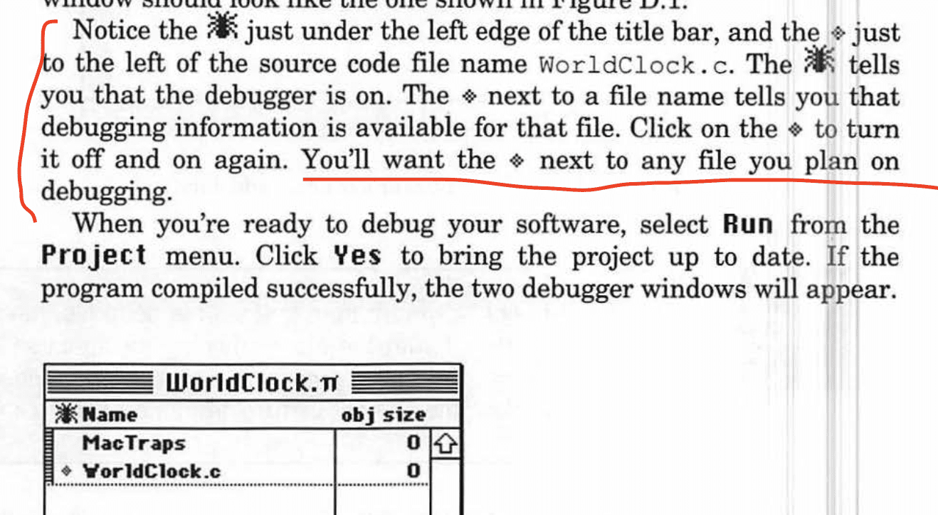

Ah here was my debugging problem:
In any event - I think I'm past my last issue.
