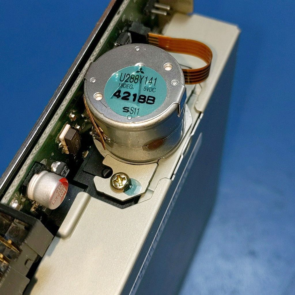

Regarding the manual-inject FDD (Mitsubishi MF355F 592MA), here is a link to a recent video from @techknight in which he discusses disassembly, recapping, track zero alignment and so on.
The MF355F 592MA that I've been working on recently had at least six screws fixed in place with green Locktite: two for the stepper motor (see photo), two for the heads and two for the PCB. Thanks to the video from @techknight it's clear now why all of those components have to be kept in alignment. So next time I recap one of these drives, I will mark the PCB and frame prior to disassembly so everything goes back together in exactly the right position.
This drive is different than the auto-inject drive described in Paolo's PDF in that this stepper motor has an 18 degree step angle (so says the sticker in the photo). If I understand correctly, that means that there's no point in rotating the stepper motor stator beyond +/- 9 degrees when aligning the heads with track zero. (That works out to about +/- 1.57 mm or 0.062" at the circumference given the motor's 20 mm diameter.) [Edit: that's assuming the motor is moved by one increment at a time when it seeks to track zero. However, it could be moved two at a time. In that case, I'd need to search over a 36 degree range to find the correct alignment, like the drive in the PDF...]
It's probably best to align the heads with the centre of track zero. One way to do that would be to follow the usual trial-and-error procedure but instead of stopping when MacOS is able to mount the disk, mark that angle and then keep adjusting in the same direction until mounting fails again. Then split the difference. An alternative method would be to attach an oscilloscope to a suitable test point on the PCB and, using a known-good floppy disk, measure the signal from the read head (or its amplifier) to find the stator angle which maximizes the signal.
Either way, I expect the main difficulty will be in making precise angle adjustments. I wonder whether those two holes on the back of the motor were put there to accept a lever -- given a sufficiently long lever, tiny angle adjustments would be easy.
