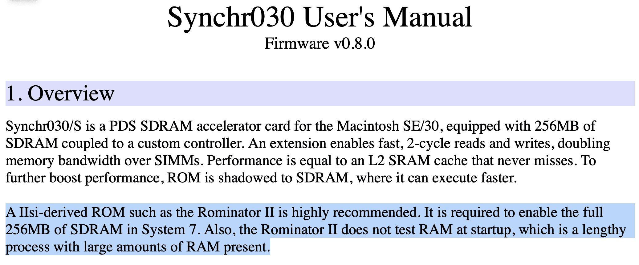

The Synchr030/S documentation mentions a non-stock ROM as being very important, and in my video I stated it as being pretty much a requirement...
"Required"? Really?
Well yes, and for more reasons than just to become 32-bit clean. Because unless you want to sit through RAM checking for 384MB (it would check 128MB, then the Extension would load, trigger a reboot, and then it would check the full 256MB), a non-stock ROM is essential to practical use of Synchr030/S. That's because non-stock ROMs kill the infuriatingly slow RAM checks at cold boot. Honestly, I wish Apple had never implemented that checking. It's so incredibly bothersome!
The good news is there are many ROM SIMMs to choose from, as I mention here.
Also note that simply having a ROM-inator II (or similar) to make your machine 32-bit clean doesn't magically make System 6 32-bit clean. System 6 (without Optima) is 24-bit only, regardless of your ROM SIMM. Optima promises to change that, but I've read about many software incompatibilities. So even if Synchr030/S is found to be compatible with Optima, one would need to contend with those incompatibilities.

"Required"? Really?
Agreed. The RAM check would have been better triggered by a certain startup key if RAM is suspect.
Enabling the full 256MB depends on certain code being present in a IIsi derived ROM, not just for the practical reason of skipping RAM tests. In other words, you will not get 256MB with the stock ROM.

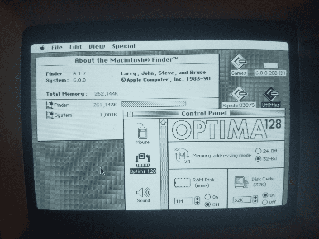

@ElBaroni I tried out the 128MB version of Optima in 32-bit mode, with and without the Synchr030/S and the result is the same:
I get a dialog on startup that says "Finder is older version" and a forced restart.
This is with System 6.0.8 and Finder 6.1.8.
The good news is that with the Synchr030/S extension in 24-bit mode, it boots fine with the ACCEL LED illuminated.
If you have any ideas, I'm happy to try them.

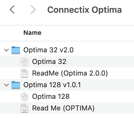

The Optima page on Macintosh Garden has only a single download. No PDF manual is offered, sadly. But I downloaded and Unstuffed the file and found there are two versions, each with their own README files:
The README for Optima 32 v2.0 says this...
OPTIMA normally requires System 6.0.7, and only functions as a RAM disk under System 7. On the IIci only, it can be made to work with Systems 6.0.4-6.0.7. Foreign Systems (including Kanji) can run with 6.0.6 and 6.0.7, but 6.0.7 is recommended.
No mention of 6.0.8 :(
The README for Optima 128 v1.0.1 says this...
It also requires System 6.0.4 or later...
OPTIMA is now compatible with many more foreign file systems. It has been tested and is compatible with German 6.0.5 & 6.0.7, Italien 6.0.5 & 6.0.7, Swiss 6.0.5 & 6.0.7, French 6.0.5 & 6.0.7 and Kanji 6.0.5 & 6.0.7 Systems. Others are supported as well.
Again, no mention of System 6.0.8. :(

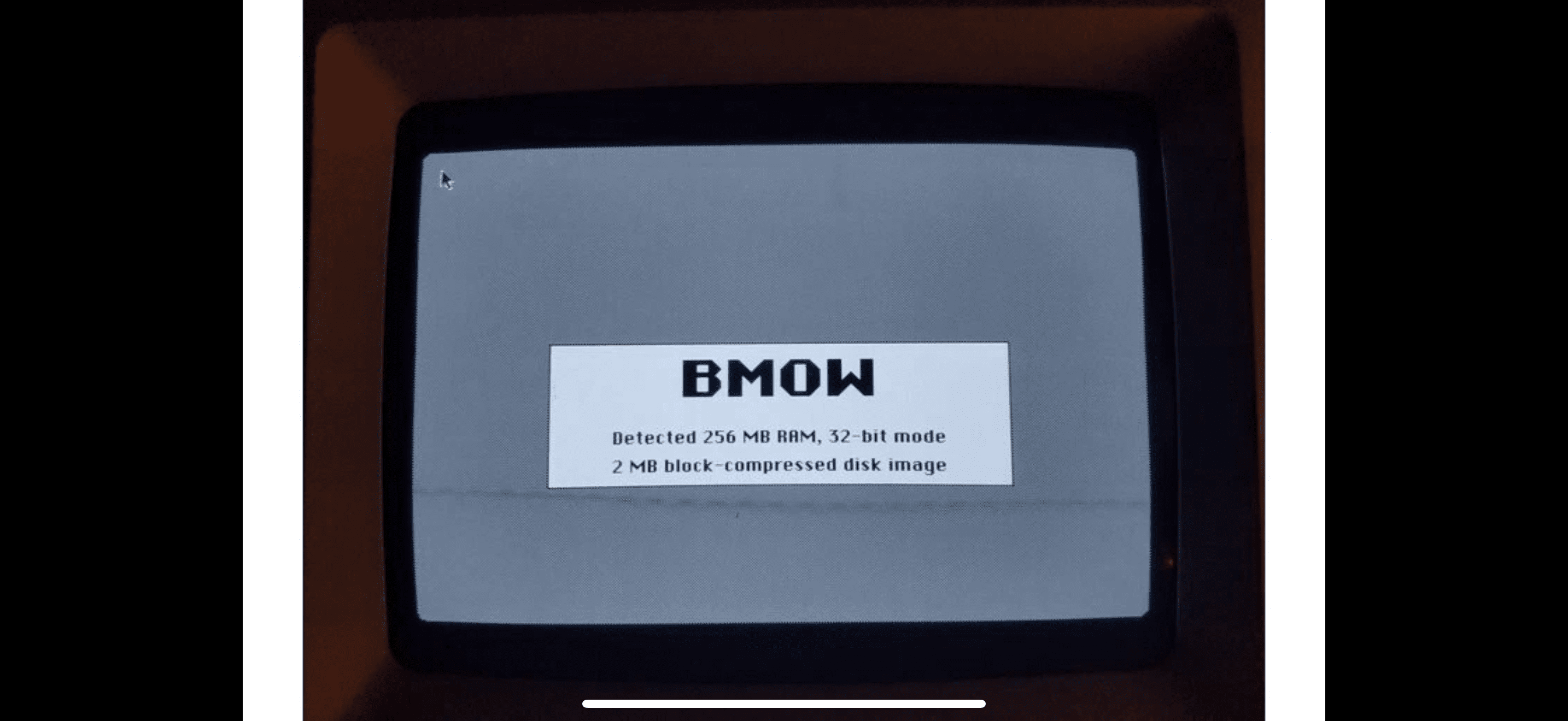

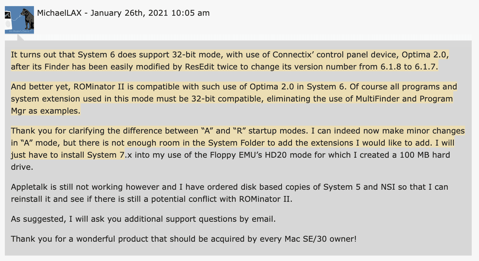

I then used ChatGPT "Deep Research" to spare me an hour of manual Googling, in hopes of locating the full Optima manual or otherwise get confirmation from multiple sources about OS compatibility, as it pertains to System 6. Deep Research checked 53 info sources (such as Macintosh Garden, Macintosh Repository, the 68kMLA, TinkerDifferent, BMOW, LEM, MacGUI, Wayback Machine, vintageapple, Reddit, Emaculation, Macworld, various Japanese, Korea, Portugese & Spanish sites) with 142 searches. In summary, it said basically what the README told me: compatibility up through 6.0.7.
However, Deep Research also found the following info about a ResEdit HACK on the BMOW site in the comments section...
SOURCE PAGE
Reactions: YMK

Thanks @JDW for this info. Apparently Connectix had very dumb version detection that didn't expect newer Finders and flagged 6.1.8 as "older version".
After using ResEdit to change all references of 6.1.8 in the Finder's vers resource to 6.1.7, it boots:
Synchr030/S is running at full speed here; two cycle reads and writes with both ACCEL and /ECS LEDs illuminated.
Thanks again to @JDW for figuring this out!

I'm truly thrilled to hear that ResEdit hack on the Finder worked! And I apologize I myself haven't found time to test it yet.
Fabulous to see 256MB fully accessible under System 6.0.8 (hacked Finder) with full acceleration too!
