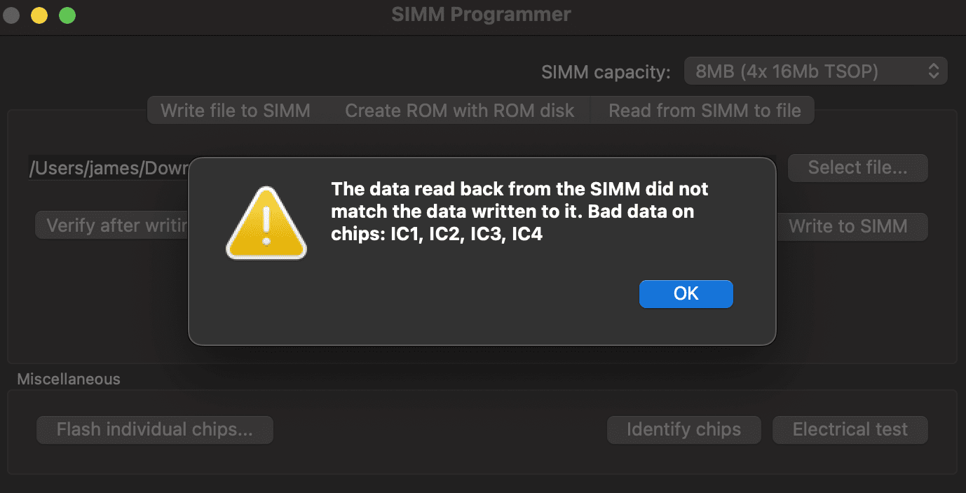

Had no time to try and flash the v091 or v092 ROMs until this evening, but sadly, my ROMmate v2 programmer simply is refusing to do the job! Is the SIMM Programmer app incompatible with macOS Sequoia? I tried using my standard cable multiple times to no avail. I tried multiple USB-A to USB-C adapters to no avail. I tried other cables too, all in vain.

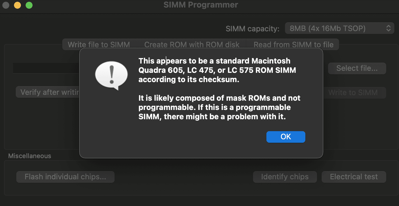

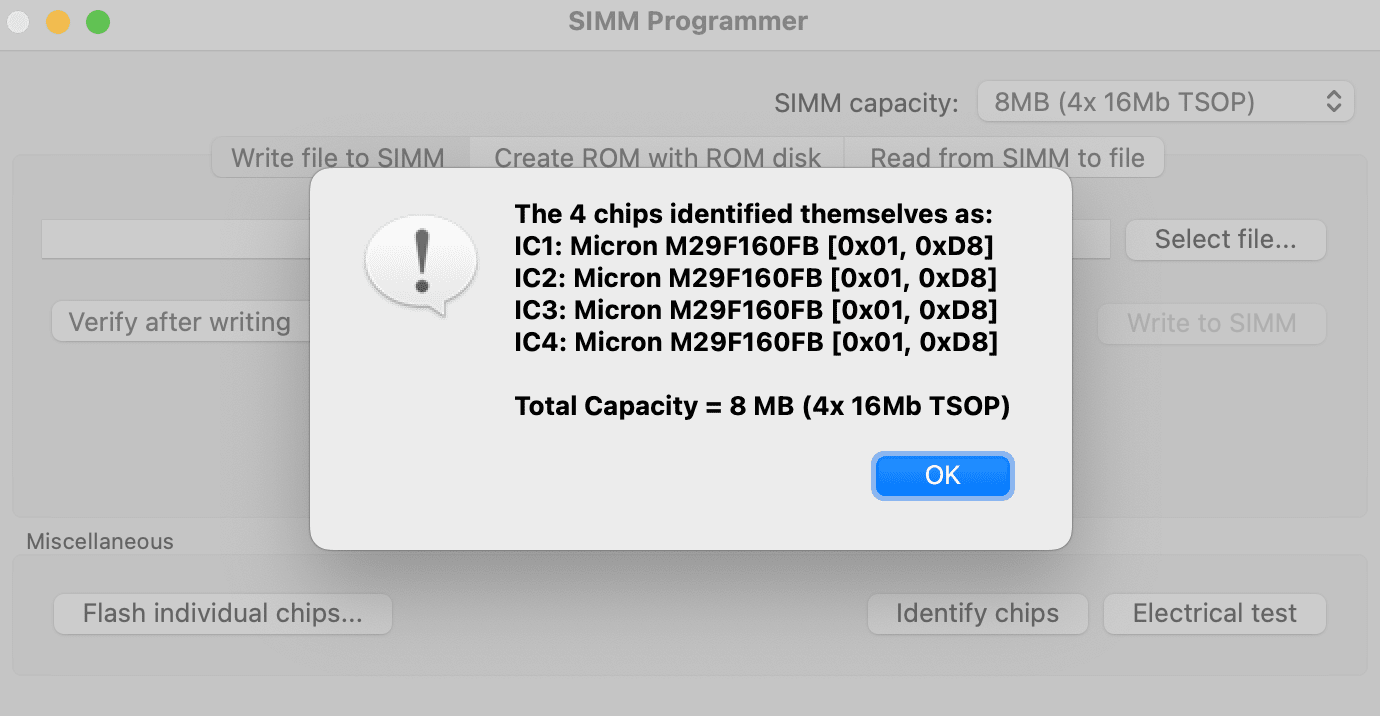

The SIMM Programmer app recognizes the ROMmate v2 programmer just fine. Meaning, I launch the app, then with the Universal ROM SIMM properly installed in the programmer, I flip the programmer's PWR SW to ON. The GRN LED on the programmer lights, as does the LED on the Universal ROM SIMM. And when programming, I get a RED LED lighting on the programmer. All is well until it finishes Verify, showing this every single time...

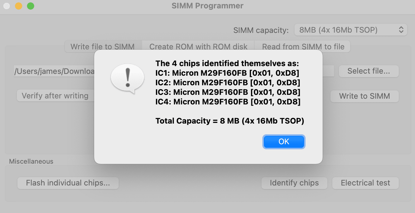

Identify Chips works fine...

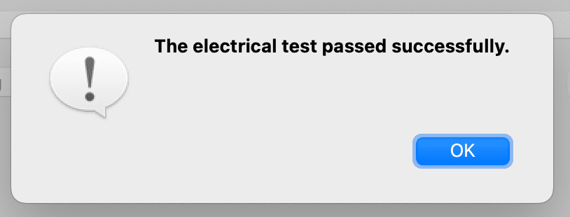

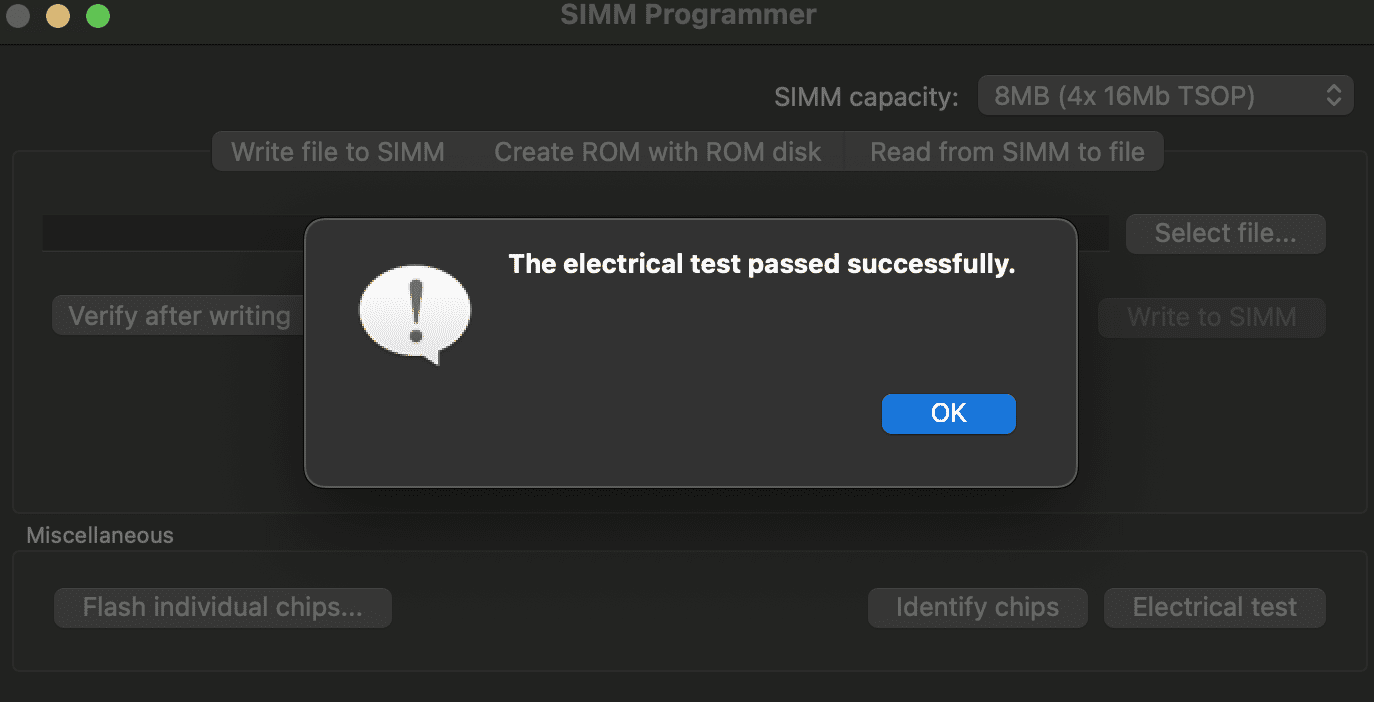

As does Electrical Tests...

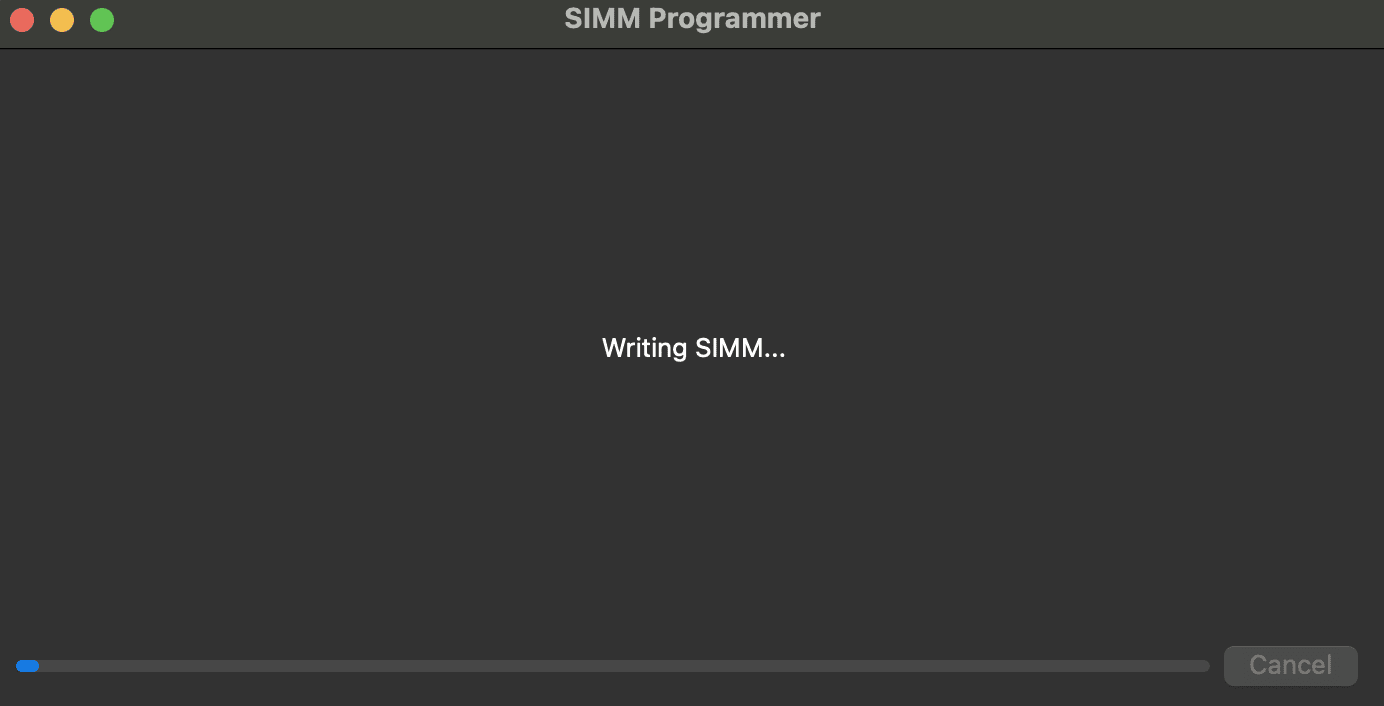

And after a Verify failure, if I try to flash again, it starts but then stops like this...
And sometimes it says that but no RED LED light on the programmer. I am forced to Restart to get it to flash again, but at the end of Verify, I get the same errors.

@dougg3 I'm going nuts!
Just fired up my old Intel mid-2015 15" MacBook Pro running MacOS High Sierra and downloaded your v2.0.1 SIMM Programmer app. Sadly, when I launch the app and then switch on the ROMmate Programmer v2, the app won't recognize the programmer. 🤦‍♂️
Used Boot Camp to boot into Windows 10. Tried the Windows version. Thankfully, it can recognize the Programmer (giving further evidence that macOS High Sierra must not be supported), but sadly, it fails to flash my ROM SIMM too.

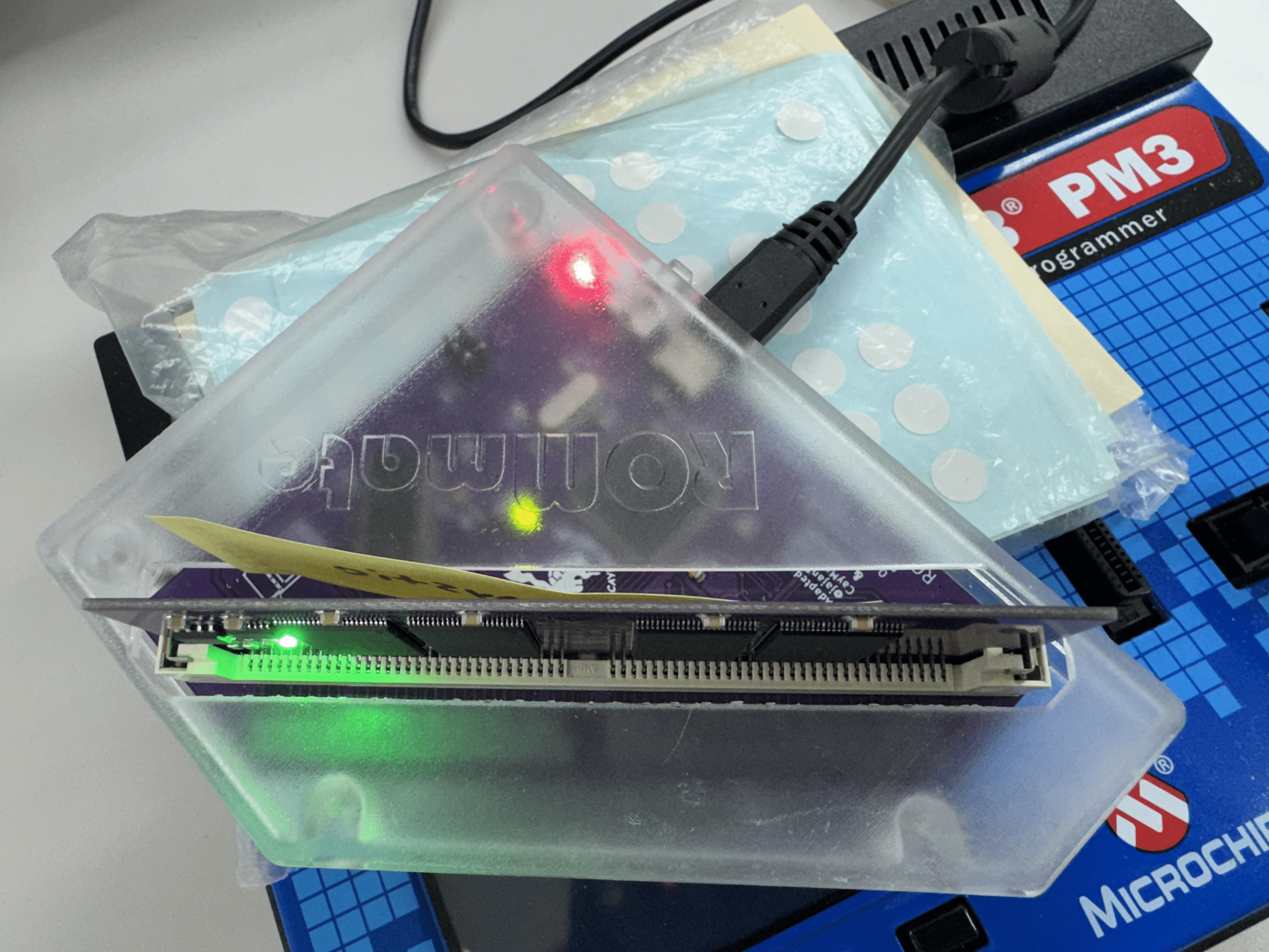

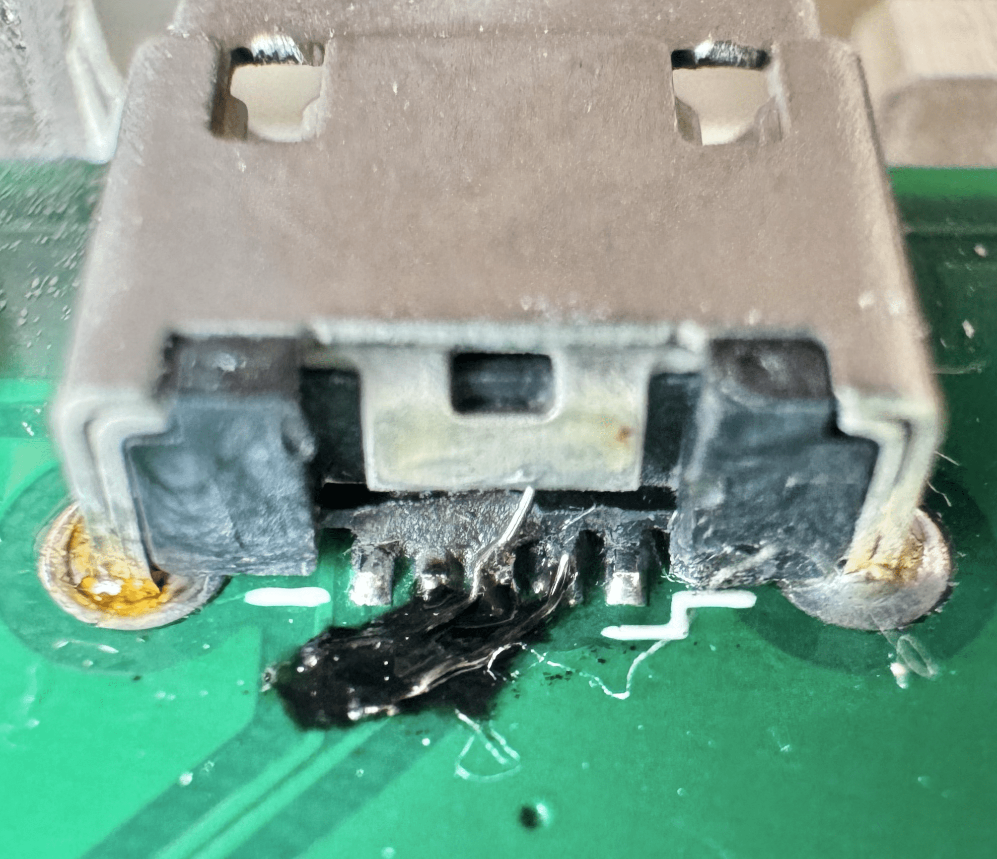

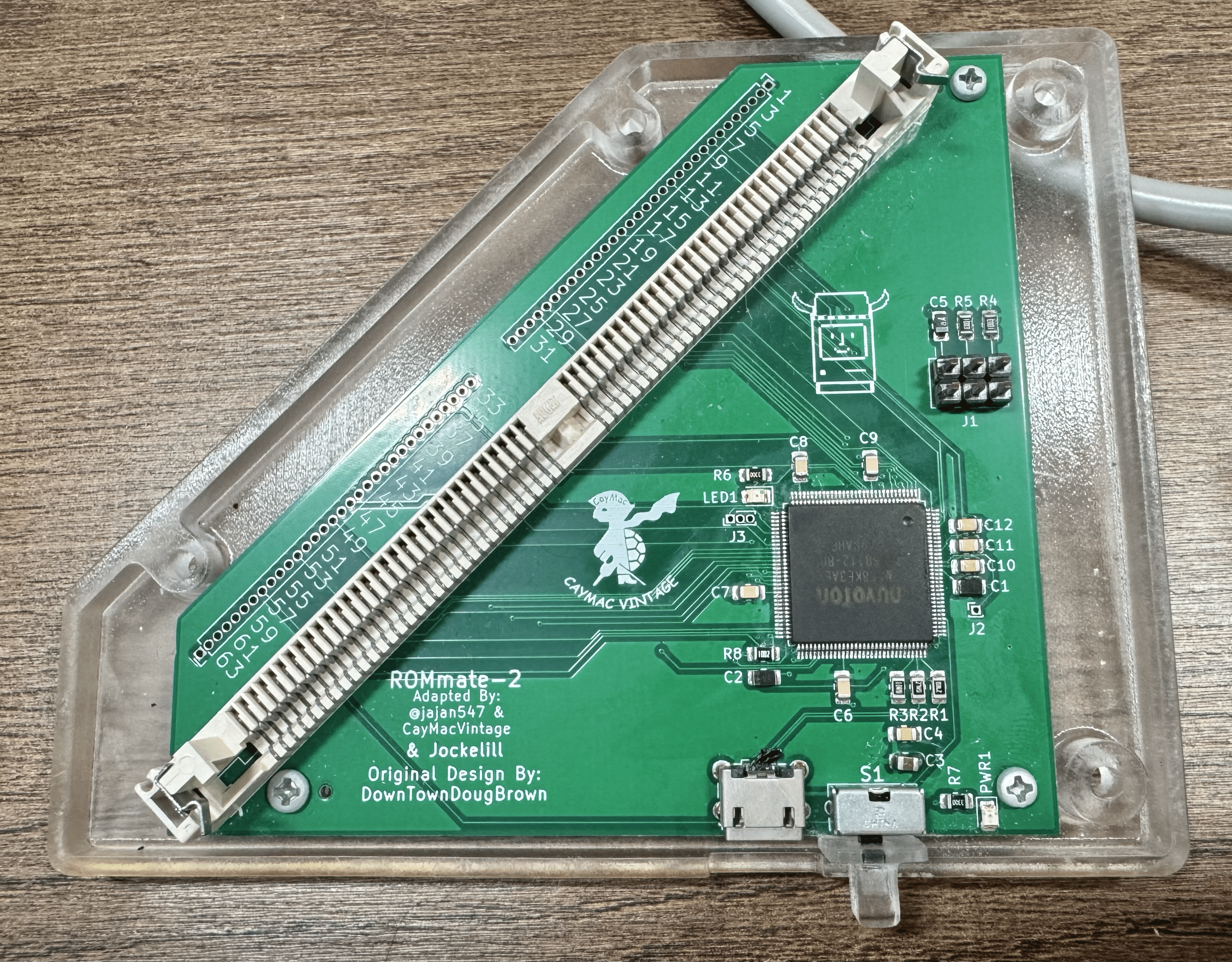

I decided to open the case and check the ROMmate Programmer v2. The back of the USB connector looks odd. Not burnt, but rather than some work had been done. My guess is that it must be that. Odd though, because it's worked fine to date.
Well, at least I have a v1 Programmer at the office, so I'll give that a try tomorrow.

I seem to recall there was a mistake on the first revision of the boards where USB D+ and D- were swapped, so that probably explains the hack you're seeing. @Jockelill would know more about that. Mine has a bodge near the microcontroller instead of the USB port, but I'm guessing it's the same hack.

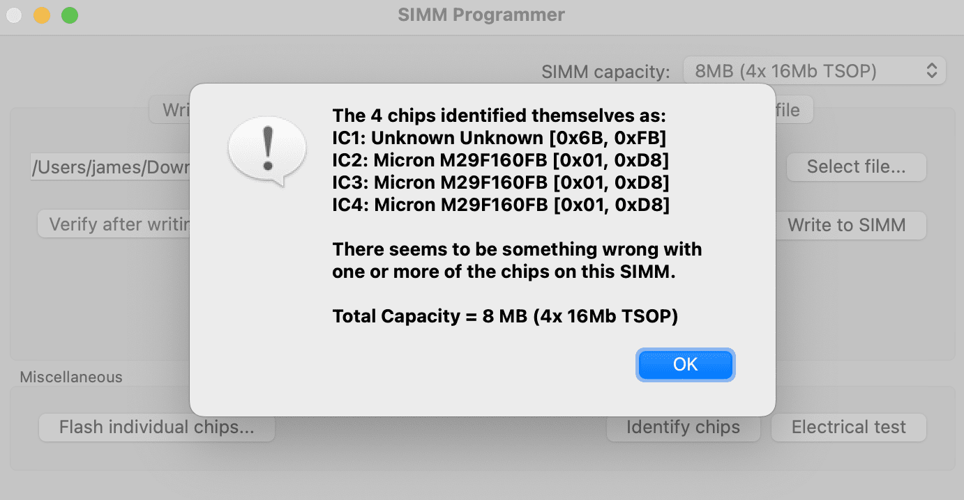

Something is definitely screwed up because it's saying "It is likely composed of mask ROMs and not programmable. If this is a programmable SIMM, there might be a problem with it." That means it's failing to detect the SIMM as actually being comprised of flash chips. What type of programmable SIMM is it? Can you try a different SIMM? I agree that testing with an old programmer would be good for narrowing down the problem.
I don't want to derail this thread into programmer troubleshooting if we have to go back and forth too much; maybe we can move to another thread or email or something. Bottom line though is that the SIMM programmer definitely works properly with Sequoia and Windows 10.

I'm at the office now with Universal ROM SIMM installed into my CayMac v1 ROMmate Programmer, and I am using the same USB cable I used last night at home without success. When I click Identify chips (again, with my v1 Programmer), it shows me this (which is expected):
Electrical tests pass:

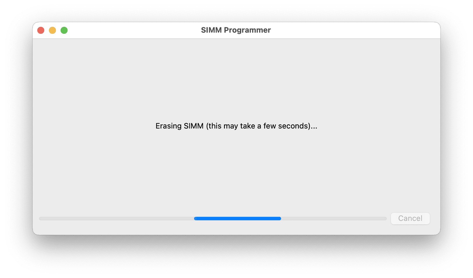

Doing a Write to SIMM shows me Erasing first, which is expected (I mostly wasn't seeing that last night):

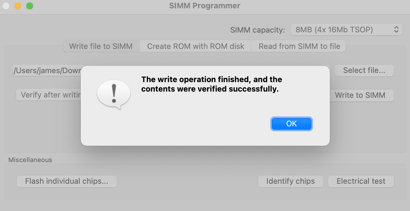

After that it wrote normally (at the slower 1x speed, of course):
Verify completed successfully too...
After that, I switched off the V1 programmer and disconnected it, leaving the USB cable attached to my 2015 5K iMac running macOS Monterey, and I attached my troublesome v2 ROMmate Programmer, then switched on Power, then clicked Identify Chips, which gave me this...
So clearly, this v2 Programmer, which worked fine originally, now is bad.
I confirmed that by disconnected the v2 and reconnecting the v1, and doing Identify chips again, which passed:
So basically, I will need either a schematic or a photo that shows which traces connect to which pins on the USB connector in order to attempt a fix, but that's assuming it's only a USB connector problem and not a fried chip (which very well could happen if the USB connection was bad).
I'm not a fan of these little USB connectors because we all end up putting too much force on them during cable insertion and removal, and they aren't designed well to begin with, not having adequate size to mount permanently on the PCB. USB-A is huge in comparison, but the larger connector makes it more robust.
Also, the power switch on my v1 and v2 are both extremely close to the USB connector, such that it's always a pain to switch it ON and OFF. I can only do it by wedging my thumb at one particular awkward angle between the switch and the USB cable, and it requires a lot of force. Even when I disassemble the case and try to slide the switch with the 3D printed extender on, the switch doesn't want to slide. It's therefore probably better to just have a power switch that has a long enough plastic switch so that the plastic part extends outside the 3D printed case, and no 3D printed switch extender would be necessary.
Another issue, on my first-edition programmers anyway, is that the cut-out for the USB cable is too small. 90% of the cables I have don't fit. I only have two cables with teensy tiny black rubber around the connector that fit into the tiny case hole, and even then it requires force. I clearly need to Dremel out a larger hole to make my connectors fit into the case more easily.
I sent Will an email just now, so I'm sure we can get the v2 programmer connector issue addressed; and for now, my v1 is working fine.

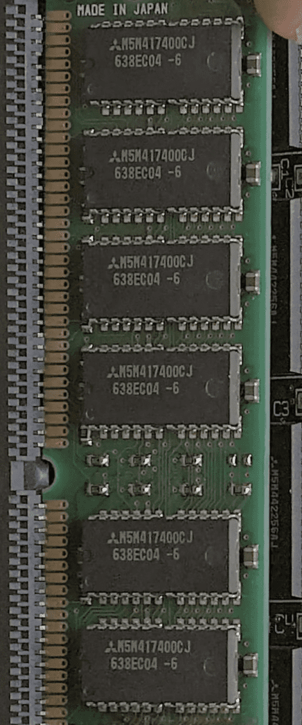

I see I only have 32MB RAM now instead of 36MB
Do you know the speed of your RAM SIMM? If the onboard RAM is disabled during sizing, I think the MEMC still defaults to 80ns if I remember correctly. So you'd need to poke the right register to step down to 60ns. I know this works OK on the LC475, not quite sure on the LC575. But that machine also has the MEMCjr right?
60ns

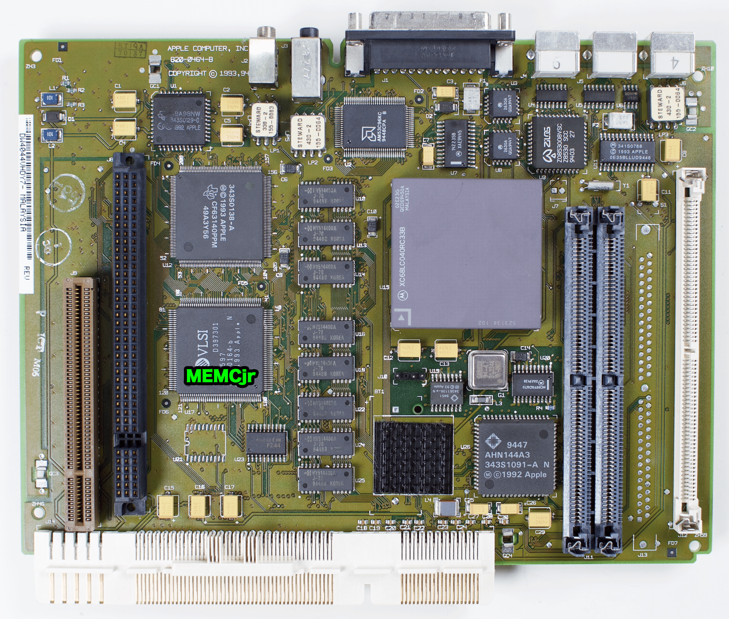

Yes. See the 4th page of the attached PDF schematic of the LC575 motherboard.
475 Overclock Software by @phipli requires MEMCjr to do its magic.
You can download the MEMCjr datasheets here:

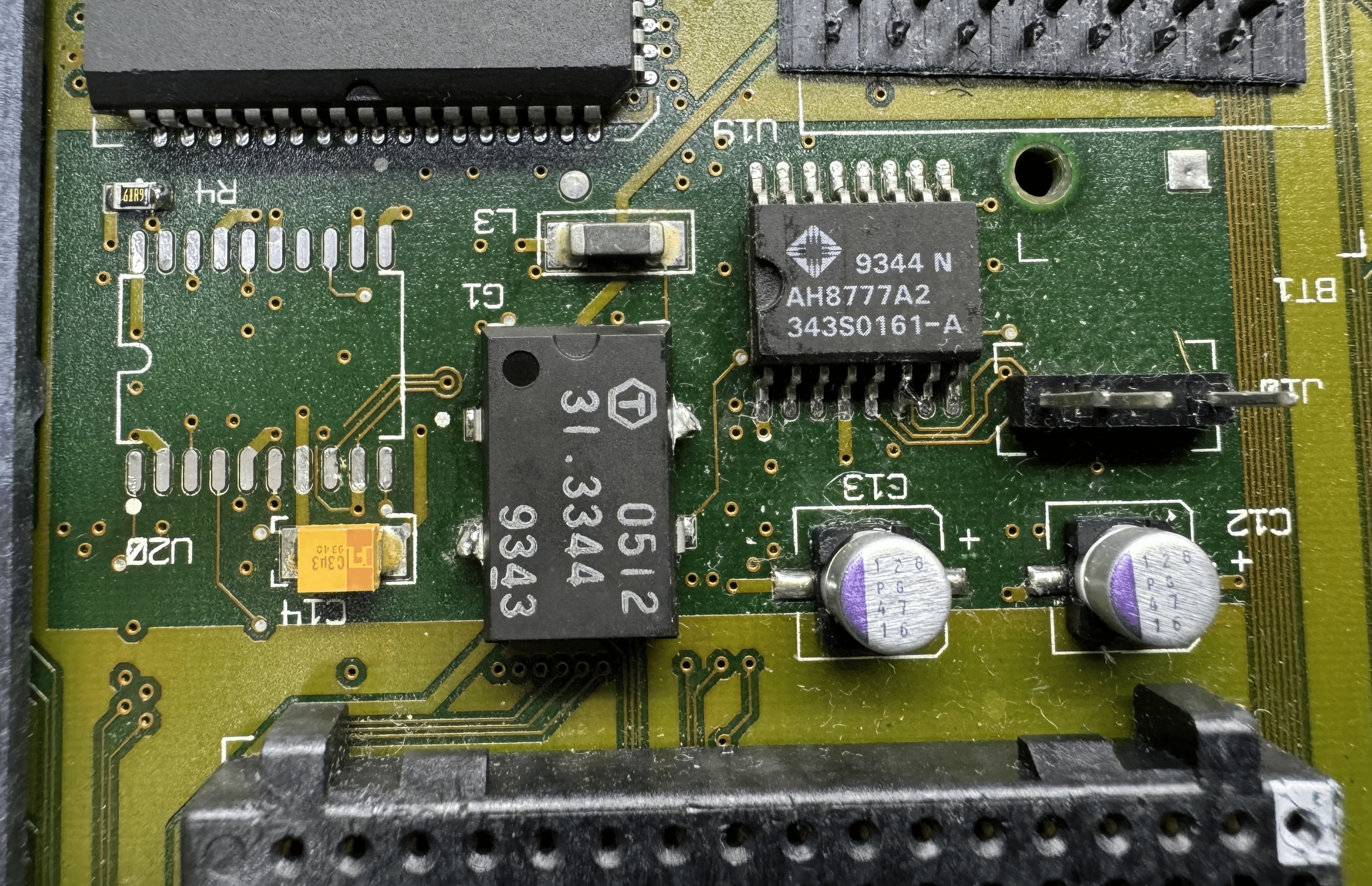

The MEMCjr's physical location on the LC575 motherboard is found at U17 in the marked up photo below (photo by @Branchus ):
Separately from that...

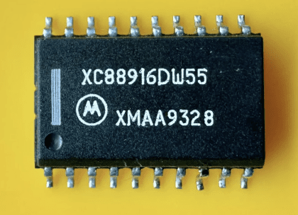

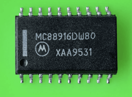

Take note of this chip, which is on the LC575 board by default.
Thanks to the kindness of @trag , I was able to replace my stock MC88916DW55 chip shown above (LC575 board) with the superior MC88916DW80:
You can see below that I had the stock MC88916DW55 chip removed at U20...

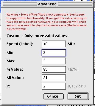

When using his 475 Overclock Control Panel, the "Advanced" settings look like this...
Phipli told me in the past to read the following datasheet to make sense of Ni, Mi and P settings:
https://bitsavers.computerhistory.org/components/sierra/SC11412.pdf
I still was unclear on what numbers to type into the fields (see "Advanced" dialog box above), so I spoke to Mustermann, who laid the coding groundwork for Phipli's later coding work. He told me the following in regards to the SC11412.pdf I linked above, noting that his mention of "Phipli's Tool" is referring to the 475 Overclock Control Panel and Extension combo. (Also note what Mustermann says here about Gazelle, on the LC475, being a SC11412.)
There are 2 clock generators in the [SC11412] chip. One is managing PCLK the other one is managing MCLK.
Both are programmed using a common 20-bit shift register.
DS0 (first bit) of the register decide if you are programming clock generator 1 or clock generator 2.
Within my code and Phipli's tool, DS0 is always 1 so programming clock generator 1, controlling PCLK that is connected to MC88920/16. If you switch that to 0, you can change pixelclock (but I never tried that).
Don't worry about MCLK is controlling pixelclock. Apple just used them the other way round.

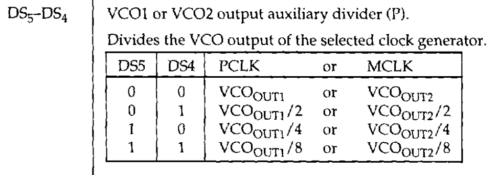

Next is about "P" [field]:
There are two bits DS4 and DS5 in the shift register selecting P divider.
So this part of the register can be 00=0,01=1,10=2,11=3.
As you can see from the datasheet, 11 set divider to 1/8, 10 to 1/4, 01 to 1/2 and 00 to 1/1
My code and Phipli's tool both use the binary value of DS4 and DS5.
So at the end clock is divided by Pi(in the calculation in the datasheet) = 2^P (from the tool).
I am not sure about the greyed-out Mi/Ni ["Ni value" field].
This is how calculation works:
CPUfreq = 2 (that is what MC88920 is doing) * N/(M*2^P)* 31.3344MHz(Frequency of Crystal oscilator)
48,01238 = 2 * 95 / ( 31 * 4) * 31.3344

So to write 12bit you need first write the upper 6bit into MEMCjrHoldingRegister and then write the lower 6bit into the target register.​
So the lines...​
*((unsigned long*)(MEMCjrHoldingRegister)) = 0x0101>>6;​
*((unsigned long*)(MEMCjrConfiguration)) = 0x0101;​
...just write 0x0101 into Configuration Register of MEMCjr.​
For the FrameBufferConfiguration register, the bits 0-7 shall not be changed by the function.​
So it first reads the register (again with support of HoldingRegister)...​
config = 0x0000003f & *((unsigned long*)(FrameBufferConfiguration));​
config = config + ((0x0000003f & *((unsigned long*)(MEMCjrHoldingRegister)))<<6);​
...then sets the bits 8-11 to 0 (that is the parameter for level 0)​
config = config & 0x000000ff;​
and write back the result​
*((unsigned long*)(MEMCjrHoldingRegister)) = config>>6;​
*((unsigned long*)(FrameBufferConfiguration)) = config;​
For Level=0​
Configuration is set to 0x0101​
FrameBufferConfiguration is set to 0x00?? (?? because these bits were not changed)​
For Level=1​
Configuration is set to 0x001A​
For Level=2​
Configuration is set to 0x00DC​
FrameBufferConfiguration is set to 0x02?? (?? because these bits were not changed)​
For Level=3​
Configuration is set to 0x02DC​
FrameBufferConfiguration is set to 0x0A?? (?? because these bits were not changed)​
Configuration register is setting wait states for RAM and ROM​
FrameBufferConfiguration is setting wait states for RAM and ROM​
E.g., Level 0 is 1 ROM waitstate, Level 1 is 2 ROM waitstate, Level 2 is 4 ROM waitstate and level 3 is 4 ROM waitstates.​
As all these registers are about waitstates, for security reasons.​
it is better to have more waitstates. So if frequency is between 2 datasets read from datasheet (e.g. between 25Mhz and 33Mhz the values should set to maximum of the values of the edges.​
That is why the function is named setregistermax.​
As I have a programmable ROM added to my LC475 that is quite fast (55ns, instead of 100ns or 120ns as the onboard ROM is) it makes sense for me to reduce ROMwaitstates at higher frequencies as well.​
Current version of the Extension is not able to do this.​
From my experience, ROM speed and waitstates have a significant impact to overall speed.​
Lastly, Phipli's 475 Overclock Software is COMPATIBLE with the following Macs:
• LC475, P475, P476, Q605​
• LC575, P577​
NOTE: Some Macs (not 575) need resistor changes (not LC575), as mentioned on Phipli's Web Page here.​

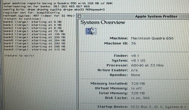

@JDW yes lots of really good info regarding overclocking the MEMCjr and djMEMC. That is next on my list to continue that.
Otherwise been out of pocket for a while working on some other hobbies. Returning to my newly arrived Q650, I can get it to register 328MB of RAM so far (8 onboard + 128 SIMM + 128 SIMM + 32 SIMM + 32 SIMM).
I am running into the same issue BBRAUN documented back in 2012, where 3x or 4x 128MB SIMMs results in bad chimes. So I'm deep in SIZEMEMORYPATCH disassembly (offset A0000) and djMEMC land right now. Curious if I can figure this out.
https://web.archive.org/web/2022112...info/forums/thread.jspa?threadID=117&tstart=0
This is were I also got stuck, maximum 328MB RAM :), if you fix it it's incredible :D

I'm pretty close to getting 512MB to register in the Q650, at least I hope. I do think it may have to do with the power/voltage drain by the big SIMMs. When I poke the 50F0E000 register and set the OneBufferedBus bit, the Q650 posts and does a full boot with 4x 128MB SIMMs. But by setting this bit, the video is also forced to the data bus and I get no display. So right now I have some low voltage SIMMs on the way so I can give these a try.
The comments from the original Apple developers indicate that WOMBATs (ie, the Q650 machine) should not set the OneBufferedBus bit. Makes sense I think, as the djMEMC can address the RAM in parallel.
I'll put a bit more detail on this post than I did on the 68KMLA. I pretty much re-wrote the SIZEMEMORYPATCH in all the testing I did. I went so far as to even move the SoundBuffer in hi memory instead of the RAM chunk table. So I'm leaning more towards power drain at this point.
It may not be power drain per se. It may be that the memory controller does not have/use enough drive strength for the number of chips connected to the bus. The current provided on the address/control lines may be too low.
But...
It seems to me that the number of chips with 4 X 128 MB would be the same as the number of chips with 4 X 32 MB SIMMs. So one would need to dig into the datasheets for the chips that are typically on the SIMMs and see how much current they drain on their address pins, comparatively.
If the 128MB SIMMs have parity chips on board, removing those could make the difference by reducing load. Although, do parity chips draw current on the address lines?
What you said @trag :) I also noticed all of my SIMMs are EDO not FPM. But I am not sure if that makes much of a difference with power drain.
I'm out of town at the moment. But when I get back my next step will be to look up the chips individually to see how they compare.
Reactions: trag and JDW
