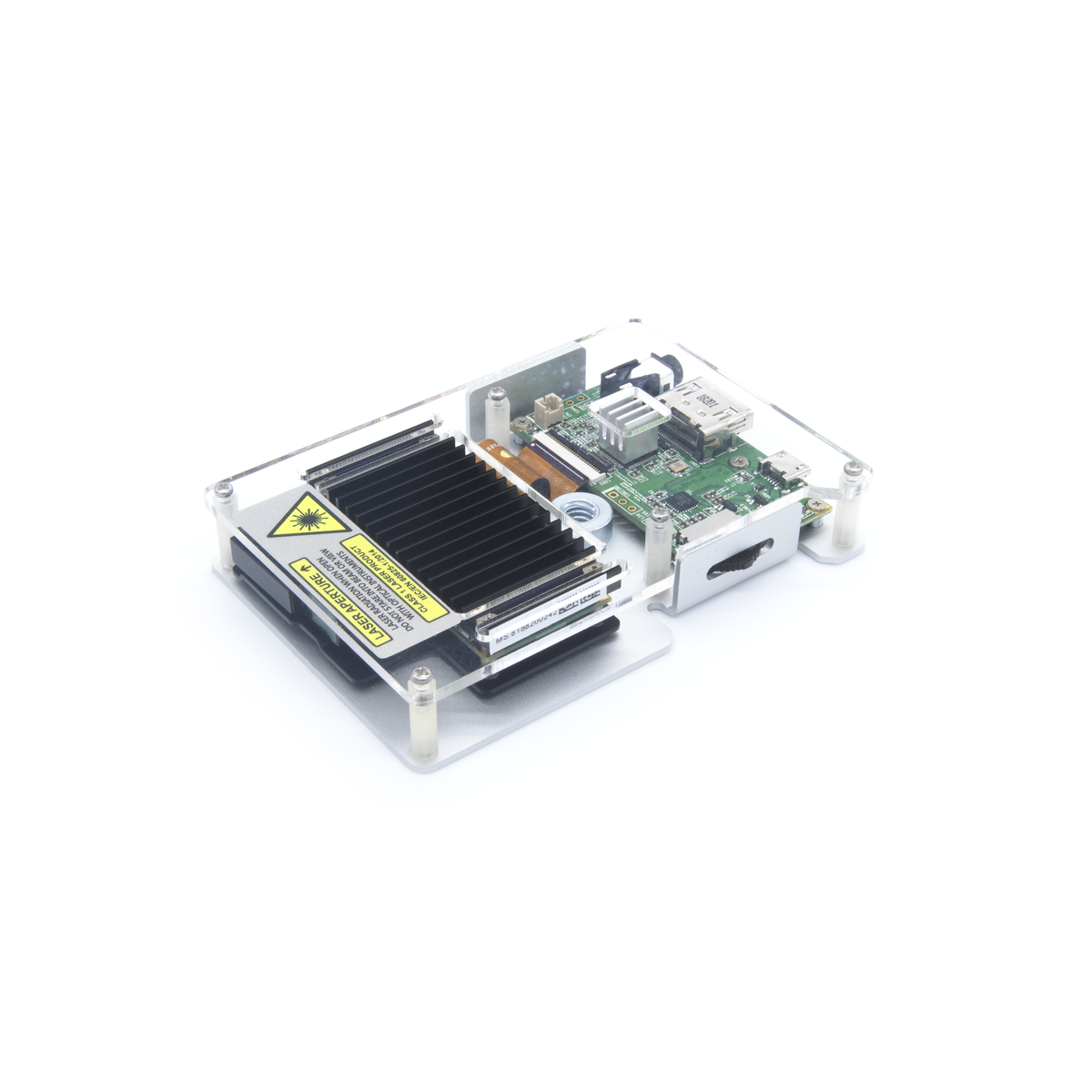

My favorite display I own is actually a projector. Sadly they are hard to get right now because there was low commercial demand, no one really understood why it's so much better than any other pico projector. The other issue is the chip shortage + the MEMS powering it is being used in other products like automotive.

Nebra/AnyBeam MEMS Laser Pico Projector.
AnyBeam in some markets, like the US. Nebra elsewhere.
Did I find it? :)
Reactions: vorg

Did I find it? :)
Yup!
I wish I heard of it in time but they did a Raspberry Pi hat version on kickstarter once too.
