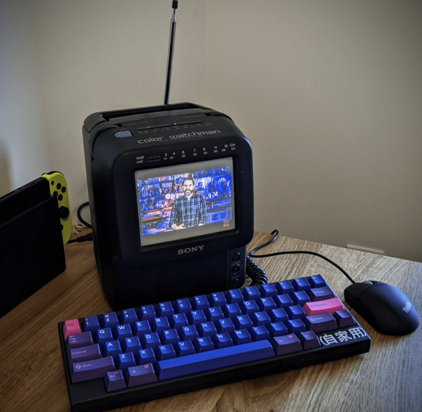

@Drake, is it a Sony KV-6PR1 tv? 🤩
I forget the model exactly, it's in the closet ;)
