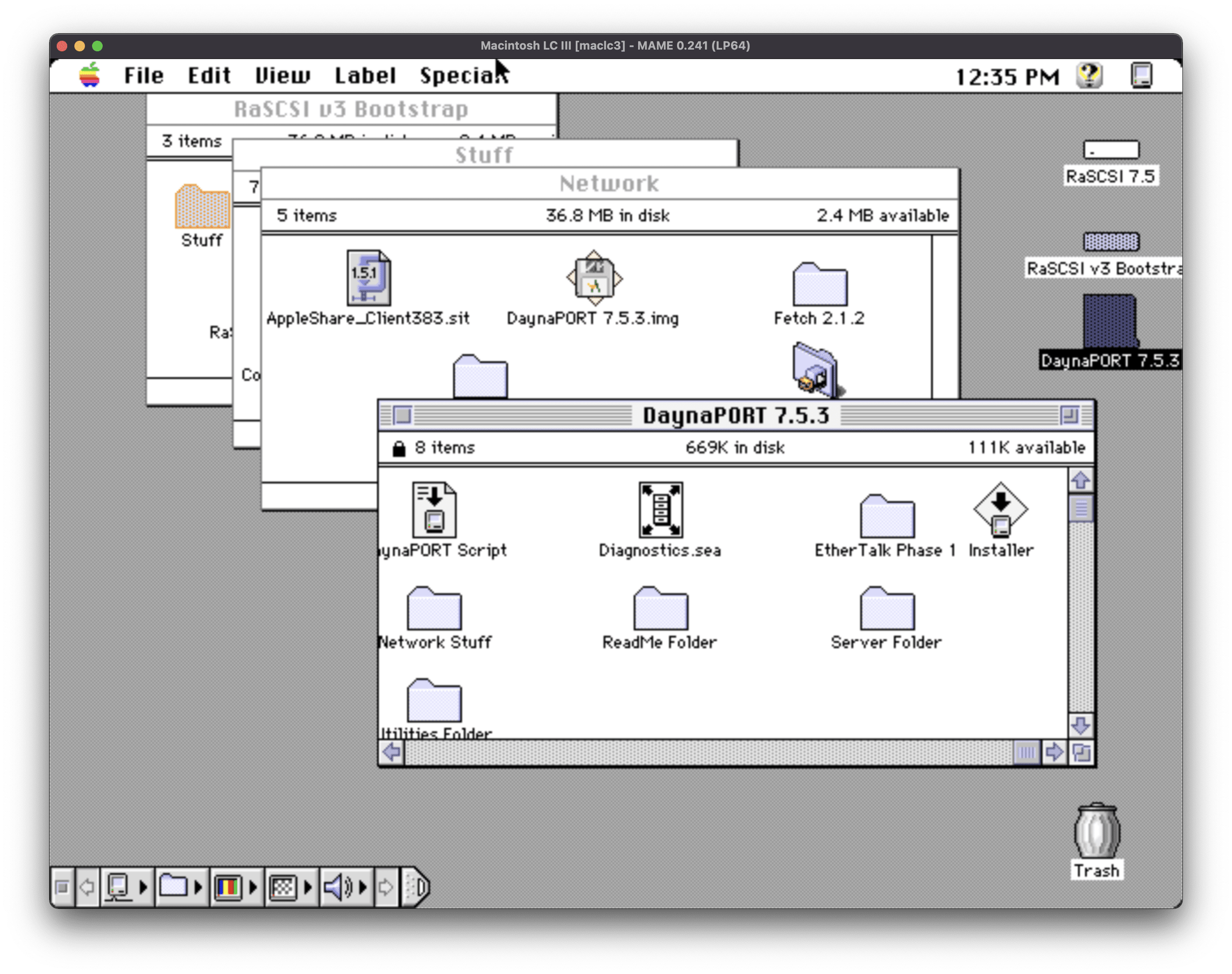

I am trying to remember what I recently did to get those installed. I am starting to think that I actually created a physical floppy because I was running into the same problems.
1,152
1,936
On the RaSCSI bootstrap v3 I made sure to make it a self moutning image as to not have these issue. check it out. Be sure to follow the instructions and only install the driver needed and not overwrite some system files with an older version.

Was it maybe a Shrinkwrap archive?
I seem to be having issues with the installer I found for 3.5 (crashes instead of doing anything), and 2.1 mounts the image but the system reports that it's not formatted as a Mac disk and needs to be formattd.
I'm using v3 - Double clicking on the image gives me an error: "ShrinkWrap was unable to load a component needed to mount the disk image. The Component Manager may not be available. Error #-9405"
