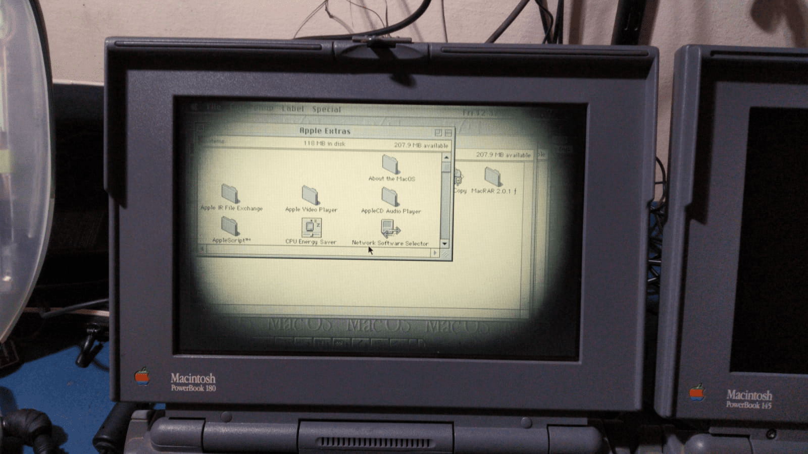

Tunnel vision on PB170
Oct 15, 2021
213
So folks are (lightly) baking their LCDs to get rid of tunnel vision?

I’ve made another video where I try baking the LCD panel and have achieved great results. Not 100% better but close. I suspect more baking will yield better results. Short of buying a new panel this is the only working fix I’ve managed to find.
Hope some will find it helpful.

Nice work, and excellent video! Quick note of clarification: tunnelling only affects ACTIVE matrix display, so only the 170 and 180. The other Powerbooks are unaffected (I just noticed you mention the other PB's in your show notes).

I managed to recover my Pb 170 by vacuum bagging it along with silica pouches for a long, long time (I mean: months).
When I got the unit, the (severe) tunnel effect was appearing after just a few minutes. Nowadays I get bored at pretending I have to do something with the PowerBook before it starts darkening again and just along the very periphery, similarly to what shown in the video.
Say, a non invasive method for the very patient ones…
