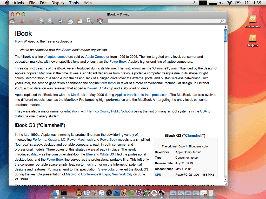

I managed to get Kiwix to finally work on OS X 10.5 (PowerPC) even though I don't think they ever had a PowerPC-working build. There are some PowerPC builds around but the components inside the app bundle (contentManager.dylib, xapianAccessor.dylib, zimAccessor.dylib and zimXapianIndexer.dylib) were all build for Intel-only. Therefore, Kiwix did not work.
It does work now after re-building the components and the XUL framework, and I can browse Wikipedia offline from the safety of my iBook G4.
If you enable ZIM indexing, the CPU will surely get gimped for few hours, as seen in my screenshot.

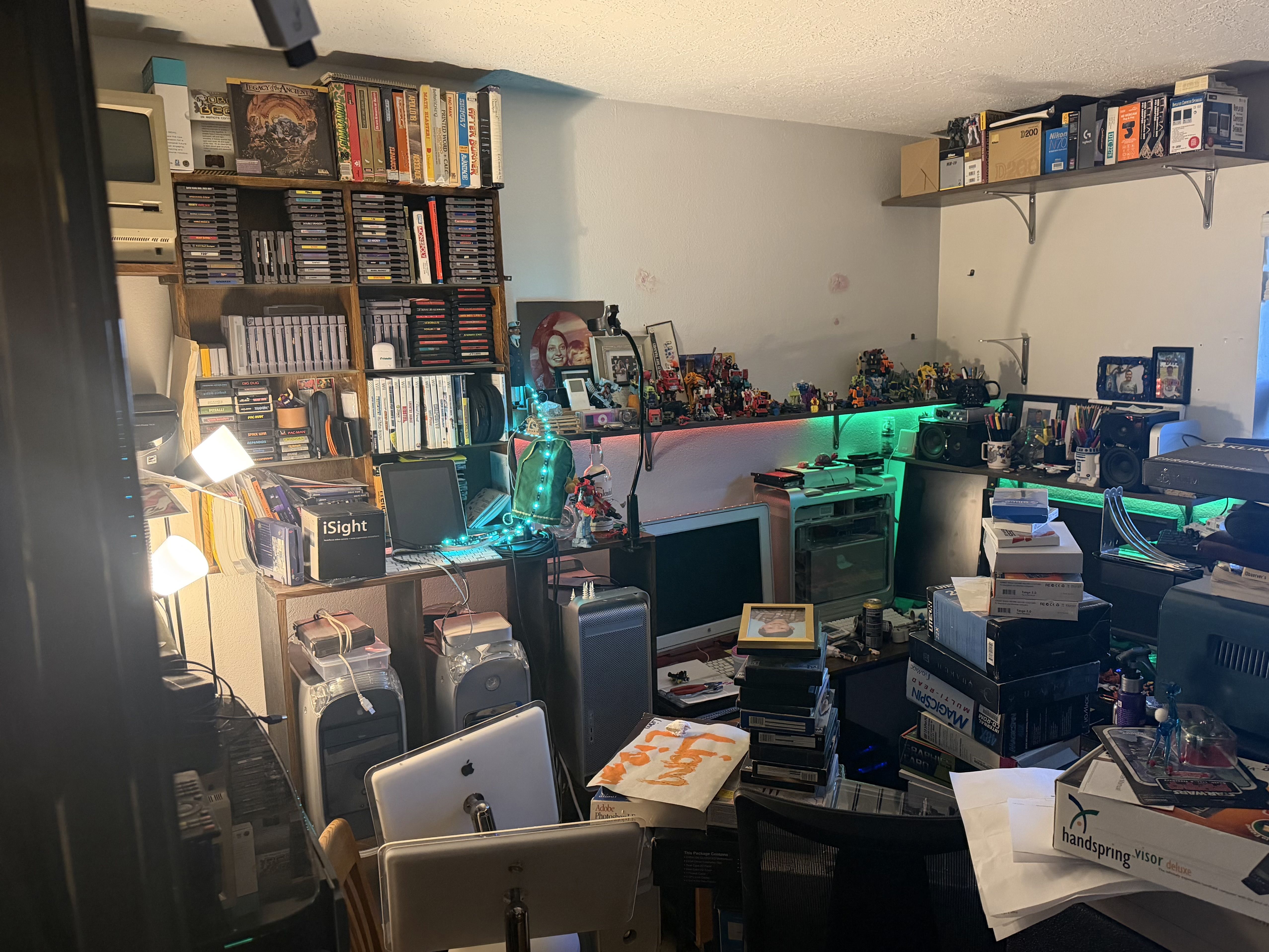

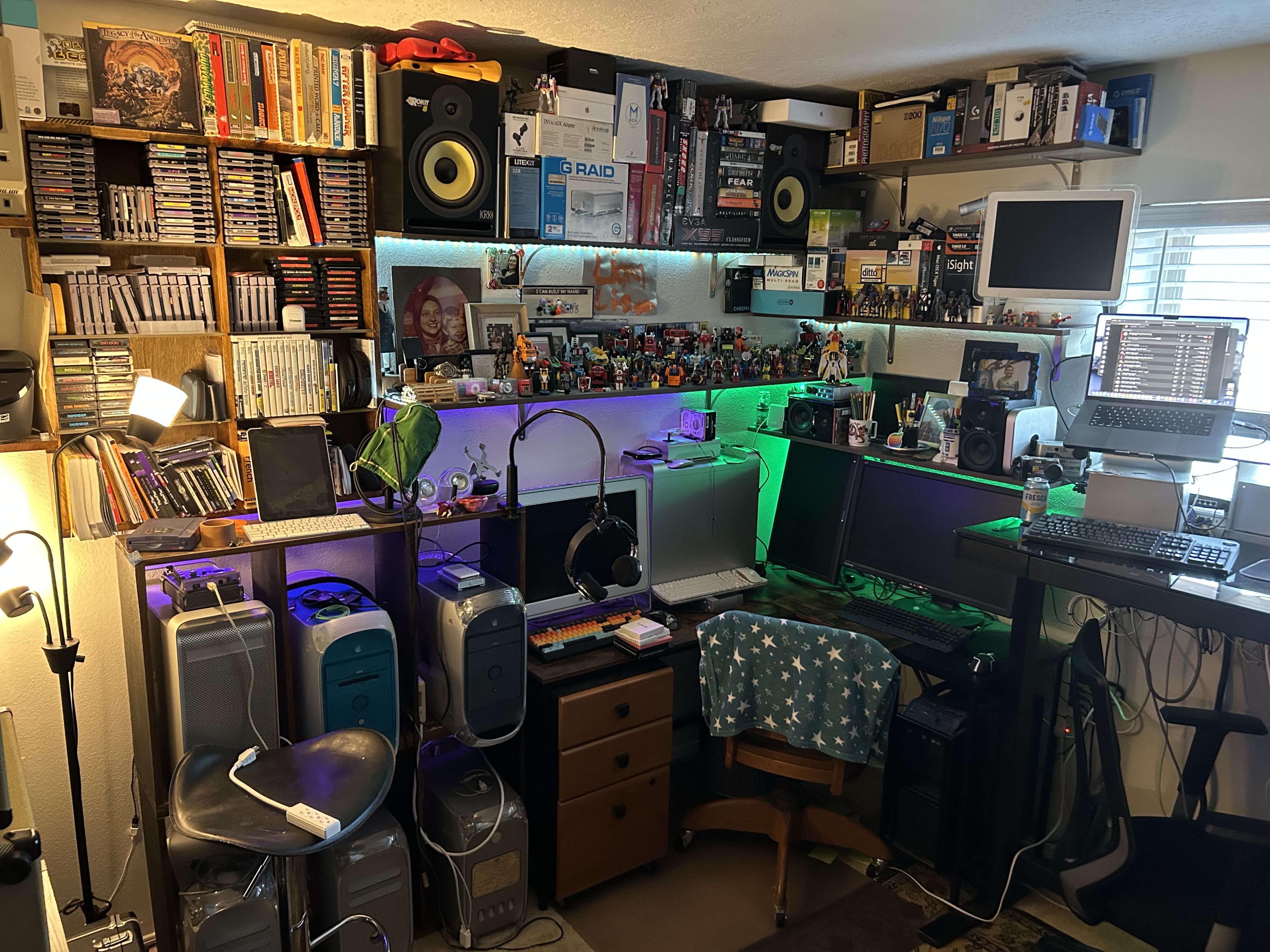

Today I tested two of my iMac g4s & a g4 mini to make sure they still worked and survived a tumble off some storage shelves in my office when their metal supports fatigued sending all sorts of stuff tumbling to the ground. This was last week Tuesday while my three boys & I were eating dinner. I feel SO lucky that the boys were not in my office as they love to get up on that shelf and play with my vintage transformer and gobot collection. So many times I’ve been in there with them too & my littlest 2.5 y/o loves to sit right below that shelf on the ground - scary thought just makes me sick to think about :(. Everyone is fine of course but holy heck!
Addirionally, something whacked my a1047 on the way down (maybe one of those big krks) which caused it to kernel panic. Luckily it rebooted without issue and I haven’t experienced any weird behavior … yet 🤞
BEFORE
AFTER
1.) Good news is that the iMacs & mini all survived a 6-7ft tumble and are working fine. I did have one dvd rom stop working but that was due to the pata cable coming loose from the jolt of the fall which was easy to fix.

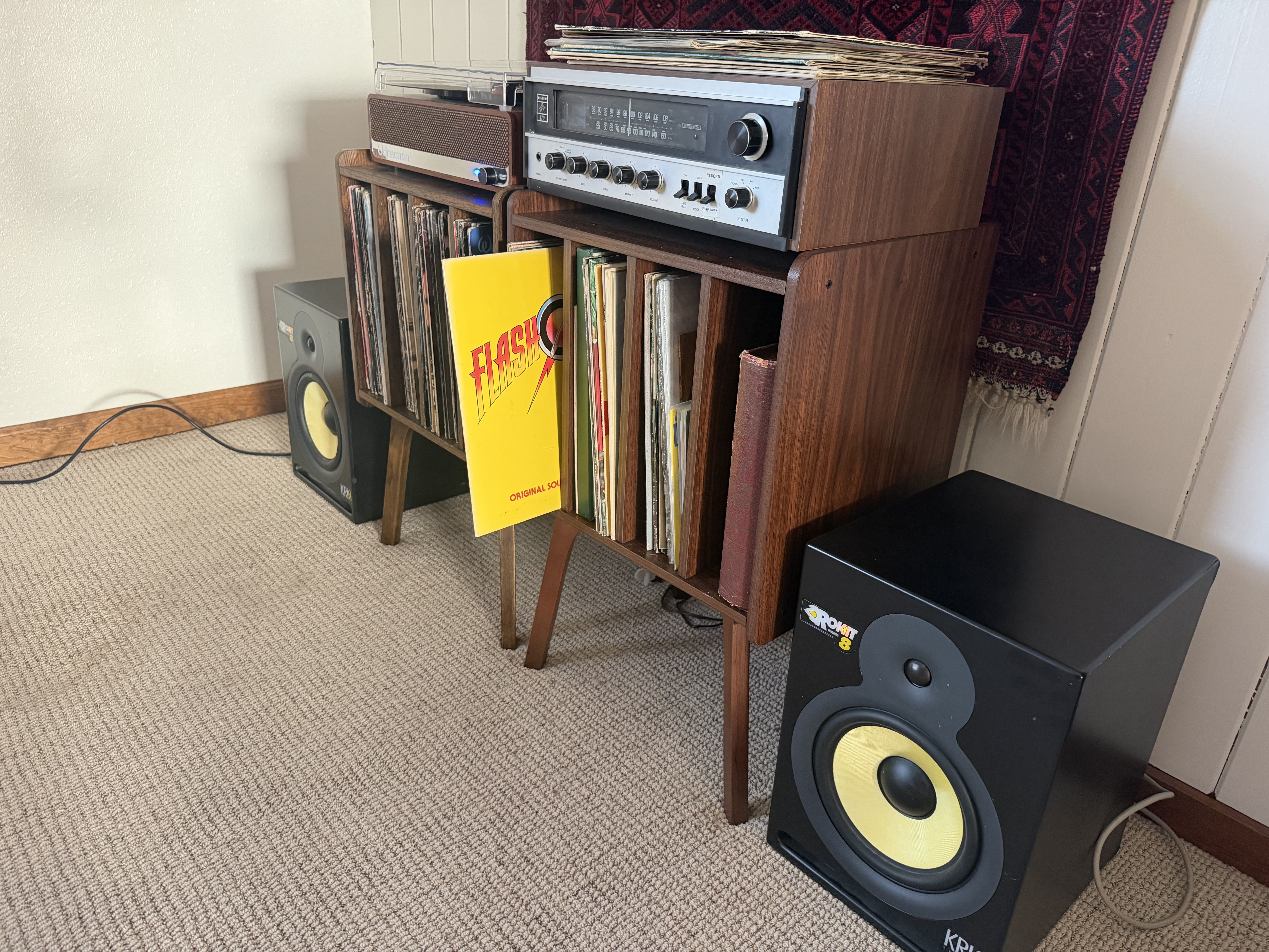

2.) The two big 8” gen1 krk studio monitors did NOT survive without damage - the 1st driver ejected itself out the front of its enclosure and the 2nd launched capacitors off the interior pcb. I fixed both and they are next to my record player set up & sound great.
Initially I wasn’t going to use them until I built some sound isolating stands but things have changed haha. Moving forward, I’m going to install a 3rd shelf which will prevent me from loading too much on any one single shelf which I am a fan of doing. Tetris & Jenga are two of my favorite games after all lol. I am also going to add a fourth steel foot + L brackets on either side/end. I really dont want to have this happen again so along with that additional shelf, a steel foot every 2 feet effectively.

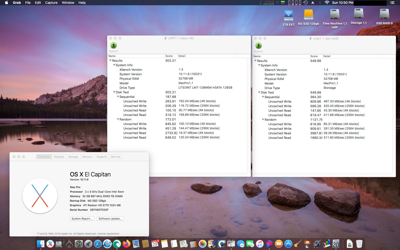

Nice, turns out the Accelsior msata is completely bootable in this cMP 1,1. Benchmarks don't beat the sw raid 0 but it is perfectly snappy regardless. I cannot tell any difference for normal DD tasks.
Ive never found great performance with Liteon, so I will keep hunting around for a Samsung, Intel, Crucial etc msata to see if I can squeak out better performance. Also, I havent gotten around to flashing the 1,1 to a 2,1 and installing the new cpus lol. I was sick last week, we're on the road for spring break this week sooo ... next week LOL.

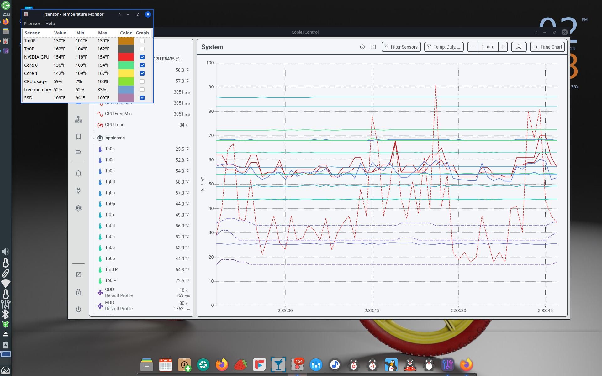

I have been fine tuning MX25 on my boy's early 2009 24" Imac 9,1. The point as spoken to earlier is to create a safe environment and employ basic Parental controls within MX25.1 due to limitations of El Cap. To this end, most recently I figured out how to create SSBs in MX using Firefox's FireSSB add-on. This works incredibly well; the only drawback being that FireSSB was built by a non-english speaker and as such their English language resources translation are .. interesting to decipher haha 😀 Still, glad they are there and the add on is great. It allows me to create standalone access to some of my younger kids (2.5 & 6.5y/o) favorite to-dos (Epic online books, PBS kids tv and games etc.) without access to a FF address bar or any browsing tools that could get them outside their guard rails and into the grown up internet.
I also picked up a cheap pair of used Logitech Logi speakers at the goodwill for $5 bucks. If there was one sore point with MX its that audio while working fine, has zero EQ, so audio can sound extremely harsh and not treat speakers well. I have fixed this with Easy Effects+PipeWire's easyeffects effect bundle that includes an excellent 32 band EQ. I noticed on not so great Jazz recordings I stream via Pithos for example that the speakers would distort badly around 571 hertz, so with this handy app+ EQ, I have easily been able to roll that back a bit and create an excellent sound and save that as an automatically loaded preset upon opening the app which I added to autostart when anyone boots with Pithos, Freetube, FF all set to leverage EE. So now the kids have some very nice sound for $5 bucks and my time figuring out a gui EQ.
Lastly, I technically havent employed this quite yet as I am unsure if I want to drive this from my router or if I want to employ it only for this computer at this time but I think I have settled on OpenDNS FamilyShield which is a modifiable but designed to be highly plug and play DNS filter to keep my kids from malicious and adult content (especially my oldest 8.75 y/o who has limited browsing access for school) and for my own ease sacrificing less time investment in set up and management. Anyways, I need to think a bit more on how exactly I want to employ this but will get on with it next week I think once I decide on next steps.

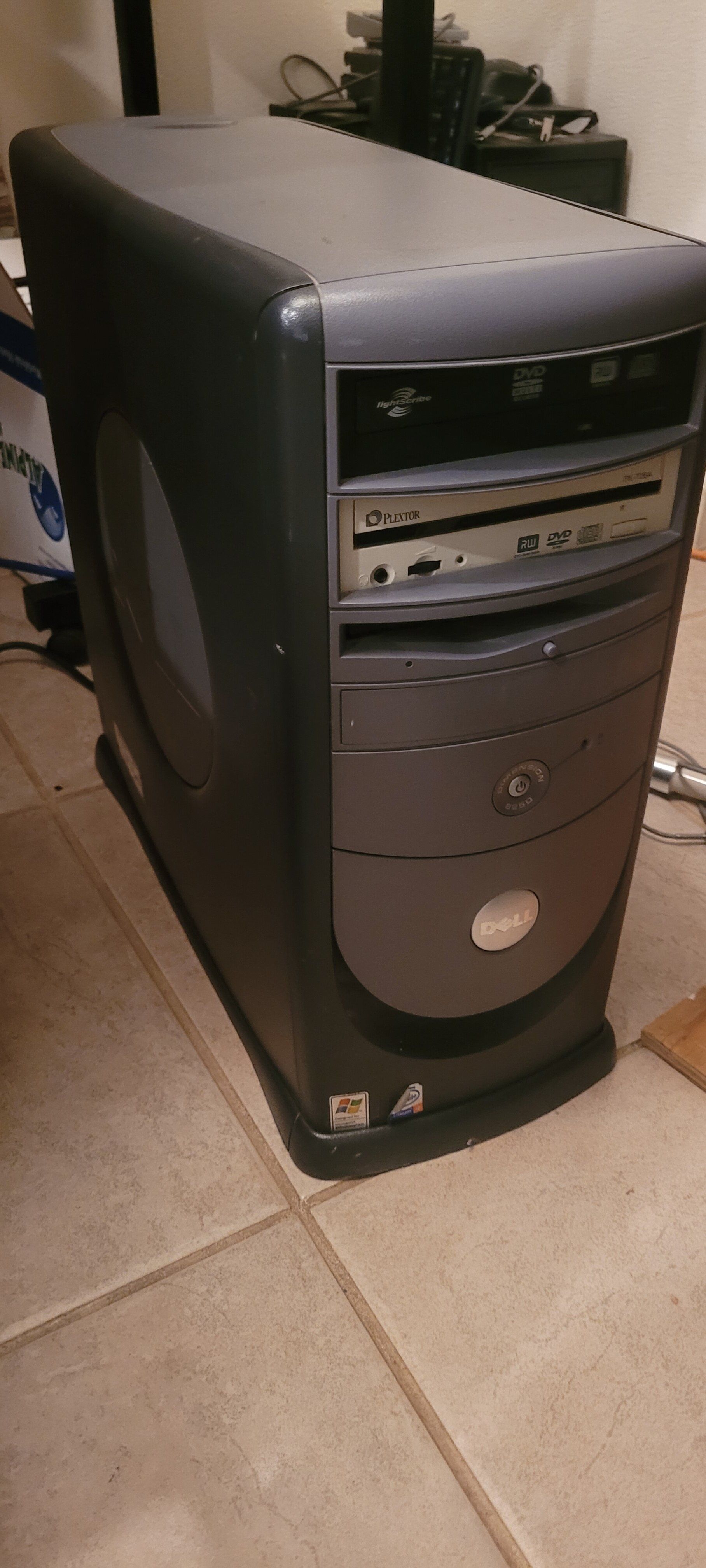

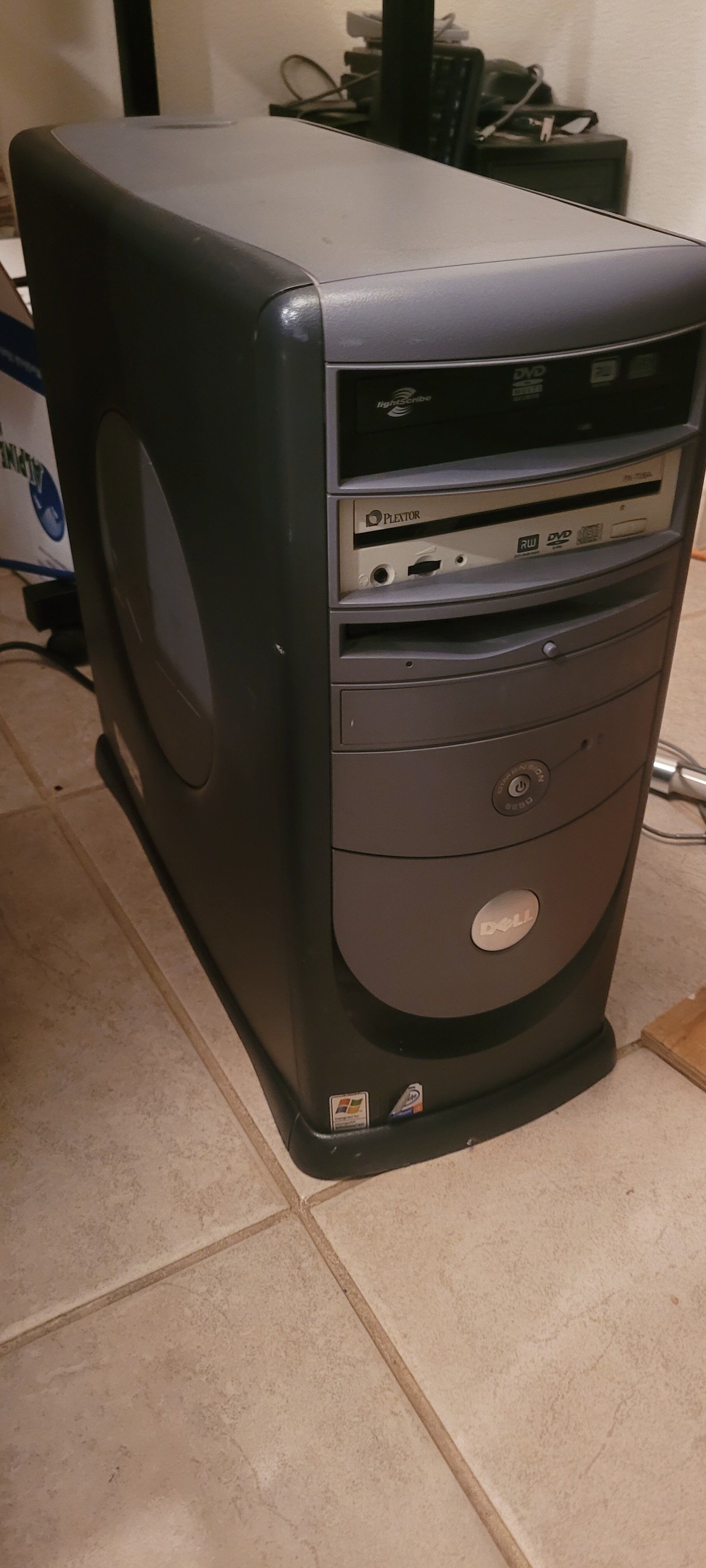

Got myself a Dell Dimension 8250 2 days ago and got Windows XP reinstalled. Then Out of all the crazy things after getting past the register your XP thingimadoodle, I installed... Can you guess? Probably not. Lego Island... Yeah I know. CRAZY! As a plus it does have a Pentium 4. Such a cool name compared to the Intel Core that has lasted to me about 16 years already. There is no info on the WWW for anything related to this except for Dell's datasheet. I would have thought there would have been a little bit but not that little!

Hey you got my old work computer circa 2003-2004ish :) Technically it wasn't mine per se but I was on it everyday. I did twist IT's arm to up the ram on it to 512mb which at the time iirc had 128mb. I asked for 1gb but got the 512 which was still better than nothing. I later learned that these came with RDRAM instead of what I had assumed was PC133 SD.

Oh, you've got the fancy base for it! I just passed on a Dimension 3200, kinda wish I'd have kept it, but I already have a better Pentium 4 build, just needs a good GPU.
