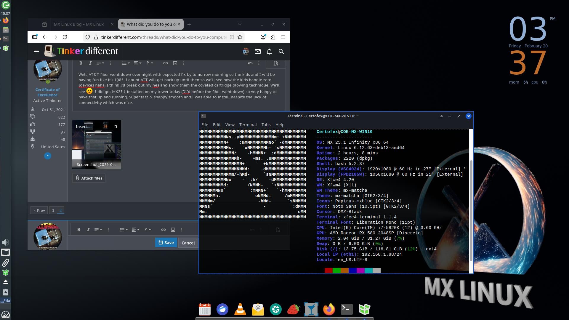

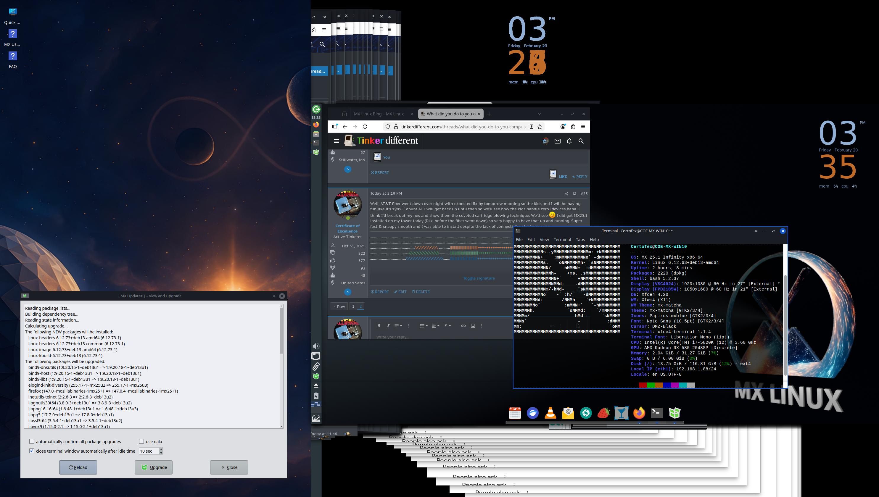

Well, AT&T fiber went down over night with expected fix by tomorrow morning so the kids and I will be having fun like it’s 1985. I doubt ATT will get back up until then so we’ll see how the kids handle zero Idevices haha. I think I’ll break out my nes and show them the coveted cartridge blowing technique. We’ll see :) I did get MX25.1 installed on my tower today (DL’d before the fiber went down) so very happy to have that up and running. Super fast & snappy smooth and I was able to install despite the lack of connectivity which was nice.
*Update
Just realized that neofetch has been deprecated and now replaced with fastfetch lol. Super snappy on this box. Also ATT got it done and service has returned as of about an hour ago + they are going to credit my account for the loss in service. Happy all things considered and ITS FRIDAY :)
Have a great weekend everybody!

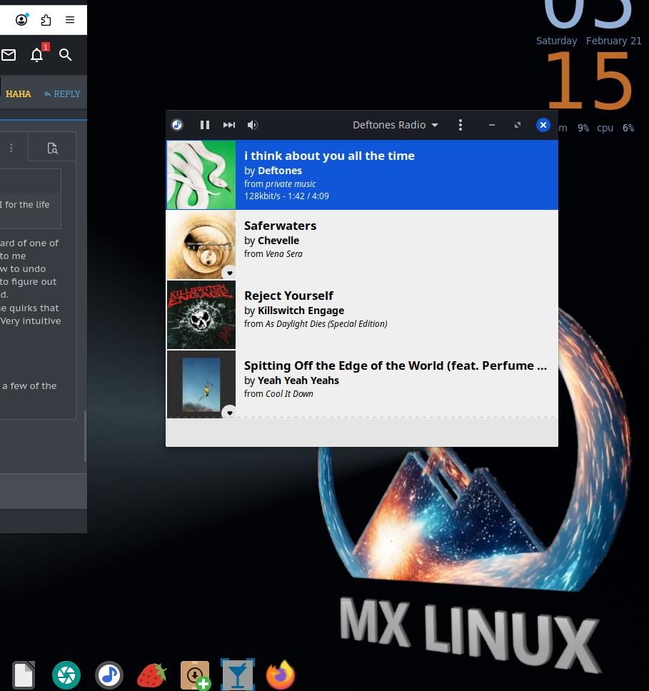

Today was mostly bike maintenance before and after a downhill ride I had with my boys and a few of the neighborhood kids and one other dad. I did get to downloading & installing Pithos Pandora player.
Crushing sound through some ancient Cambridge soundworks "Surround Station" PC speakers I think my Dad originally bought in the late 90s and I later inherited when he upgraded to something else. These are really great speakers even after all these years.

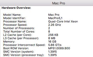

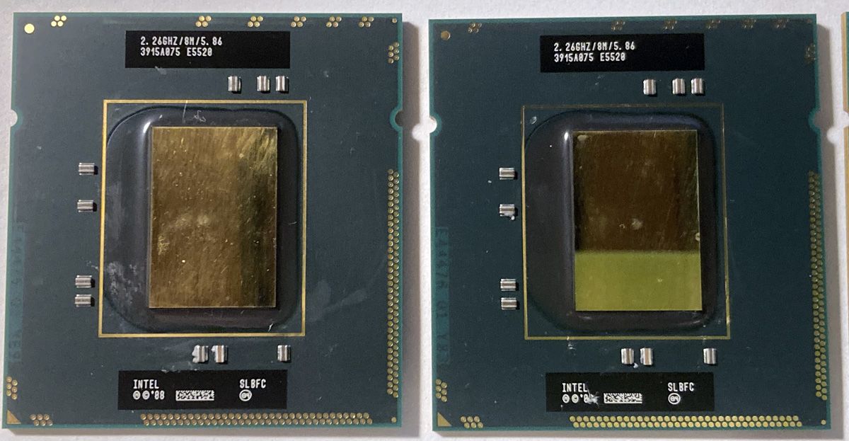

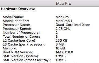

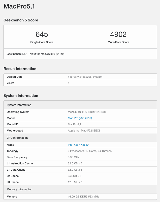

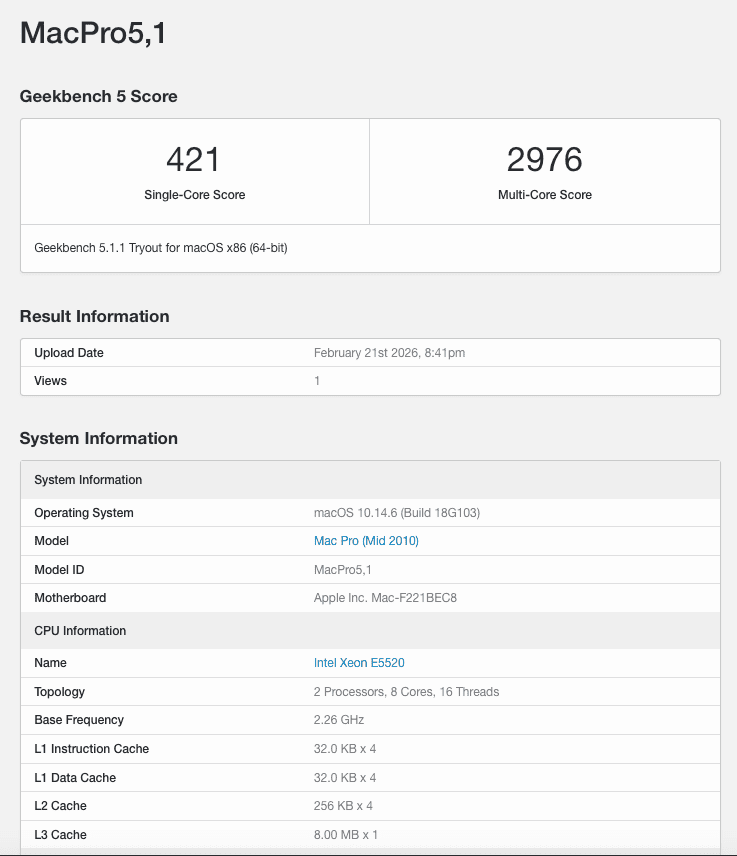

Today I worked on a dual CPU MacPro4,1 and did the firmware upgrade to 5,1. Quite the process now.
Started with El Capitan, and followed this guide to get it done (then another update through High Sierra). Had to swap out my HD 5770 original GPU for a Quadro K4200 (I only had a single power cable available but 5 more on order now) to get the Mojave installer to work (Metal required for final 144.0.0.0.0 update).
Original Quad core dual 2.2GHz

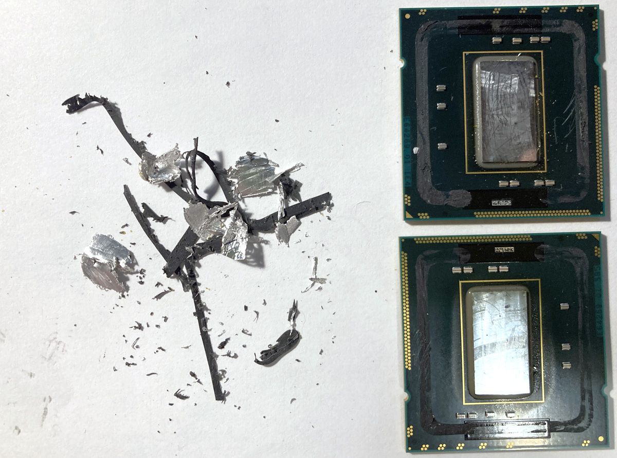

Once I get the Firmware up to 144.0.0.0.0, then I can run OCLP and lots of versions of MacOS. I purchased two X5680 Xeon 3.3GHz CPUs and delided them with a vice. That should make a nice improvement in speed.
Dual Quad score in GB5
Dual Hex score in GB5
I picked up a lidded pair of 3.0ghz x5365 xeons last summer for like $5 bucks lol that I need to delid to bring my qc 1,1 to 8 cores. LOL They're sitting on my tool rack in my garage (still in their box) next to my bench - been there all winter. Hoping to get to that project soon. Then I'll upgrade that cMP to dual boot MX 25.1 & elcap.

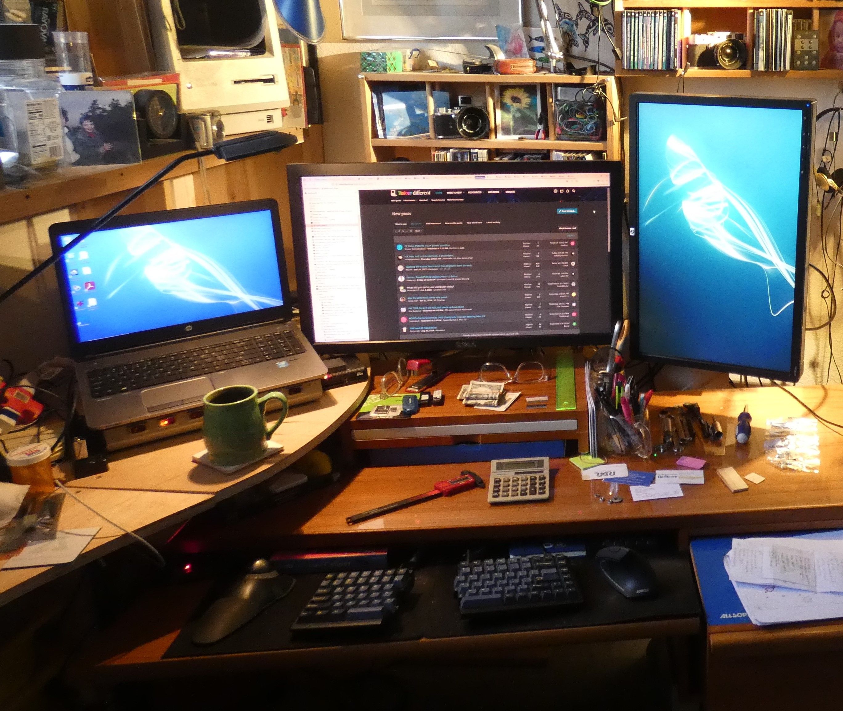

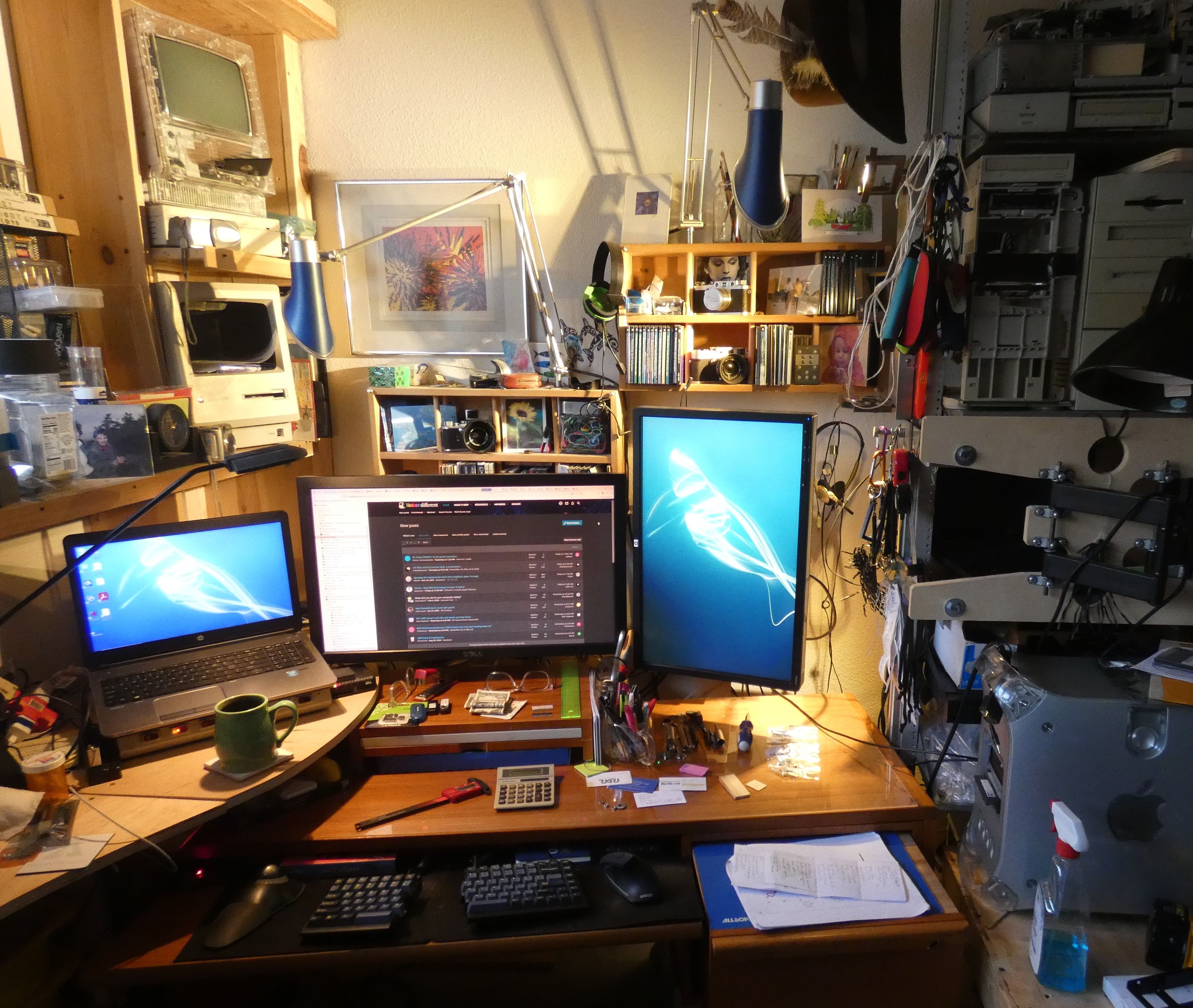

Not specifically on any individual computer, but I finally got the 1440p Display up on a flexible wall mount so it's centered comfortably in front of my Mouse/KBD/TrackBall setup. I can now roll the desk out to get at what will be storage beside and behind it. Now I only need to yank the Power/USB cables off the Hub on the desk to roll it around!
Now that the main screen is far enough from the TelCo Rack on the other side of the 1920x1200 portrait panel I can reposition and rotate that one to landscape mode on its own flexible wall mount. That way I can use it as a second screen when I flip the KVM switch over to the MDD/FW400. PITA that I've yet to find a way to do Portrait Mode under OS9. 😒
Next to get the HP ProBook Dock onto a platform on yet a third wall mount so I can swing everything around to my hearts content. Still working on setting up that PPC Challenged MDD/FW400. One day I may get this all sorted out, maybe for Marchintosh?
1,540
498
Glad that word salad was clear enough to like, mate! Straightened up just enough for the pics:
Don't mind the 20mm Ultrawide distortion, was trying to get far enough back for a pic small enough to post full size. GraphicConverter is offline ATM. Trackball kept me on computer whilst in rotator cuff sling for seven weeks up to New Year's Eve and still find it useful. Mouse pad area was half as wide with main screen still off center before yesterday.
Overview shot: second ProBook/Dock/Ubuntu workstation is behind the big "I" shaped plywood of the modified pivoting wall mount on rack. Defaulting to the main and portrait screens with blank native panel.
G4/OS9 graphics workstation is the bottom shelf of rack. Now there's room enough the portrait can be rotated as horizontal second screen until I can figure out how to do get it set up under OS9. It was almost touching the rack in portrait mode before yesterday.
Should I do a dedicated topic on setup's many crazy features? That's still a long ways off. For now I think this qualifies as what I did with my computer(s) :)

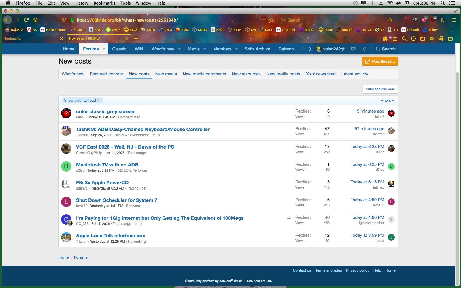

Got Wi-Fi on the Mac Pro, finally. Yes, I know that I'm showing a screenshot of the other forum site. Had to use a couple Nikon Nikkormat FT series shutter mounting screws to mount the Airport Extreme card to the logic board. All of my Apple screws were too big, or coarse thread. So, there are a couple brass slotted Nikon screws inside the machine.

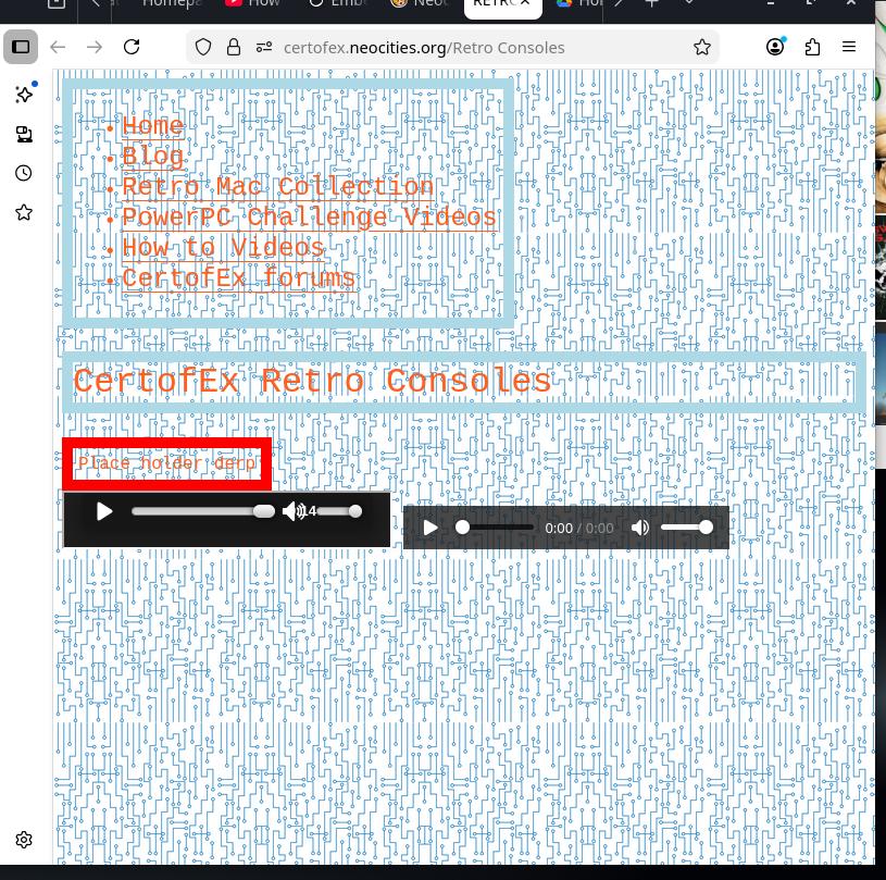

So over the past few days I have been trying to to figure out how to embed a macintosh chime mp3 montage I made. The file itself was tiny as far as audio files go - maybe 400k? Making it took all of maybe 5 minutes? - easily accomplished with free Clideo audio merger. Within those 5 minutes, I stitched together a collage of bongs and saved to multiple formats (mp3, mp4, ogg etc) onto my macbook.
Then I hit a roadblock. Neocities supports direct audio upload for paying customers. Hmm my account is a static free one ... well I'm not paying $5 a month for the priviledge of puting mac chimes on my website. Call me cheap, whatever - That's stupid LOL so Im not doing it. SO with that I set forth trying to figure out how I could get sounds hosted elsewhere onto my website. I figured I was going to be using <audio> or <iframes> to accomplish this which I was ultimately correct after ALOT of being wrong. I have accounts at bandcamp, soundcloud, youtoobies etc. and while those were easy to upload to, to get a link that would properly embed wasn't possible ... I mean maybe it is but at least I couldnt figure it out with the low-tier account I had lol. I then thought about my google drive which I never use, so figured Id give that a shot and get some use out of it. I researched a number of purported solutions that were within the 2020s using html <audio> and manually creating an embeded link (similar to what I did for the YT shorts vid) but for the life of me I could not get it to play. I could get the player on there - no problem, but no dice on playing the file. I tried a number of sources, file types etc. but same result. That was yesterday. I cut my losses and onto getting my older two kids off the bus and scooping my 2y/o from daycare.
Today I have success ... kinda. I mean, I call it success. Is it exactly what I envisioned? No, not exactly but I'll take it for now and it isn't costing me anything either nor should it. Instead of using html <audio>, I am using the raw embed file off google drive and dropping that into <iframes> and then manually adjusting down its size. I can't make it blue like my site as I intended to ... at least I don't understand how I could do that yet (maybe in the future) but I have a functioning play button! YAY lol :D Below you can see me testing on my "under construction retro console page". The player on the right is <audio> which is broken and the player on the left is 100x50px <iframes> and it plays just fine. Do I like the look of <audio> better? Yes. Do I understand how to adjust its look better. Yes. but its broken so there's that part haha. I'll take the <iframes> win for now.
Retro Consoles (Under Construction)
Senior Tinkerer
1,005
703

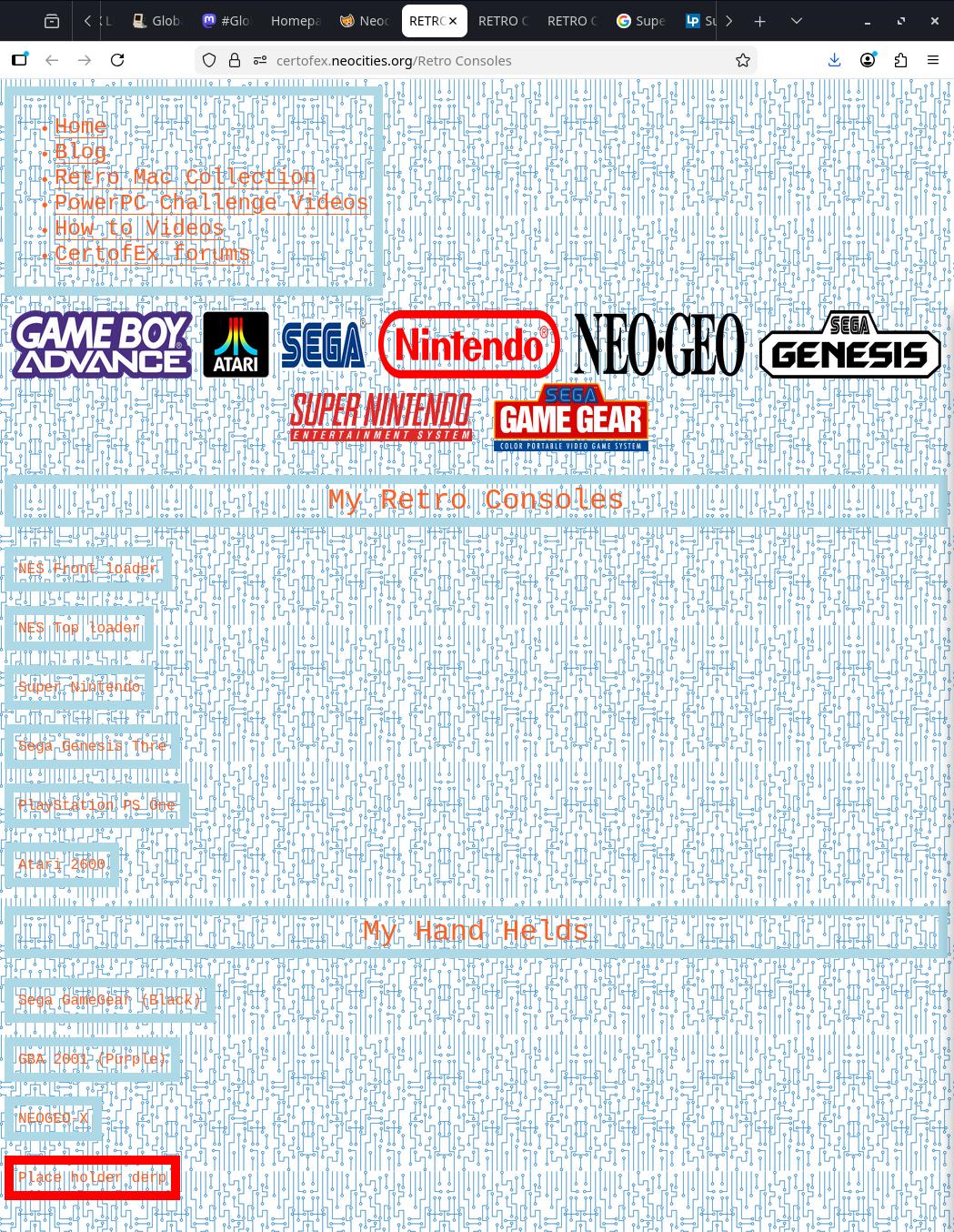

I worked on placing my mac chime montage on my landing page and updated some of the page names & added a MX logo at the bottom although I just realized I did not make the back ground transparent - oops LOL. I also started working on my retro console/hand held page with organizational improvements and some fun jpg, png and svg logos. I have a few more logos I want to hunt down but everything is coming together nicely. Dunno if I will take the time to take actual pictures of my consoles - maybe later or better yet, maybe my favorite games on said consoles. That could be a fun project with my DSLRs or maybe the other way around with some of my late 90s Sony Cybershot/Mavica cameras ... or out of convenience, maybe screenshots in emulation on my boys imac. I've got a bunch of retro emulators on their imac so they can play all the mario/sonic/Zelda/cool retro titles out there without raiding my office for actual cart/sys game play.
On a separate note, my middle kiddo over extended one of my measures and broke the spring inside so I repaired that and made a quick video on it with everything apart. Figured that could help someone else who didnt want to spend 30 bucks on a new quality measure when they can pretty easily fix the one they already had for the past 20 er 30 years. :D
