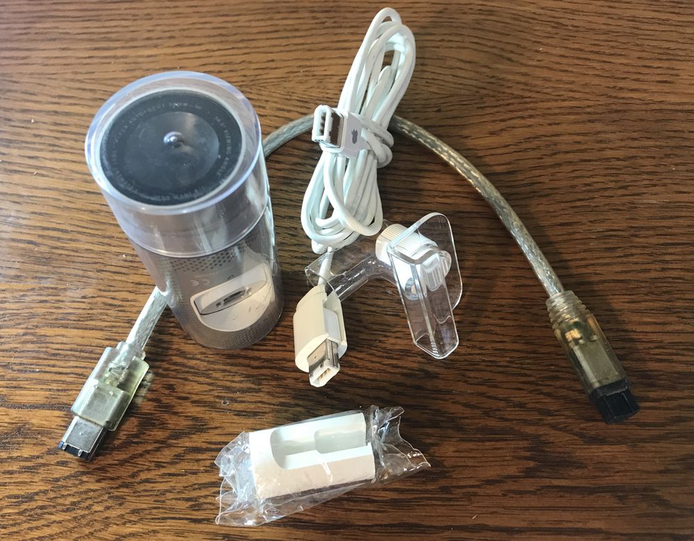

iSight FireWire, listed as untested, works fine at home, $5 (iChat would not open the camera on PPC, but my FW800->FW400 cable worked on my iMac12,2).

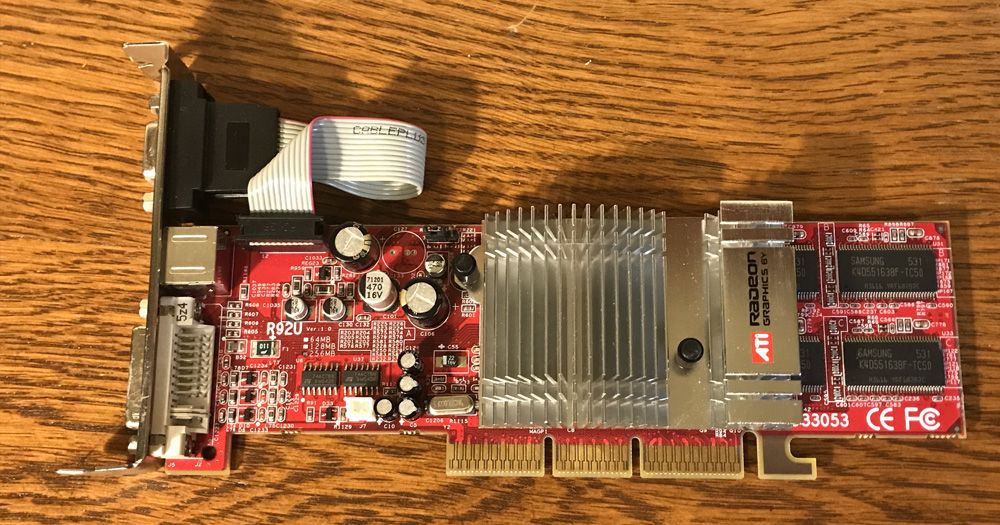

Found a Radeon 7000 that I hope to eventually flash for the Sawtooth, something look off to you?
Yeah, they bent the bracket... but for $5, I will give it a shot.

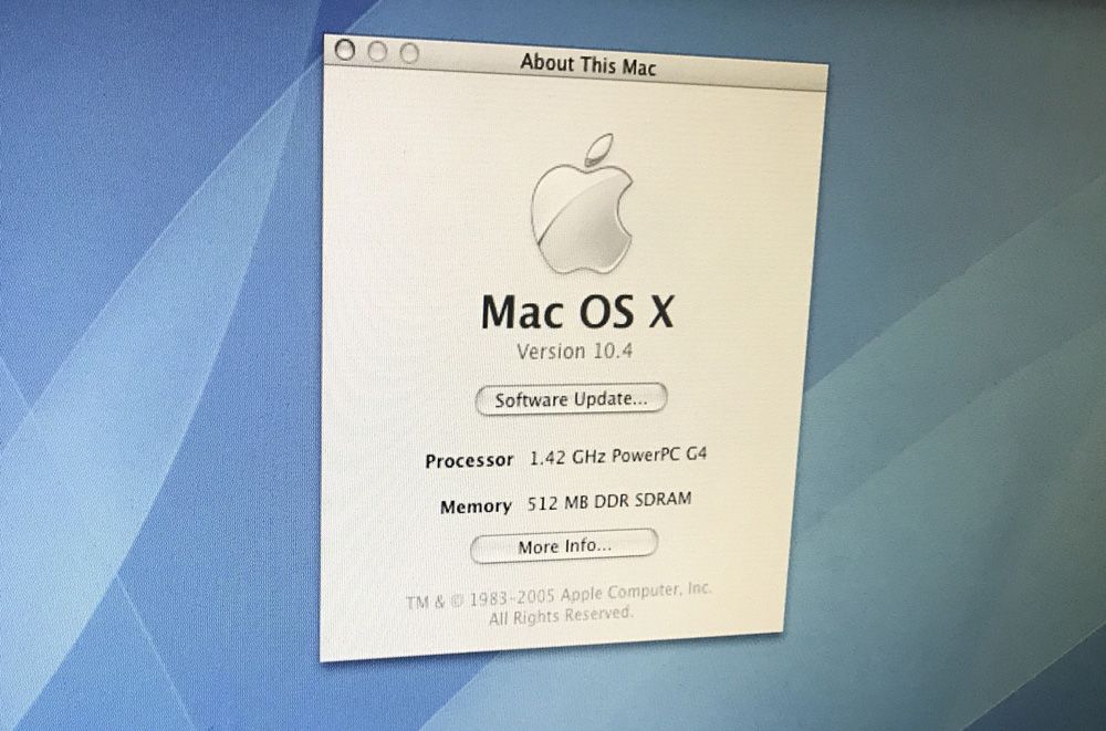

Grabbed a couple legacy PhoneTalk adapters ($0.50@), a couple USB->Ethernet adapters ($4@), another original AirPort card ($1), and this beauty Mac Mini PPC 1.42GHz for $15.
I have one more 120GB mSATA SSD and an IDE-mSATA adapter, so I will upgrade this to solid state and run some more benchmarks. This is now my fastest PPC until I can revive the Dual G5 2.5GHz.

Nice pickups. I scooped a boxed iSight off goodwill a few years ago but it was missing its cable which I did not notice in the auction. I had a thinner fw400 cable I was able to squeeze in so it does work but glad to see yours came with the exact cable.

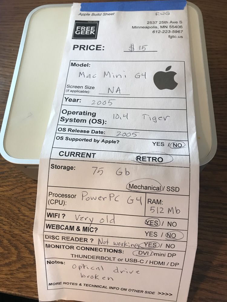

For $15, I'm not complaining! I would jump on a PPC Mac Mini for that price. It's a bummer that the optical drive is malfunctioning according to the attached notes.

Yes, the optical drive was faulty. Luckily I had another laying around. I swapped out the spinner drive for solid state, replaced the optical drive, and upgraded it to 1GB of RAM. I could overclock it with the resistors on the bottom of the motherboard, but its not worth it right now.

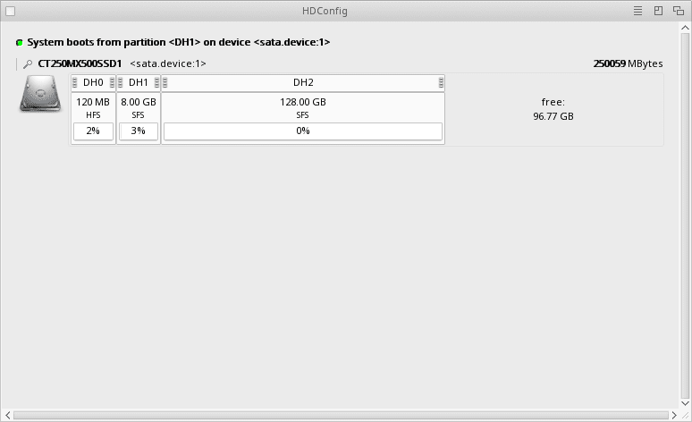

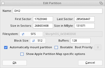

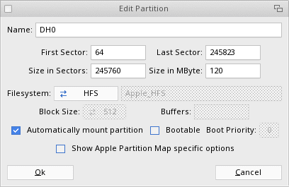

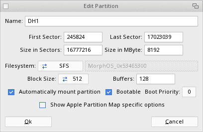

Try using bootable iPartition #4.
MorphOS requires 3 partitions, I kept a cheat sheet in the form of several screenshots to manually partition the disk.
Try it, it should work out.
I can get the partitions created, but the iWizzard does not allow me to change anything on the partitions... I try to change the flags, and hit save, and everything reverts back. I guess I can wipe the whole drive and try MorphOS only, then shrink it and put Tiger and Leopard back on later.
