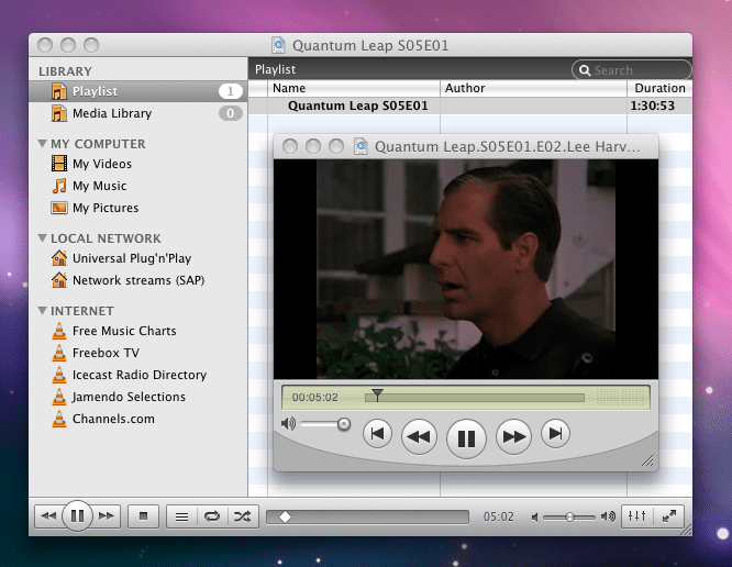

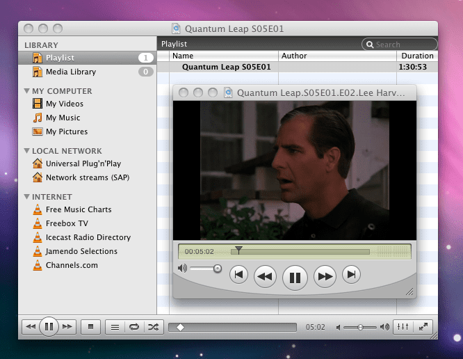

Long day at work, 100 mile commute, so not a lot of time to play tonight. Lets try to relax. I have some .avi files, wondering if VLC for ppc will play them.
Installed VLC 0.9.10 on 10.4 but they would not play. It may be due to the Rage128 Pro graphics card? Now that my Sawtooth is a Dual-500MHz G4, I cloned the 1GHz FP 10.5 installation over to my Sawtooth using my handy Rugged LaCie drive. It has dual 800 FW and a USB3 port. Great for moving legacy stuff as well as FW800 on mid 2010 iMacs and USB3 to anything else newer without a FireWire port.
Got 10.5.8 running, did some system updates, installed newer VLC 2.0.10, and 3IVX codec. Video will play in QuickTime with no sound, .avi files play sound in VLC with no video. Both at once? QT playing the video and VLC playing the audio... I get about 1 frame every 2-3 seconds. Not watchable.
Maybe I won't relax watching some old .avi files....
Phungus, for AVI files, give one of these a shot.
