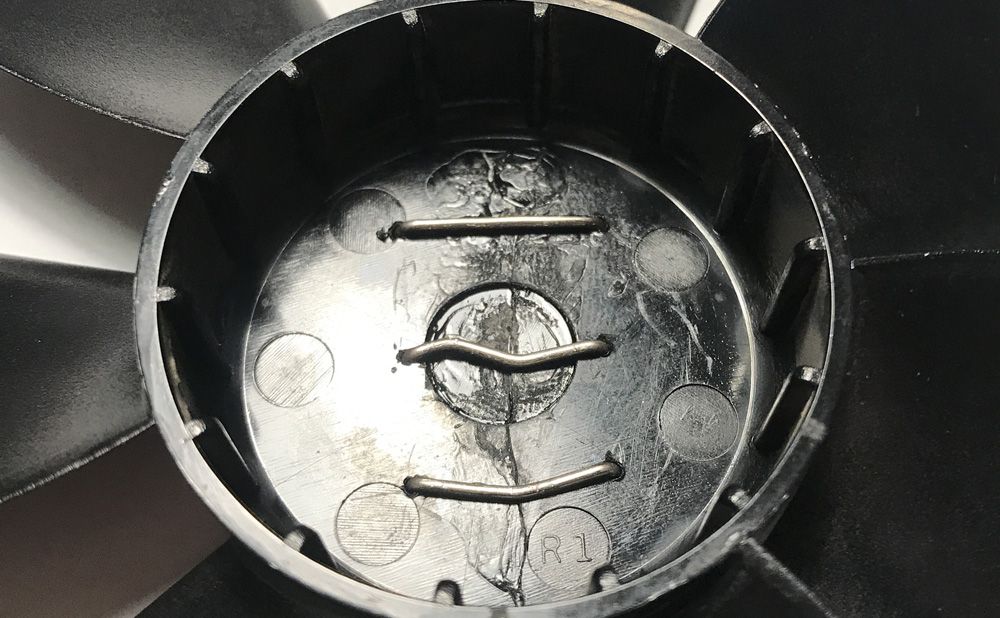

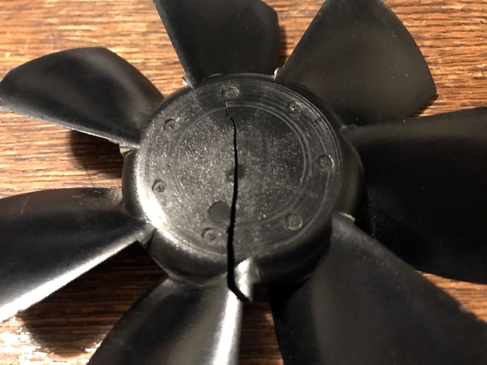

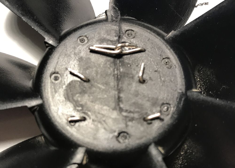

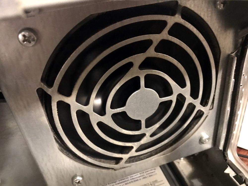

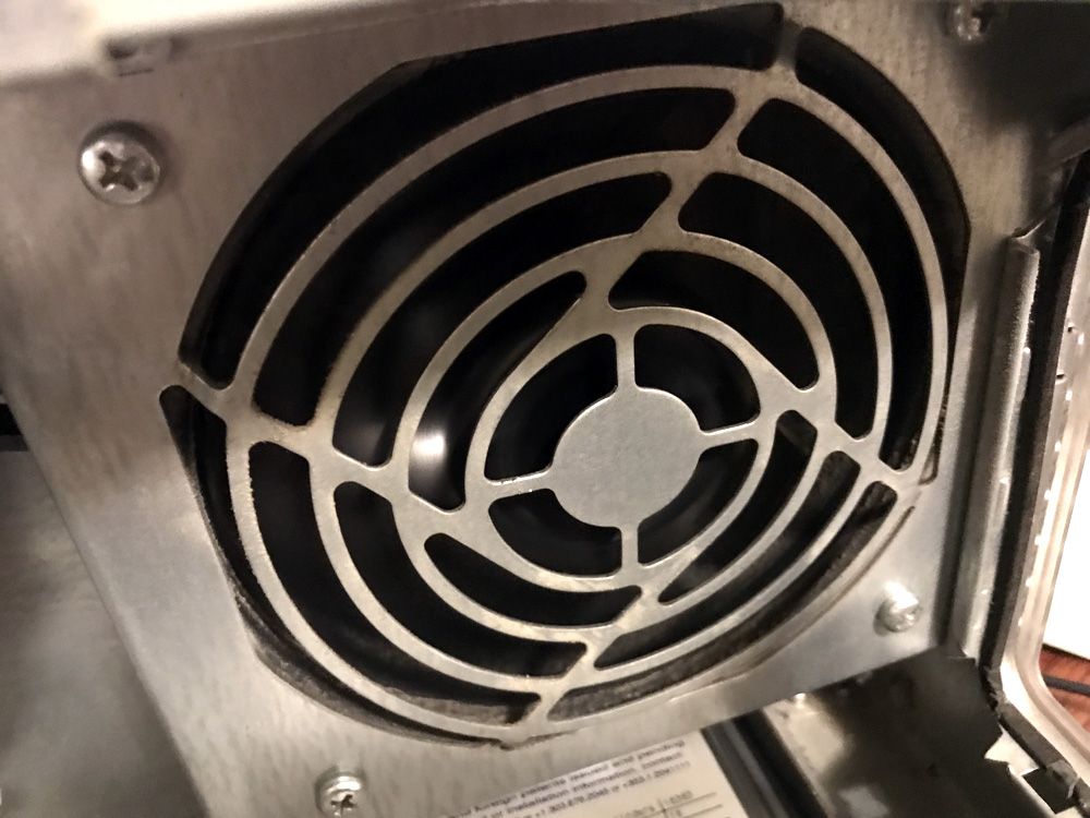

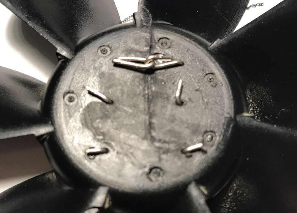

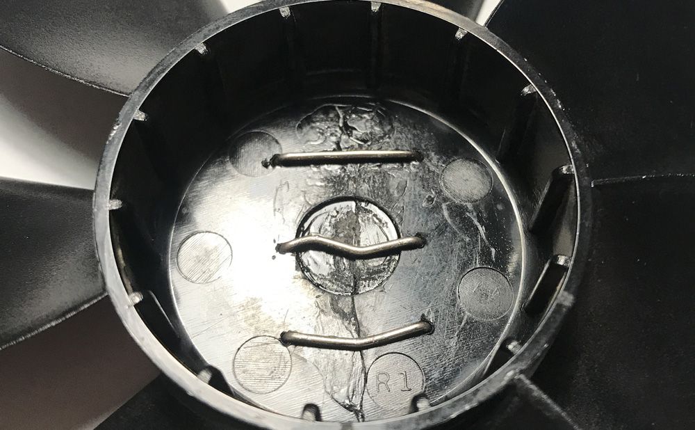

The Noisy Fan Issue
I initially thought the cage was just dented in, so I pulled it out a little to give some room. That solved it for a short time and it started rubbing again.
After disassembly, i discovered the fan is actually cracked pretty bad. The motor is intact and functioning properly, but the fan can't hold onto the motor.
Tried crazy glue, which I am never fond of... didn't hold. Its a harder plastic, so maybe epoxy, but I don't have any laying around. Thought of maybe using the soldering iron to melt it back together. Instead, I drilled a few holes and used a paperclip to tie it back together. Holding fine so far.

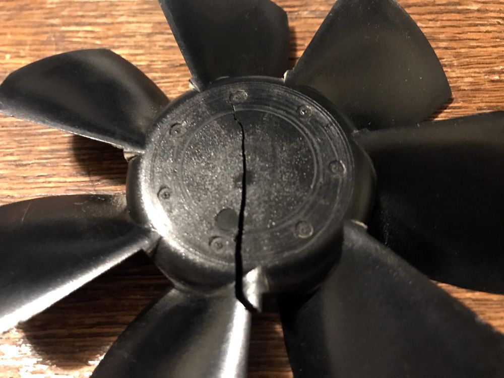

The Noisy Fan Issue
Nice fix. I had the same issue albeit a smaller crack more along the top edge and I used epoxy to secure it. That was about 4 years ago. I was worried about it being off balance but the repair really didnt impact the balance of the fan at all.
Its a noisy as any of my others LOL :)

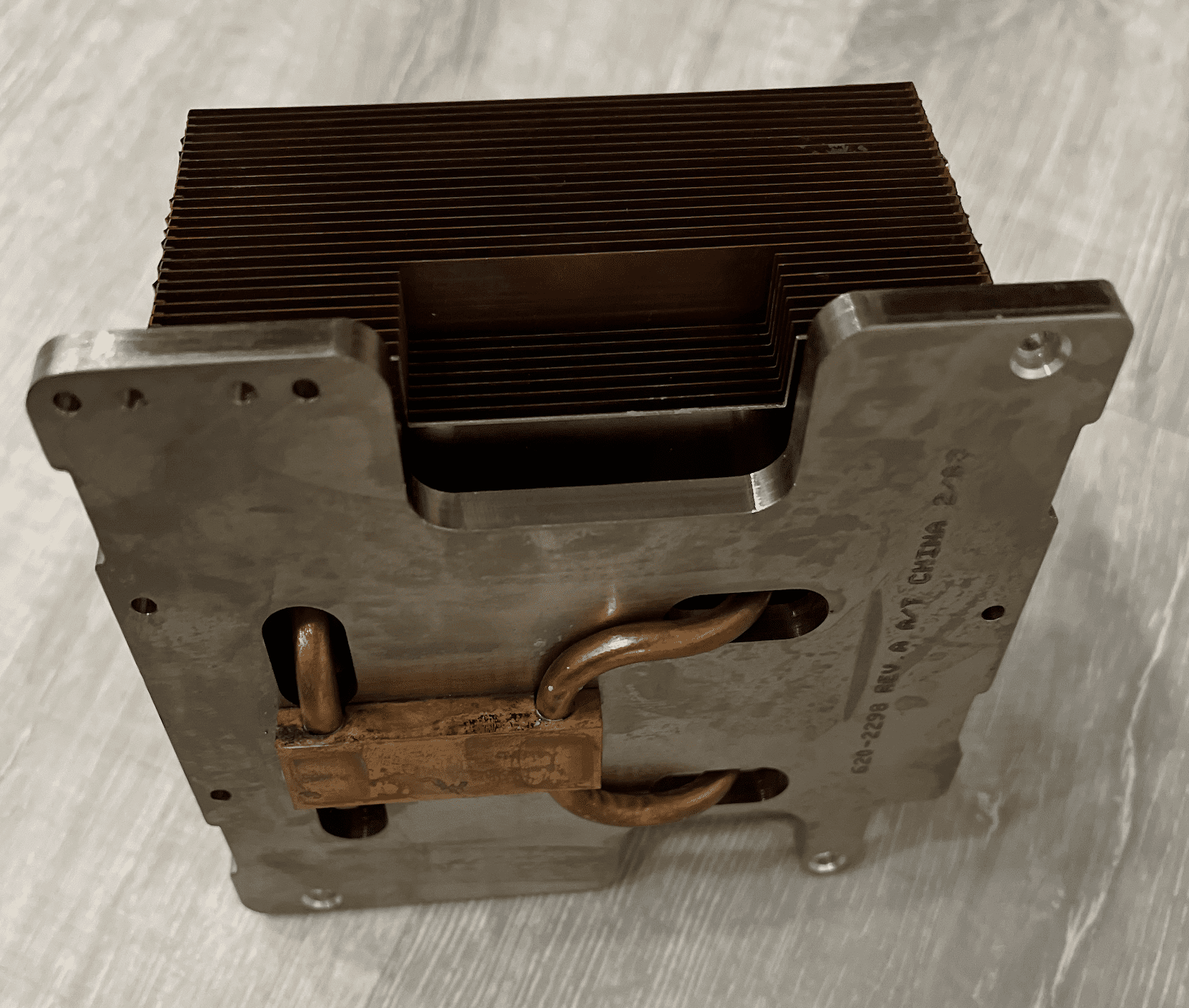

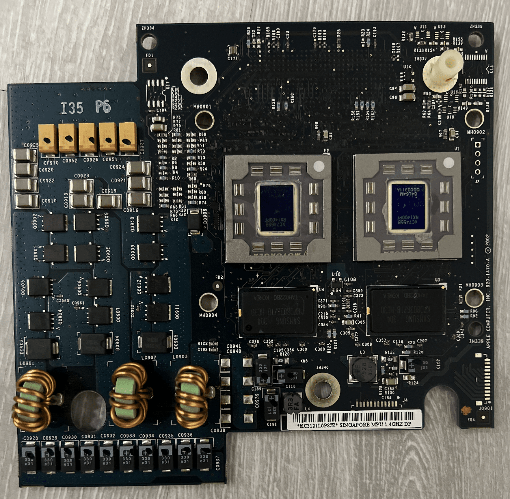

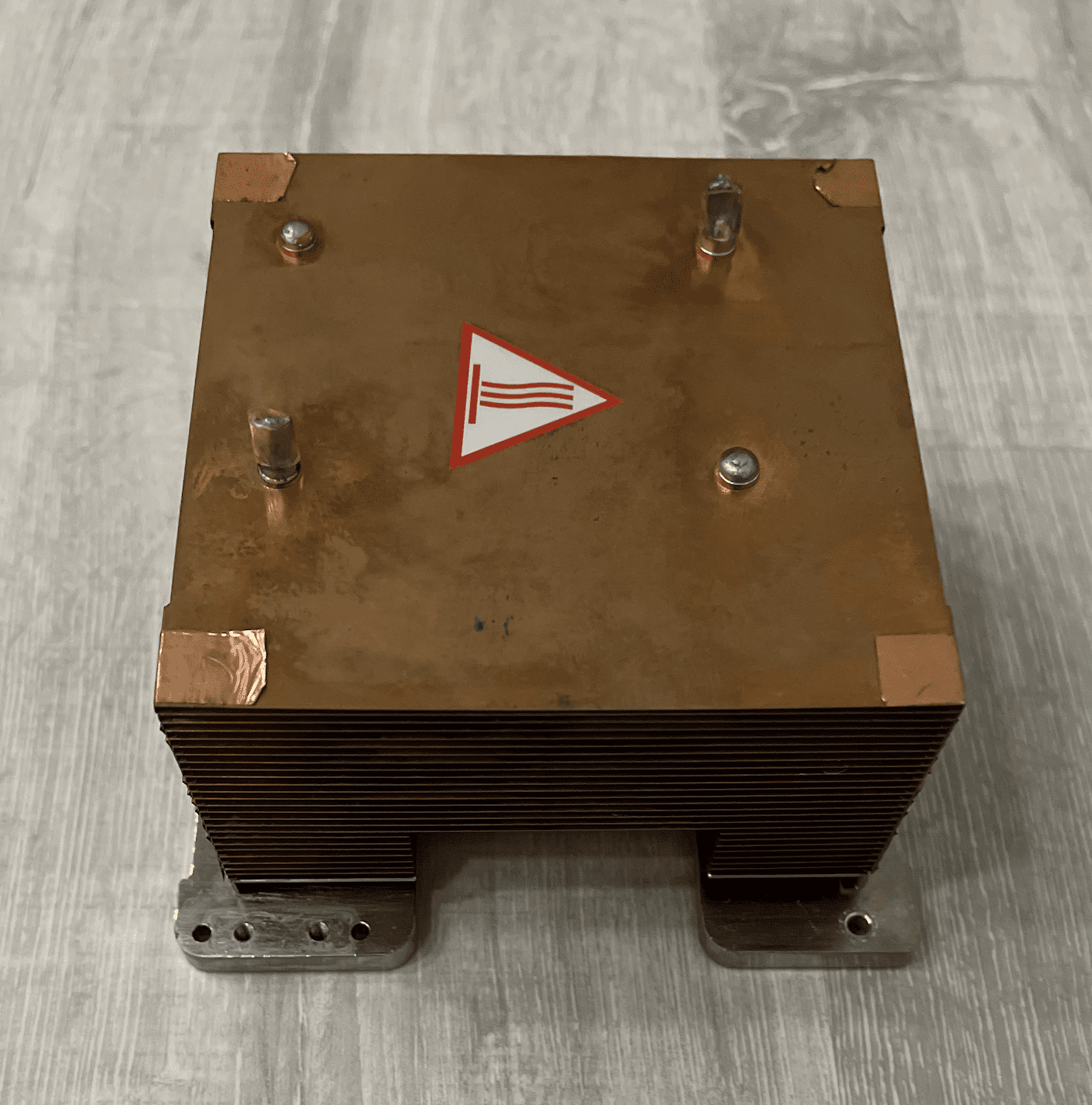

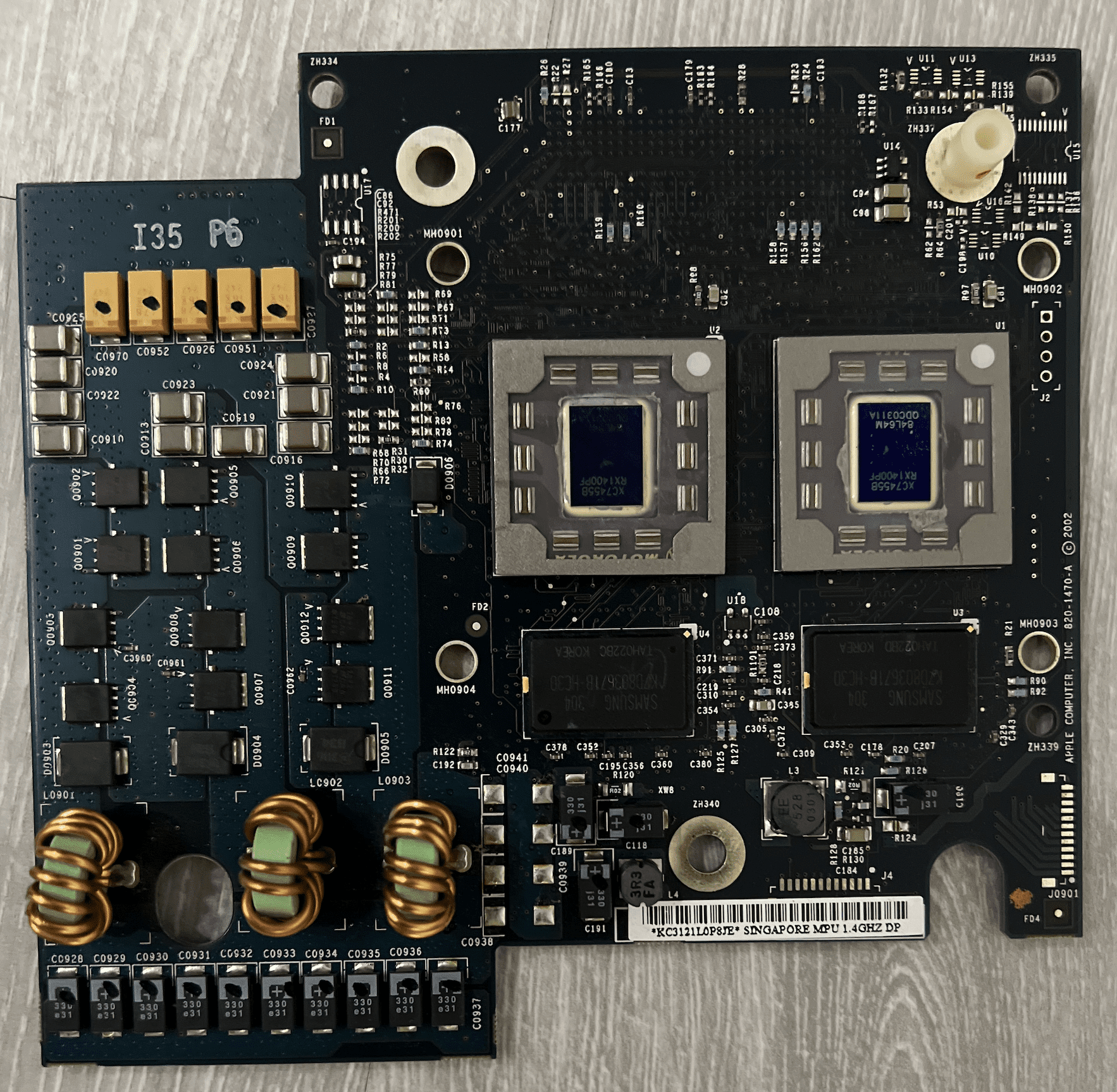

Today is a great day -- I received a package with new toys!

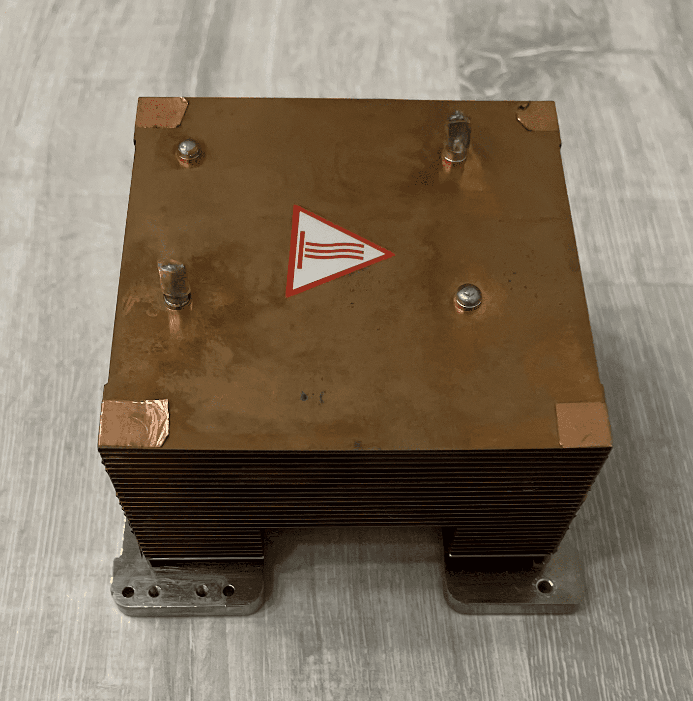

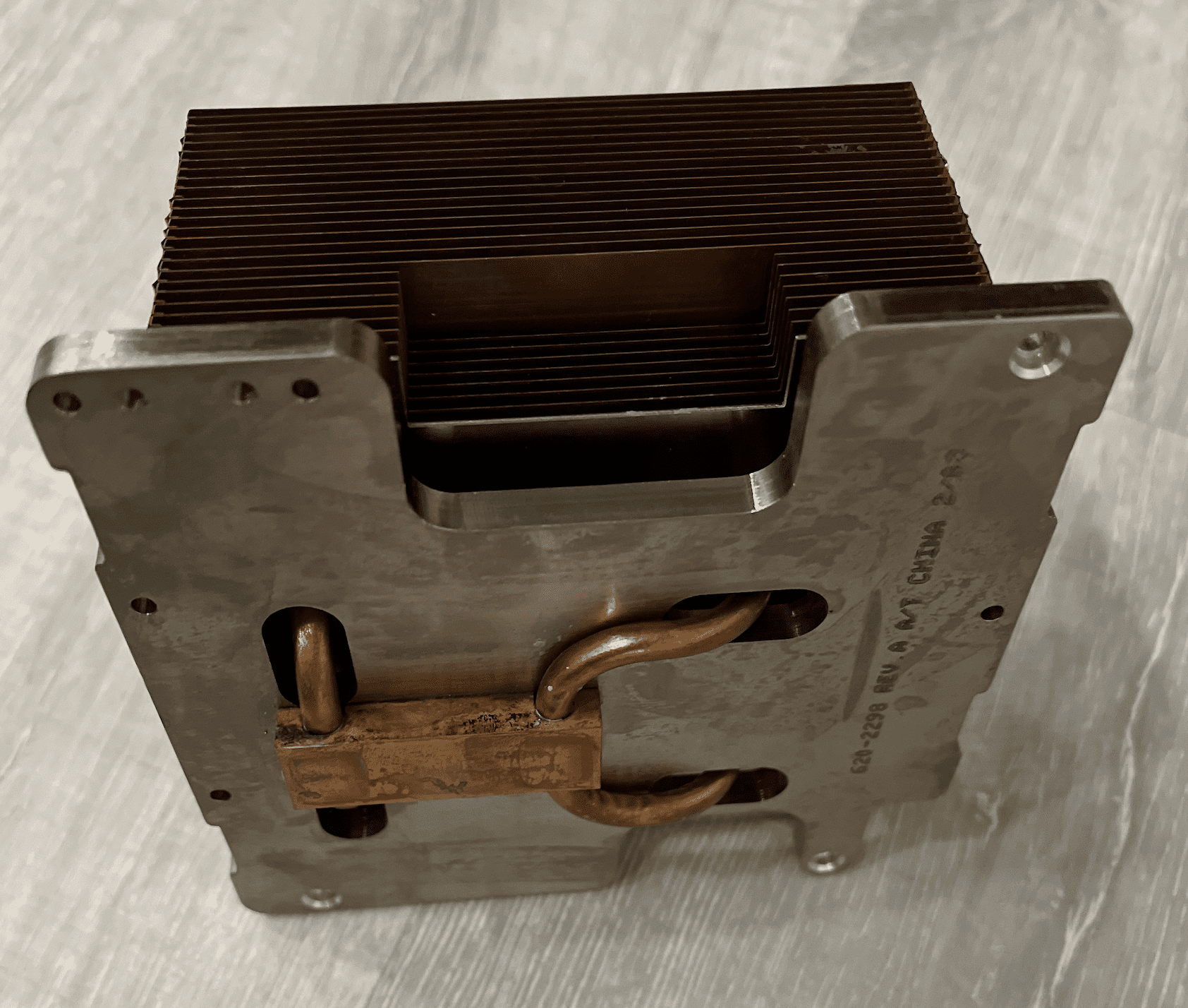

G4 DP 1.42 Ghz processor and copper heatsink from FW800. This will be installed in FW400 (2003) to get a powerful machine on OS9.
I've never had these copper radiators before, and I thought it was just a piece of copper, as it usually happens. But here are the pipes. What's there? Some kind of inert gas? :unsure:
View attachment 14638View attachment 14639View attachment 14640

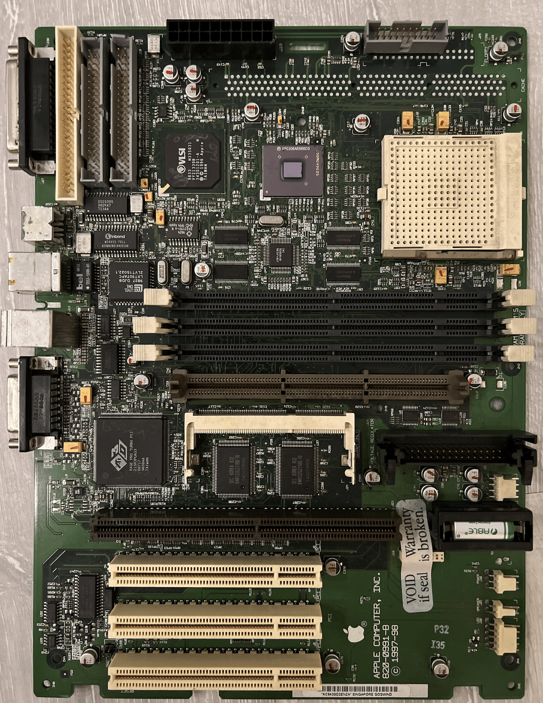

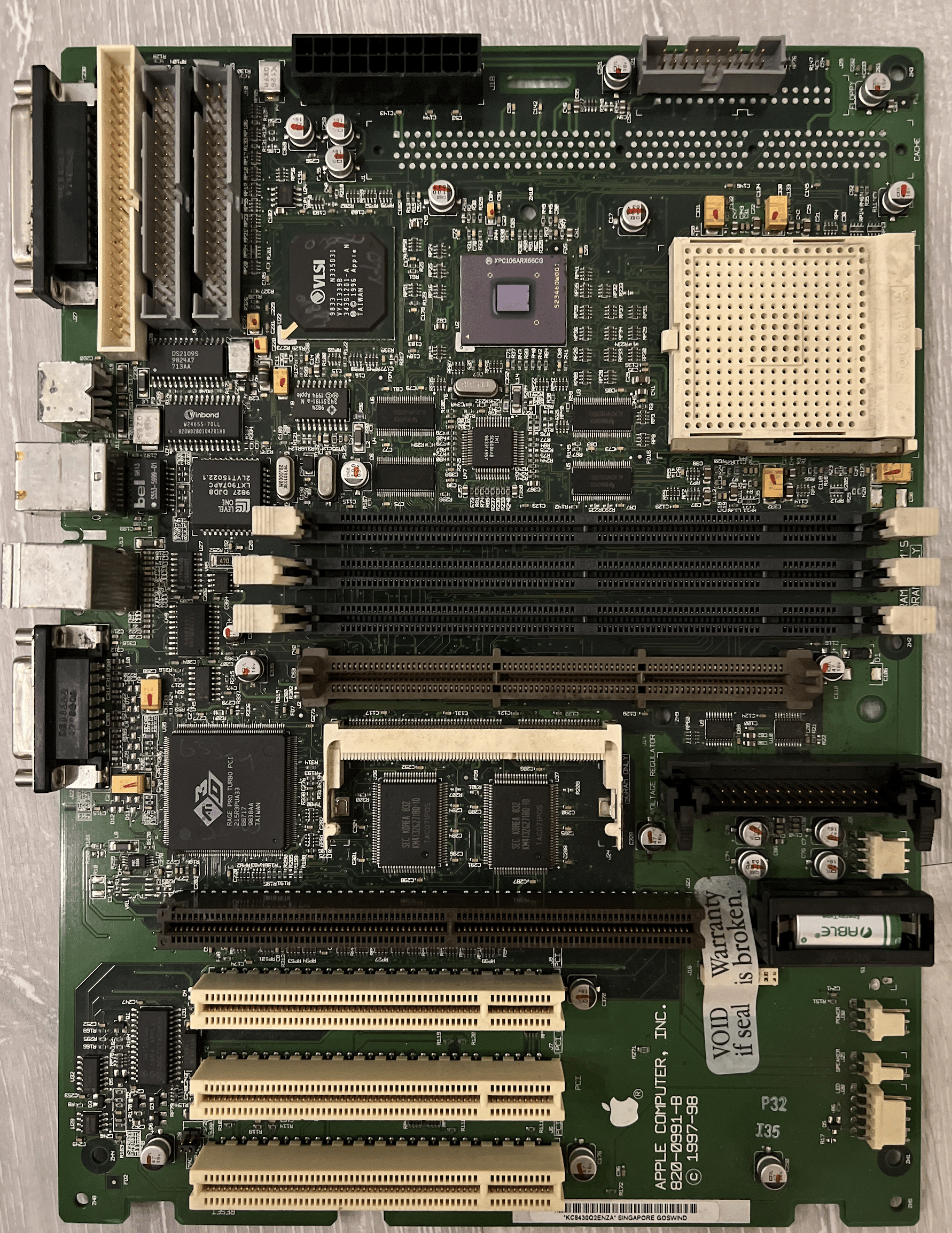

I also now have a new motherboard from G3 Minitower. It seems to be Rev.C.
View attachment 14641View attachment 14642
This motherboard is very dirty, the hands get dirty after touching. Compressed air cannot cope with these contaminants, it seems that it needs to be washed.
How do you clean dirty boards? Do you wash in regular water or do you need distilled water? :unsure: Please, share your experience.
Use the highest concentrate of isopropyl alcohol that you can get, like 91%. You can use a toothbrush lightly as well. Then give it plenty of time to dry thoroughly.
