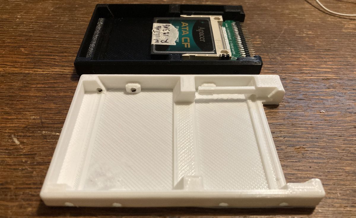

I installed the lower frame into the plastic bottom chassis, and installed the motherboard. I mounted the screen, and as I was about to install the CF-IDE adapter, I noticed the holes were off. The PowerBook 190 and 5300 have used some older drives with different mounting holes. I adjusted my 3D model and I am printing a new carrier for the CF adapter now.

My CF-IDE carrier finished, I installed it into the drive carrier in the PB190cs. Assembled the rest, epoxy seems to be holding.

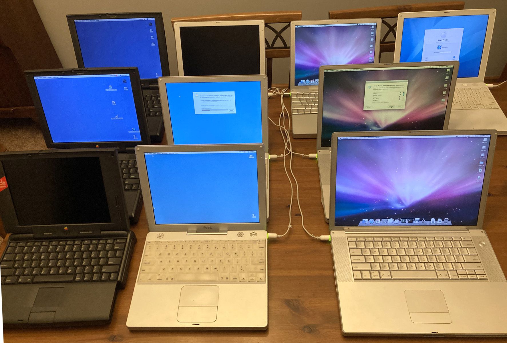

So, at the last minute, the PB190cs would not boot. The 3rd G3 500MHz that was flaky, was flaky again. After the 2024 PPC Challenge, I had zero PPC laptops. Since then, I acquired about 20 parts machines, and have these 10 pieces completed. I have another 3 that are likely to be recovered and 7 that are probably scrap. As I set them up to photograph this shot, two didn't go all the way, so I rate this challenge as 8 out of 10! It was really fun, I learned a lot about the innards of PPC laptops, I have added some great pieces to my collection, and I saved/rescued a lot of machines from becoming eWaste.
Back row: PowerBook 3400c 240MHz, iBook G3 500MHz 12", PowerBook G4 867MHz 12", iBook G4 1.2GHz 12"
Center row: PowerBook 3400c 200MHz, iBook G3 500MHz 12", PowerBook G4 1.5GHz 15"
Front row: PowerBOok 190cs, iBook G3 500MHz 12", PowerBOok G4 1.67GHz 15" DLSD
Back row: PowerBook 5300c 240MHz, iBook G3 500MHz 12", PowerBook G4 867MHz 12", iBook G4 1.2GHz 12"
Center row: PowerBook 5300c 200MHz, iBook G3 500MHz 12", PowerBook G4 1.5GHz 15"
And great work on those. The honest documentation was fun to follow and helpful I’m sure to many who will be cracking similar iBooks/pbs open in future. Personally I really enjoyed the examples of use of epoxy to fix/repair brittle broken plastics etc.

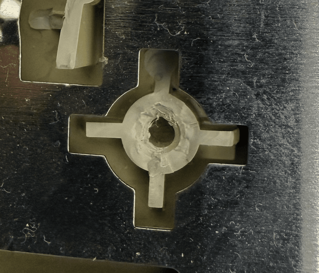

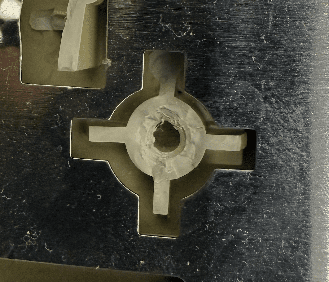

I'm restoring my PM9500, and I've encountered problems that I don't understand how to solve.
The front panel mounts were completely broken, I restored the right side by printing clips, but what to do with the left side?
All self-tapping mounts are broken, in some you can use a self-tapping screw, but it seems very unreliable.
Who would have experience in restoration, what would you recommend?
Managed to fix it!
The plastic had metal threaded bushings soldered into it.
It seems reliable.
I won't take it apart anymore, it seems to me that this plastic starts to crack every time I look at it. :LOL:
