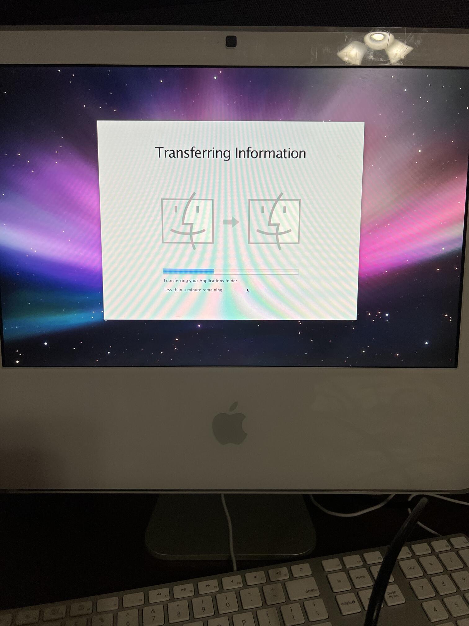

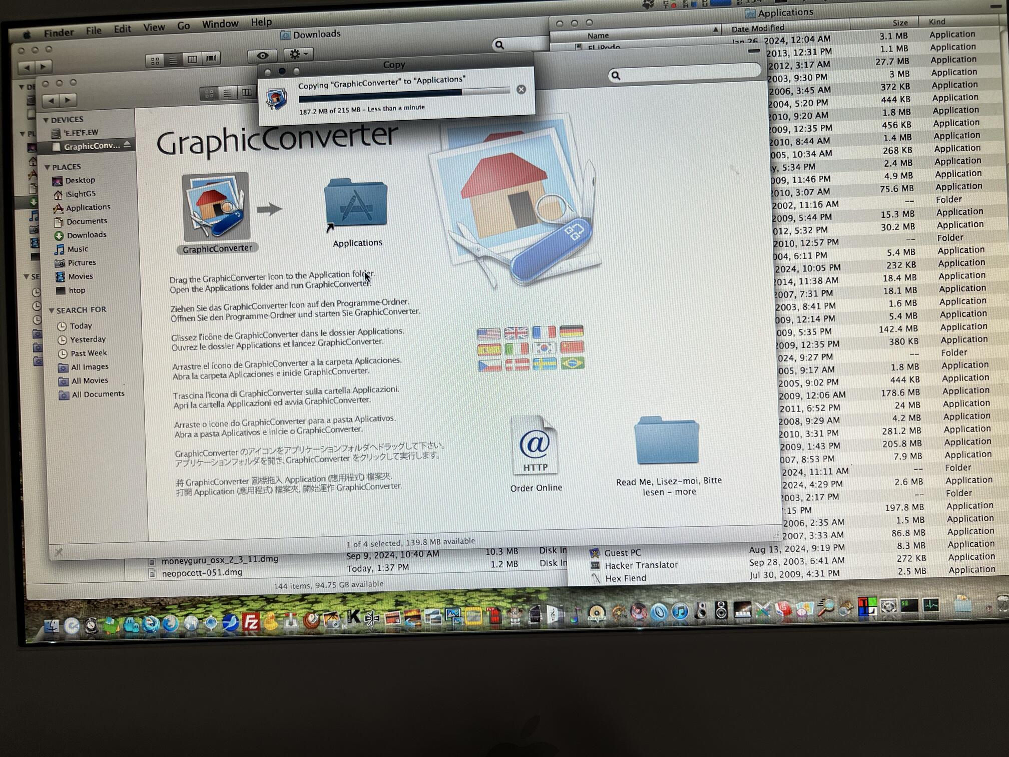

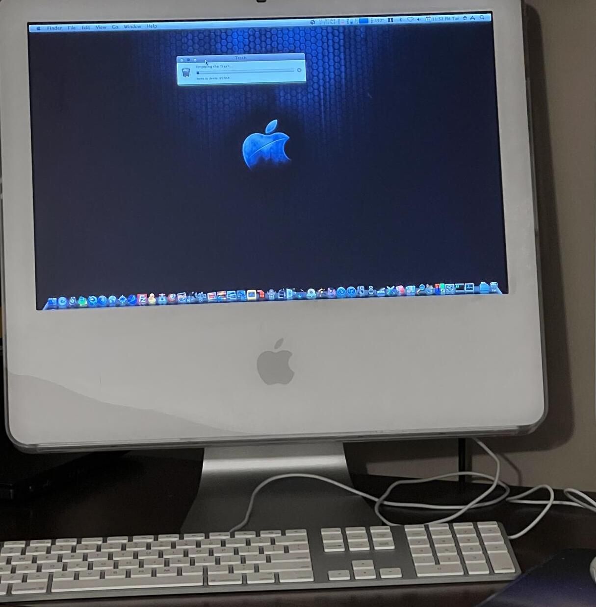

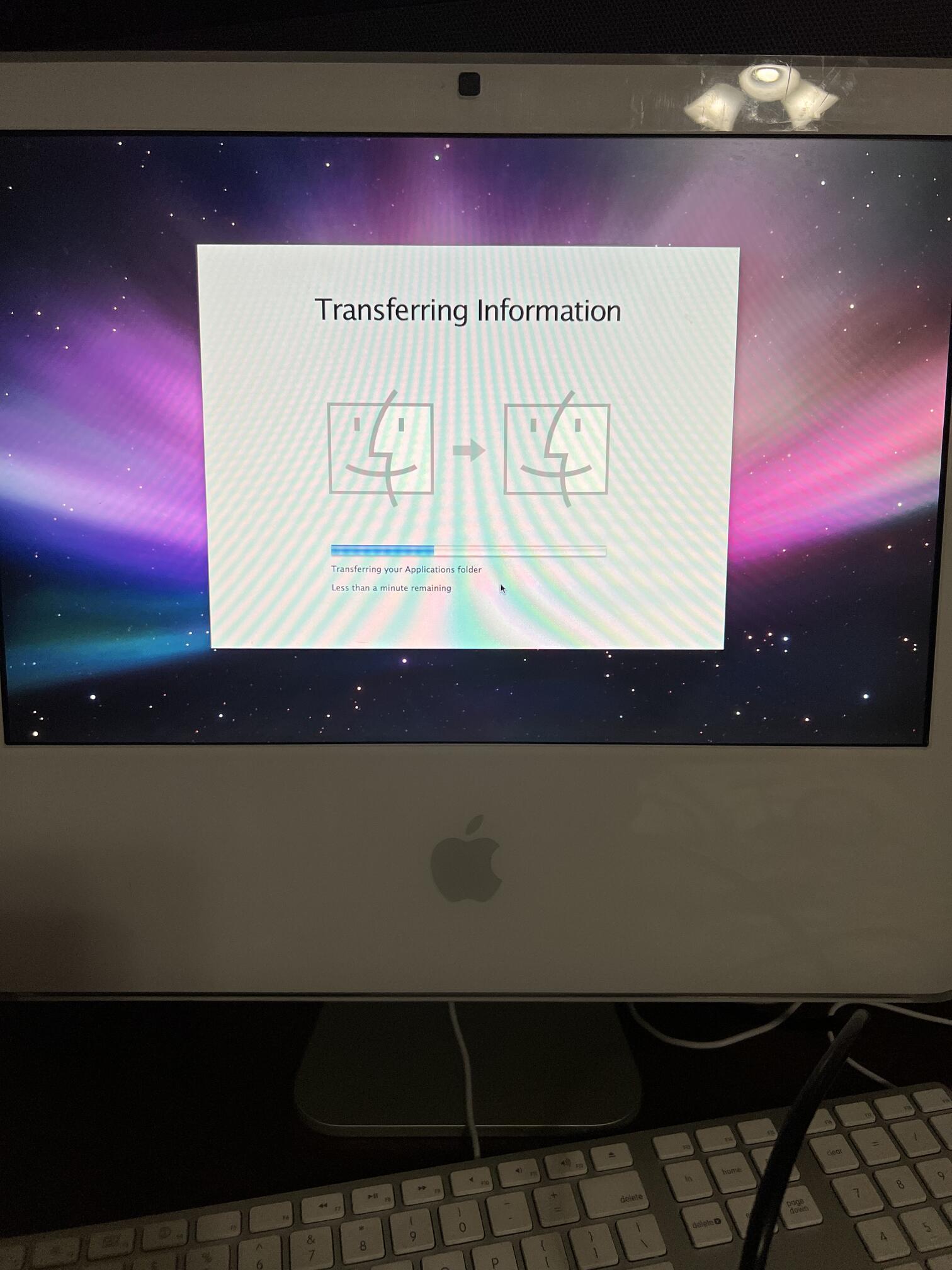

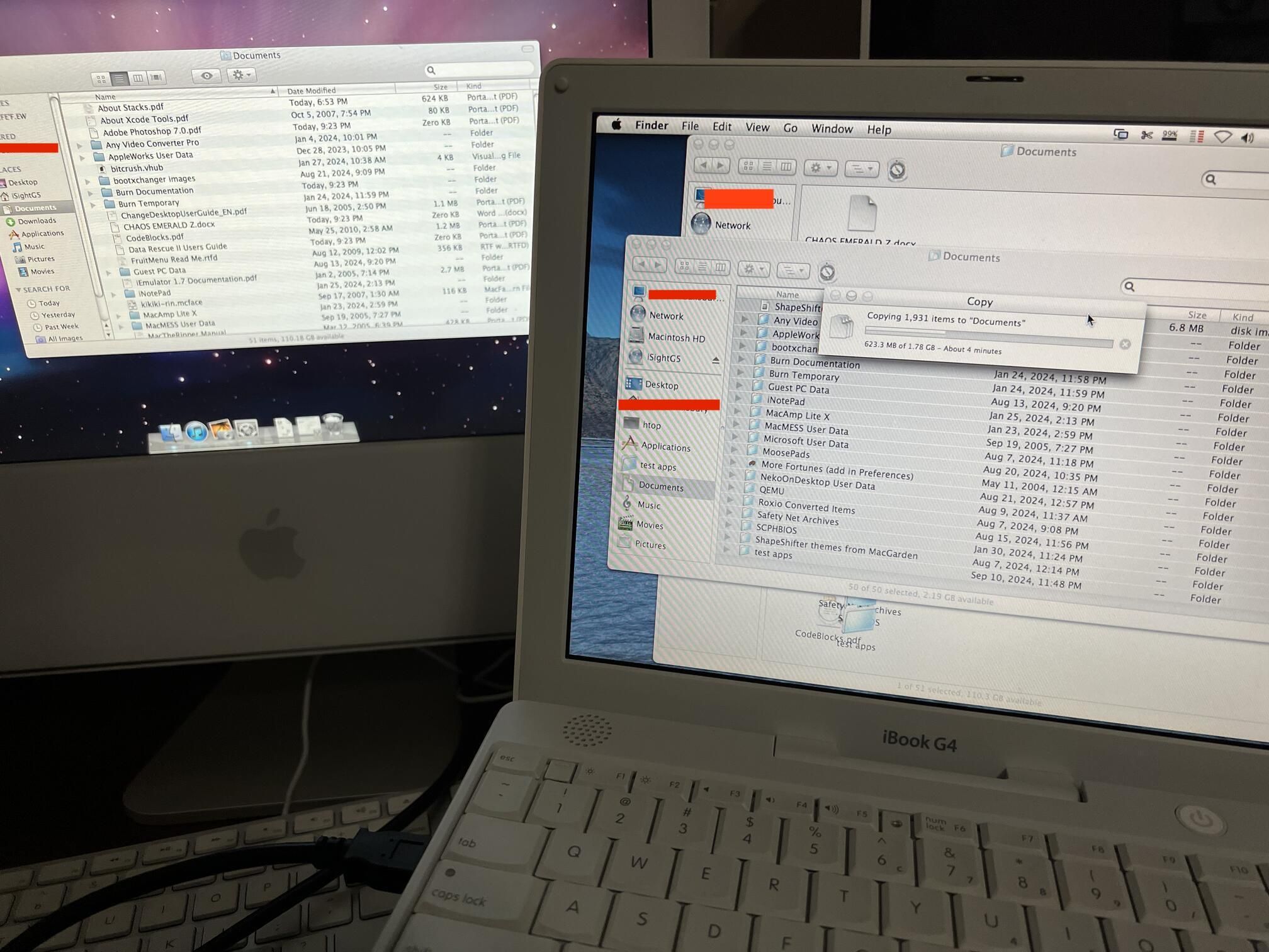

This is my iMac G5. It is the late-2005 17-inch "iSight" model with 2.5GB of RAM. Folks on MacRumors got 4.5GB of RAM to be registered on the 20-inch model, but I was unsure whether or not the same 4.5GB RAM mod could be applied to the 17-inch model as I didn't see anyone mention the 17-inch and all the iMacs that were used in their testing were 20-inch models, but I digress. 2.5GB is plenty for my use case.

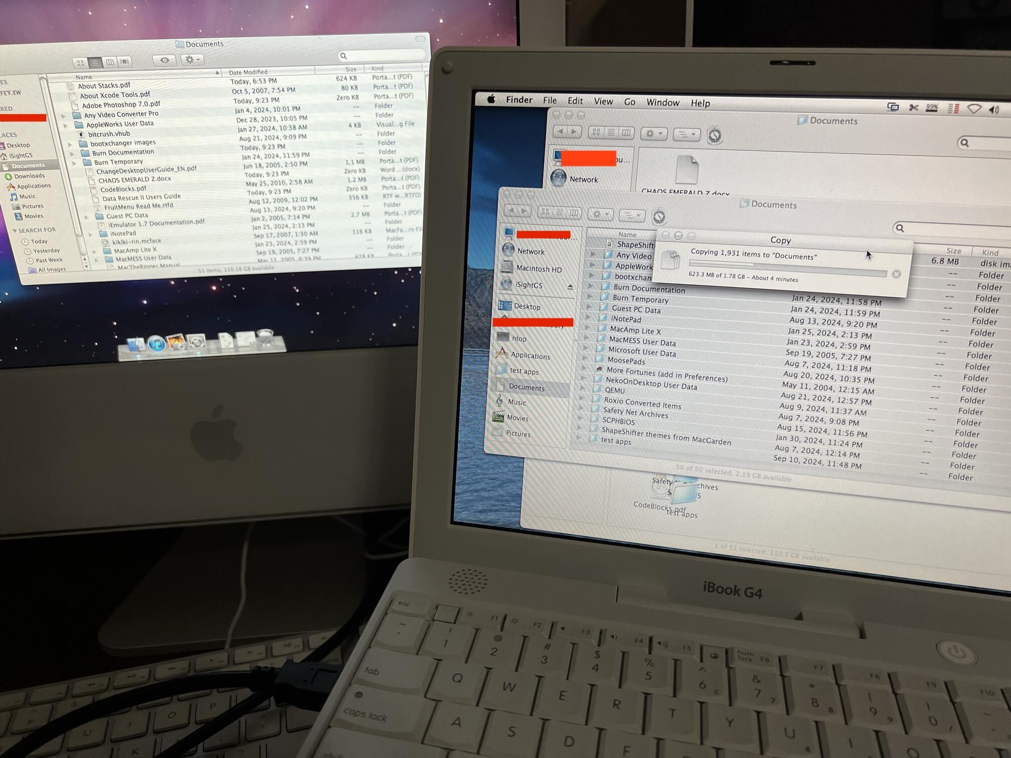

I initially tried doing Target Disk Mode over FireWire from my iBook G4 to the iMac G5. I chose not to select to transfer user accounts since the user account belonging to the iBook G4 is the literal full name of the previous owner, and I don't want his name and other individual stuff that may still be on the iBook to be transferred over to this iMac out of respect. This is the same iBook G4 mid-2005 model that was used in last year's PowerPC challenge.
Well, Target Disk Mode got botched. It eventually froze and the blue barber pole loading bar stopped moving. After waiting for a few minutes, nothing progressed. The iBook's battery died, too, so Target Disk Mode failed in both ways. I made sure the iBook was at 100% battery before beginning, but maybe the battery degraded in the last year. I wanted to get my software and documents over to the iMac so I wouldn't have to manually do that with each of my PowerPC Macs. Foregoing Target Disk Mode, I just left the two computers alone normally and configured FireWire-over-IP (FireWire/IP) to transfer files between the computers without the use of a flash drive. I was able to copy the files over, but I kept dropping connections, forcing me to terminate the link and restart the link again. Why is my FireWire dropping connections like this?

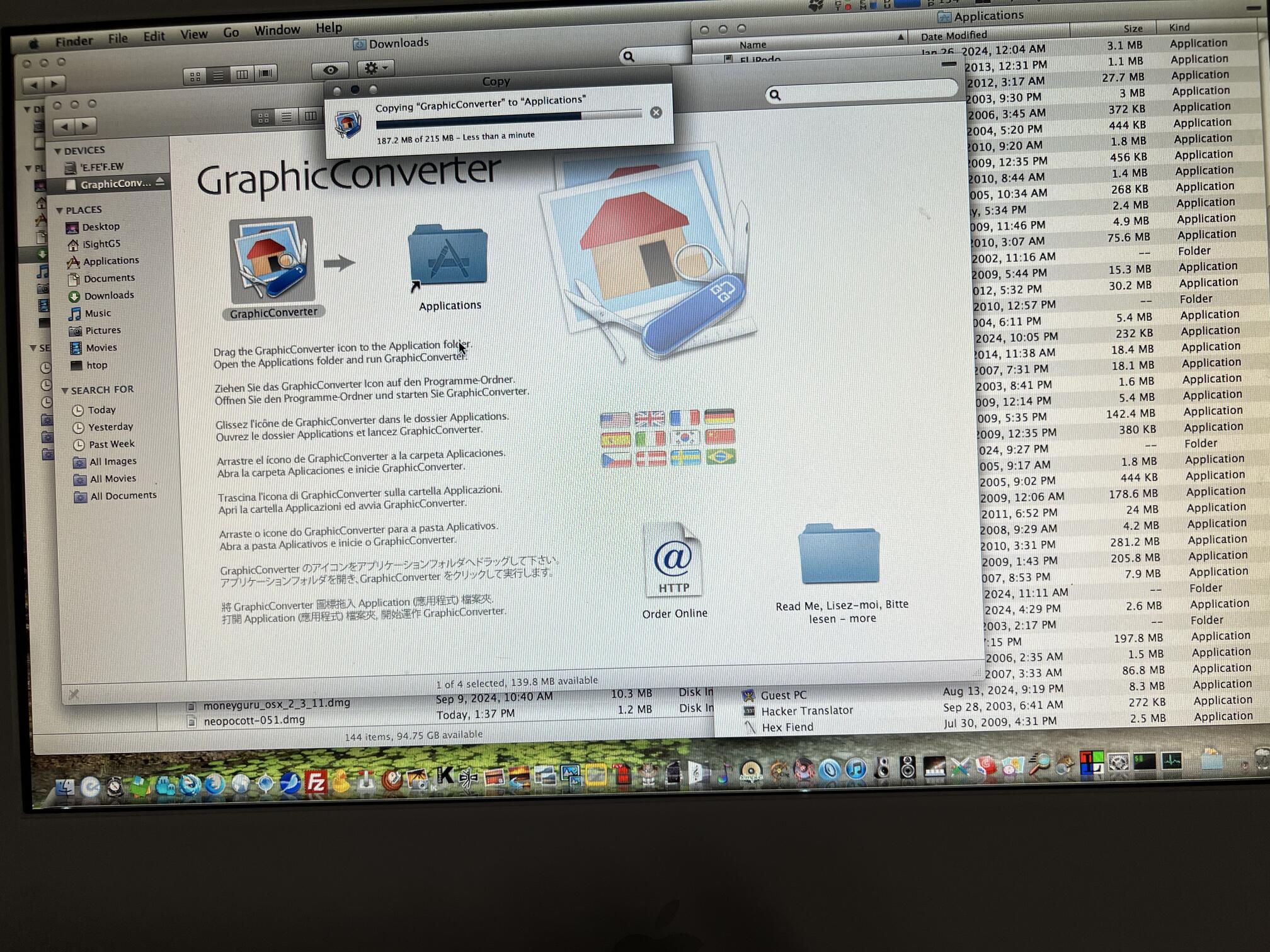

Here I am installing Leopard-exclusive programs or Leopard-exclusive updates to programs already installed. I think there's about 120 or so PowerPC Leopard exclusive programs or newer versions of programs I have installed that require 10.5 Leopard. Also, since I'm manually moving the programs over to the iMac, certain programs are unable to be deleted because they think they still belong to the user that's on the iBook. The programs get confused because my iMac is under a different user. Naturally, it doesn't know that I am the same person controlling both computers, so it denies me permission to delete certain programs that have this permission block. I tried various methods to restore permissions or "repair permissions" is what I think it's actually called, including using a terminal command. It's not a big deal, I don't think, since it won't be every day that I'm deleting or modifying the files in the Applications folder. It's only for this lengthy process of replacing programs that have newer versions that require Leopard, which the iBook is running Tiger and cannot run those programs, but this iMac can. I have to individually change the "Sharing & Permissions" section when you press Command+I or "Get Info" on a selected file and set the read/write permission to "everyone" so I can delete a program. I also installed a custom black dock and Leopard theme that changes the traffic light window control buttons to a dark blue color and the global menu bar, too. It's called "Soliq" and is available for download on DeviantArt. Unfortunately, DeviantArt for the past few years requires you to log in with an account to download anything and is infested with AI "art" now, unlike the good old days when the colors were muted shades of green instead of a JavaScript-infected unnavigable black void.

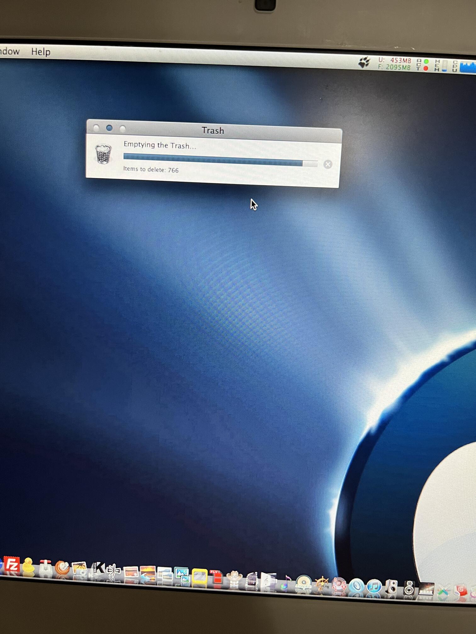

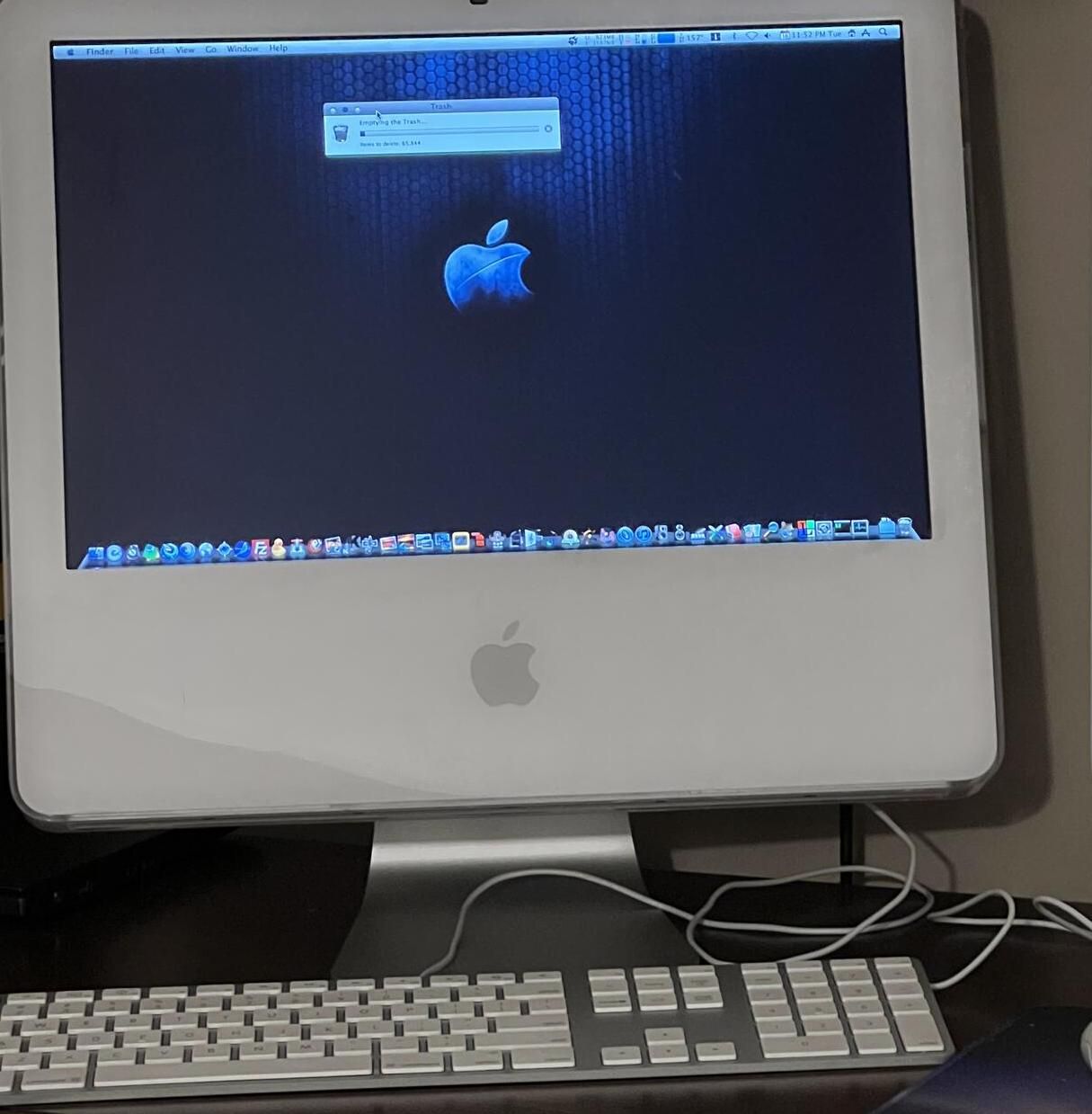

After I had finished for the day, I tried emptying the trash. There was 60,000+ files being deleted and it was crawling at a snail's pace, deleting a dozen files every few seconds it felt like.
I cancelled the operation, restarted the computer, and ordered the trash to be emptied again. This time is zoomed by at a reasonable speed. Interesting setback.
