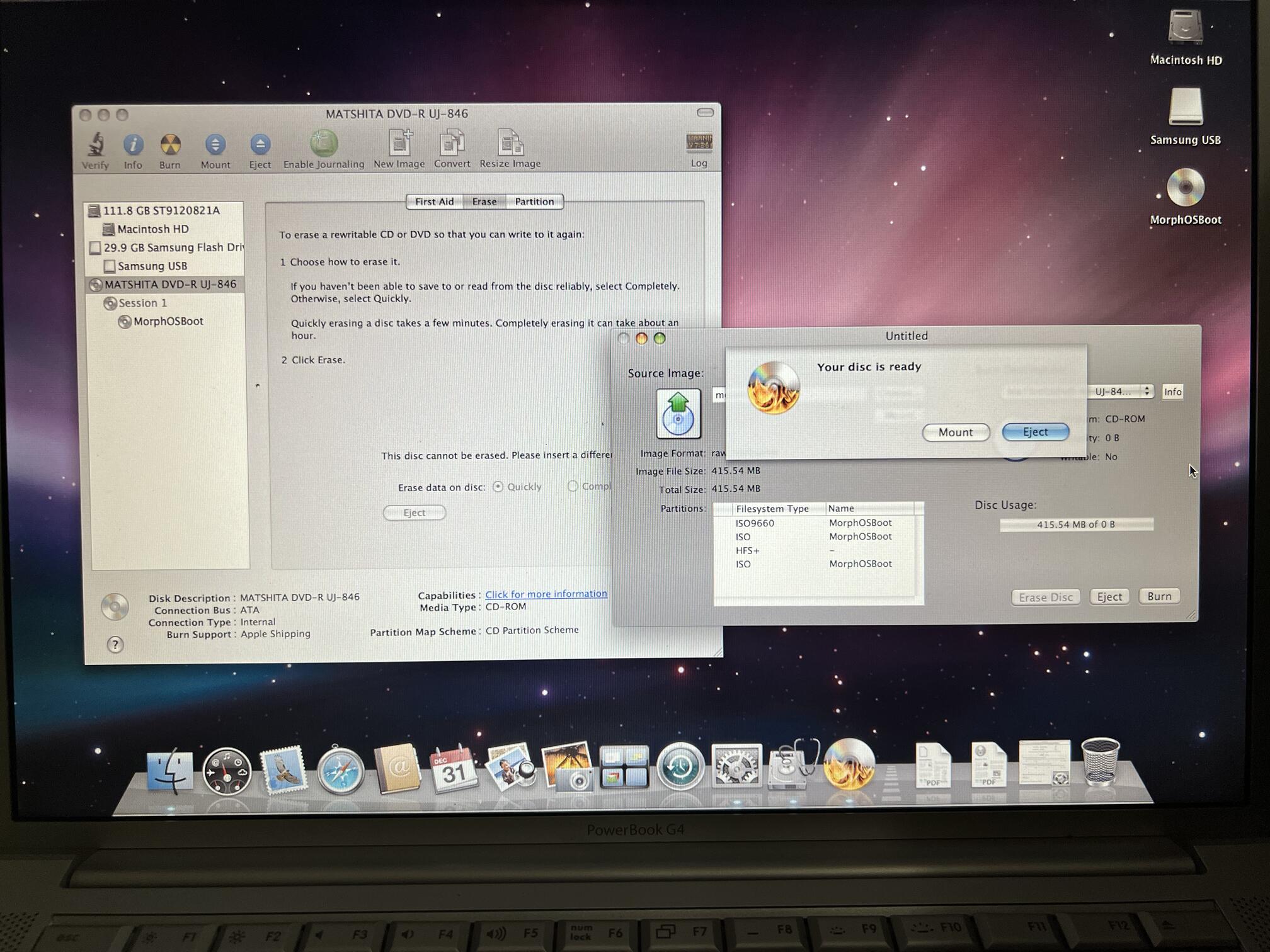

Ah, here awaits a beautiful Amiga-like experience! Let's just hope my optical drive doesn't conk out one day.

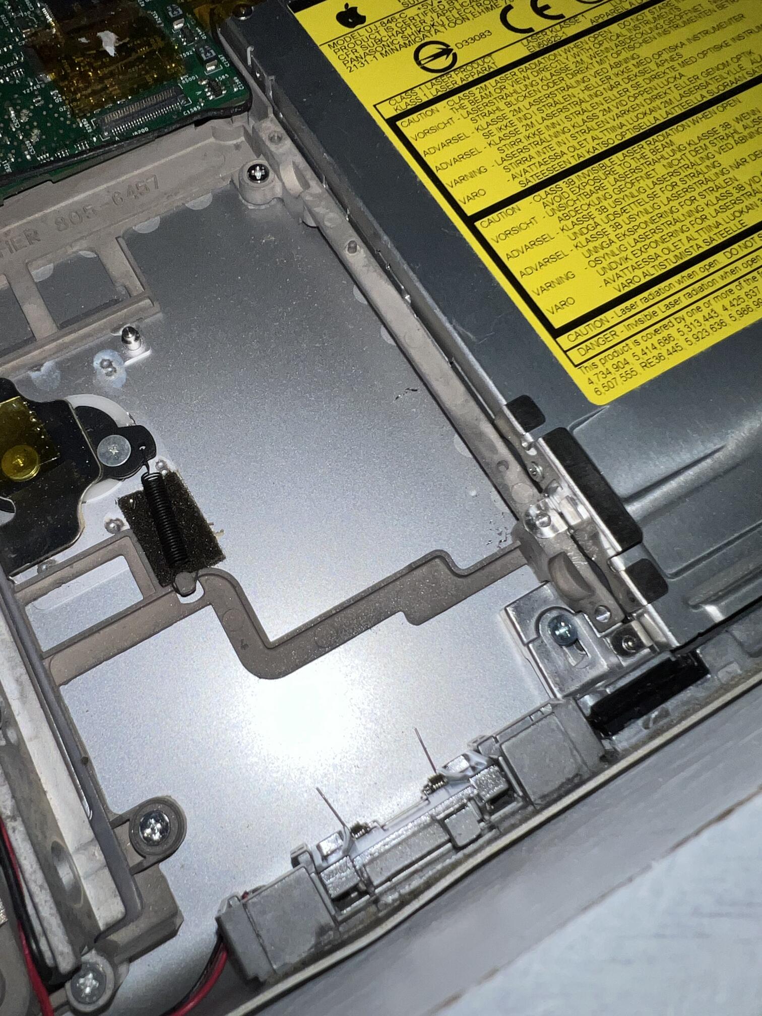

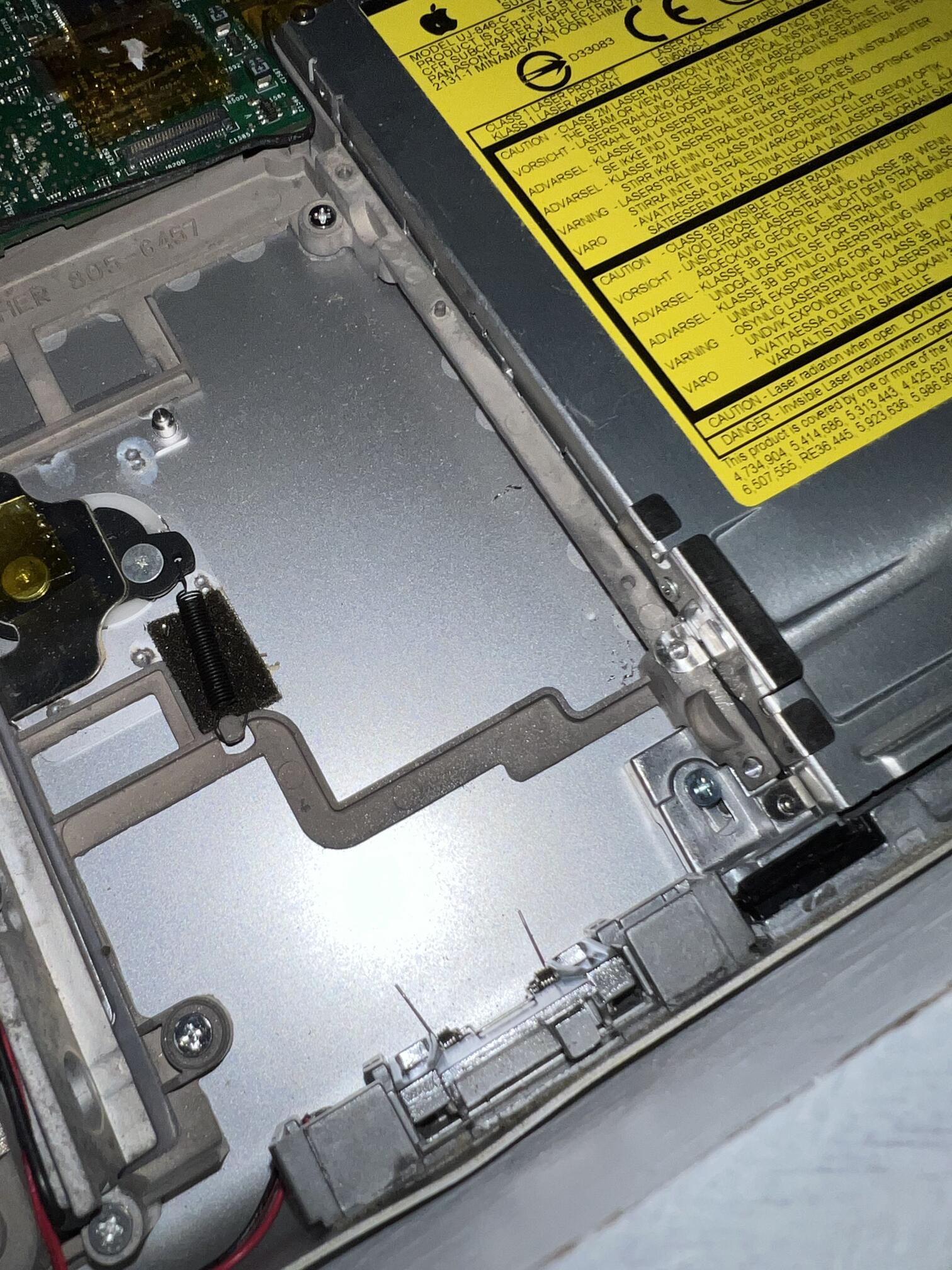

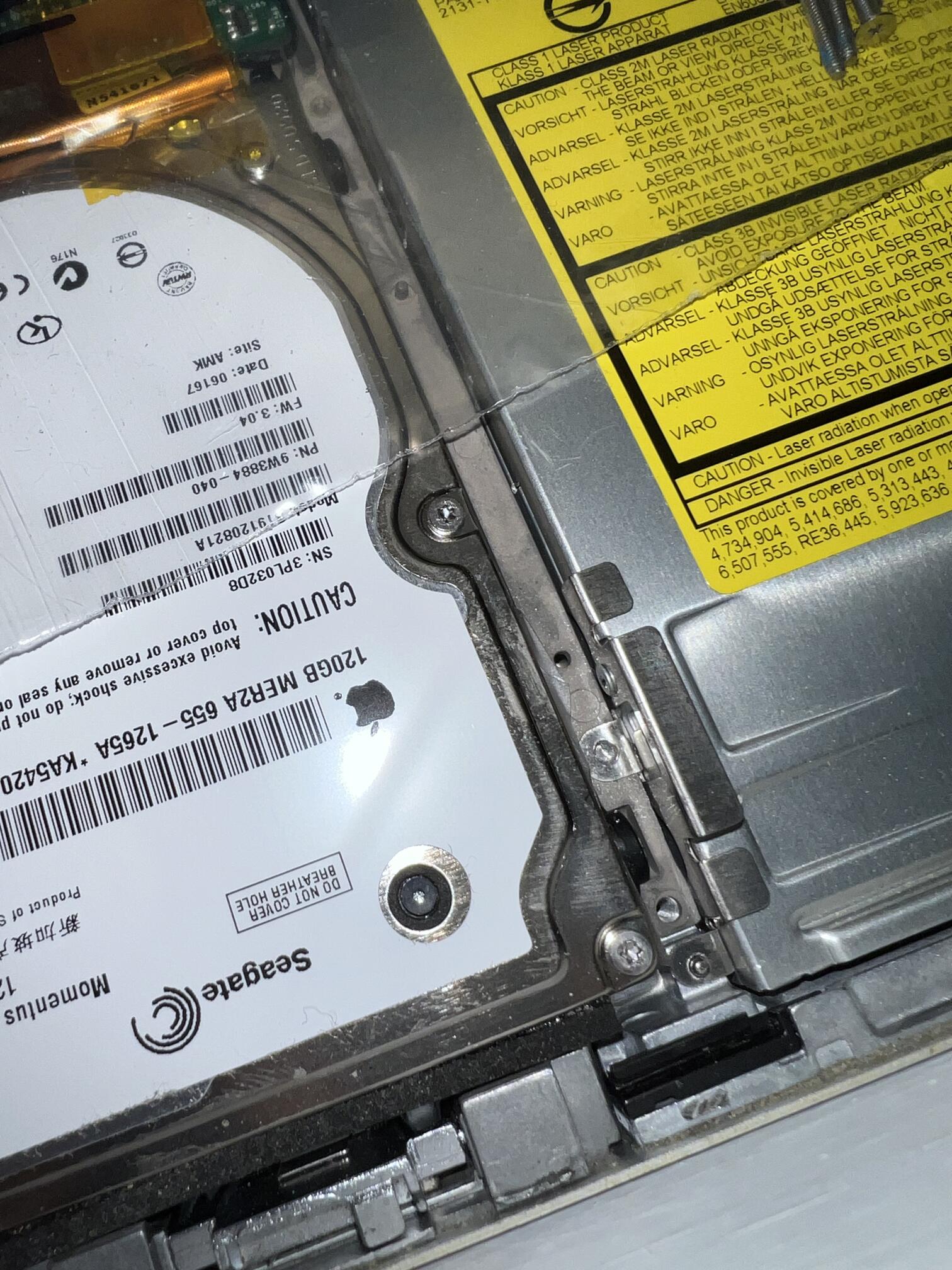

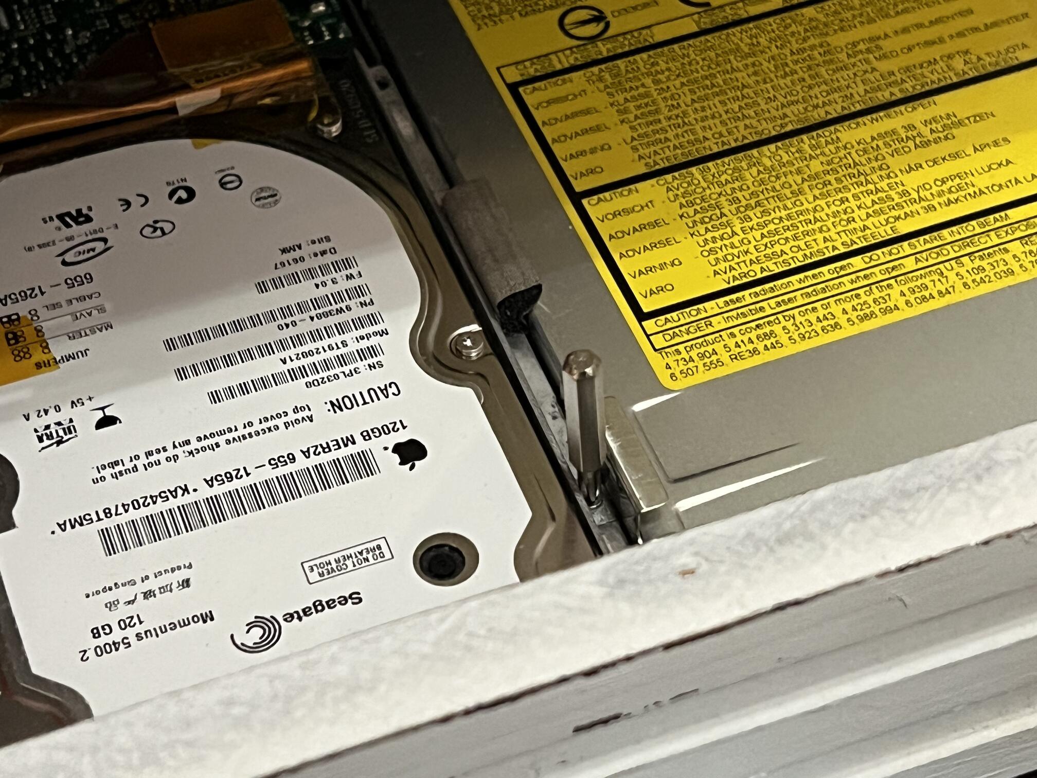

I didn't want to install MorphOS just yet. I want an SSD in this once top-of-the-line laptop. 120GB is not plenty, and at a speed of 5400rpm, it's not speedy, either. I have one of those generic IDE-to-mSATA adapters with a 256GB mSATA SSD mounted to it. Here is a photograph of the assembly in progress:

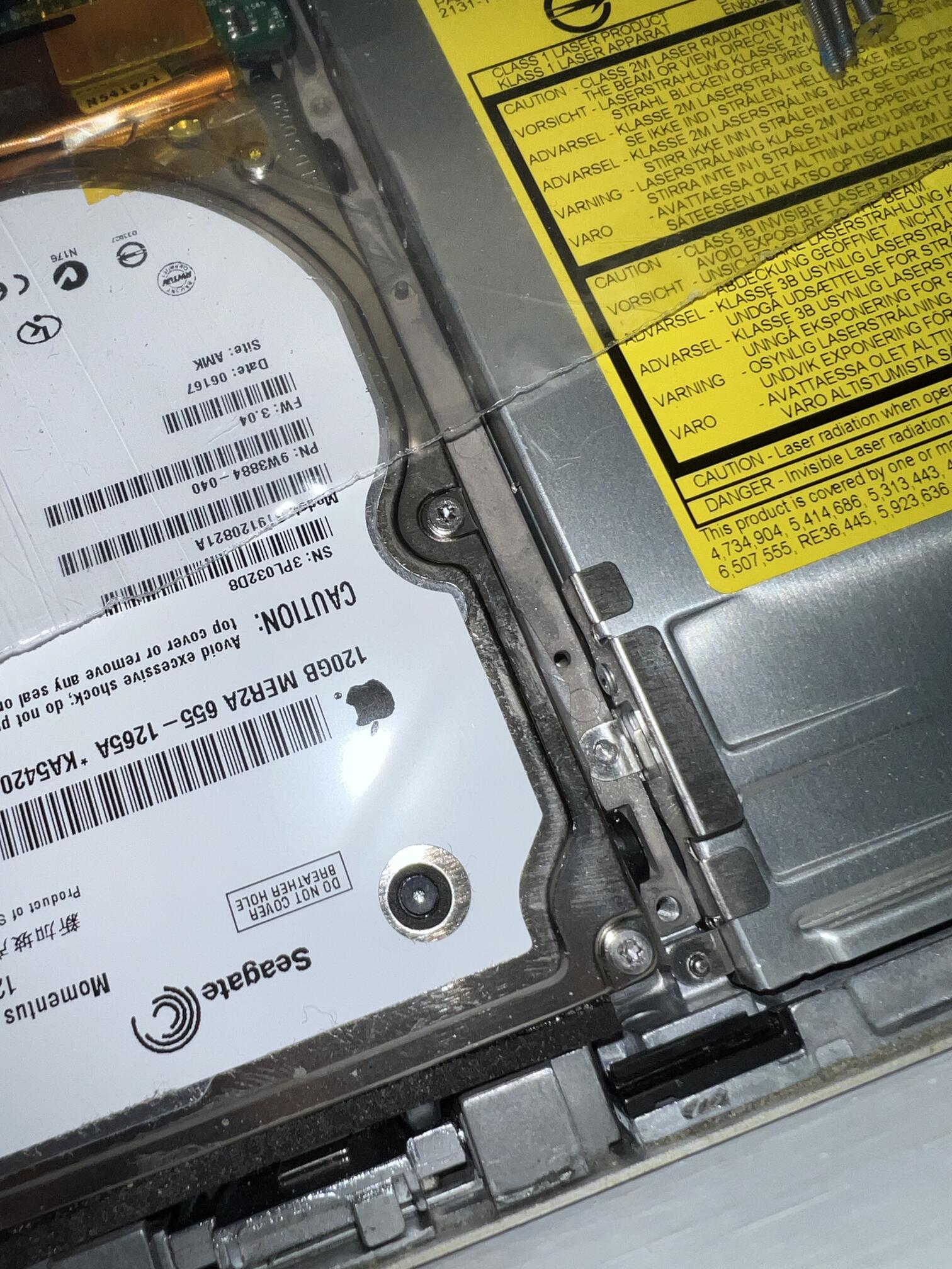

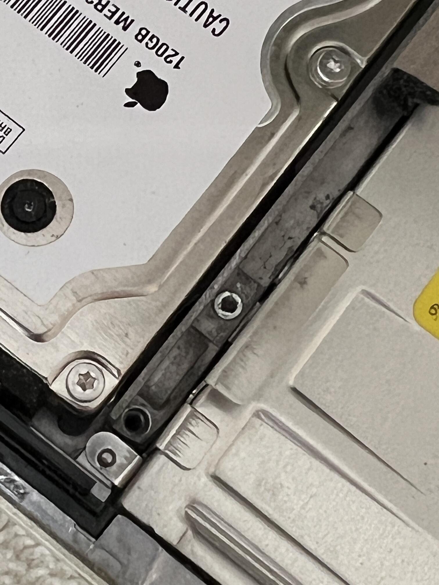

After removing the battery, the RAM door, and plenty of different length philips screws, plus the two (I think) T6 torx screws above the keyboard, I opened the laptop body to reveal the rather clean innards. There are three screws remaining; the ones on the metal bracket between the hard drive and the optical drive.

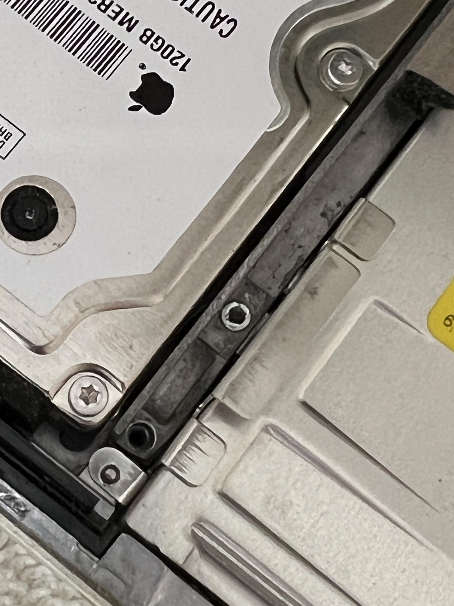

The final screw stripped ... Lovely....​
My current situation is eerily the exact same as this individual on the MacRumors forum: https://forums.macrumors.com/threads/help-i-stripped-a-screw.2250987/. It's my last screw and I need to get this bracket off. I believe after I get the hard drive out, the bracket itself is not needed for my SSD. Hard drives move and vibrate and are susceptible to shock damage, hence the retaining bracket. I could just discard the bracket altogether if and when I get the SSD in there. I've tried the rubber band method, a bigger screw bit, the tape method, and I tried pliers but it was too tight a squeeze to get anything plus the screw is still flush with the bracket. I tried superglue but this glue is at least 15 years old at this point. If I get new superglue, I'll probably retry that method. The last resort I know of is to drill into the screw to destroy it, but that's risky in this example, don't you think? Well, in any case, I am at yet another impediment with my PowerPC Macs. Can't something good happen to me for a change? Also, the PowerBook did not survive the disassembly unscathed. A little bit of plastic perimeter broke off. Observe:
I stored the different screws into plastic bags and segregated them based on screw location. Screws belonging to the RAM door go in a separate bag and screws belonging to the battery compartment go in a separate bag, and so on. I was tempted to reassemble the PowerBook and call it quits on the SSD upgrade, but I did not. The PowerBook is still sitting lonely (somewhere else not on my dining room table). Here is my current situation with various tools and other mess strung about:
Any help on getting this stripped screw removed is welcomed, please. Thanks in advance.
Drill it out. Turn the laptop so the mobo is vertical, with the drive towards the edge of the table... that way any metal falls down instead of into the motherboard (drill horizontally). Slow speed with a drill bit the size of the screw head, the screws should be soft enough. You just have to remove the head and the bracket should come off, leaving a couple threads you may be able to grab with a pliers once the drive is removed.
Otherwise, if you are not worried about reusing the bracket, just snap it off.

So, my SSDs arrived on the 28th. Both are brands that other PowerPC users have in recent years confirmed compatibility with the SATA in the G5 Macs. They are Netac and T-FORCE. Upon deciding which to insert into my PowerMac first, I randomly selected the Netac SSD, which I think is only sold on eBay, so the whole supplier is just operating from an eBay account, and the drives go for really cheap and they give out free discount codes. Normally, this would make any smart shopper skeptical, but PowerPC users are already strapped for options as it is, so my only concern with these obscure drive brands is their longevity. Who knows, since a book shouldn't be judged by its cover, Netac could be a hidden gem. After all, the eBay reviews are majority positive.
Huzzah! The drive is immediately recognized, unlike the OWC SSD, which more PowerPC users after me are now beginning to find out for themselves that it no longer is compatible with any G5 Mac. Let it be known in 2025 that Netac SSDs work with G5 Macs!
Alright, let's clone Sorbet Leopard to the Netac SSD after formatting it in Disk Utility.
Done. Select the Netac SSD as the startup drive in System Preferences. Reboot. Watch the Leopard introduction movie. Create a user account and password. Readjust my resolution settings from 2560x1440 to 1920x1080. Here we go.
Install the "Mountain Leopard" theme included with this custom operating system to get that delicious Mountain Lion look:
Copy over my ~21GB worth of software I'll be installing and set my wallpaper to the best James Bond actor, Roger Moore.
Let's do some experimentation. I have this EDIMAX 802.11n Wi-Fi dongle. I hear that the drivers are actually Universal Binary and could be installed as early as Panther, I think? But it's confirmed to have Leopard compatibility, which is what I'm interested in at the moment. It's recognized in System Profiler and the driver installer .pkg opens and takes me through the installation process.
After rebooting, the app "Wireless Network Utility" gets installed to the Applications folder. I open it but it immediately closes itself. I hate it when certain apps do this. MuCommander 0.9.0 and I think 0.8.9, both versions that require Leopard, do this on Leopard even after installing the necessary Java updates that file manager requires. Version 0.8.5 opens just fine on Tiger. Some Intel-only binary of GIMP also does this on my MacBook 1,1 running 10.6.8 Snow Leopard. In my repertoire of ~450 or so applications, I recall having about a dozen do this where they just open in the dock for a split second and then immediately close, signified by the dock expanding and shrinking by a few pixels before everything returns to the way it was as if I had never double-clicked (or pressing Command + Down Arrow) to open the app.
I also retrieved an alternative download that used a slightly different/older version of the program. No dice. Using the command "sudo fs_usage | grep open" in the Terminal shows me that the app indeed opened, and Console shows me three messages that occurred when the app opened and closed itself. "Crashing" was the wrong terminology used in TextEdit in the following photographs, at least not in the actual software sense. Apps that do this open and immediate closing do not report a crash message prompt.

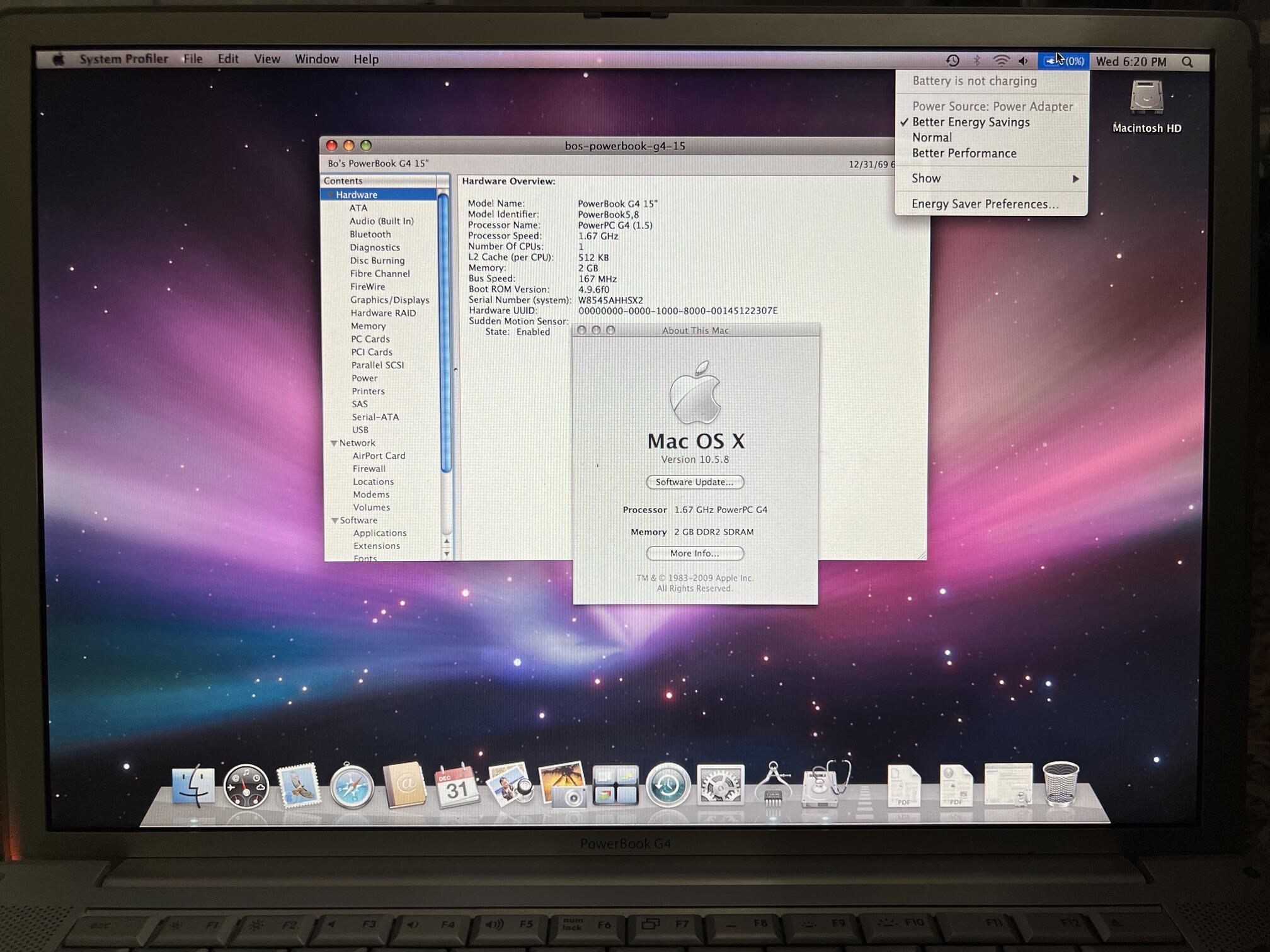

Just for experimentation, I booted back into 10.5.6 running on the stock Apple Maxtor hard drive and see if the app works from there. I know MacTracker is angered by the "About This Mac" saying "10.5.9" instead of "10.5.8" so maybe this was an unreported case of that happening with "Wireless Network Utility". Reading the changelogs of Mac apps I've installed in times past, software developers have released quick patches for bugs in their software when it gets confused about a higher Mac OS X version number than what they are programmed to expect, which happened probably most often when Tiger updated from 10.4.9 to 10.4.10. Within 10.5.6, no difference was made, so I rebooted back into 10.5.9 on the Netac SSD.
I took out the EDIMAX Wi-Fi dongle and I noticed small print on the backside of it, reporting the model number to be EW-7811Un V2.
Oh...
Version 2 is the one that wouldn't work with PowerPC Macs. The website this was purchased from did not specify if it was V1 or V2. I ended up receiving V2. Bummer, I did not luck out. In the meantime, I just went to purchase a few more different dongles to try out since these ones with specific RealTek and RaLink chipsets have PowerPC drivers for them hosted on the Macintosh Garden and other users on MacRumors have confirmed that theirs works with their Macs, too. Hmm, what could I even repurpose this for? Maybe I'll give it to my MacBook 1,1 that also lacks 802.11n Wi-Fi, if it works there. I think it should.

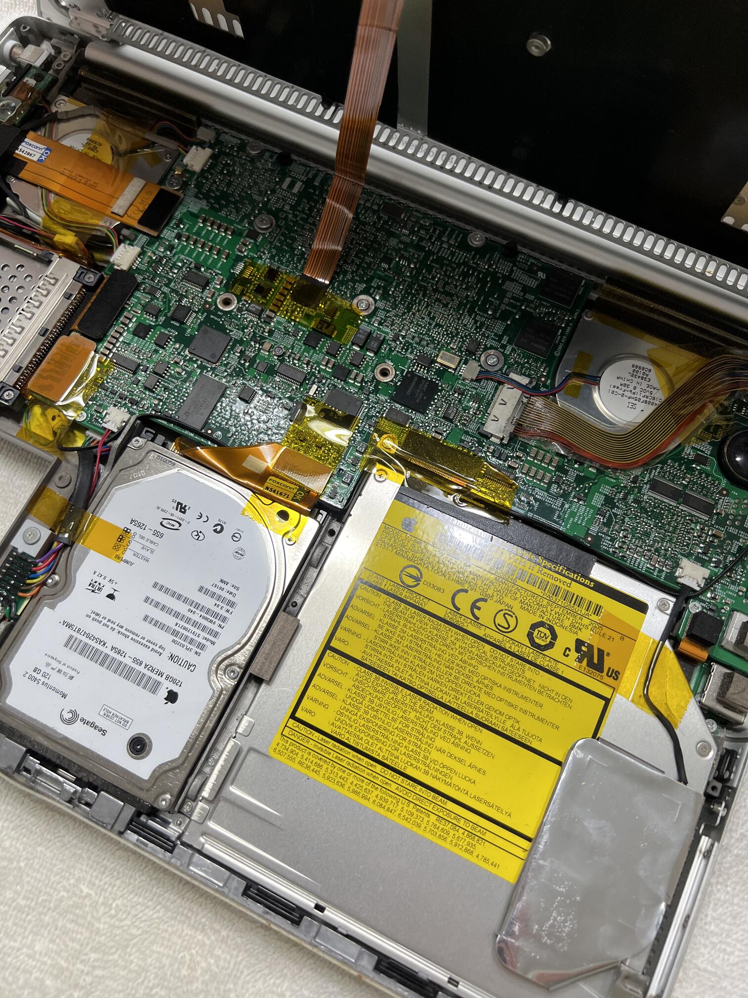

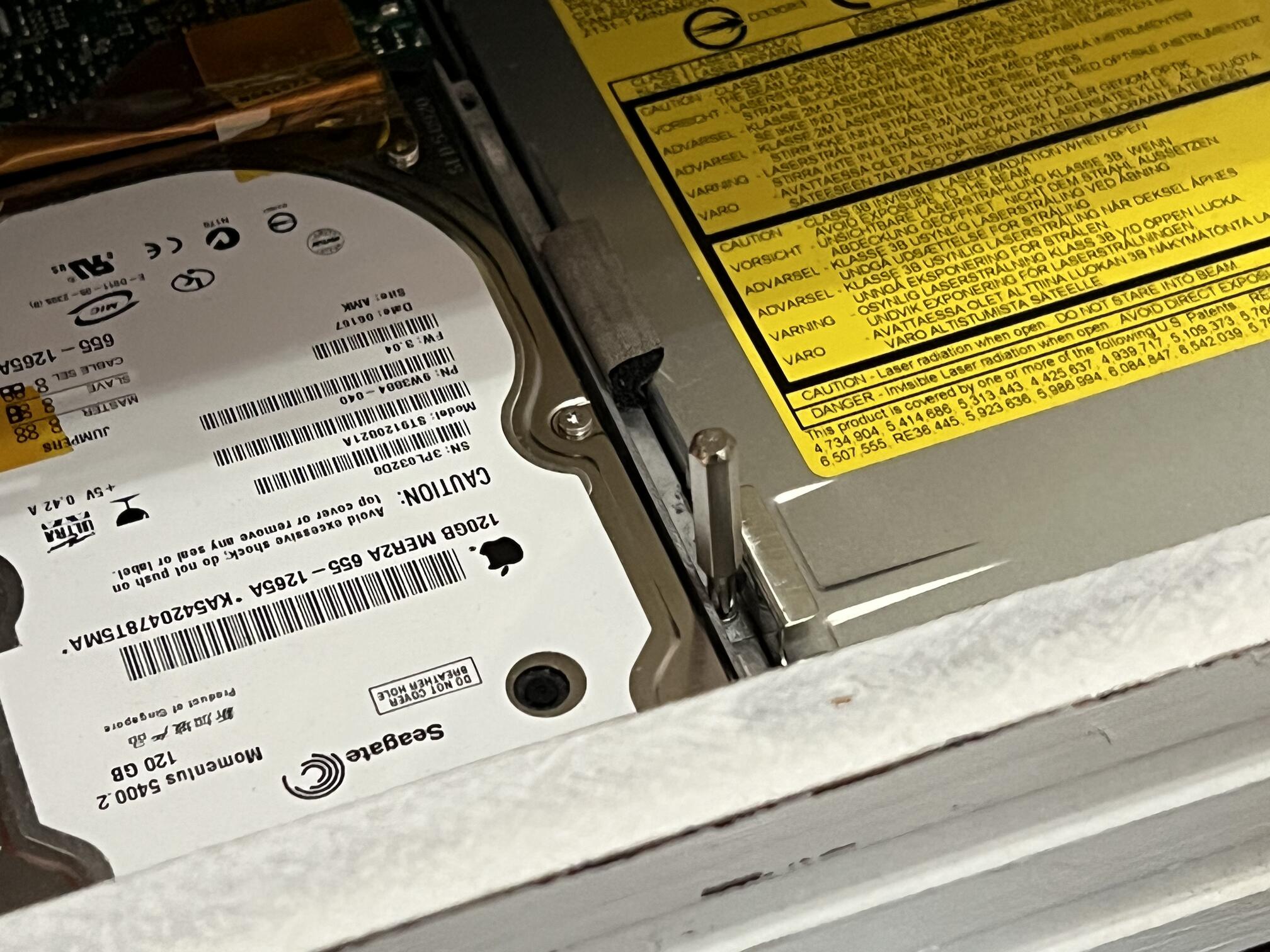

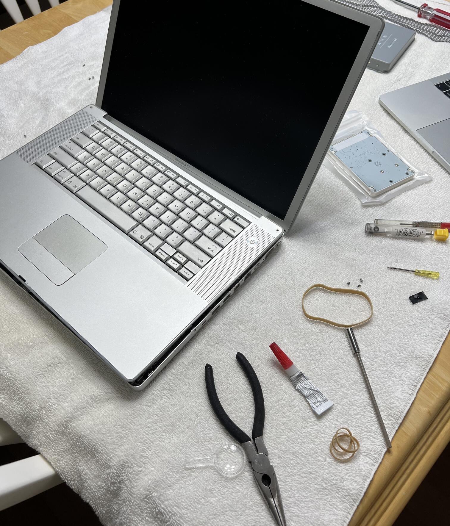

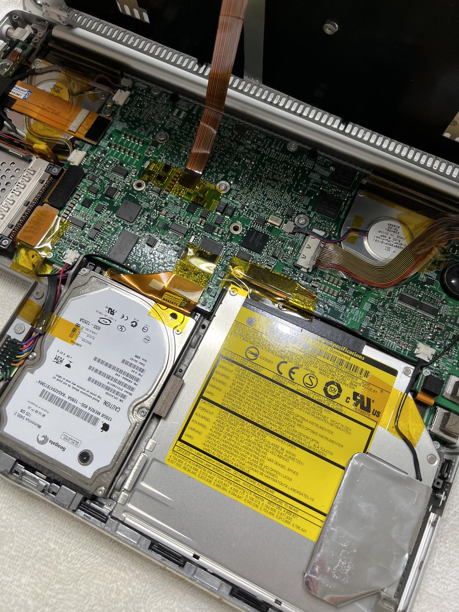

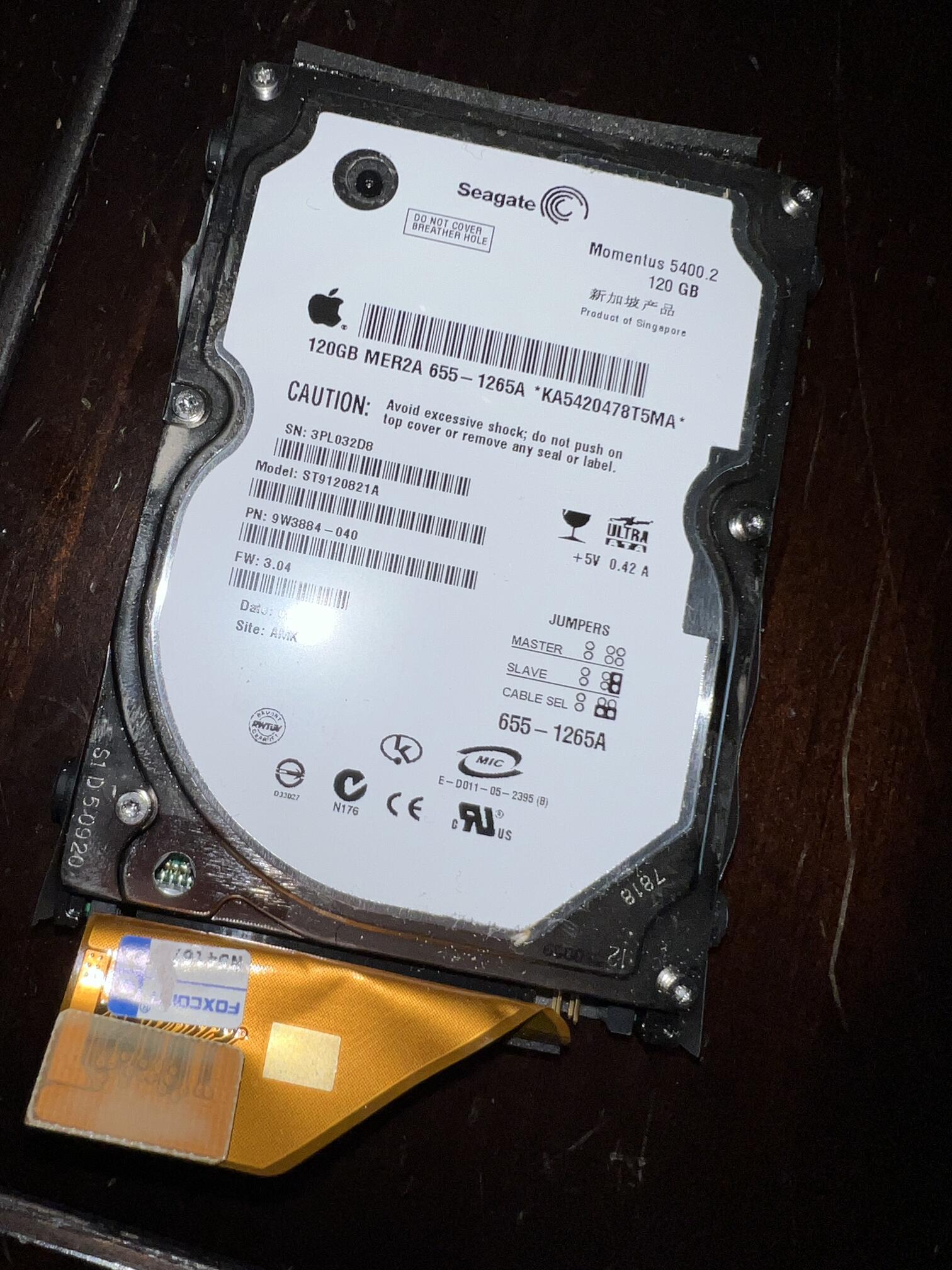

Fast forward to today, it was finally time to resume work on the PowerBook G4. For the past day and a half, I had sat the laptop on a coffee table with a bit superglued to the stripped screwdriver head. This was newly purchased superglue, not the ancient stuff used previously in an earlier post. This superglue method ended up not working for me. The glue wasn't strong enough, still, and the bit just pulled out from the screw head.

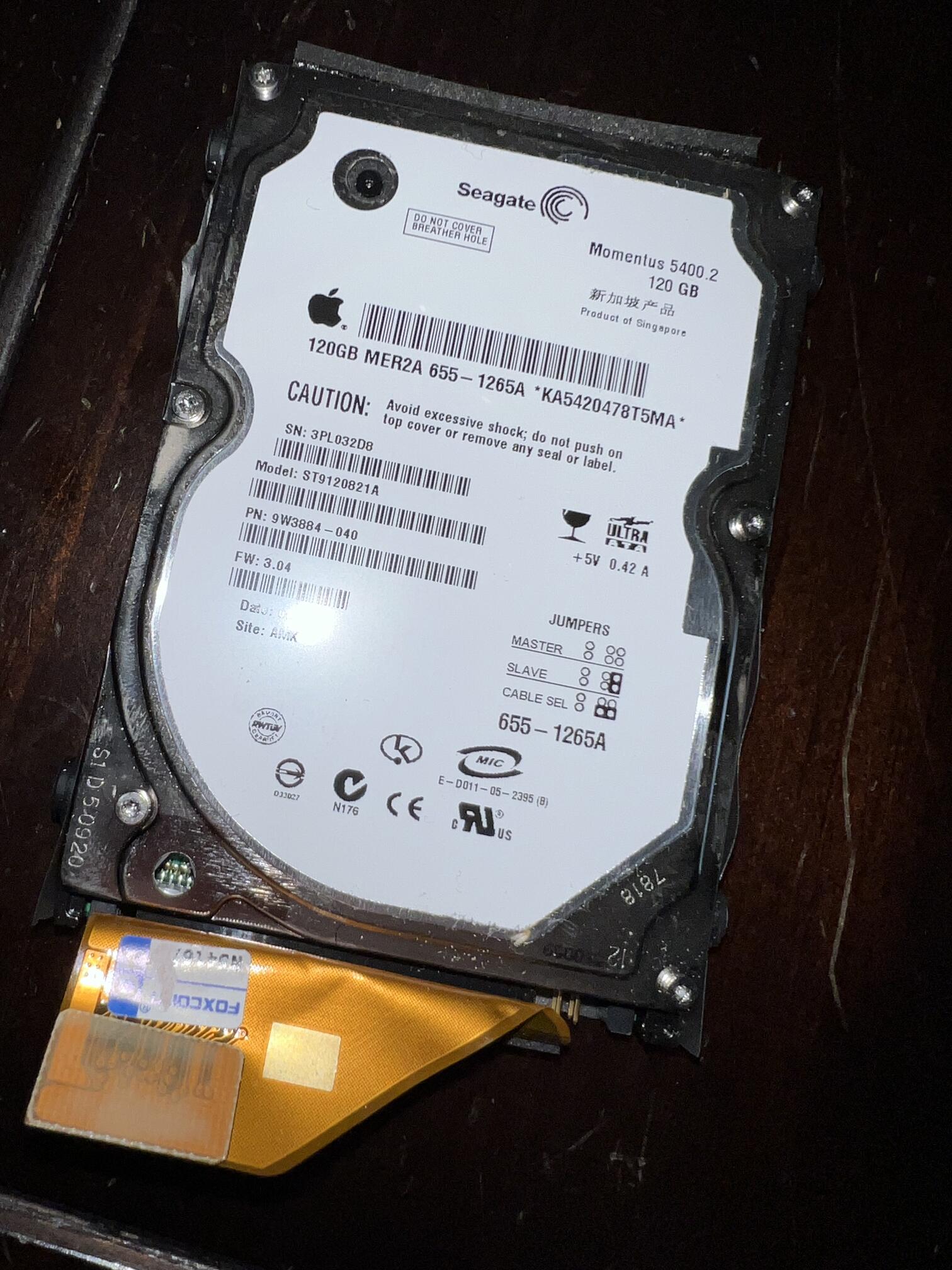

It was time for more drastic and destructive methods. Carefully using a power drill with the smallest bit in my garage and a little downward pressure was doing enough damage to the stripped screw that it eventually broke off successfully. A portable vacuum was used to suck up the shards left over from drilling into the screw head. The bracket with its brittle metal, upon pulling on it, got snapped in two in the process.
Remove the orange tape, disconnect the ribbon cable from the motherboard, and lift out the hard drive by the ribbon cable. The drive is now removed and the PowerBook is now nearly ready to be upgraded with an IDE-to-mSATA SSD. Don't worry about this next picture, the leftover debris sitting in the chassis got sucked up, as well, after the photo was taken:
Here is the removed hard drive sitting on my coffee table:
This is where things are at for now. I'm hungry right now and I have things I have to do outside the house today, so I'm leaving this as is until tomorrow. Hopefully the PowerPC Challenge continues into the first week of February like it was hinted at in the first post of this thread by Branchus, because as things are finally shaping up and escalating now with precious progress is being made for both my PowerMac and PowerBook, I do want to reach my "finale" - if I want to call it that and frame this challenge as a theatrical storyline - and end on a high note for you all.

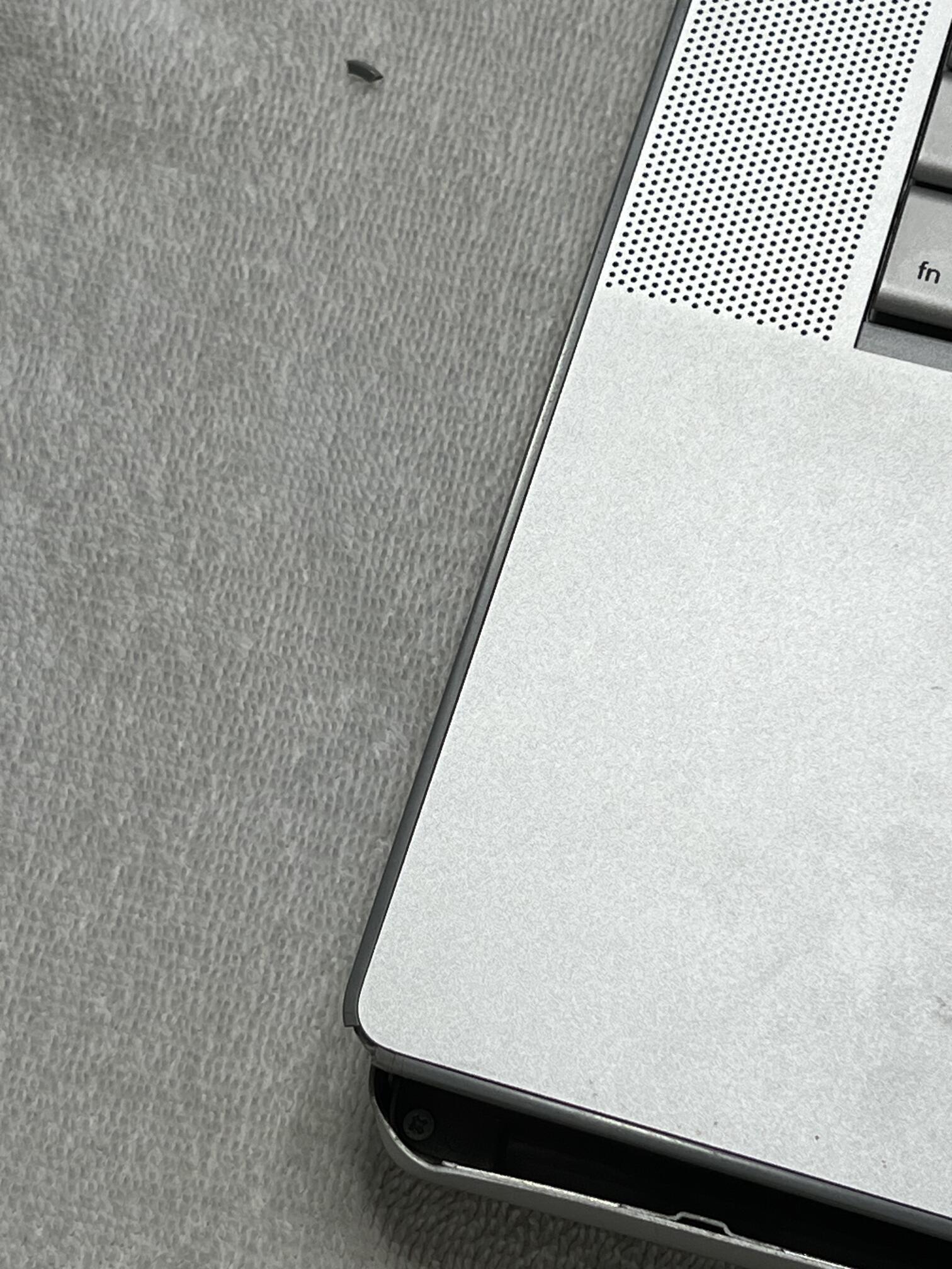

And some of the welds on the front have broken free. Time for more epoxy.

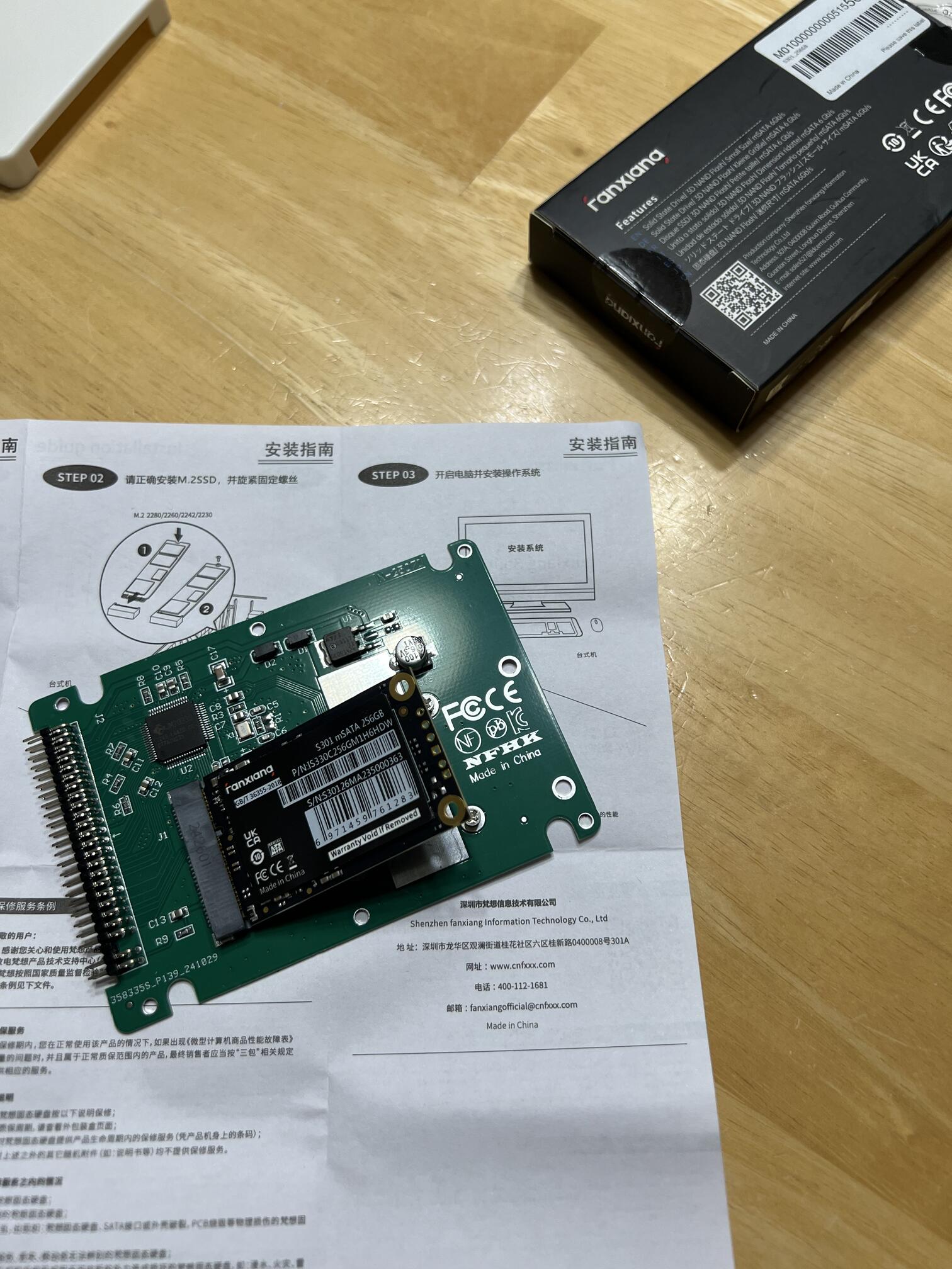

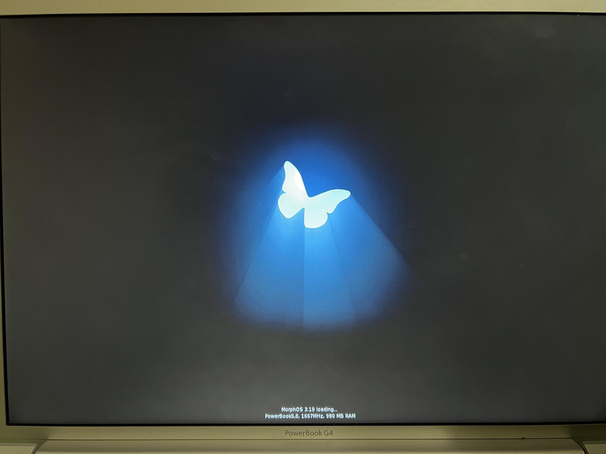

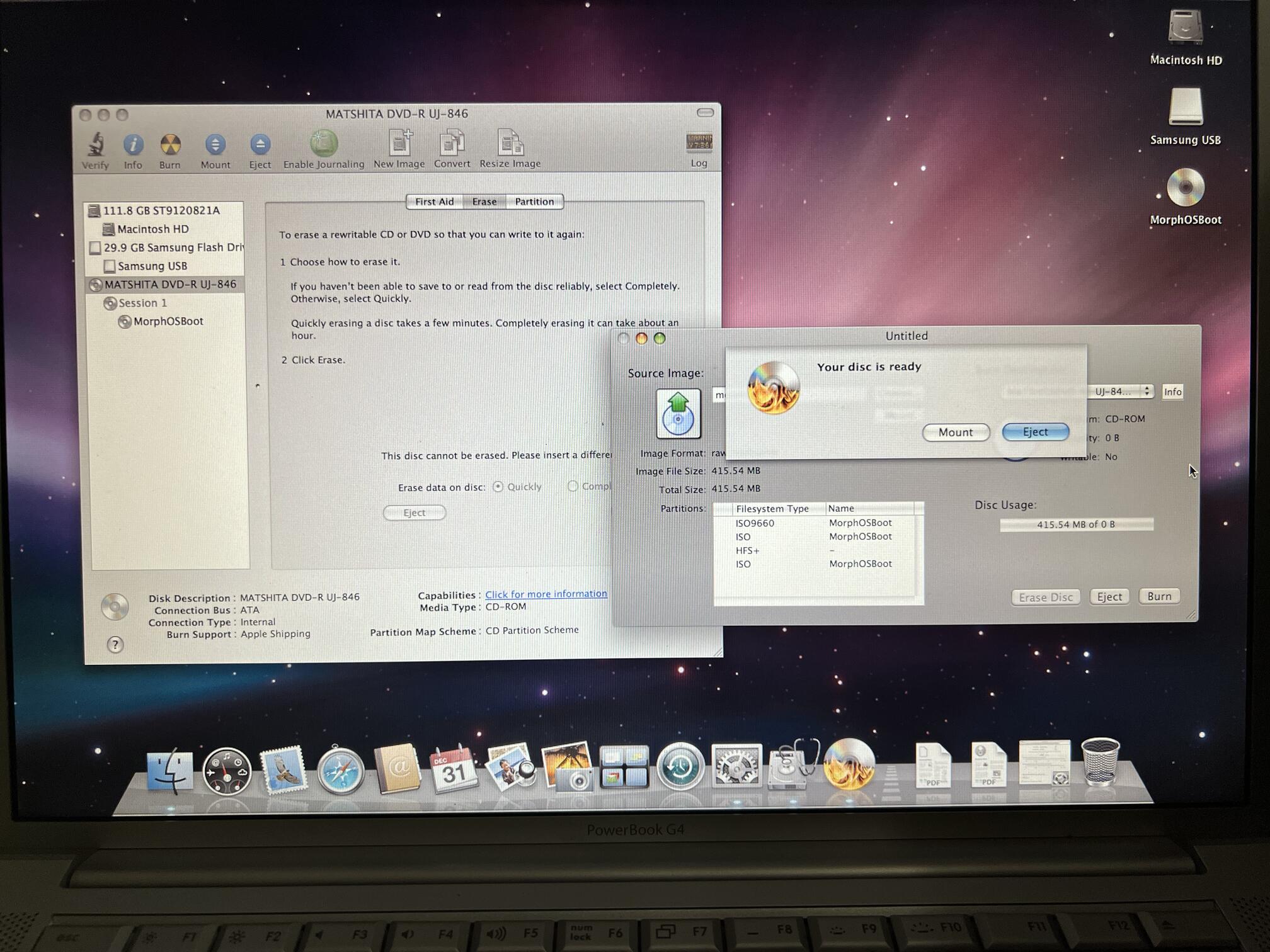

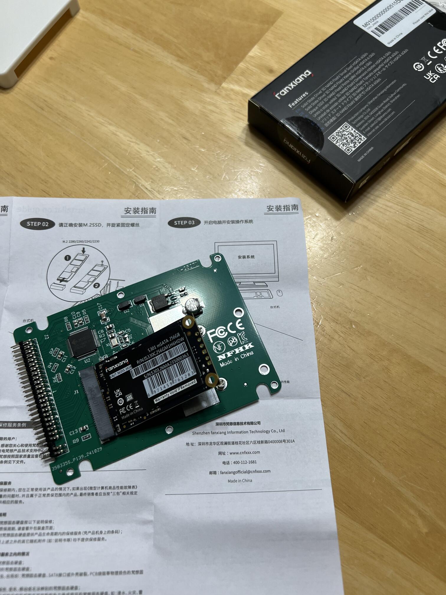

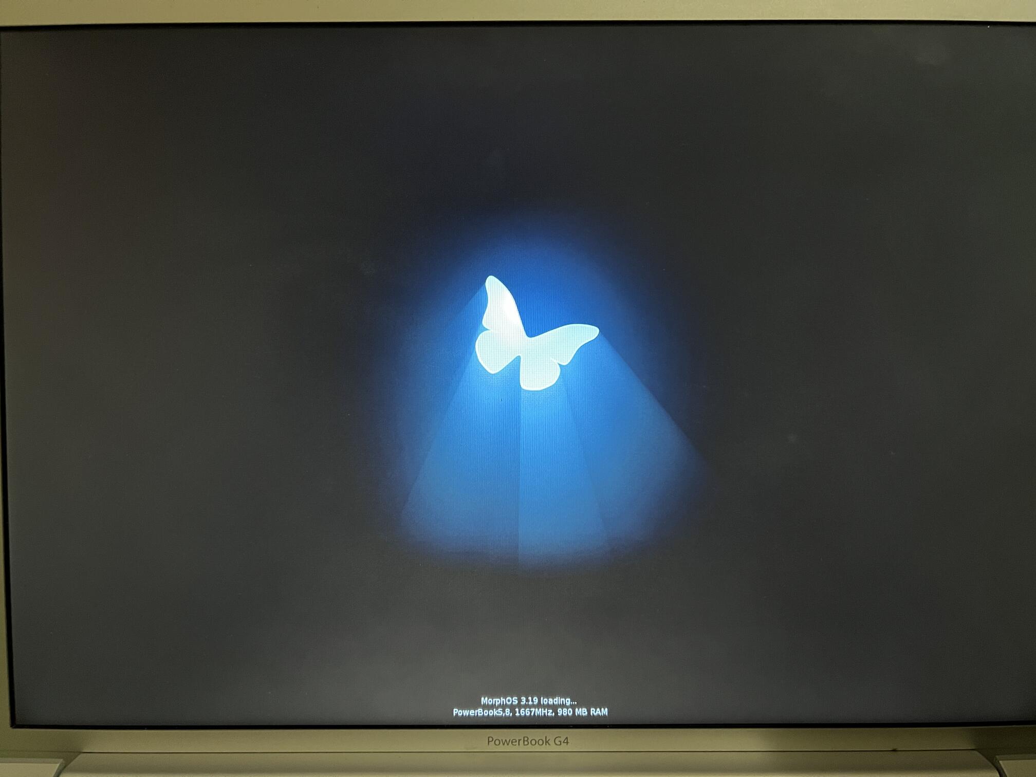

Yesterday, the SSD (IDE-to-mSATA) was plugged in to the PowerBook while the stock Apple 120GB 5400rpm hard drive gets zipped up into the plastic bag the IDE-to-mSATA adapter was packaged in. For now, that drive will remain in the bag for safe keeping.
Before reassembling, I plugged in a Mighty Mouse to the PowerBook and the PowerBook to an outlet and turned it on, making sure that the laptop was in working order and the SSD was functional/recognized before screwing things back together. My burned copy of MorphOS 3.19 inserted, I read through the installation prompts and such.
There she is, the freshly installed 256GB SSD ready to be used:
MorphOS finished installing and I ejected the CD from the optical drive by holding the mouse button upon startup. Wow! I knew MorphOS was quick, but experiencing it for myself is another thing entirely! It certainly adds to the speed to boot from an SSD. I was unaware that MorphOS could not take advantage of a drive larger than 128 gigabytes, so MorphOS is not using the full 256 gigabytes my SSD has. Maybe I will do a dual-boot configuration, but that would involve installing Mac OS X or Linux first and then MorphOS last, as guides like this one demonstrate: https://dreamolers.binaryriot.org/dualboot.pdf. The "Smart File System", the default file system in MorphOS, cannot create partitions larger than 128GB, which is far less than even FAT32 allows: https://library.morph.zone/Filesystems. I also haven't registered MorphOS yet, so I'm still running in demo mode. Just so everyone is on the same page, MorphOS is commercial software and costs about $70 to purchase. It's also machine-specific, so one license for one machine only.
30 minutes of MorphOS usage had already transpired (the max you're given in demo mode before performance begins throttling itself), so the PowerBook was reassembled after the installation. Success! I'm unsure if I'll have the little plastic bit that broke off from the laptop's outer palm rest perimeter be superglued back in place or not.
