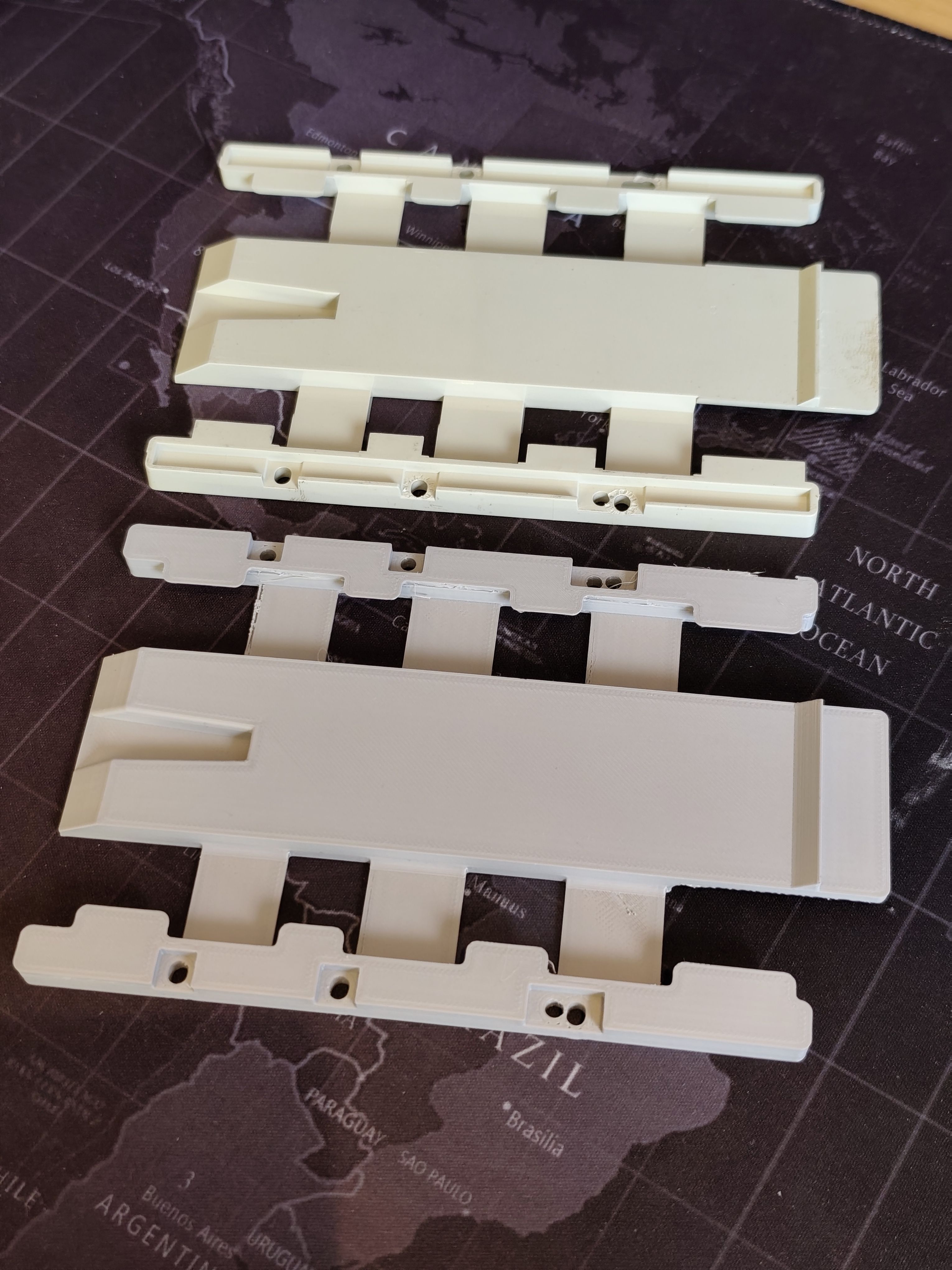

Ibook G3 battery pack
Oh, found another one, this one is tricky to print, and im not 100% happy with it but it is the Ibook G3 battery pack shells, i have assembled a pack like this and it does all fit, but it is not as strong as i want it to be.
i forgot the STP file there, so i have added it. IPT is for inventor
actually, this was not supposed to get posted yet, i will mend it today once i found the correct files :)

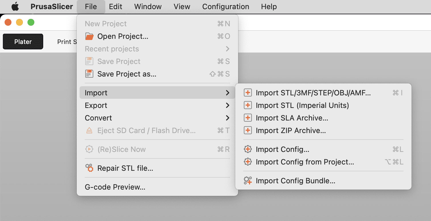

I can open and rotate STL files merely by selecting the file on my Mac and pressing the Spacebar for QuickLook, but how are STP files viewed?
it might be that STL files are natively supported and STP files are not, i generally use Linux, so i would not know :cool:
2,865
2,227
Hmmm.... The Mac version doesn't want to let me import STP...
If you cannot create an STL file (which all modern Macs support on the OS level), then perhaps you could post it to Printables, since that site has a built-in viewer, as you can see in this example...

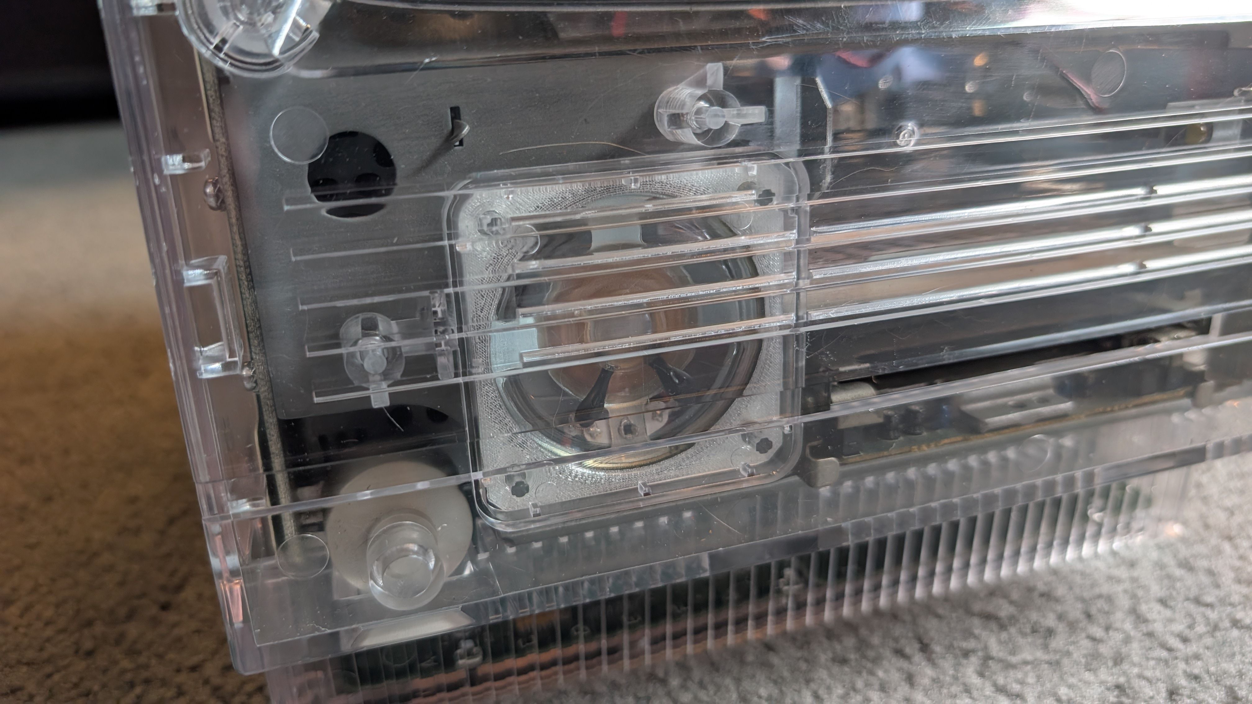

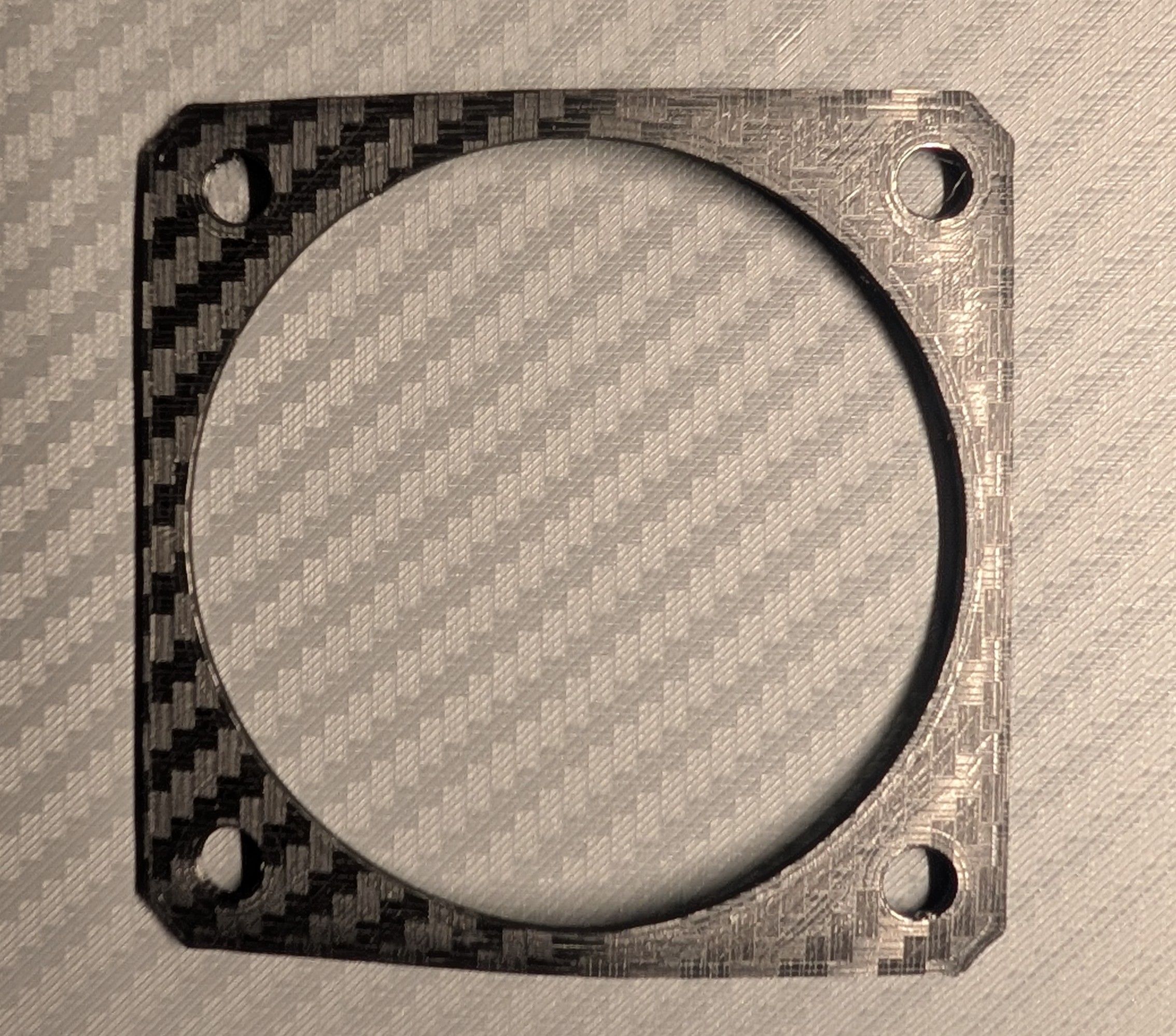

So I've been working on my Mac Effects SE/30 and thought I would share some photos of simple 3D prints I've made.
First up is a semi-transparent gasket for the speaker. I noticed that the Mac-Effects case omits the speaker gasket and I'm assuming that most people don't want to re-use the black rubber gasket from the original case in a clear case. I made a semi-transparent one with flexible TPU and I also have orange glow in the dark TPU that I haven't used yet but I eventually plan to swap this gasket out for that one. I looks nearly identical with the added ability to glow. Additionally I have made replacement black rubber gaskets as shown below in flexible PLA (left over from a 3D airless basketball project) in case there is a need for them in original cases.

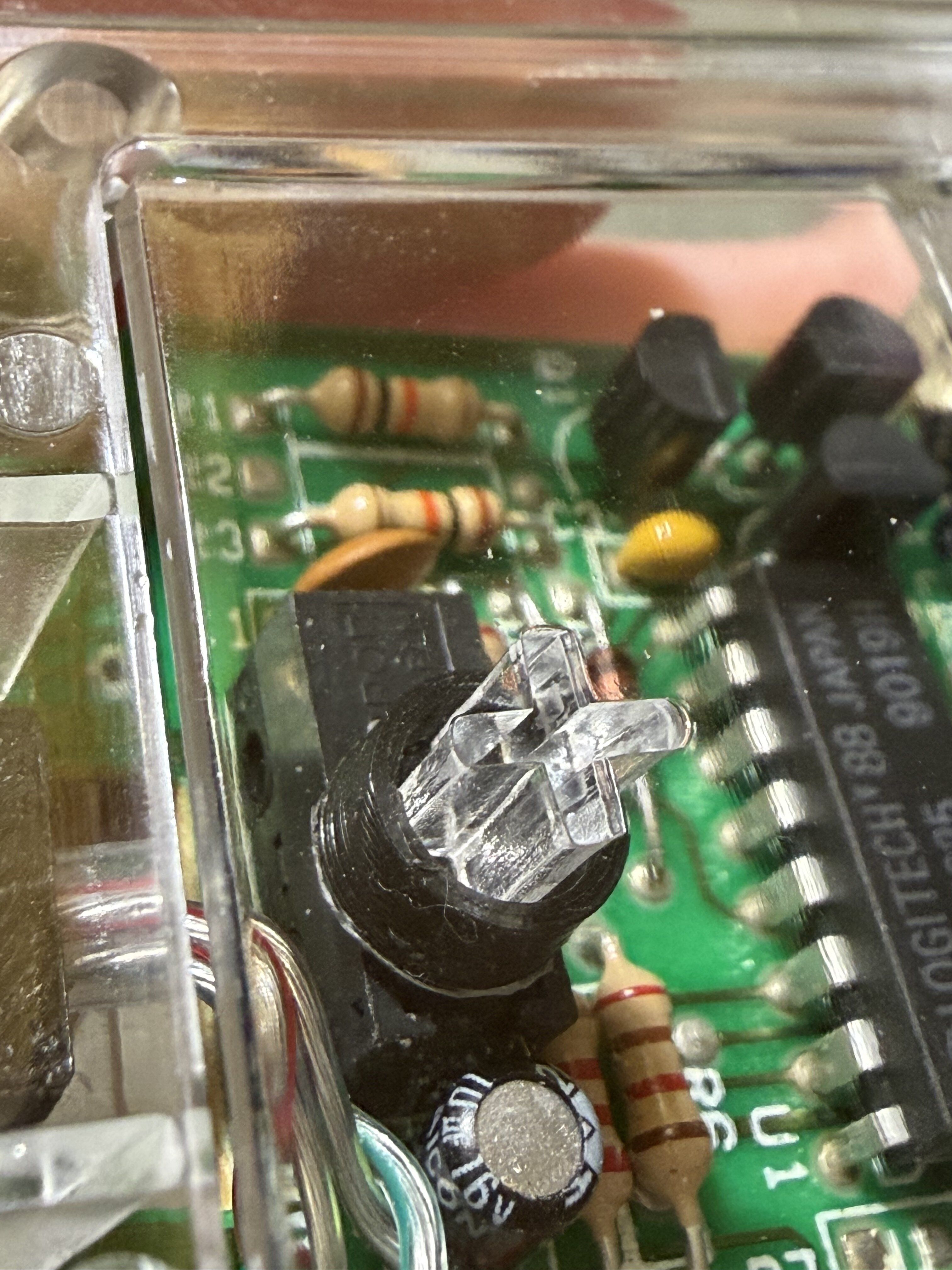

I also printed Caver01's brightness wheel in the same semi-transparent glow in the dark PLA filament. I still need to get around to installing it:

TPU is a tad more soft and certainly more squishy than PLA and other filament types, but is firm like hard rubber. Are you deliberately using TPU for a speaker gasket because it offers vibration damping and makes the sound from the speaker better? (Which is why you chose it over 100% transparent resin?) Or does the damping from your TPU speaker gasket cause a slight reduction in perceived volume levels?

TPU and Flexible PLA feel relatively similar when they are as thin as this since its basically solid infill at 1.5mm thickness. Holding the original gasket and my printed versions doesn't feel too much different to me in terms of texture and flexibility.
I used TPU because I wanted a material with similar flexible properties to the original gasket and for it to be semi-transparent to make the MacEffects speaker still presentable when looking at the Mac. I noticed that a lot of other people's MacEffects builds we're forgoing the gasket and I was concerned that vibrations from the speaker would resonate on the acrylic case without using something between it and the speaker like it was originally designed with. All said and done when playing audio from a stock SE/30 or playing audio from a MacEffects case with the TPU or Flexible PLA gasket; the sounds are exactly the same. Installing the speaker without the rubber gasket may be fine too given that i haven't seen comments about the speaker vibrating annoyingly on the case on other builds. I guess it just comes down to my own personal preference.

...playing audio from a stock SE/30 or playing audio from a MacEffects case with the TPU or Flexible PLA gasket; the sounds are exactly the same.
Thank you for that confirmation.
And just to add one detail... The clear MacEffects speaker looks great in the clear case, but because it is 8Ω and not 63Ω like the stock speaker, the maximum volume level of the clear speaker is lower than the stock speaker. The amplifier can't supply enough power for the low-Ohm speaker and the volume is reduced accordingly. That does not pose any problem. It is just an observation from my own experience with the clear speaker and stock.

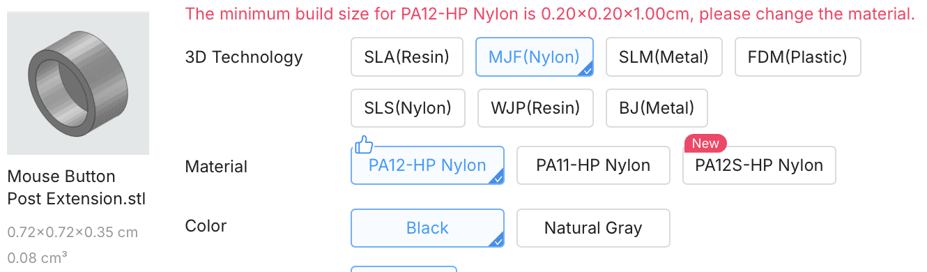

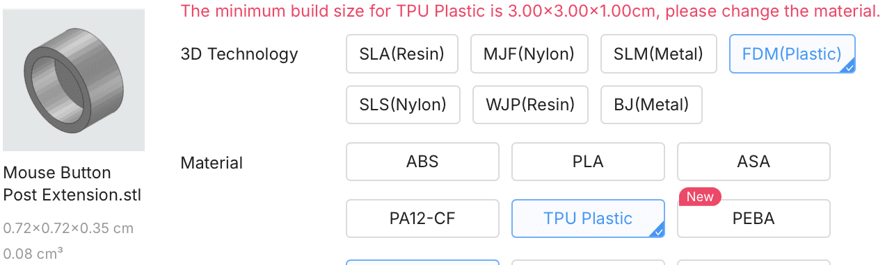

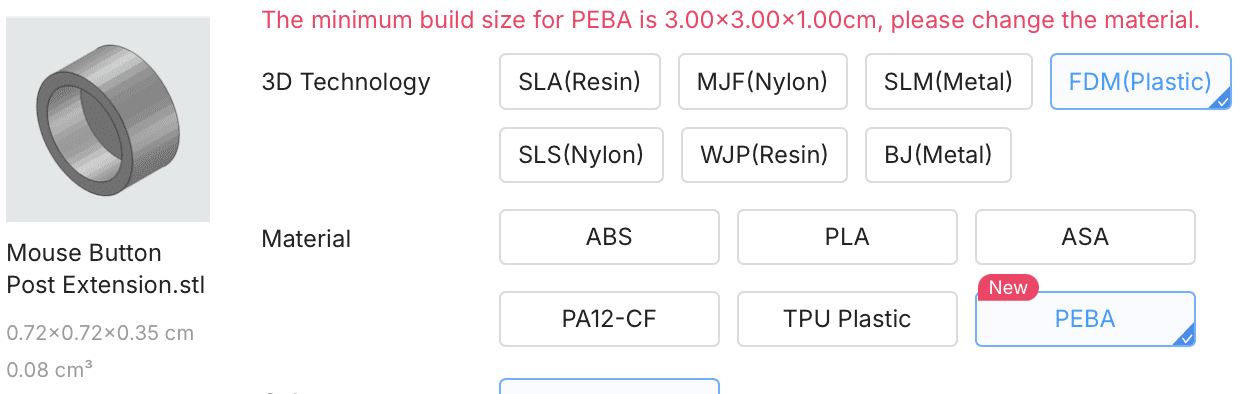

The difficulty in clicking my MacEffects clear mouse shell is why I stopped using the shell. Your fix might allow me to use it once again, but JLC3DP refuses to print anything so small, unfortunately. A dab of hot glue may work. I'll need to experiment.
How big does the brim have t be again? I printed mine with a brim because I didn’t want it to pop off the print bed it is so tiny. . . but that was slicer generated. I could make one with a .2mm brim built in. This is something you could probably knock together with a straw and baking soda + super glue at the bottom. I mean, it’s such a trivial shape and size, if i just looked around the house I would probably find some cast off piece of trash that would work. Maybe a Lego?
