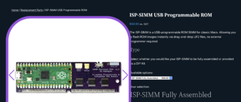

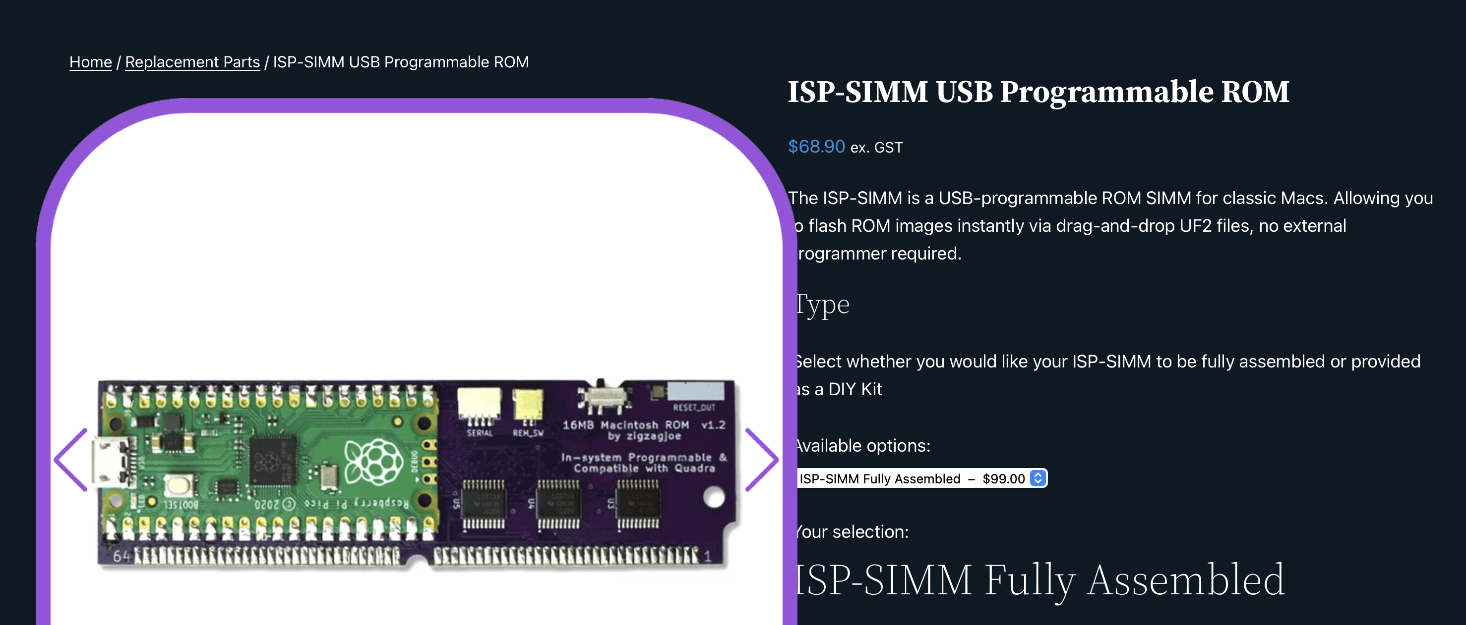

Wonderful! Thank you @joevt. I just spoke to zigzagjoe about his original product https://juicycrumb.com/store/?v=0b3b97fa6688 and if it could be one day modified for an ANS ROM. But that seems to be way too much work.
Which product is that? I just get the main page with that link. (But I love the JC HI-FI item! JC, you've done it again!)
@joevt, do you have something handy that can pull an ndrv out of a ROM, or is this something I'll have to whip up? I'm thinking of creating a modified Mac OS that will at least have internal video so it can work with either the pre-production ANS ROMs or the 2.0 ROMs.
Sorry not sure why that link is not working try this https://juicycrumb.com/product/isp-simm/?v=0b3b97fa6688
Thanks @ClassicHasClass I was really hoping to have it ready for my VCFMW display later this year. That still leaves us some time :)
