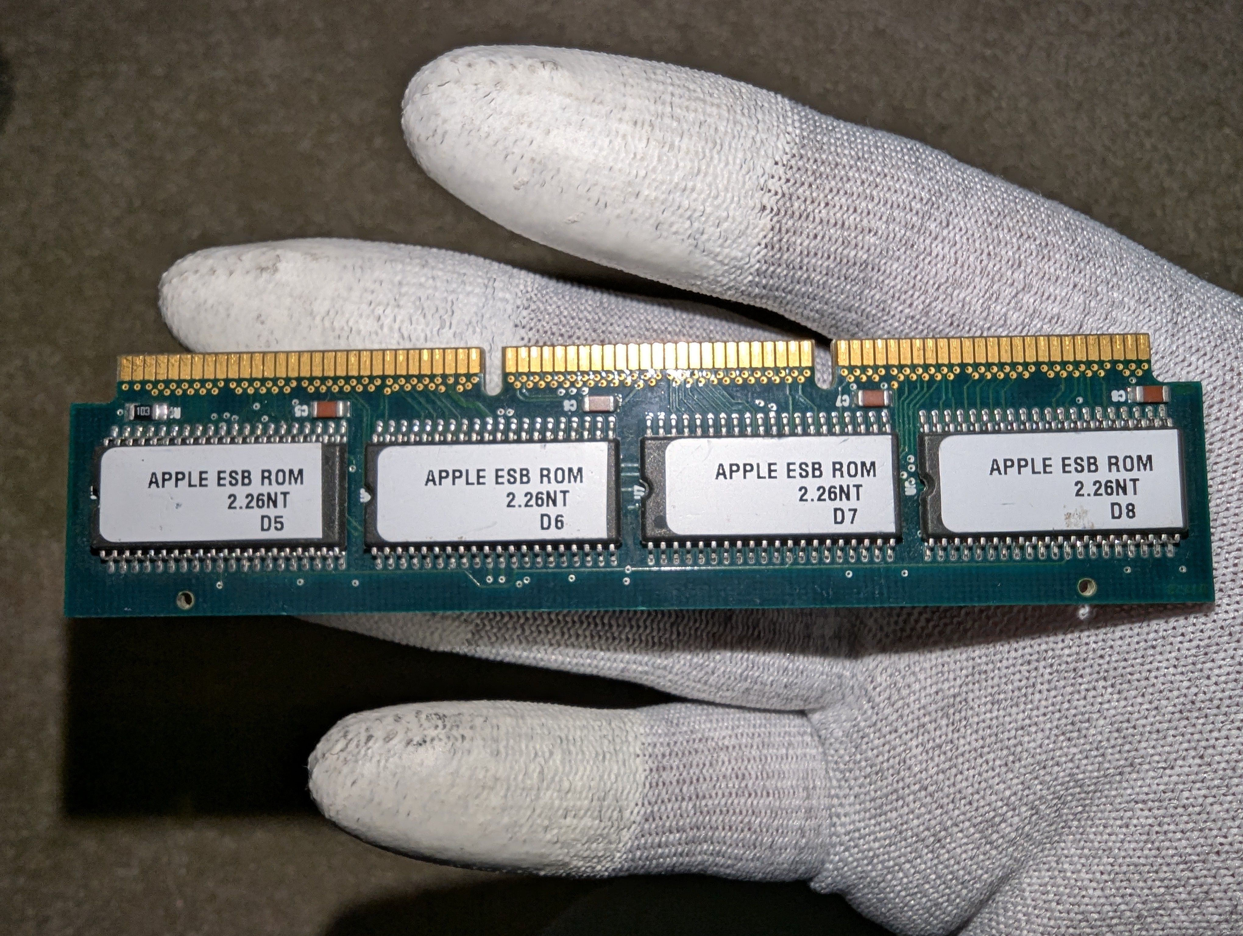

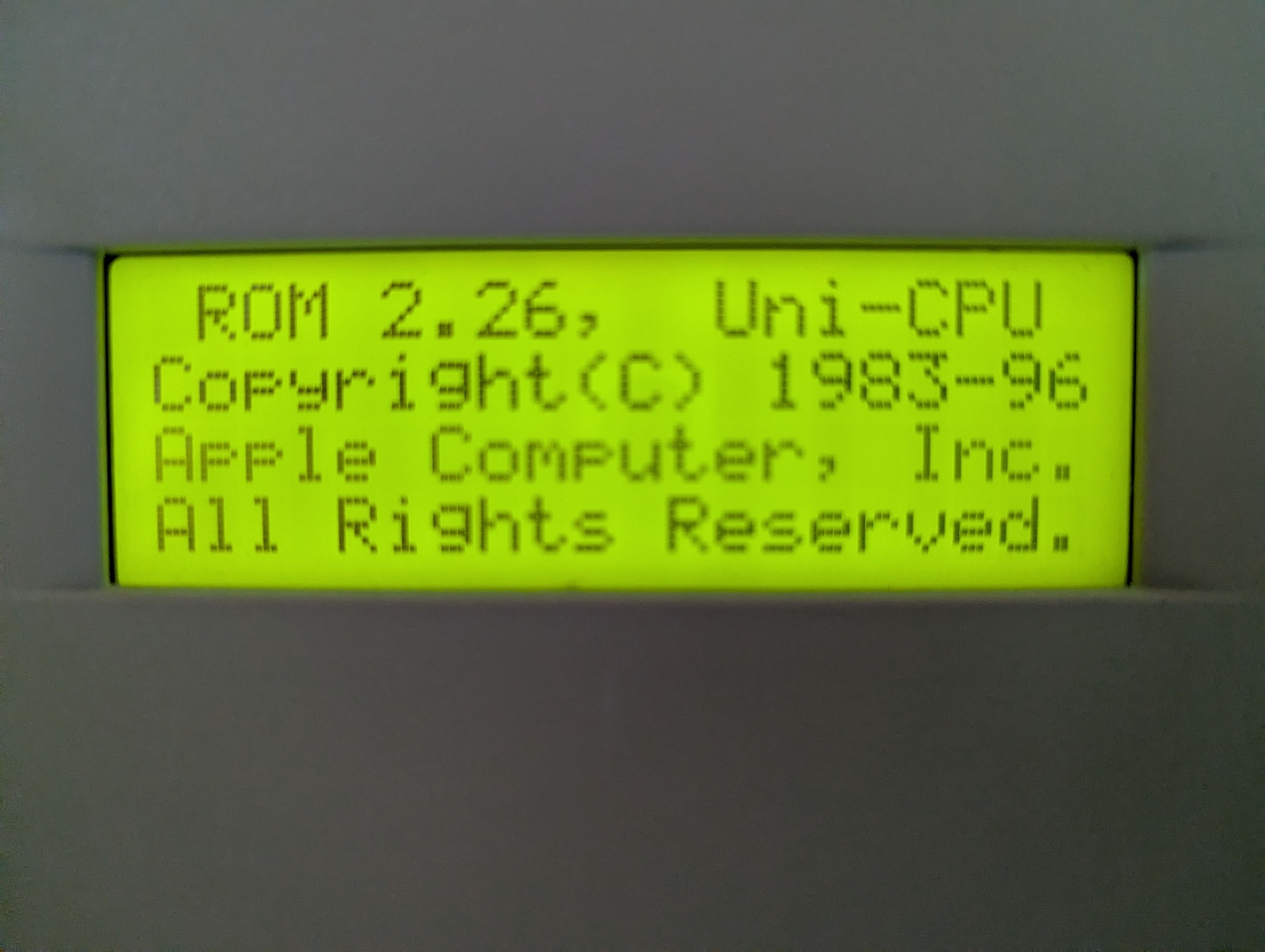

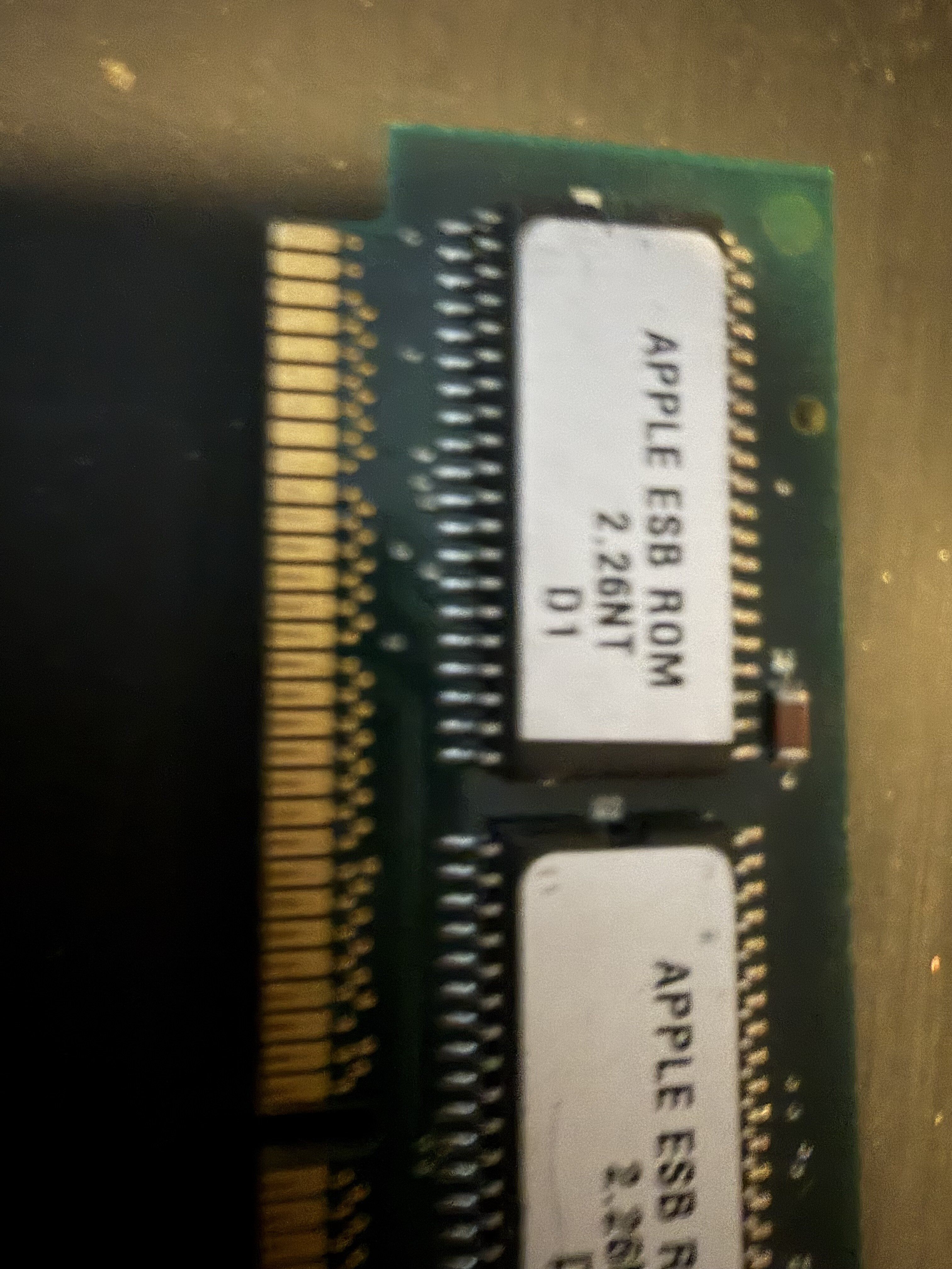

I pulled my test 700 from storage over the weekend and rehabilitated it (bad CPU card, bad slides on the logic board drawer). With that running, I received the NT ROM from @dbinreno and today was able to dump it. I attempted a naive boot directly from my Windows NT 4 CD-ROM and while SETUPLDR will load, it immediately bombs out with a CLAIM failed! no matter what the load base or real base are set to. Rairii (Windows NT on Power Mac fame) suspects there is a missing HAL for this, so we may still need another piece to get NT booting. I'll keep messing with it in the meantime.
That said, there are OF words in the ROM (attached) that directly reference NT that do not seem to be present in other ROM dumps, like init-nt-vars, maybe-read-nt-part, etc., that appear to create a section in the NVRAM specifically for NT. I do not know their purpose otherwise. Perhaps @joevt has an idea about that. It also reports itself as 2.26.
To my great shame, I also found in my box of tricks - some of which came from Apple Austin - a flash ROM very much like @johntucker 's that also turns out to have 1.1.20.1 (bitwise identical to his dump). I am able to get this dump to boot MacOS, with some extra work. I'll write that up after I've finished some additional experimentation - and yes, I will definitely try Rhapsody. :)
The first 3 MiB (68K ROM) of 2.26NT matches 1.1.20.1 and 1.1.22.
The last 1 MiB (Power PC ROM) of 2.26NT is very similar to 2.26B6. It has some additions that don't appear to be NT specific? In other words, 2.26B6 seems to have all the NT stuff also.
Open Firmware additions in 2.26NT vs 2.26B6:
  • _cold-init (the fcode called by cold-load) calls cuda-send with a couple zero bytes.
  • not-pci-pci-alloc? flag is added. It has something to do with f-seg which is a thing that exists only in Open Firmware for ANS. f-segment? is an nvram variable that controls this. not-pci-pci-alloc? starts out as true (normal result for use-f-seg?) but is set temporarily to false when assigning addresses to devices behind PCI bridges (use-f-seg? is forced to return false during that time).
  • A size word is added to fat-files, iso-9660-files. This word does not exist in any other version of fat-files or iso-9660-files.
Non-Open Firmware differences in last 1MiB:
  • ExceptionTable (Start): ?
  • HWInit: None except date.
Differences in the first 3 MiB:
  • Resources: None except dates in PEFs.
  • DeclData: None except date.
  • MainCode: two locations in the Universal Tables (view with my Hex Fiend) have different bytes:
    • SCSI96_2Exists is changed from true to false in BasesValid of InfoTNTProto1
    • SCSI96Addr1 is changed from 0xF3018000 to 0xF3010000 (same address as SCSI96Addr2) in the HHeadDecoder
  • ROM 2.26NT ANS 300 & 500 & 700.zip

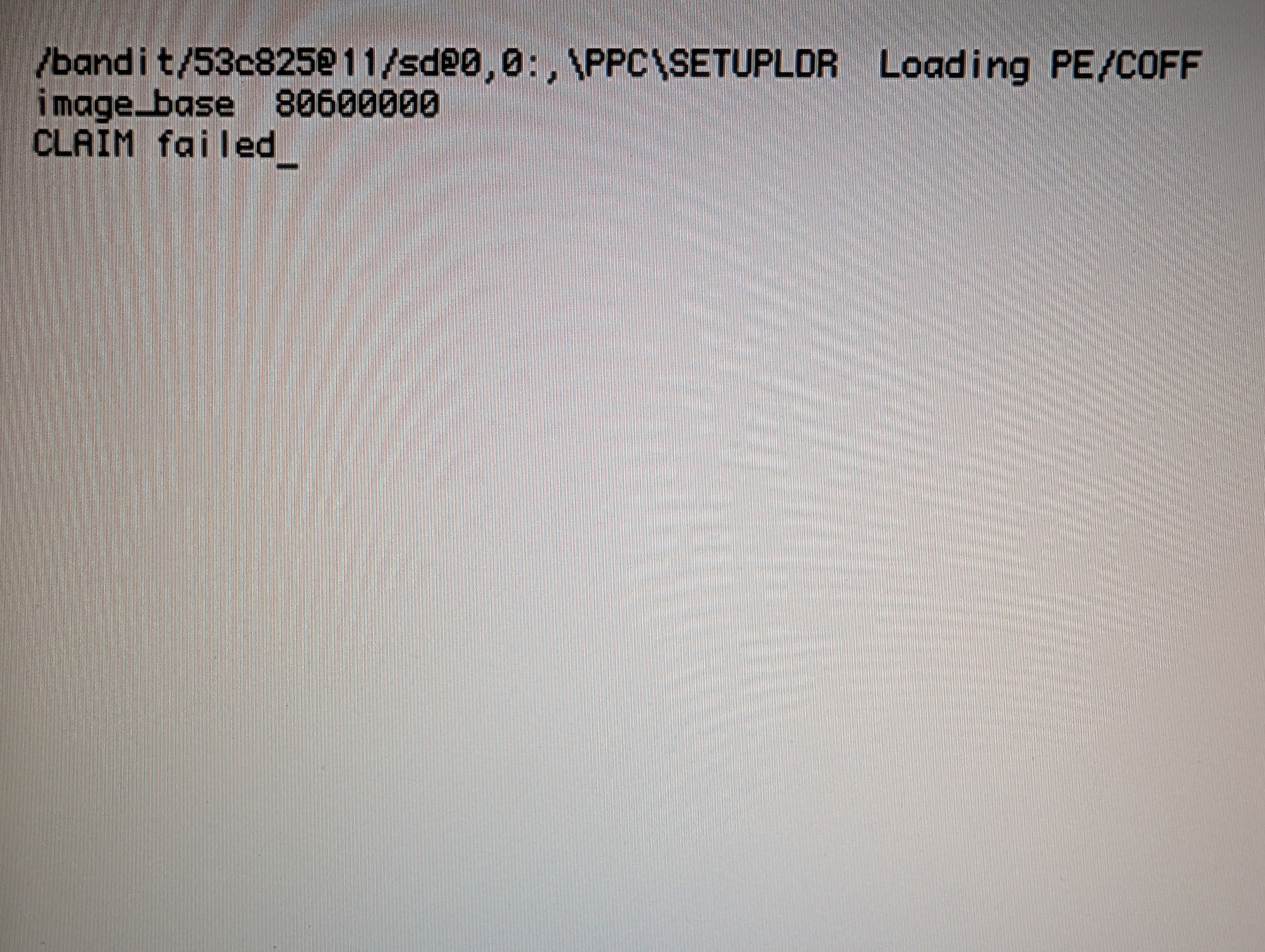

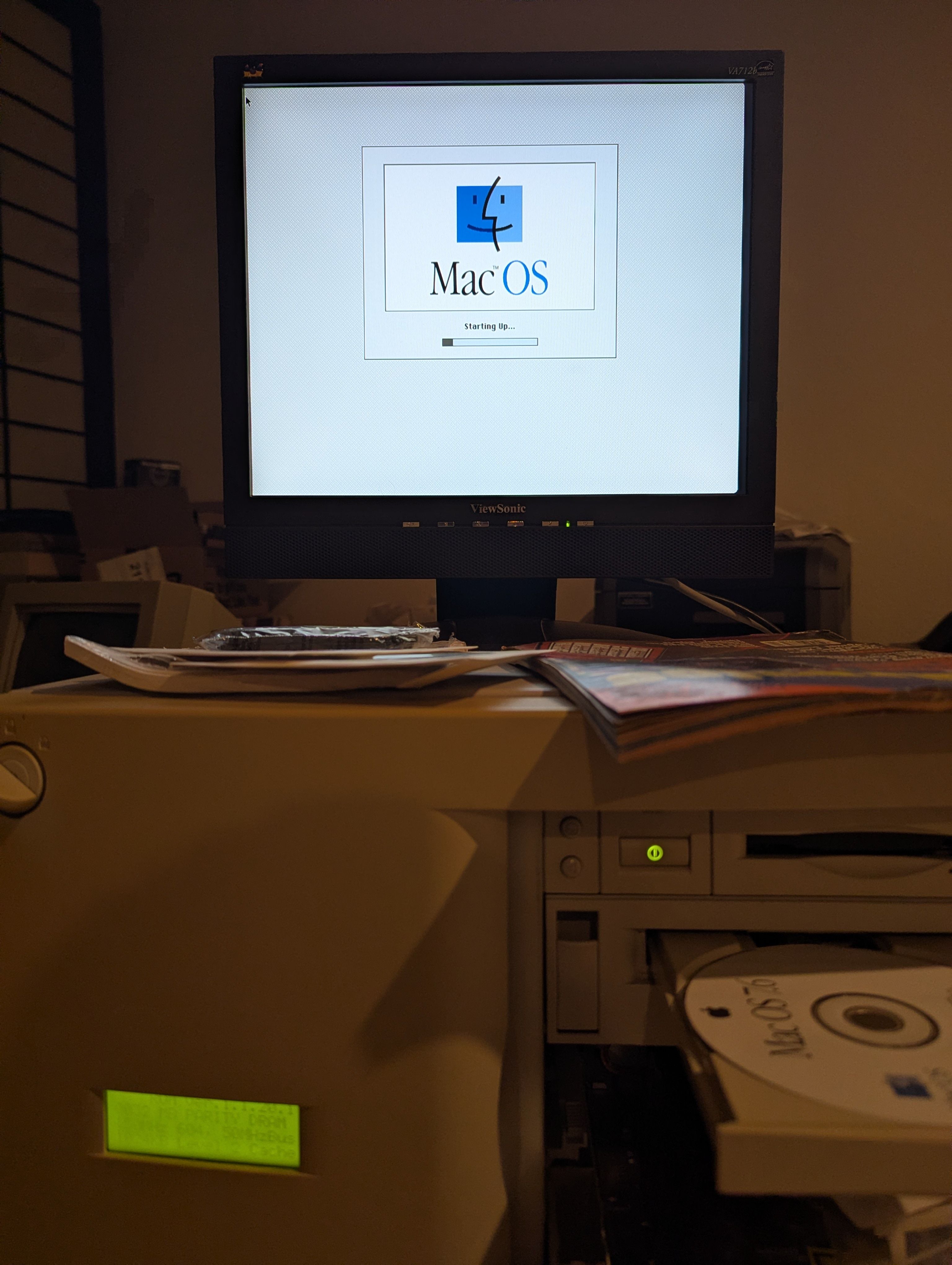

I didn't use an nvramrc to boot Mac OS on 1.1.20.1, it mostly just worked with the BYE command. It requires a supported video card, it will only boot from the external SCSI (so you'll need an external CD-ROM and/or CD images) and I'm currently investigating issues with Ethernet, though I haven't yet ruled out something wrong with the logic board. That said, NSDU gave it a clean bill of health with the production ROMs.
It is clearly less functional than the later 2.26 ROMs, but it does work in a basic sense. I'll be exploring 9.1 a bit more tomorrow, then Rhapsody, then possibly trying an XPostFacto boot to bring up 10.2.
Right. 1.1.20.1 and 2.0 have a normal implementation for AAPL,ROM's load and open words.
1.1.22.1 removes a call to <bye> in AAPL,ROM's load word and changes open to always return false.
2.26B6 and 2.26NT has normal load from 1.1.20.1 but broken open from 1.1.22.1.

No, onboard graphics and internal fast SCSI do not work in the 1.1.20.1 ROM. It looks like @johntucker 's 2.0 ROMs are the only ones that support this.
Since you mentioned the 2.2b6 and 2.26NT ROMs are very similar, I checked to see if the 2.26NT ROM will start /AAPL,ROM and it will not, not even with your nvramrc script, not even with an external video card and external SCSI device. It simply hangs after "MacOS requires PCI video card and external SCSI boot disk" and nothing is displayed on the video card.
If you can post your OF Extender here, I'll see about trying it (I don't use my account at the "other site" anymore).
