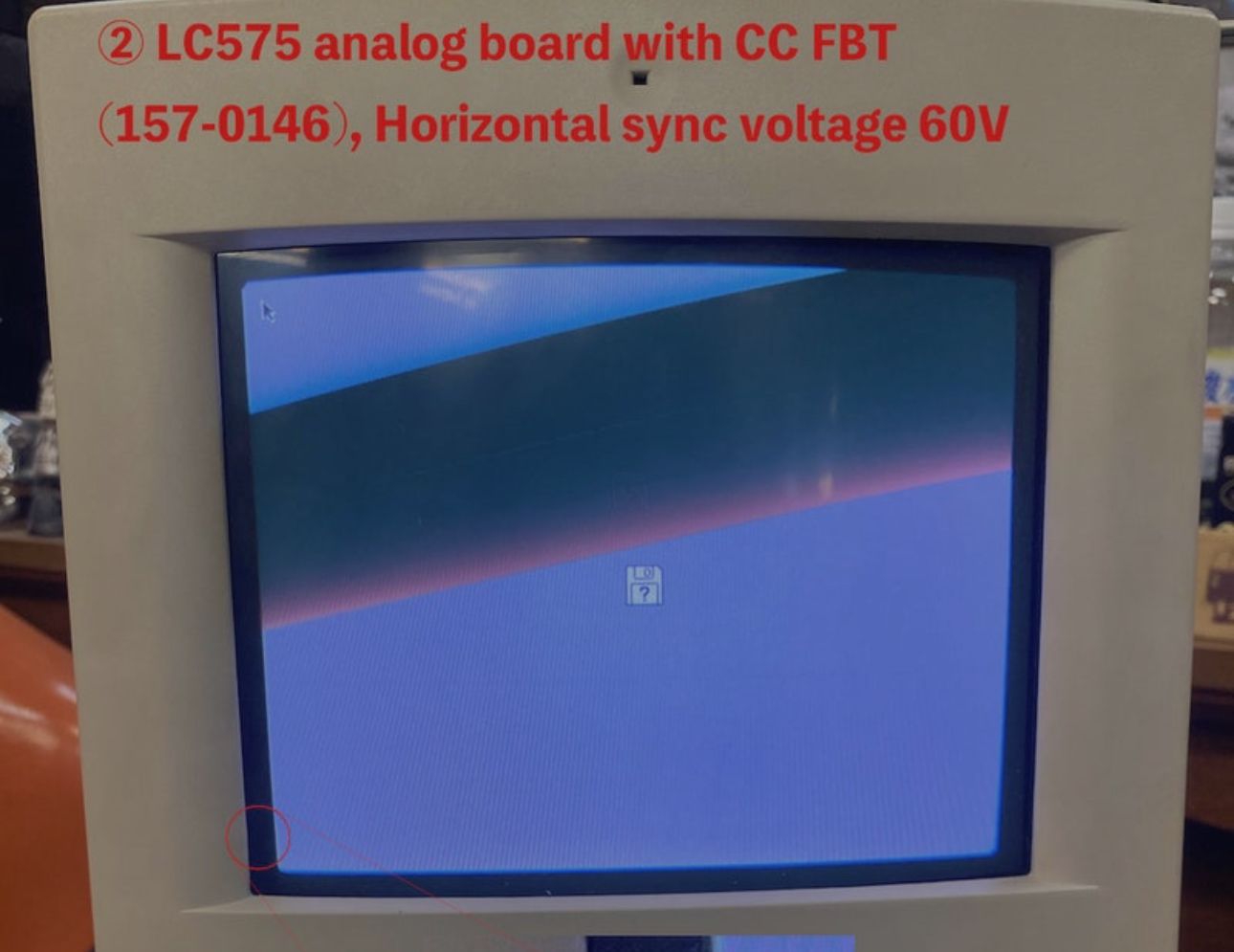

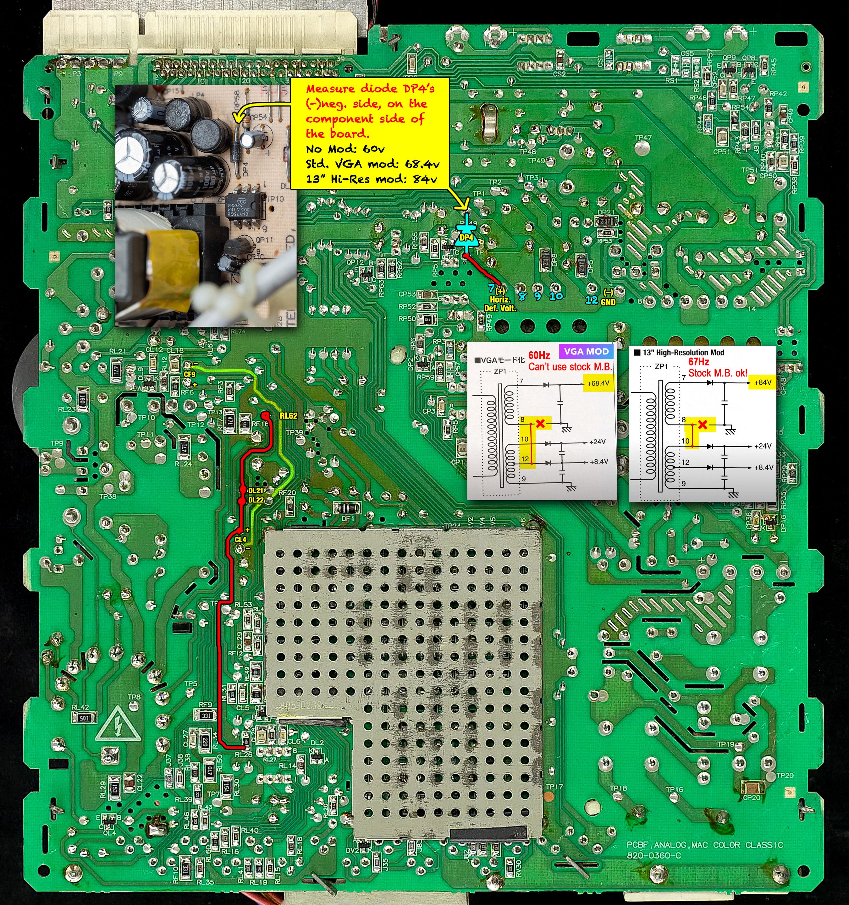

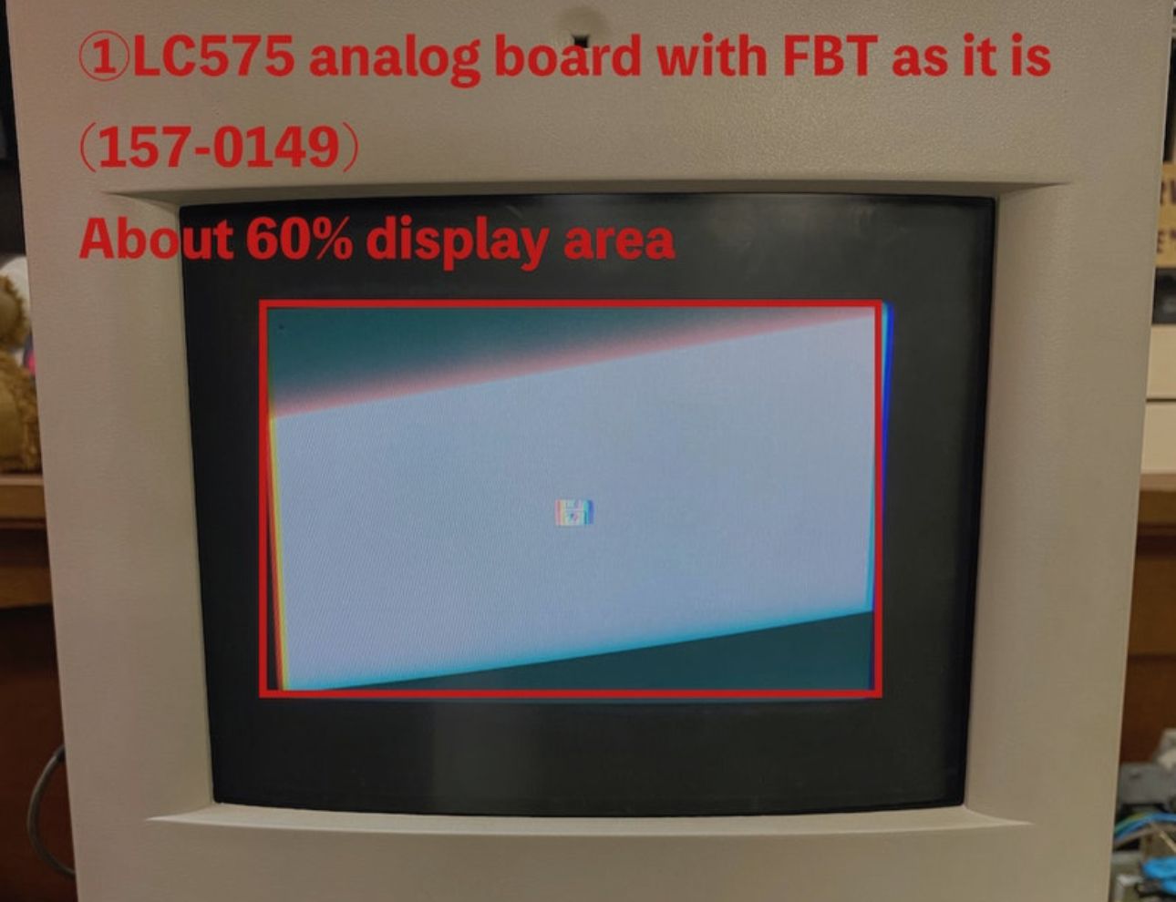

My intention is to do this parts "upgrade" first, and then I plan to change my Standard 68.4v (60Hz) VGA Mod to the higher 84V (67Hz) Hi-Rez Mod, which will finally allow me to use any compatible motherboard, such as the stock CC board, LC520 board, and LC575 board (all of which I have). I just wanted to touch bases with you prior to filming.

I measured 47.5V at the center pin of the horizontal output transistor, but I'm not sure if this is the right place to get the B+ rail.

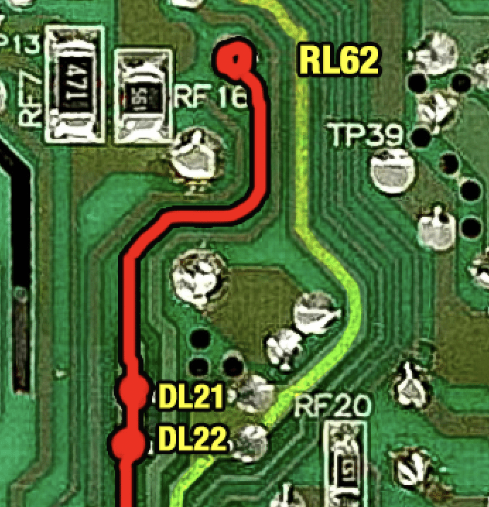

@YMK Very sorry to trouble you, but could you please mark on an analog board photo where that "horizontal output transistor" is located? I'm just curious where you were measuring when you started this thread.
As you can see below, I have marked up a photo of the bottom of the Analog Board (taken prior to the VGA mod). At left, you can see that those super-hot DL21 & DL22 Zener Diodes connect to the equally super-hot RL62 47Ω resistor. The other side of those two diodes leads to the ground side of capacitors CL4 & CF9. Then in the upper right, you see that diode DP4 is where the Horizontal Deflection Voltage should perhaps be measured, on the component side of the board, of course. (My machine is disassembled and I've not measured there yet.)

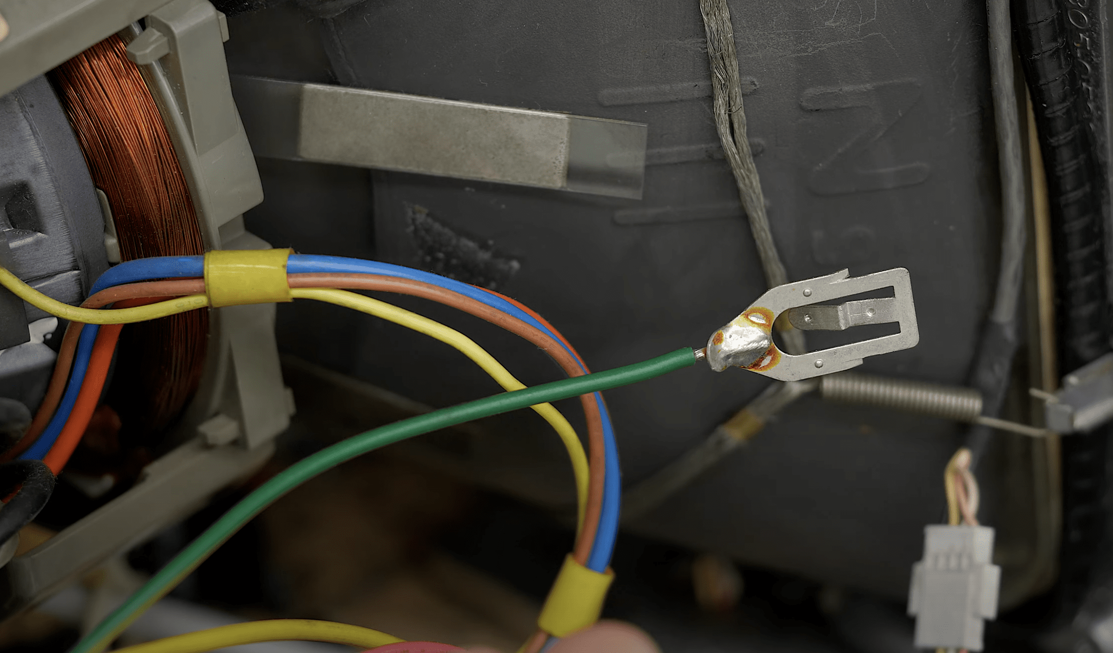

The only time I have ever had my screen stay black, hearing all the sounds you described AND booting too, is when I've got the CPU overclocked too fast for the VRAM SIMM. But I am using an LC575 board, and it seems you are using the stock CCII board, right? In other words, an LC550 board, I believe. I've never tried one of those boards, but I doubt you have it overclocked in any way, so there obviously must be some other reason for your black screen.
If you failed to reconnect something, it can have huge consequences. For example, @Kay K.M.Mods warned me in the past about ALWAYS reconnecting that green grounding wire to the main exposed metal ground during reassembly...
But I'm guessing you must have reconnected it prior to power on because Kay said it would destroy the motherboard if you didn't reconnect it, and since your machine boots, the MB must be OK.

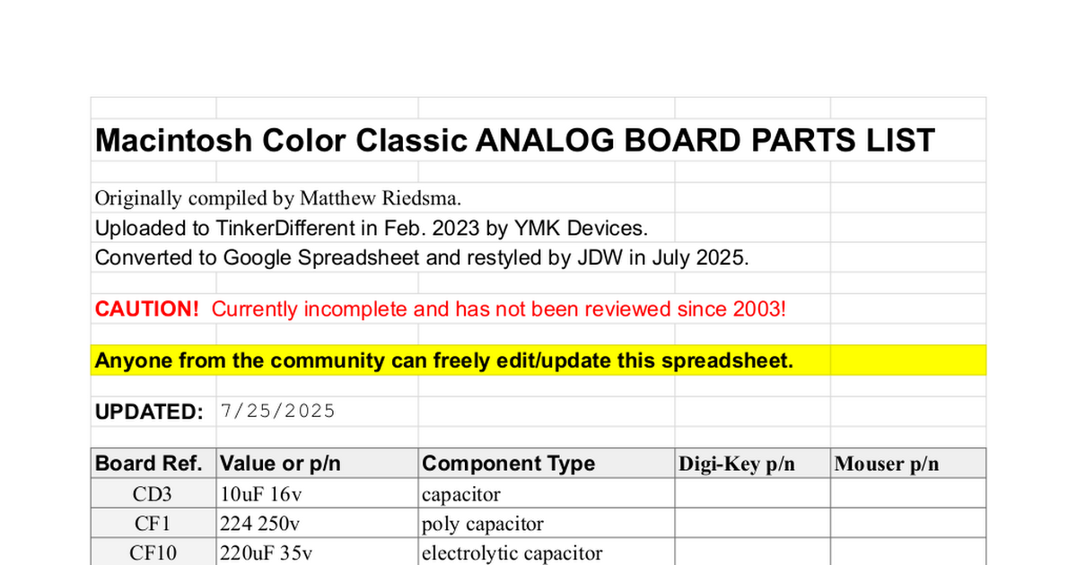

The attachment in the opening post by @YMK has a text file extension even though it is HTML, making it hard to open. I converted it to Google Sheets and improved the styling and layout. Anyone can freely edit and update it here:
Color Classic ANALOG BOARD PARTS LIST

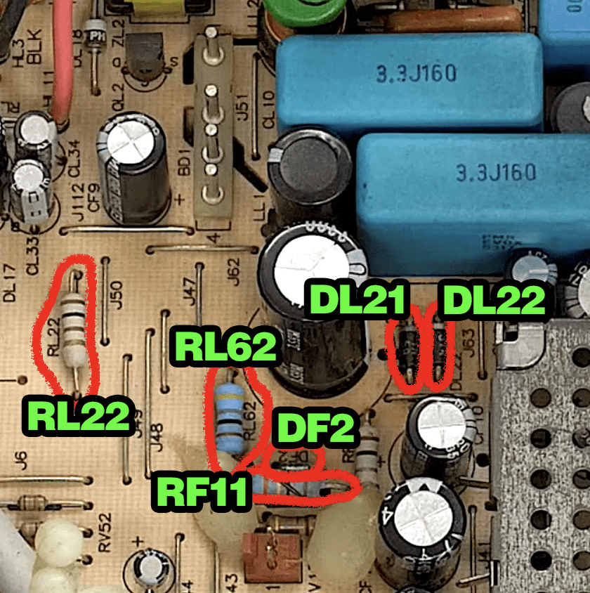

My filming of the component swap is finished. All replacement parts were raised up and off the PCB for better cooling. It passed the SMOKE TEST. No changes to the way the picture displays on the CRT either. Great so far!

REPLACEMENT PARTS
RL22
100Ω 5W 5% Axial Metal Oxide Resistor
Stock part: Body color=Cream, Dimensions=3.0mm x 8.75mm (possibly 1W Metal Film)
RL62
47Ω 5W 5% Axial Metal Oxide Resistor
Stock part: Body color=Blue, Dimensions=3.45mm x 8.5mm (possibly 1W Metal Oxide)
RF11
390Ω 5W 5% Axial Metal Oxide Resistor
DF2
8.2V Zener 5W (Izt=150mA): 1N5344B-TP
Stock part: 8.2V 0.5W Izt=20mA 1N5237B
DL21 & DL22
Remove both stock parts. Replace with 1pc of 1N5355B 5W 18V (Izt=65mA) Zener
Stock parts: 18V 1.25W Izt=20.8mA 1N5931B

ANALOG BOARD PARTS LIST (caps, etc.)
