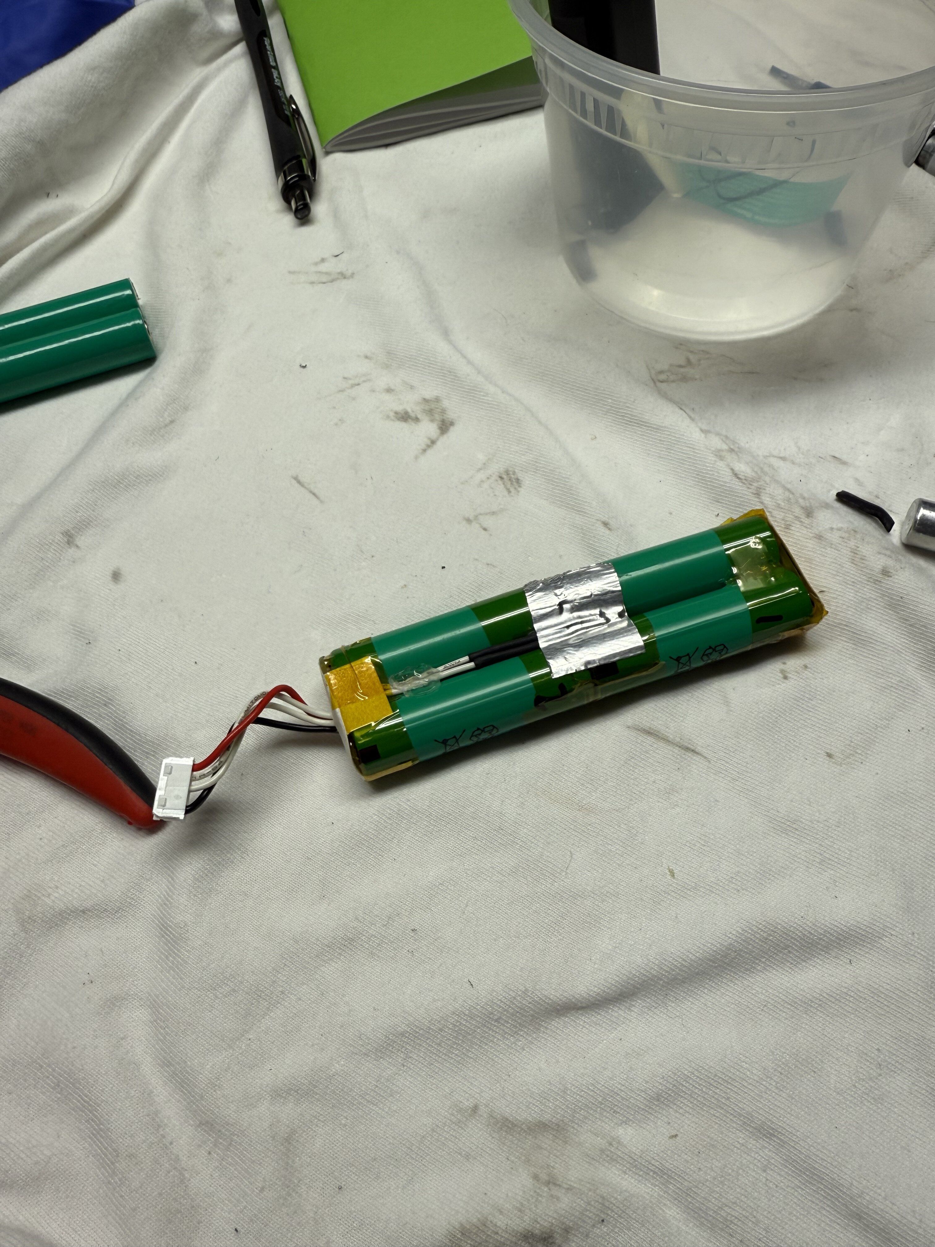

Great question. I would absolutely do this again and you have even a little skill with the soldering iron this is pretty simple. I would suggest getting tabbed NiMH cells unless you have a battery spot welder. I considered getting one of those mini ones because they are inexpensive and I have seen a few reviews, but opted for tabs and glad I did.
I followed this guide here:
https://www.pda-soft.de/emate_battery_pack.html
which was a fun read and very good instructions. I'd say the trickiest part of it by far is carefully peeling the adhered components off the old pack--paper stickers on the ends and foil covering the thermistor. If you are slow and methodical with an x-acto knife or fine tweezers, you can get all of this off with ease and no damage. Also, the switch on the end cap of the old pack needs to come off which is prying it off the spot welds. Not an issue, but you just need to be careful and use a side cutter or needle nose.
Other than that, my tips are to have some Kapton tape ready and a stick of hot glue makes all the difference holding everything together. You don't even need the hot glue gun--just a few mm of the glue stick which you can nip off pieces with a wire cutter and tap into place with a hot iron tip. The glue easily melts and you can lay it between the touching cells to hold them together and it only takes seconds to harden. You don't need much. See the guide.. Glue cleans off the iron easily.

I will add that you could probably get away with vinyl electrical tape to hold the pack together. It won't be as smooth--heck, even I didn't have big shrinkwrap--but if you keep tape layers to a minimum it should easily slide back into the plastic case with the clips, and there's plenty of room with the foam spacers inside the eMate even if it bulges a little.
I did not take detailed photos of the soldering, but everything happens on the battery tabs. When lining up two cells end-to-end, just line up the adjacent tabs (positive on one with negative on the other) like a little set of wings sticking out, and solder the tabs together. Done right, you can bend them flat against one of the cells.
When bringing the two joined cells together as a 4-pack, rotate the m so that the tabs you soldered are angled next to the touching edge. Dab some glue to hold the sets together.
Finally, the switch which came off the old pack goes on the endcap opposite the wiring harness. This was spot welded, but you can flatten the contacts a little and tin them, then bend the tabs from your new pack into position so they can be soldered to the switch without anything sticking out beyond the radius of the cells. It doesn't have to be perfect. Paper insulation will go over this (you saved it right) and there is plenty of room if your soldering isn't perfect.
Take your time with the wiring harness and care with the thermistor. Cleanly tape it all up and put it in the case.
