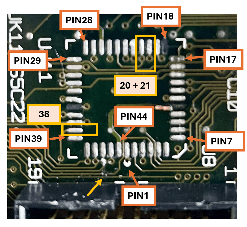

Thanks for your input. Attached is a photo of the UJ11 location where the blown chip has been removed. 3 of the connectors have been damaged (see photo) so I'm concerned I might not be able to solder a replacement chip should I find a dead Mac SE30 board ... Can it be fixed ?
Whilst I found the schematic of UJ11 here, I'm looking for a way to read the real chip pin allocation on the board i.e. where shall I start reading pin 1 and next ones? I noticed all chips are surrounded by 3 perpendicular corners and a single diagonal corner. I guess the diagonal suggests to start reading pin 1 from the top but I'm not sure. If this is correct, the broken connectors are 16,33,40. On the previous schematics, I can see that 40 is connected to A10, I don't see anything with 33, and I'm not sure if 16 is the one next to Part of UH7 that goes to the disc drive port.
If I can't find a replacement chip, would it make sense to connect some connectors e.g. via a 10kΩ resistor to +5V (ex : 20, 21 for the read/write select lines, and 38 for SEL SWIM ?
If I remove the ROM & RAMs, should a regular/working Mac SE 30 boot fine without the horizontal lines ? I'm getting lines with or with them.

The suggestion I got won't work so I'll look for a SWIM replacement unless I figure out how to wire some UJ11 pins to remove the error (these schematics can be useful). Attached is my understanding of the SWIM pinout ; is it correct ?
2,621
2,037
Incorrect.
Pin-1 is marked on the PCB and on the chip itself with a dot, and it should follow this diagram:
You also need to verify if the trace I've circled is broken, because it looks that way. It must not be broken.
Reactions: billbucks
billbucks
Oct 23, 2023
75
14
Hi,
I'm going to make an attempt to fix the board without floppy drive support.
Attached is an updated view of UJ11 connector's pins positions based on your reply.
I'm planning to connect pins 20, 21 and 38 to 5V, each via a 10K resistor. Does it make sense ?
Where should I find a suitable 5V output on the Mac SE30 board ?
I will also look at fixing the broken trace.
Thanks

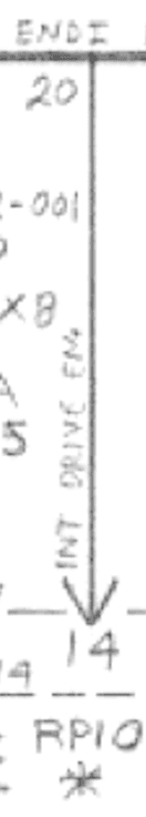

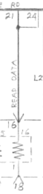

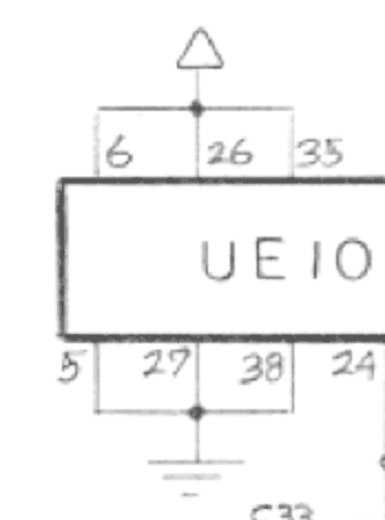

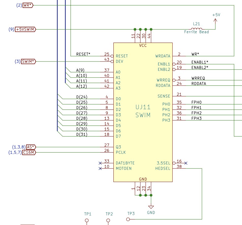

2,621
2,037
Your pin numbering is correct for UJ11.
But you are saying that UJ11 pins 20, 21 and 38 need to be pulled-up to 5v via 10kΩ resistor. How did you determine that? Because on the schematic, I see pin 21 is tied to pin 24, and that is labeled READ DATA, shown to be an output according to the arrow direction...
Pin 20 appears to be Internal Drive Enable...
And I'm not seeing pin 38 on the BOMARC, but I did find it on the modern recreation of Apple's schematic, marked at HEDSEL...
The above schematic also shows VCC is +5v, but pins 11, 22, 30 & 44 are going to +5v through a ferrite bead (noise filter) at L21.
The BOMARC schematic is also saying this marking represents +5V...
So for example, the UE10 chip has pins 6, 26, and 35 all going to +5v...
You should reference the full schematic to see which pin of all the chips are going to +5v, and then you can pick which pin to tap.

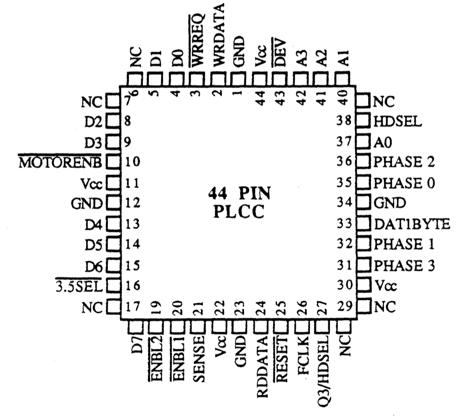

Well, for important matters like this, I myself wouldn't trust ChatGPT, and I see you aren't either, which is good. We must also try to never "assume" either, which of course is why you are speaking to me in this thread. Well, the only thing I can do is what you can do — find pinouts and technical docs for the SWIM. I Googled and found this:
As you can see, it says pin 38 is HDSEL, and it describes it this way:
"This output may be used to select the disk side to read to or write from on some drives, or may be used as a general-purpose output (44-pin PLCC only)."
That same document shows the 44-pin PLCC pinouts too:
So that answers your question in the affirmative about whether pins 44, 11, 22, & 30 are Vcc. But you could possibly measure at those pins/pads with the machine on to confirm +5v is there.
The same document says pin 43 is overbar-DEV, which can be written /DEV or said "not DEV" and is described this way:
"This line is used to select the chip for reading or writing data from the processor."
The bar means it's Active LOW. So if tied to +5v, it would never be "active." The chip would never be selected for reading or writing data.

billbucks
Oct 23, 2023
75
14
Thank you for the link, it is very interesting.
I looked at pins linked with the CPU that would be worth connecting to the GND (pin 1) or 5V (pin 22 Vcc):
43 (/DEV = Device select) --> 5V
25 (/RESET) --> 5V
37/40/41/42 (A0-A3 : address lines) --> GND
Do I need to add a resistor before the 5V e.g. 10k ?
2,621
2,037
Again, I am no expert on these SWIM chips, nor do I have experience toying with them as you are. But any signal-level pins like RESET, DEV or even Address lines shouldn't be requiring a lot of current, so using pull-up or even pull-down resistors should be very safe and achieve your aims too. As to the resistor value required, it really depends on the current flow. But because we are talking about signal level pins here, I don't see why a resistance value of 10kΩ being chosen wouldn't work just fine.
