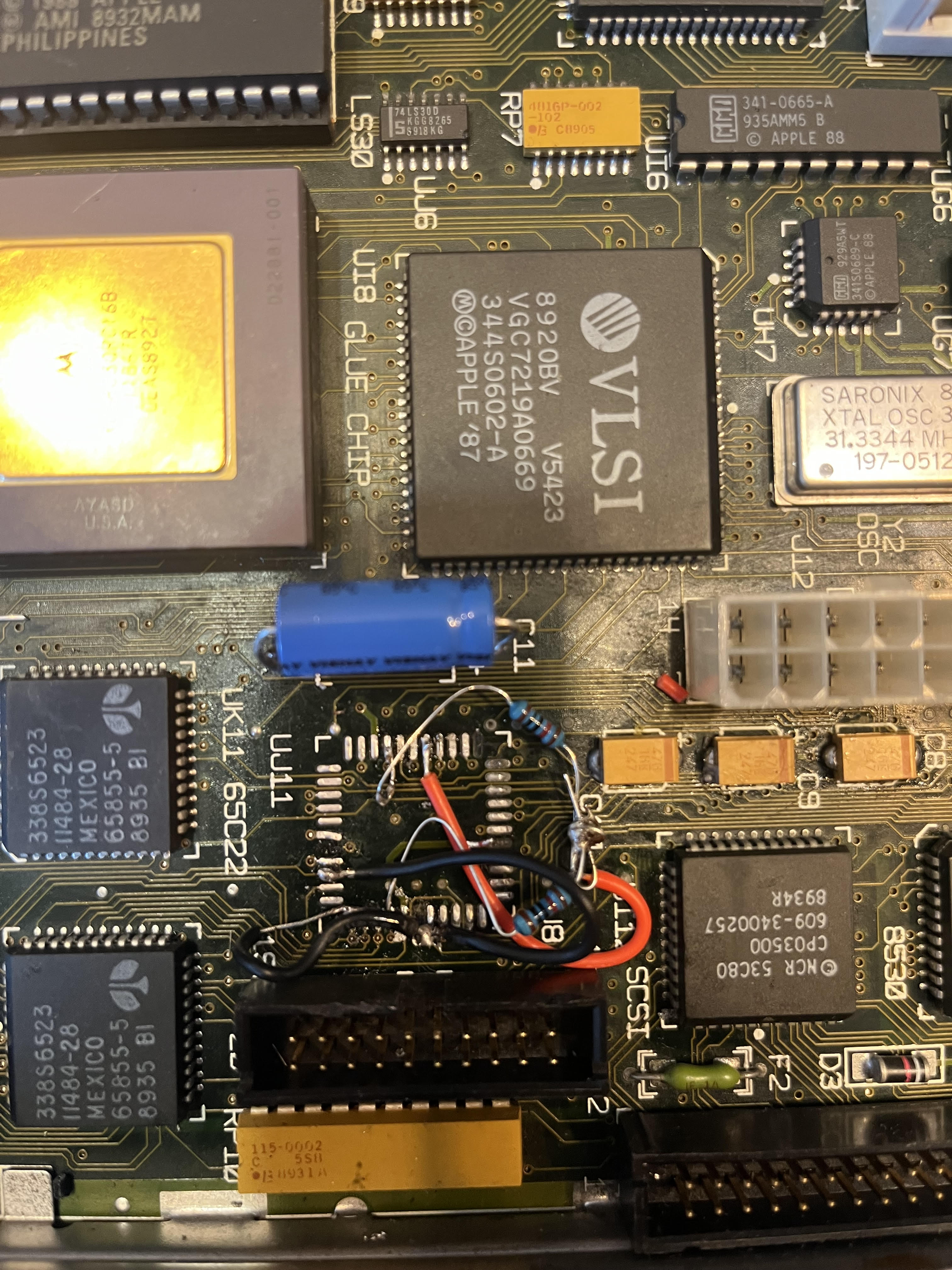

I finally managed to solder the SWIM chip pins as discussed (see photo) but that didn't fix the issue. I'm still getting the horizontal lines.
I used my digital multimeter to test the capacitors on the motherboard. Some of them don't have the expected value e.g. 1.3mF for a 47µF so I guess I have to desolder them from the motherboard to check if they need to be replaced.
