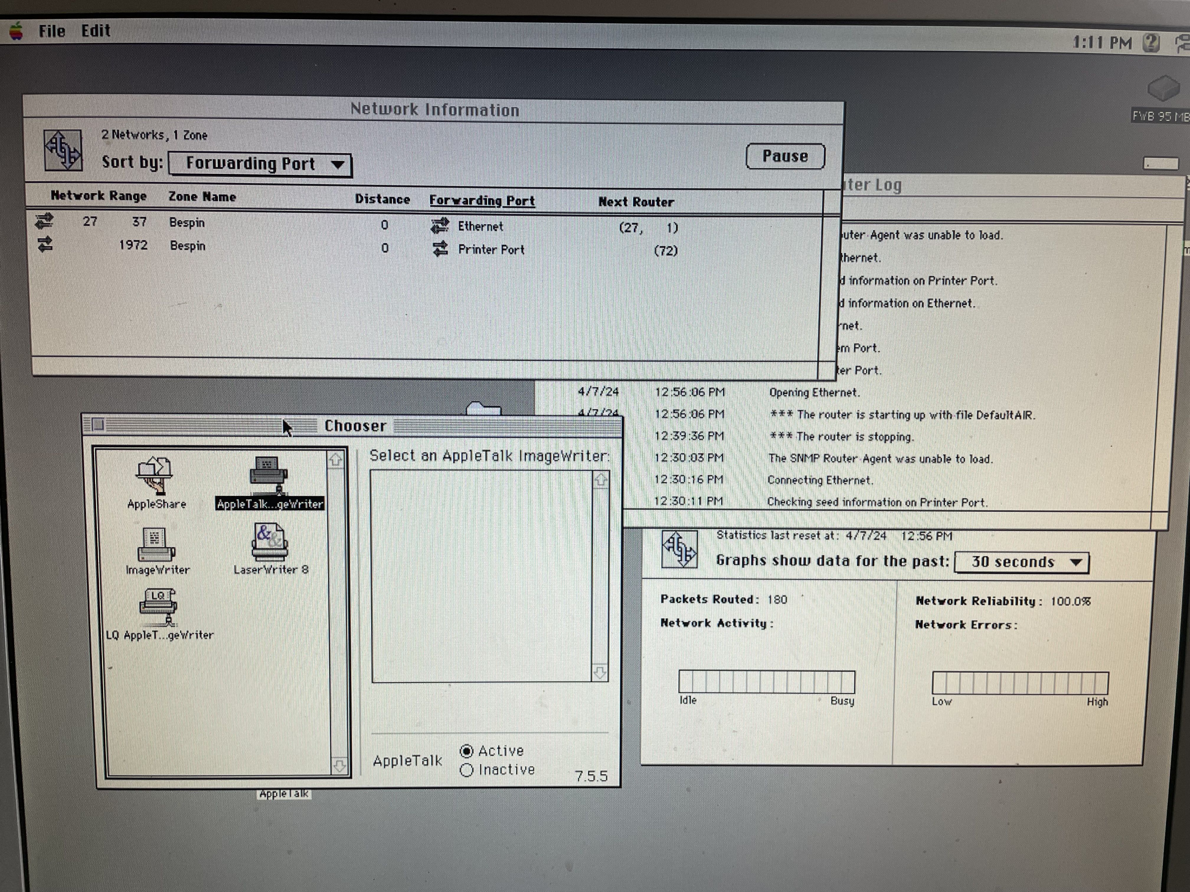

michelefrost
Mar 29, 2024
Hello globaltalkers... I think I made it but I can't see anything in my zones... so I did not :D
I used Petar's image that @Byte Knight shared, which I understand is already updated, patched and ready to go... right?
I do have an Apple Internet Router up and running on my IIci, range and zone (hopefully) configured, but I see no other zones in my Chooser.
In the log I see that SNMP Router Agent was unable to load.. does this affect GlobalTalk settings? FWIW, web browsing is working with no problem.
BTW file sharing is not possible using this disk image, as the extensions and controls to run it are disabled, but I was curious at least to see some live in my zones box... while I do not even see a zones box!
Any hint super appreciated! thanks in advance.

Check in excel list that you have unique zone range not used by anyone else and that your router share open port.
michelefrost
Mar 29, 2024
router has UDP 387 open... but zone range might be overlapping with another. I will change and test again.

Looks like your Network control panel is still set to Printer Port instead of Ethernet.
michelefrost
Mar 29, 2024
Turned off printer and modem port, fixed the zone range to a free one (and updated the shared list), ADDED SOME HOST IDS to the router settings (this I did not do before), and now I see zones - but I don't seem to see shared folders or printers. Maybe because sharing in this disk image is off? I already know I will spend some nights to make this work :D

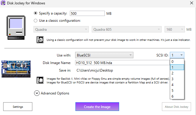

  • Disk Jockey can be used to make new images (thanks Ron), make sure you select the BlueSCSI format https://diskjockey.onegeekarmy.eu/

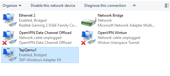

  • go to openvpn and get Windows 64-bit MSI installer for the TAP https://openvpn.net/community-downloads/ and install it
  • once installed go to Windows "View network connections" (ie typing that in the Start search bar) View attachment 15576
  • rename the TAP-Windows Adapter V9 to "TapQemu1" so that the batch file recognizes it when it launches QEMU later
  • ctrl-left click on both your regular internet providing network and this Qemu1 network so that they are both selected at the same time
  • right click on the selection and choose "Add to Bridge"
