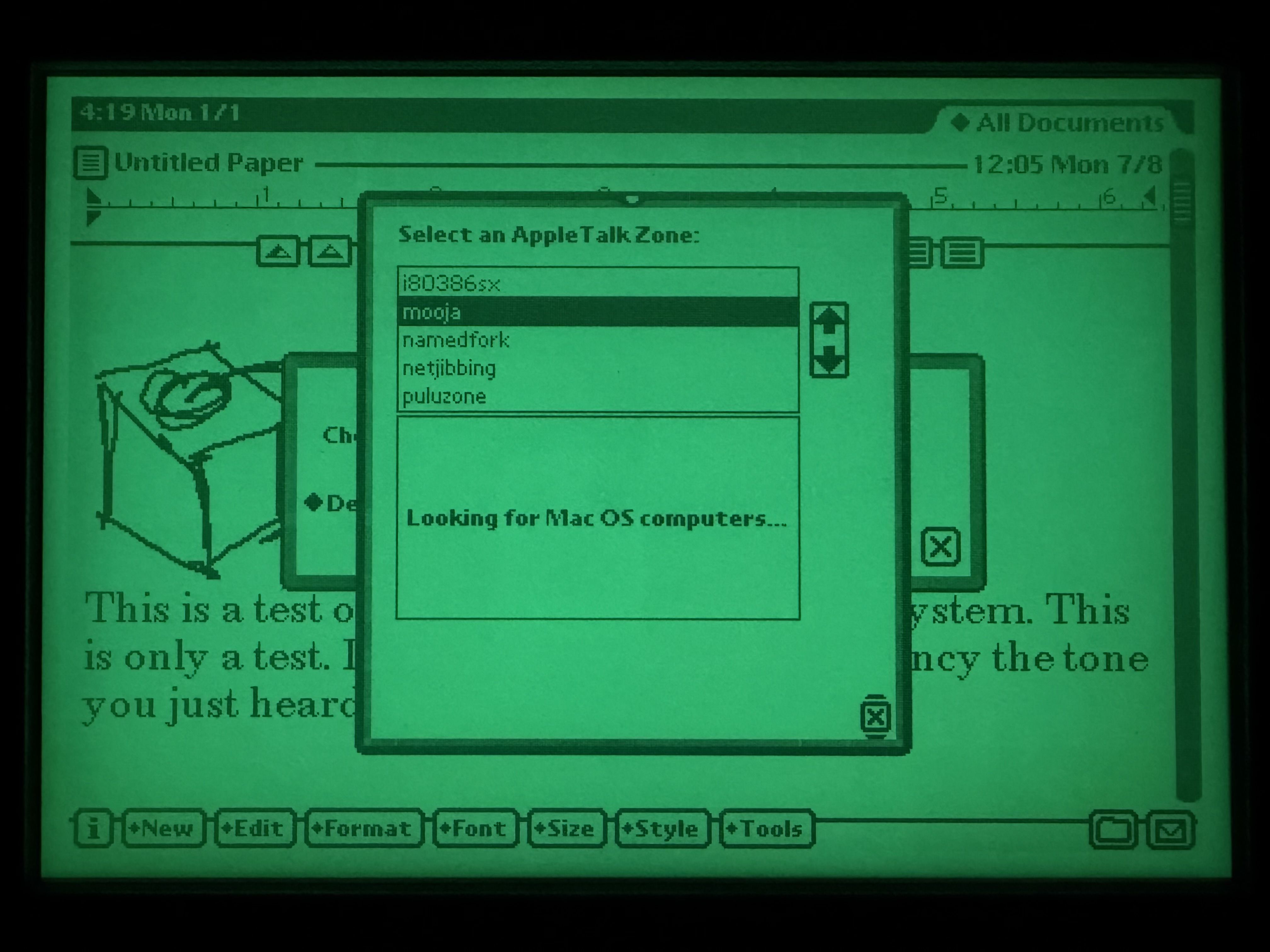

Haven’t seen anyone mention this (haven’t specifically searched yet), but I see GlobalTalk zones from the eMate!
Not sure what else I can do with AppleTalk from a Newton device, but it works (via PhoneNET connectors). Kinda neat. I guess I could sync from my eMate to halfway around the world!
Reactions: misterg33
fergycool
Mar 13, 2025
Haven’t seen anyone mention this (haven’t specifically searched yet), but I see GlobalTalk zones from the eMate!View attachment 27255
I've tried printing to LaserWriters on other zones from my eMate. Not yet sure if any of the prints worked! :)

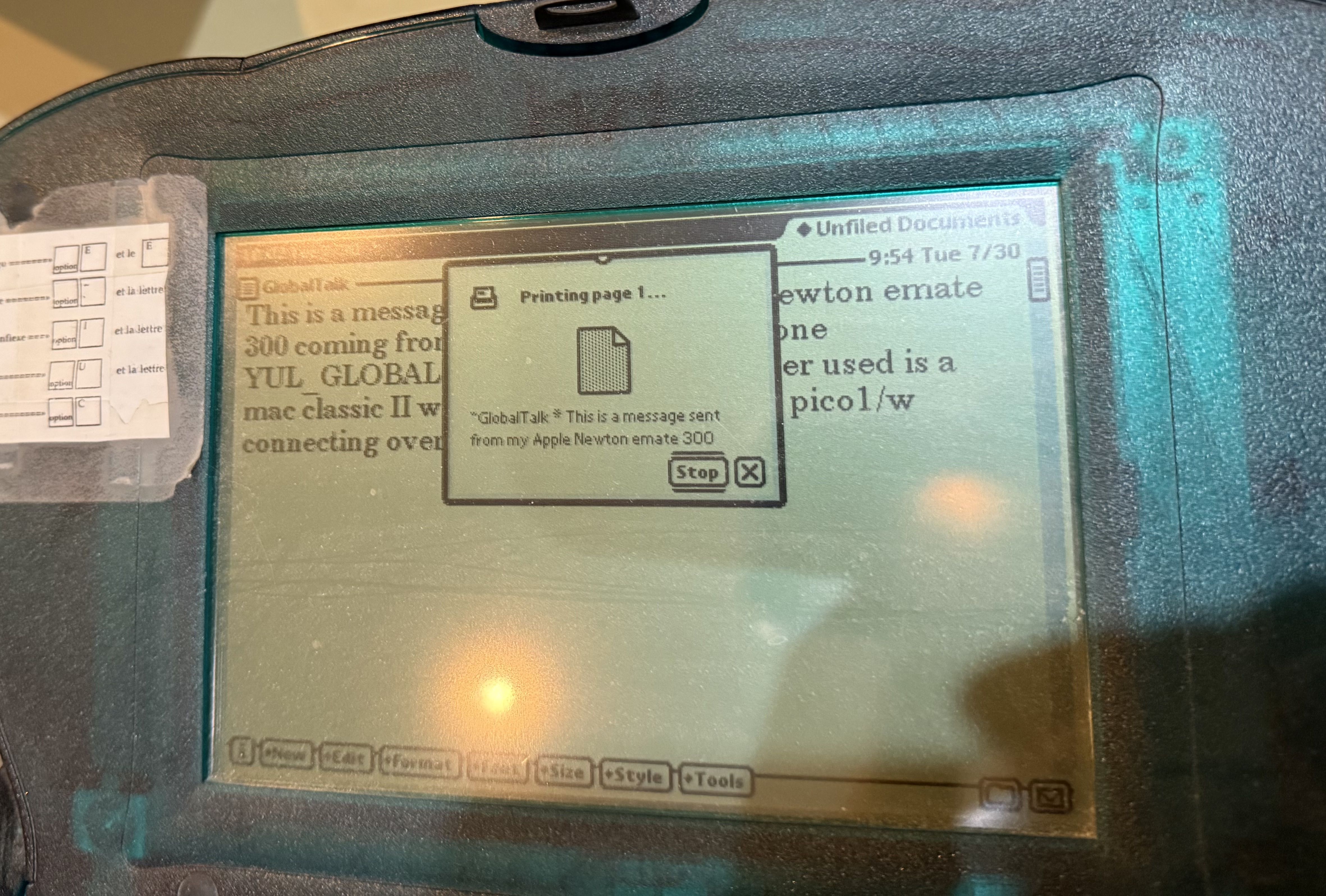

Jacexpo
Nov 15, 2023
It does work fine, I’ve been printing to as many fellow globaltalk laserwriters as possible!

fergycool
Mar 13, 2025
Excellent. It appeared to work with a Localtalk cable, but then I went down the rabbit hole of connecting wirelessly to Globaltalk from the eMate. I think a few prints worked but not really sure. Changing zones and selecting printers was good, but for actual printing it generally lost connection with the printer. It also did the same for my own Laserwriter so not sure of the issue.
