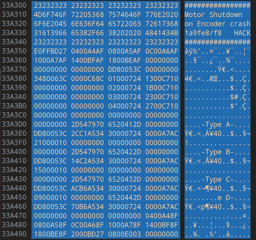

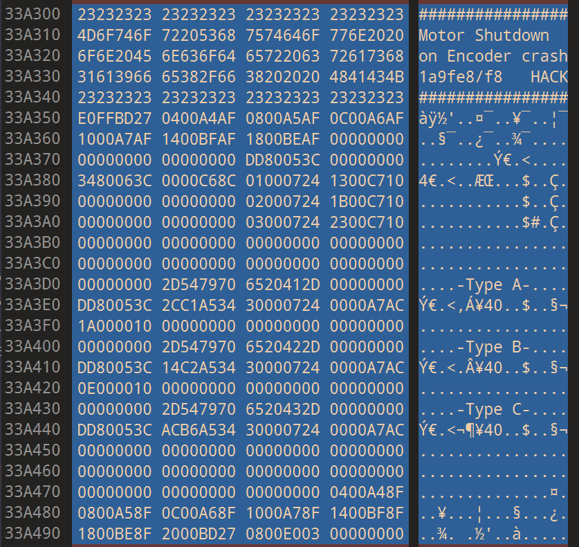

All my code changes additions are between 338f28 - 340008. However these are dozens of changes in the rest of the firmware to branch the old code to run the new additions. You will need to diff the stock type C with v7.7 Type C, to see all these changes and do the equivalent. But this will be hard for D units, as the changes in the base firmware are more extensive.
This is the first code change in Type C. The is a replace a jal (jump) call with a nop. In type A-C "5800020C" is jal 0x80160 (console print), yet in type D the console print is "1803020C" jal 0x80c60. This first change is at 0x1d430. So everything has moved around.
The next big issue, some of my code additions was written directly in MIPS assembly, not C code. These change assumed things like the console print was jal 0x80160. I don't know what other assumptions I've have made. Otherwise I've attempted to make the added code device type aware.

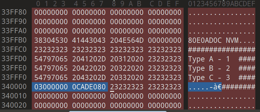

At offset 0x340000 is the device type C=3, D will be 4, followed by the address of the NVM (you will have to find that.)
My code uses these fields.

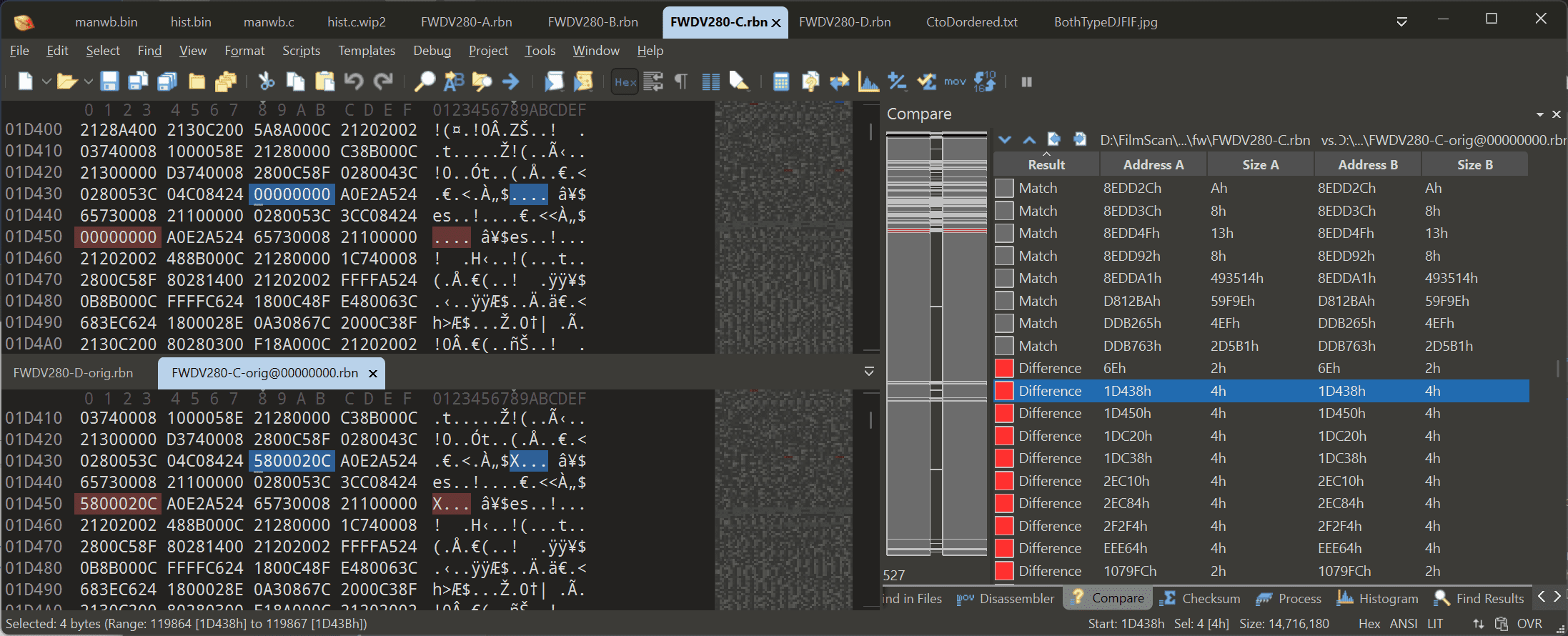

@0dan0 - Perfect timing! I've been working on D variant analysis.
What I have:
  • Stock D firmware (H2825... serial)
  • NVM base address: 0x80E0D600 (found via Ghidra analysis)
  • Device type should be 4 (as you predicted)
  • Successfully injected manual WB code already (device boots and captures, and white balance doesn't seem to shift)
  • Full binary diff between stock C and your v7.7 C
Initial findings:
  • Confirmed function addresses differ (as you noted with console print)
  • Simple offset approach (+0x1164) won't work
  • Ready to do "a bit at a time" as you suggested
I can work through your ReelsChangeNotes.txt and report findings.
Happy to test incrementally and report breakage points. Thank you again!

Key Discovery: Type D firmware cannot use simple offset calculations from Type C. Each data location and function address must be individually mapped.
Process:
  1. Identified device-specific addresses (NVM: 0x80E0D600)
  2. Mapped 17 external function calls from Type C to Type D equivalents
  3. Updated 0dan0's ~29KB custom code block with D-specific addresses
  4. Inserted custom code at 0x0033a08c
  5. Found resolution values via pattern matching (not offset calculation)
Confirmed Mappings (Type C → Type D):
  • Console Print: 0x80080160 → 0x80080c60
  • Resolution Width: 0x00ddb754 → 0x00ddc718
  • Resolution Height: 0x00ddb758 → 0x00ddc71c
  • Input buffer setup: 0x802ea95c → 0x800160a0
  • Plus 13 other function mappings
Critical Finding: Offsets vary wildly across the firmware:
  • Console print: +0xb00
  • Resolution: +0xfc4
  • Some functions: negative offsets!
  • Conclusion: Each address must be found individually

I've ported (what I believe are) the core improvements from 0dan0's Type C firmware to Type D hardware. The device now runs 1600x1200 @ 18fps with improved auto exposure, stable with no motor issues.
The following summary was created by Claude.ai with some notes of my own.
What's Working ✅​
  • Resolution: 1600x1200 (changed from 640x480 upscaled to 1728x1296, better quality than stock)
  • Frame Rate: 18fps
  • Auto Exposure: Improved algorithm from custom code
  • Stability: Completely stable, motor operates correctly
  • All core quality improvements from 0dan0's mod
What's Not Working ❌​
  • OSD Display: No on-screen histogram, frame counter, or exposure stats
  • White balance GUI/control
  • Frame rate GUI/control
  • Likely due to Type D display hardware differences (frame buffer addresses)
  • Custom code executes but output not visible
The Challenge​
Type D hardware proved to be significantly different from Type C:
  1. Memory Layout: Custom code offset +0x1164 from Type C locations
  2. Function Locations: Preview/capture functions at different addresses
  3. Motor Timing Sensitivity: Function entry hooks break motor control completely
  4. Display Hardware: Different frame buffer or overlay addresses
The Solution​
After two failed attempts that caused motor issues, I discovered 0dan0 hooks INSIDE functions, not at entry points:

the hist.c code, does require you configure the data at 0x340000, which you haven't done correctly yet. It will currently default to a Type A. see lines 412-428 in hist.c
volatile int* reelType = (int *)0x80340000;
volatile uint32_t* button = (uint32_t *)0xA0E8BFF8; // uncached
int32_t* nvm_base = (uint32_t *)0x80E0B78C; //Type A - exposure, sharpness, tint
int* expo_iso = (int *)0x80e56134; //Type A - sensor ISO
if(*reelType == 2)
expo_iso = (int *)0x80e56224; //sensor ISO
nvm_base = (int *)0x80E0B87C; //exposure, sharpness, tint
button = (uint32_t *)0xA0E8C0E8;

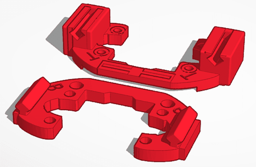

I can't keep up with you guys. I started to mod my machine tonight, if I understand the photos I've seen before, for the spacer item,
The piece with the four holes and socket receptacles mounts on the bottom, where the PCB was, with the bar part at the back facing the unit. The back holes are used to align with the pins on the existing PCB mount area and only two screws of the original six are used to secure it. The other four screws are used to mount the camera PCB assembly to the bracket with the two diamond "pins" and then this is slid into the larger, lower part until things are lined up.
I would suggest removing the undercut from the larger piece as it just makes it harder to print andor uses up supports that are hard to remove on a small area.
The undercut is to clear the surface mount components on the other side of the sensorboard. Yes it's a tad harder to print because of this, but not sure what the alternative would be.

Wait, so then you're saying the piece with the grooves in it, the larger non-size-adjustable piece goes on top and the smaller one of three choices piece goes on the bottom?
sheider
Oct 17, 2025
26
Yes, notice the "T" and "B" lettering that @0dan0 helpfully included in his design.
Also, if you have trouble focusing with the bottom piece height that you depicted, then try 1 of the other 2 heights that he helpfully shared here.
Or if you prefer a single-piece design, you could try the one that @Deano shared in his very helpful writeup.
Reactions: WowIndescribable
Yeah those letters didn't really catch my eye in the model and were obscured in my print. I was aware of the three heights tho.
