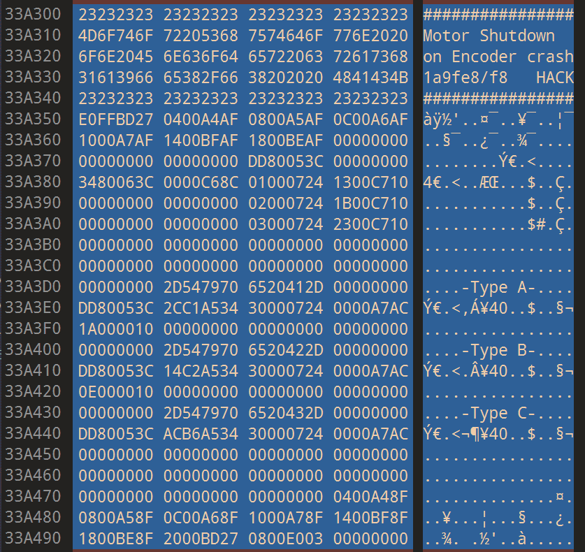

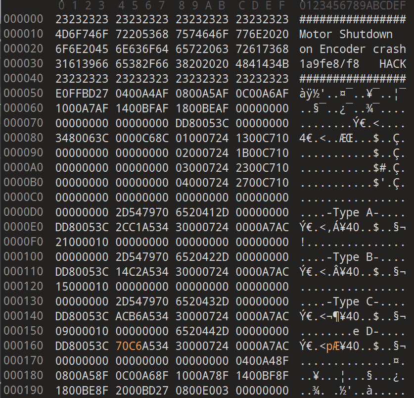

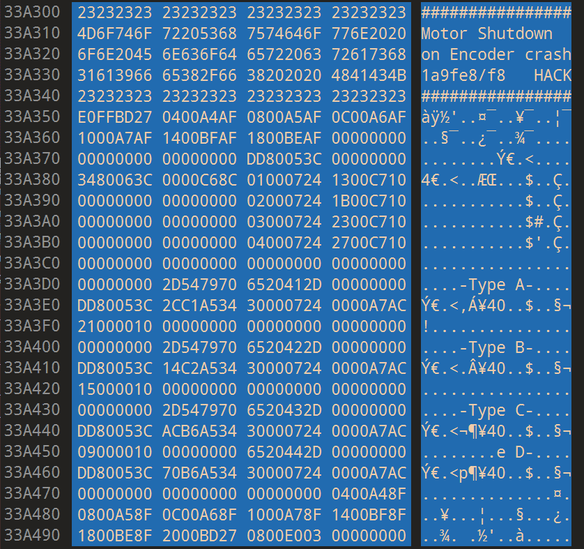

I updated my type-D firmware with the above code changes. This has not merge in your other patches. So you should just grab bytes from 338f28 - 340008. Repo is up to date. Note: the code from 338f28 - 33b200 still will need some Type D support.
Like this motor shutdown code:
If has branches for A thru C, not D yet.
I will have some more time this weekend.
P.S. Attached is the WIP for motor shutdown fix.
I guessing the motor shutdown is at 80ddb670
You can confirm by starting a capture, then:
mem w 80ddb670 30
The motor should immediately stop.
Thanks 0dan0! I ran that mem command, and the motor did not stop. To be clear, the BIN you provided is your code update for the motor shutdown hack and should be inserted at whatever address we find in Firmware D that stops the motor?
Also, should we have a dedicated thread for code development?
Jan 13, 2025
442
623
The code dev stuff could scare some away, but I always ported my findings in the main thread, just in case someone can learn from it.
Opps! I made a typo
Try this:
mem w 80ddc670 30
You do not need the motor stop patch code yet, as that is hook to the encode crash, which only happens once you hooked up the rate control (you are ways off from that.)
I'm slowly creating a D-type patch.

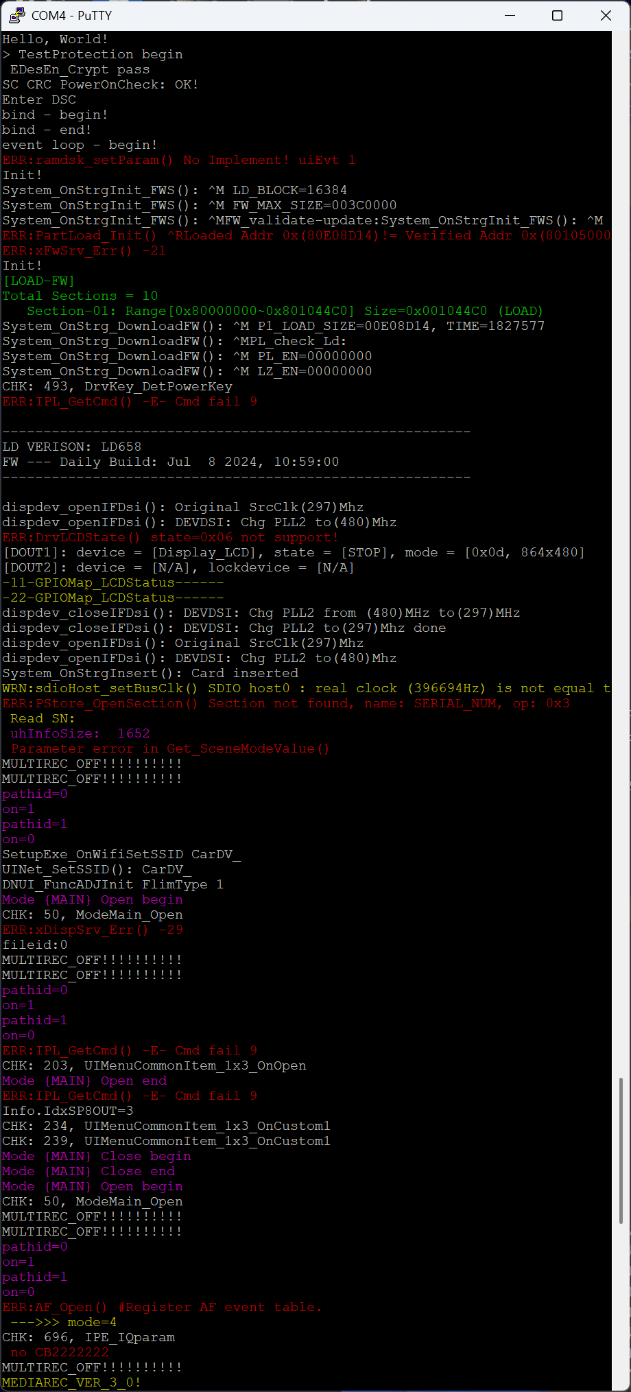

As an aside, I'm seeing this error continuously during capture. Is it normal?
Code:
ERR:UIFlowWndMovie_OnTimer() Record400MinTimeOut 0

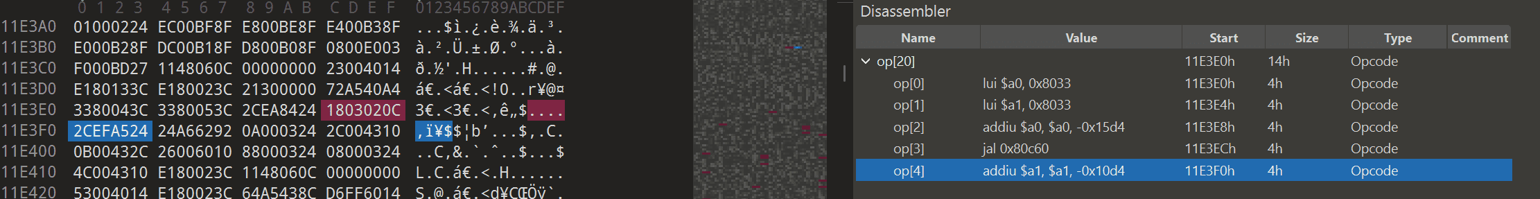

There are a lot of error messages I had suppressed with a NOP over the print console call. I don't remember if this is one of them.
For any string message to find where is it called from:
search on "UIFlowWndMovie_OnTimer"
found at offset 0x32ef2c
This address will be in stored in a0 or a1. As the ERR: UIFlowWndMovie_OnTimer, "ERR:" will be pointed to by a0, and the string we need is in a1.
To find the in the code.
The compiler commonly set up the addresses like this:
lui $a0, 0x8033
addiu $a0, $a0, 0xef2c
If is but confusing at 0xef2c will be treated as -0x10d4 (sign bit, in unsigned math)
So I'm always look for addiu $a0, $a0 ... or addiu $a1, $a1, next to a jal 0x80c60 (call to console - 18 03 02 0C)
addiu $a0, $a0, 0xef2c is (little endian) as 2c ef 84 24
addiu $a1, $a1, 0xef2c is (little endian) as 2c ef a5 24
MIPS run one extra instruction after a call, so it is not wrong that a1 setup is after the jal call.
So string message can be used to find the code. Then use Ghidra at offset 113ef0 to see what is the cause of the message.

Thanks for the effort, @0dan0 ! No hard crash, but the buttons are unresponsive on the unit. Here's the complete output from the "Hello World!" string:
Code:
Hello, World!
> TestProtection begin
 EDesEn_Crypt pass
SC CRC PowerOnCheck: OK!
Enter DSC
bind - begin!
bind - end!
event loop - begin!
ERR:ramdsk_setParam() No Implement! uiEvt 1
Init!
System_OnStrgInit_FWS(): ^M LD_BLOCK=16384
System_OnStrgInit_FWS(): ^M FW_MAX_SIZE=003C0000
System_OnStrgInit_FWS(): ^MFW_validate-update:System_OnStrgInit_FWS():
^MFW is just updated.
System_OnStrgInit_FWS(): ^M ok
ERR:PartLoad_Init() ^RLoaded Addr 0x(80E08DAC)!= Verified Addr 0x(80106000)
ERR:xFwSrv_Err() -21
Init!
[LOAD-FW]
Total Sections = 10
   Section-01: Range[0x80000000~0x801055F0] Size=0x001055F0 (LOAD)
System_OnStrg_DownloadFW(): ^M P1_LOAD_SIZE=00E08DAC, TIME=28017927
System_OnStrg_DownloadFW(): ^MPL_check_Ld:
System_OnStrg_DownloadFW(): ^M PL_EN=00000000
System_OnStrg_DownloadFW(): ^M LZ_EN=00000000
ERR:IPL_GetCmd() -E- Cmd fail 9
LD VERISON: LD658
FW --- Daily Build: Aug 22 2025, 11:52:51
dispdev_openIFDsi(): Original SrcClk(297)Mhz
dispdev_openIFDsi(): DEVDSI: Chg PLL2 to(480)Mhz
ERR:DrvLCDState() state=0x06 not support!
[DOUT1]: device = [Display_LCD], state = [STOP], mode = [0x0d, 864x480]
[DOUT2]: device = [N/A], lockdevice = [N/A]
-11-GPIOMap_LCDStatus------
-22-GPIOMap_LCDStatus------
dispdev_closeIFDsi(): DEVDSI: Chg PLL2 from (480)MHz to(297)MHz
dispdev_closeIFDsi(): DEVDSI: Chg PLL2 to(297)Mhz done
System_OnStrgInsert(): Card inserted
WRN:sdioHost_setBusClk() SDIO host0 : real clock (396694Hz) is not equal to desired (399000Hz)
Detected A:\NVTDELFW, delete A:\FWDV280.BIN
UINet_SetPASSPHRASE(): 12345678
 Parameter error in Get_SceneModeValue()
MULTIREC_OFF!!!!!!!!!!
pathid=0
on=1
pathid=1
on=0
SetupExe_OnWifiSetSSID CarDV_
UINet_SetSSID(): CarDV_
 UIInfo: PStore sys param not save before load pstore!!!
ERR:PStore_OpenSection() Section not found, name: SERIAL_NUM, op: 0x3
 Read SN:
 uhInfoSize:  1652
pathid=0
on=1
pathid=1
on=0
DNUI_FuncADJInit FlimType 0
Mode {MAIN} Open begin
CHK: 50, ModeMain_Open
ERR:xDispSrv_Err() -29
ERR:FileDB_GetInfoByHandle() This Handle is not created(0)
fileid:0
pathid=0
on=1
pathid=1
on=0
CHK: 203, UIMenuCommonItem_1x3_OnOpen
Mode {MAIN} Open end
Info.IdxSP8OUT=16
CHK: 234, UIMenuCommonItem_1x3_OnCustom1
CHK: 239, UIMenuCommonItem_1x3_OnCustom1
Mode {MAIN} Close begin
Mode {MAIN} Close end
ERR:pll_selectClkSrc() (0x0, 0x4) not supported
1.0-----------------------------true
Id=0
Mode=1
ERR:Init_OS04D10() OS04D10_init...
Init_OS04D10, DATALANE: 0 1 2 3
pathid=0
on=1
pathid=1
on=0
ERR:NH_Custom_SetFolderPath() setFolderPath id error 2!
ERR:NH_Custom_SetFolderPath() setFolderPath id error 3!
ERR:IPL_SetDZoom() IPL_SetDZoom fail (Current Mode = 0)
ERR:ChgMode_OS04D10() ChgMode_OS04D10 to 1...
csi_setEnable(TRUE)=0
CHK: 560, ChgMode_OS04D10
csi_waitInterrupt(CSI_INTERRUPT_FRAME_END)=65536
CHK: 562, ChgMode_OS04D10
pll_setPLLEn(PLL_ID_6, TRUE)=0
ERR:AF_Open() #Register AF event table.
Id=0
Mode=1
Id=0
Mode=1
Id=0
Mode=1
Id=0
Mode=1
ERR:IPL_SIEClkCBFlowC() SIEclk = 240000000
CHK: 1026, IME_IQparam
CHK: 696, IPE_IQparam
Id=0
Mode=1
CHK: 24, IPL_SIESetOB_FCB
ERR:IPL_SIESetCAVIG_FCB() CA VIG Setting not ready
ERR:AF_Tsk() #Entered AF_Tsk
Id=0
Mode=1
Id=0
Mode=1
ERR:PStore_OpenSection() Section not found, name: AWBD, op: 0x1
ERR:AWB_Init() KGain = 100 100
 no CB2222222
MEDIAREC_VER_3_0!
 TEMPSTART OK!!
ERR:IPL_FCB_Alg3DNR() ^G3DNR on..
ERR:IPL_FCB_AlgWDR() ^GIPL_FCB_AlgWDR = 6..
fileid:0

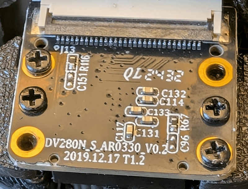

Look like we know what has changed in these newer units, they have switched out the image sensor from Aptina AR0330, to an OmniVision OS04D. The good news is this is a nice newer sensor, not really more resolution, but better signal to noise. Can you remove the sensor hood and photograph your sensor board?
AR0330 board (Type A,B & C):
The bad news, this likely why things are so different and will slow full support.

Here’s the sensor on my D unit.
