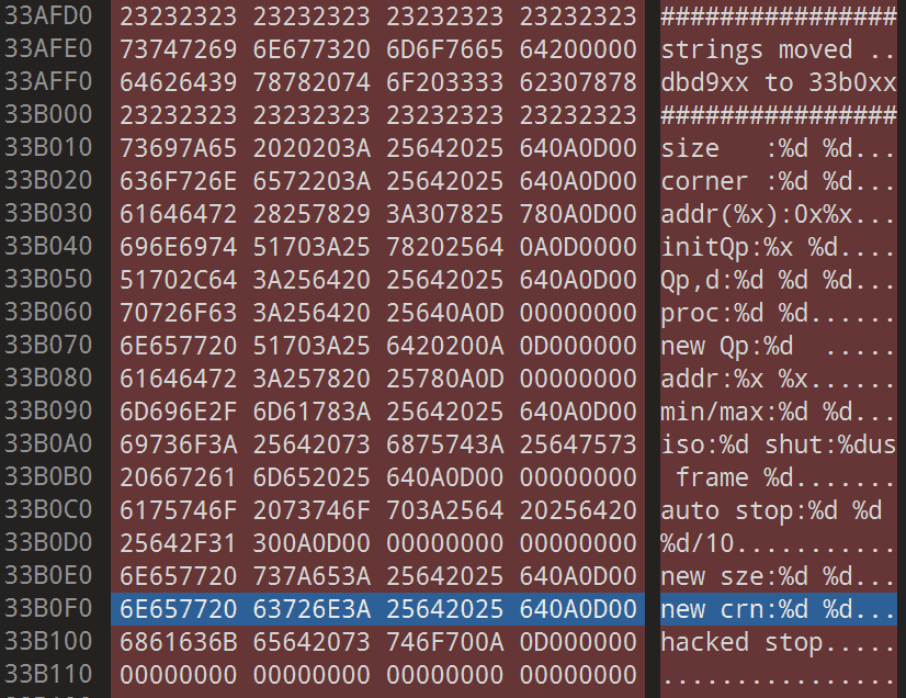

Anywhere you can add 34 80 04 3C 18 03 02 0C F0 B0 84 24
F0 B0 points to the string at 33B0F0. Value in a1 goes to the first %d, a2 the second %d, and so on. Add you own string messages as needed.
The first area to investigate, are the calls to setting resolution.
Attached is an example of print added to the beginning of New Capture Res. This should be the first entry point. It will crash after the print outs.
As the sensor pixel pitch has changed, it does make some sense scanning resolution has changed, my code it likely not expecting it.
When use the new print stub code:

Example Type C:
2034x1526 <- sensor readout max-size
612x312 <- x,y and offset from the left-top corner
840x632 <- resolution of the window to scan
@videodoctor Try the attached zip, and report your three lines in yellow for Type D.
  • FWDV280-D.zip

I'm continuing image sensor research with Claude.ai python scripts in Ghidra. I just had my right hand injected with Xiaflex and I can't work as fast now until Wednesday or so. Here's some initial findings from the python scripts (attached) and Claude's analysis, which helps but is no smoking gun.
🎯 Key Findings​
✅ Sensor Confirmed: OS04D10​
Multiple string hits at 0x80105de9 and throughout 0x80d97xxx confirm OmniVision OS04D10 sensor.
✅ OmniVision Exposure Registers ARE Being Used​
RegisterPurposeOccurrences
0x3500Exposure bits 19:16281
0x3501Exposure bits 15:822
0x3502Exposure bits 7:058
0x3503AEC Manual Control20
0x350AGain high3
0x350BGain low6
⚠️ Interesting: AR0330 Code Still Present​
The firmware has both AR0330 and OmniVision register patterns. This likely means:
  • Shared codebase with Types A/B/C
  • Sensor abstraction layer that handles both
  • Or conditional code paths based on detected sensor
🔧 I2C Functions Located​
Low-level sensor communication at:
  • FUN_80002384
  • FUN_800023dc
  • FUN_80002474
🎯 Key Discovery: Different Memory Region!​
Type C expo_iso was around 0x80E55xxx Type D candidates are at 0x80F82xxx
This is NOT just a +0x160 offset - it's a completely different memory region. This explains why your Type C addresses caused TLB crashes.
🔍 Top expo_iso Candidates​
AddressRegisterNotes
0x80F823A4s2, s7, a1Loaded 3+ times - HIGHEST PRIORITY
0x80F82580s7, a1Secondary candidate
0x80F82570a1Secondary candidate
The 0xAAAAxxxx values are division magic constants (for the modulo-3 frame check), not pointers. The 0x43210007 is the familiar debug/magic constant.
✅ Confirmed: frameno is nearby!​
Look at this from the disassembly:
[CODE}
lui v1, 0x80f8
lw v0, 0x2464(v1) ; Load from 0x80F82464
[/CODE}
0x80F82464 is frameno - we already knew this worked! This strongly suggests the AE-related structures are all in the 0x80F82xxx region.
  • claude_kodak_reels_firmware_D_sensor_research.zip

ok, thanks for another build to test. here's the section with your highlights, @0dan0 :
Code:
a1-3:2564 1444 1244
a1-3:466 84 8
a1-3:1452 1076 8
Full output from Hello World to the kernel crash:
🎯 Key Findings​
0x350AGain high3
0x350BGain low6
  • FUN_80002384
  • FUN_800023dc
  • FUN_80002474
[CODE}
lui v1, 0x80f8
[/CODE}
Seem I posted a slight different build. This will match the Type C, I help me with the next steps.
I could use the shell to confirm expo control addresses, that should work for you too.
  • FWDV280-D.zip

*** CPU Exception!!! cause 0x04: Address error exception (load or instruction fetch)
epc  - 0x80339000
$ra  - 0x80338fe4
$sp  - 0x81309c80
$fp  - 0x81309c48
general registers:
     $zero : 0x00000000       $at : 0x80e10da0       $v0 : 0x00000012       $v1 : 0x0000000e
       $a0 : 0x80dfc5c8       $a1 : 0x00000fc0       $a2 : 0x00000bd0       $a3 : 0x000017a0
       $t0 : 0x0000c54c       $t1 : 0x01010101       $t2 : 0x81308640       $t3 : 0x00000012
       $t4 : 0x00000000       $t5 : 0x80f9beec       $t6 : 0x0000000a       $t7 : 0x81309b90
       $s0 : 0x00000000       $s1 : 0x00000002       $s2 : 0x00000a08       $s3 : 0x80e07b50
       $s4 : 0x00000000       $s5 : 0x81309d30       $s6 : 0x00b009c0       $s7 : 0x81309dec
       $t8 : 0x00000002       $t9 : 0x00000002      null : 0x00000434      null : 0x00000008
        gp : 0x80e10da0        sp : 0x81309c80        fp : 0x81309c48        ra : 0x80338fe4
co-processor registers:
   entrylo : 0x00000001    status : 0x00000010    vector : 0x0100c403       epc : 0x80339000
     cause : 0x00000000  badvaddr : 0x00800010    hwrena : 0x00000042      prid : 0x00019655
   entrylo : 0x016e80c1
Task(id)   :
  IPL_Tsk(26)
stack      :
    range(0x81308620 - 0x8130a37c)
call stack :
  abort (failed to backtrace $pc!)
*** CPU Exception in Task[]! cause=0x00000004, addr=0x80339000

@0dan0 it's worth mentioning that this is the module list on the Firmware D model. Note the awbOs04D10--that looks very sensor dependent. Was there an equiv for the older sensor in the A, B, and C models?

smrec is the last command on older units
