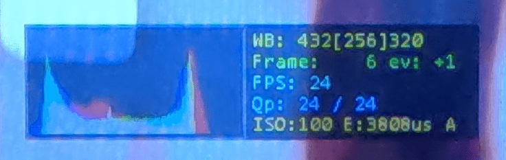

The Picture setting still set the white balance like before, with has a maximum of 9 WB settings. Now during recording you can tweak red, green and blue, up and down as much as you like, it will remember any changes. Unfortunately I yet to implement a reset, to restore the defaults. The firmware update will reset RGB gains to there default offsets. If you change red or blue, off the defaults, the value will be odd, rather than even. I didn't do this with green, as I was just preserving the existing behavior with that channel.
WBAL (current defaults)
2.0 384,256,256
1.5 352,256,256
1.0 320,256,256
0.5 288,256,256
0.0 256,256,256
-0.5 256,256,288
-1.0 224,256,320
-1.5 96,256,448
-2.0 64,256,448
Does this WB settings table take into affect the Red "Trim" you had where 496,256,256 was "default/white."
Oopps, I had the red offset wrong:
Default values should be:
2.0 592,256,256
1.5 560,256,256
1.0 528,256,256
0.5 496,256,256
0.0 464,256,256
-0.5 464,256,288
-1.0 432,256,320
-1.5 304,256,448
-2.0 256,256,448
Reactions: ThePhage

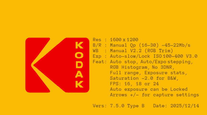

Here is v7.5.
Additions:
- You can customize all the RGB gains for white balance, to deal with very blue (or red) film.
- The font has been increased in size for improve readability.
- FPS, EV, Qp and Frame count are now only during capture.
Bug fixes:
- Sometimes the ISO/Shutter wasn't displaying correctly.
I see that the Qp level now ranges from 15 to 29 (instead of 39) and it no longer loops back to 20 when exceeding that range) = Good!
