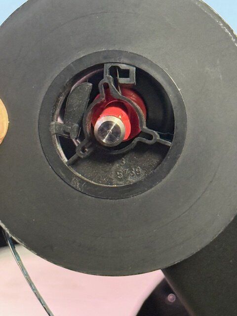

My Kodak Reels arrived today with the red adapter attached to the left arm and the grey one attached to the right arm. However, my super 8 reels "center hole" are still too large. Do I need another adapter? please see image.

That is not the adaptor. The red and grey posts are just classic 8mm style reel hubs. You need to attached this over the red post:

Darn. My unit did not come with the adapters. what are they called? maybe I can find them on AMAZON. If I cant find on AMAZON, where can I buy in USA? thanks

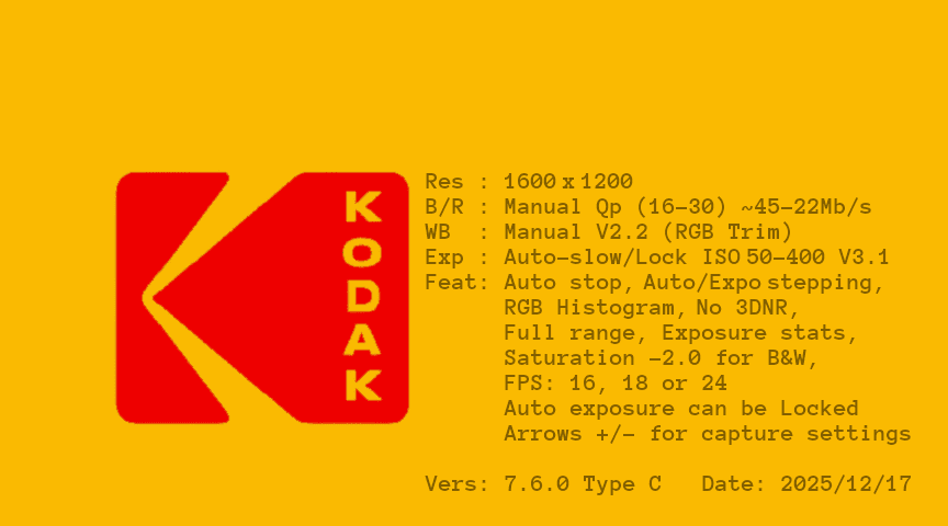

Release V7.6
This adds info reporting the sensor read-out resolution, but leaves the encoding resolution at 1600x1200 for now. This is info is during preview only.
There is also the window offset, the number of x, y pixels from top left of the active sensor region. This could be useful for debugging.
Final change, during capture I have restored support for 50 ISO, so a slightly cleaner image (maybe).

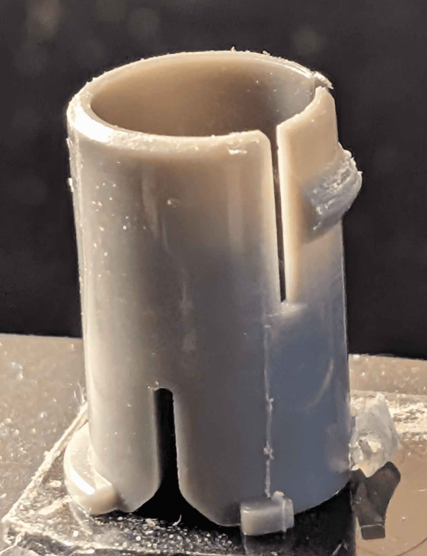

I’ve now ordered the recommended new lens and plan to have the corresponding mount 3D-printed. Since I don’t have much experience with 3D printing, I have a quick question:
The service Craftcloud, which I plan to use for printing, asks whether the 3D model is specified in millimeters or inches. I assume millimeters, correct?
And which material would you recommend for the print?

The STL file is in millimeters, and material choice is not critical. PETG should work nicely and should be inexpensive.

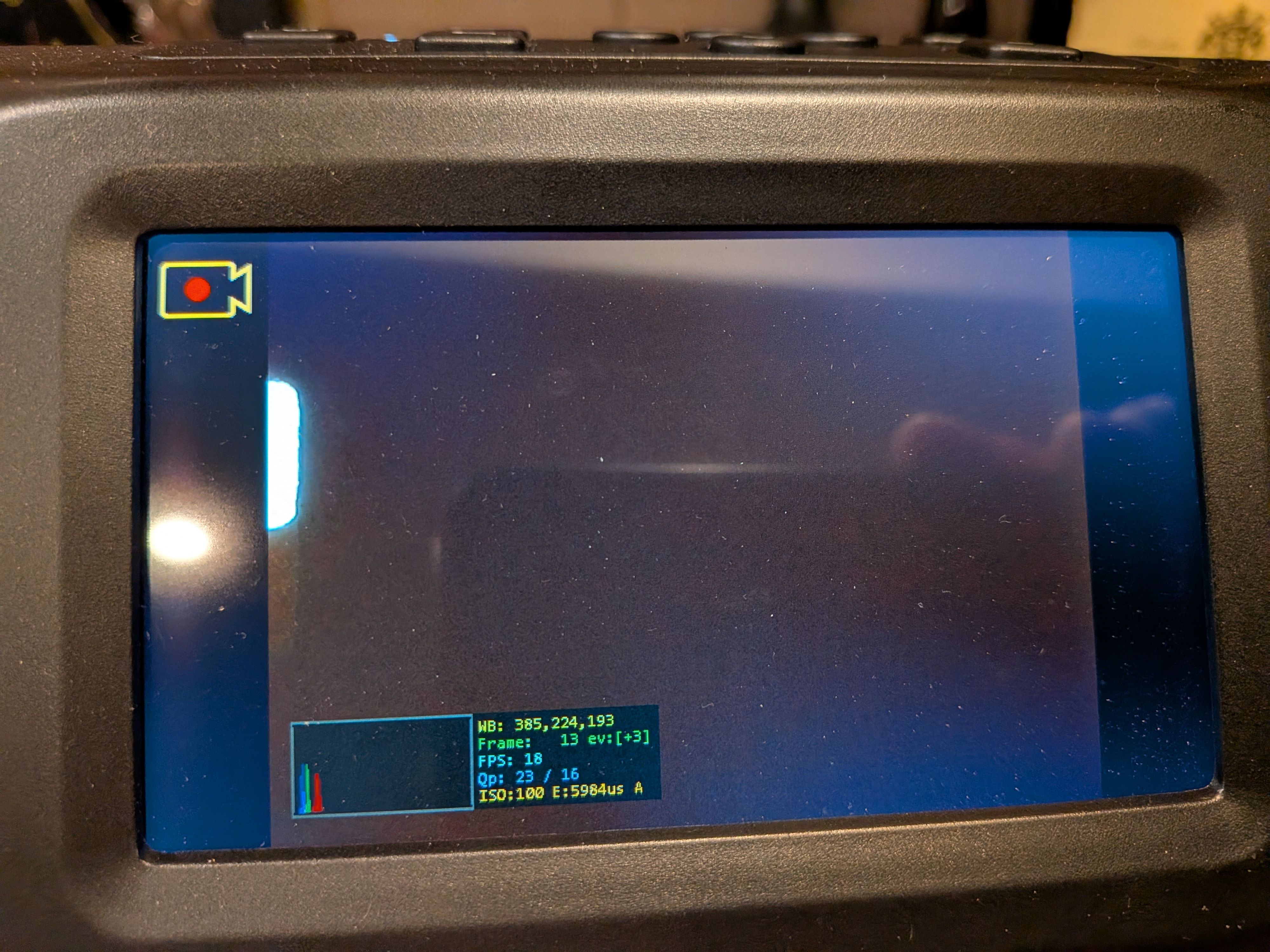

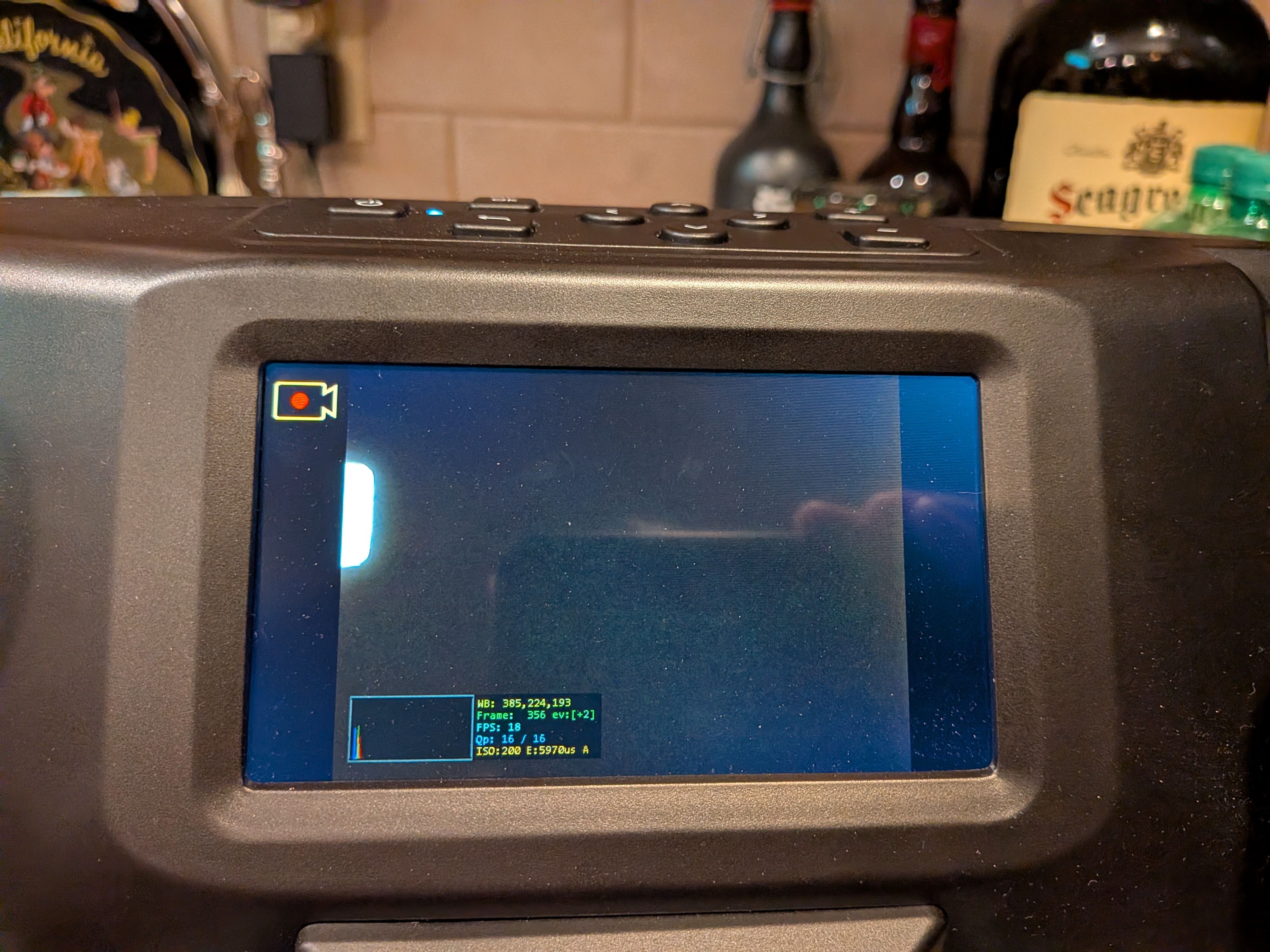

Hi @0dan0 -- I have a couple observations / questions about the ISO / exposure algorithm.
v7.1 - v7.5: During capture with my 'C' unit, the highest ISO / exposure that I observed was ISO 200 / ~5970µs. I never observed an ISO of 400 during capture, even with a black image. Is that behavior consistent with your expectation / experience?
v7.6: During capture with my 'C' unit, the highest ISO / exposure that I observed was ISO 100 / ~5984µs. I never observed an ISO of 200 or 400 during capture, even with a black image. Is that behavior consistent with your expectation / experience?
I understand that you're aiming for the lowest practical ISO for the film's density, but I'm surprised that none of the thousands of feet of film that I've scanned with v7.1+ has triggered neither your highest coded ISO nor an exposure time exceeding 6000µs. If that is by design, then no worries... I just want to confirm that my unit isn't underexposing images due to a hardware malfunction or firmware bug.
