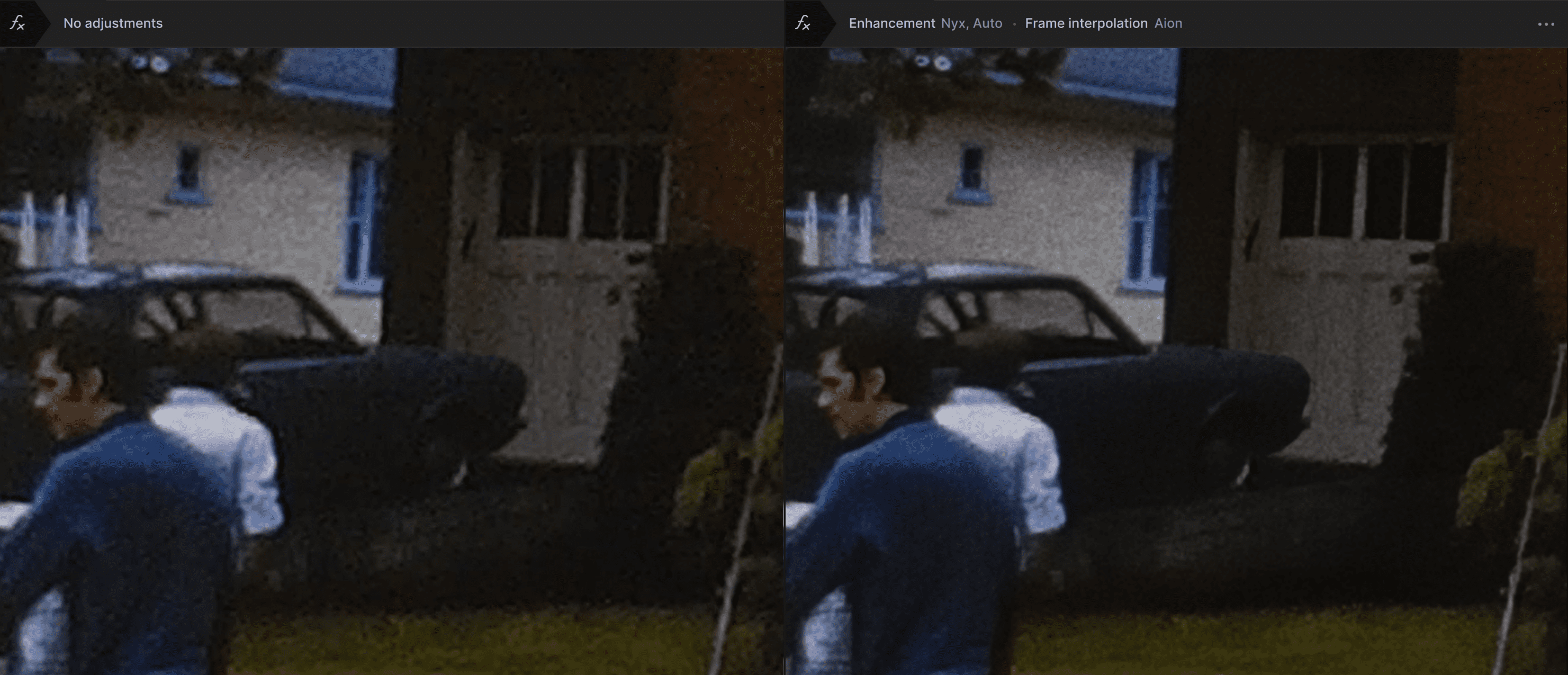

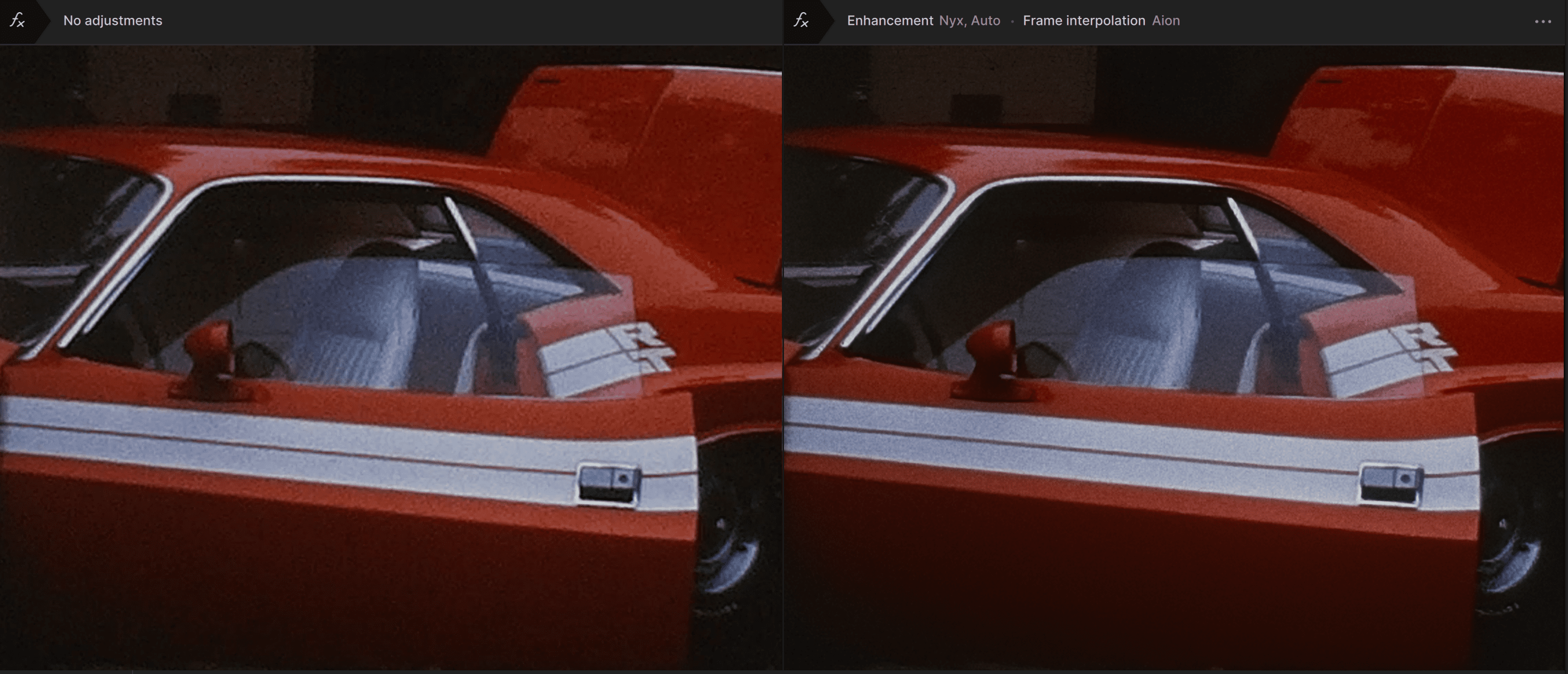

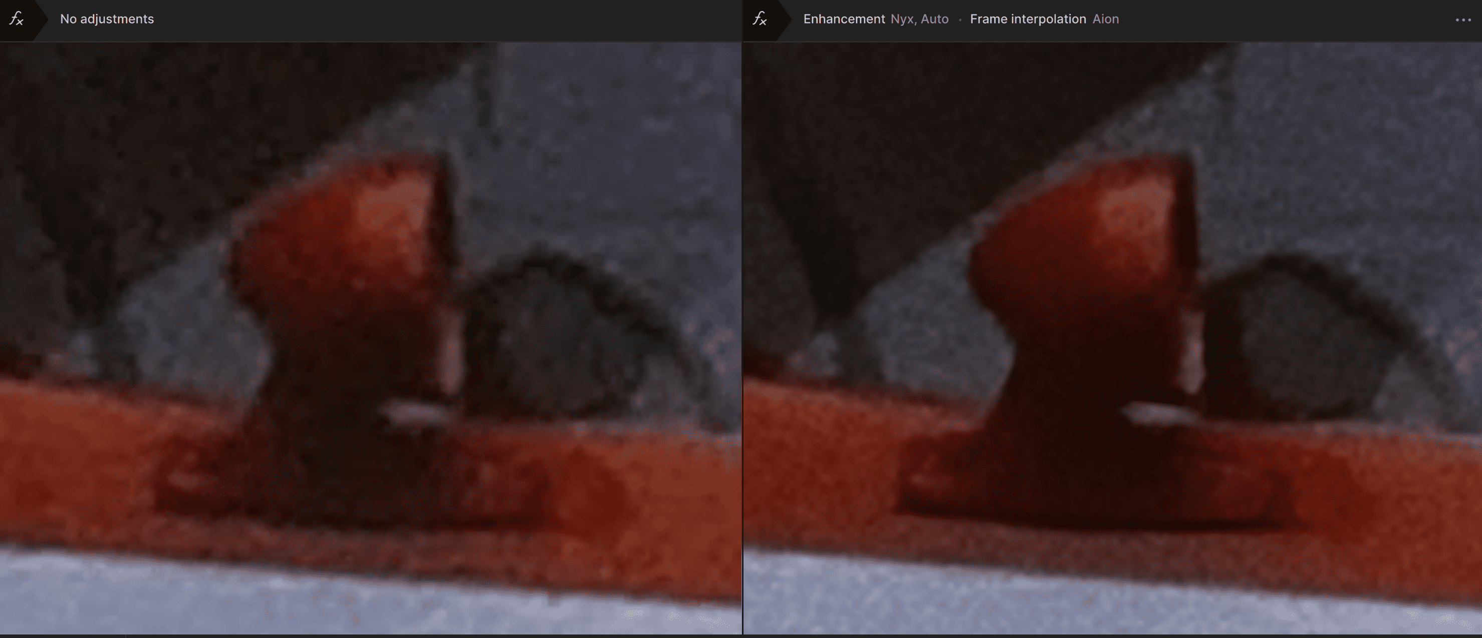

@0dan0 Quick update on version 7.6: I’m now getting a steady 25–27 Mbps with the stock lens. Sharpness set to -0.5. There’s still a bit of jitter at the bottom of the screen occasionally, but overall the capture quality is pretty good. This is using version A of Kodak Reel. Thx
This is with Topaz Video AI enhancement applied.

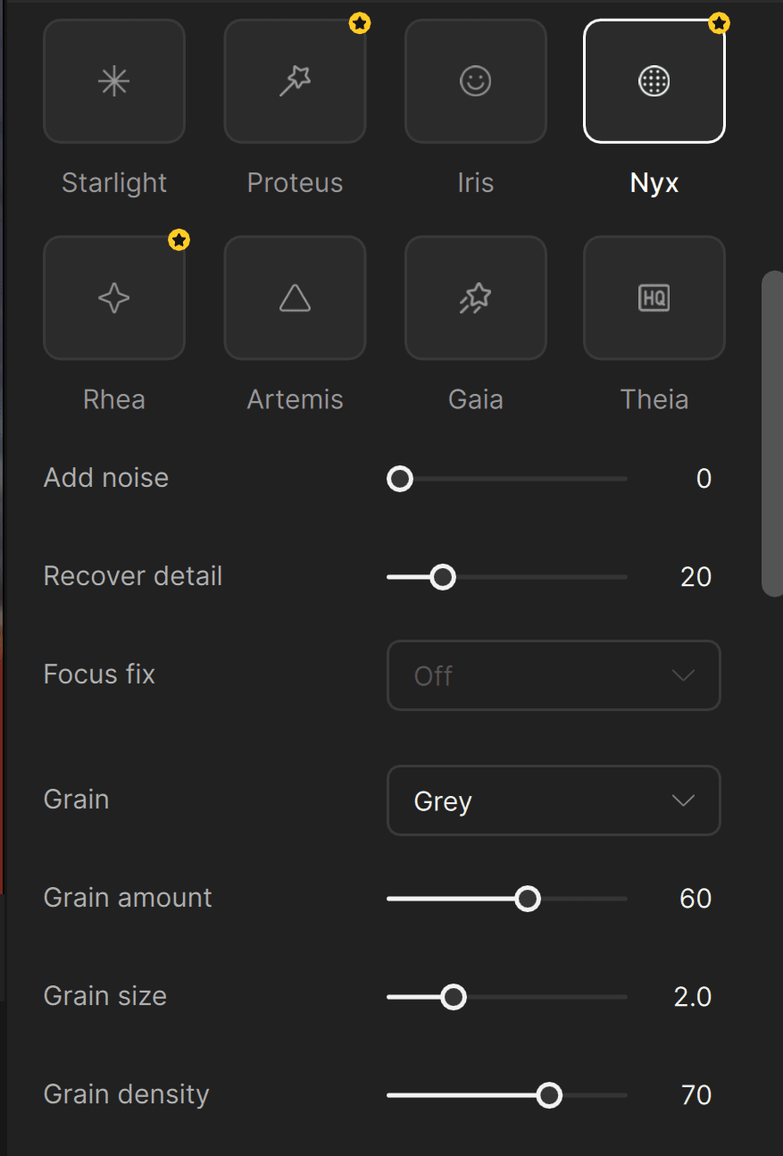

Are you reapplying grain in Topaz, as this are pretty nice / gentle enhancements. Can you share your settings?

I got Type A running at Qp 16 again, outputting 45Mbs. Updating builds now.
Switching back to ISO 50 seems to be improving encoding by cutting down noise, which usually gets in the way of encoders. In the next update, hitting 45 Mbits sustained might not happen, but landing around 28–30 Mbits would still be fine. After that, Topaz can help enhance the image and fill in any gaps with some grain.

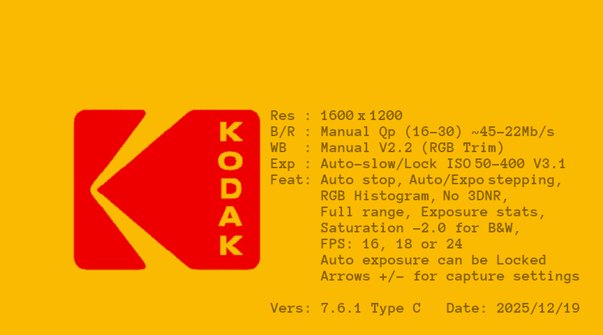

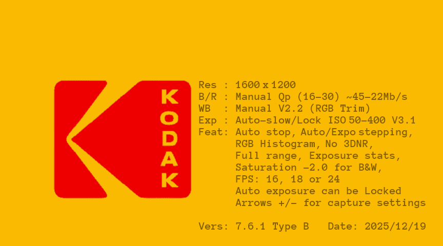

v7.6.1
Bug fixes only.
- Qp rate control below 20 was fixed on Type A & C (B was okay)
- Now supports up to 400 ISO during encoding (not sure if this is a good thing, but try it.)
  • FWDV280-TypeA-V761-0dan0.zip
  • FWDV280-TypeB-V761-0dan0.zip
  • FWDV280-TypeC-V761-0dan0.zip

v7.6.1
View attachment 25423View attachment 25424View attachment 25425
Bug fixes only.
Thanks @0dan0, I can confirm that at on my Type C scanner, the ISO value does 400 ISO during film scanning and also reported up to 800 ISO when I put my finger between the light and the lens (blacking out the sensor). Also, the encoder is showing as running at Qp 16 (when set to 15). Thanks for the ongoing updates/improvements!

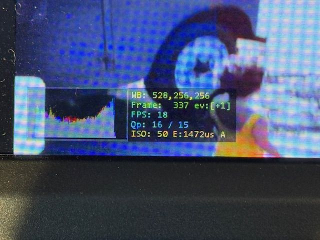

Ive updated my C unit to 7.6.1. My QP is set to 15, but I dont think im getting good Mbps. (the Mbps shown in image are equal to 16, and that's not ideal, correct?)
The Qp (Quantization Parameter) level that you set (15) and see being achieved (16) is quite good (essentially the highest quality compression you can achieve on this hardware with this current custom firmware, and WAY better than what you could achieve with the stock firmware).
Qp can be thought of as a setting that dictates how much compression is being applied, where a higher number equals more compression. The bitrate of your video is probably somewhere between 30 and 40 Mbps, but you would need to open the file in some software to determine that (or do the math yourself based on filesize and duration).
