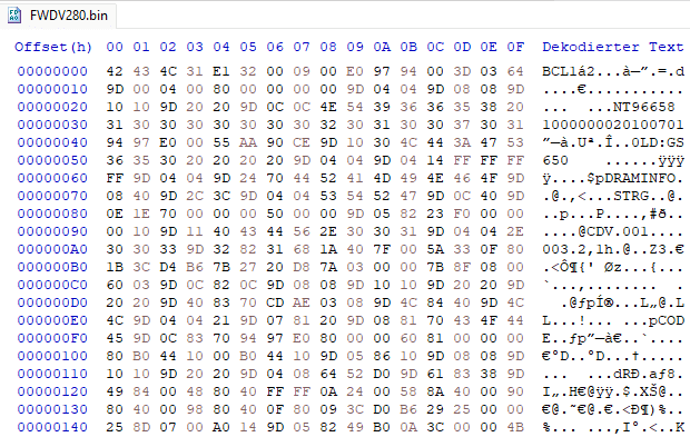

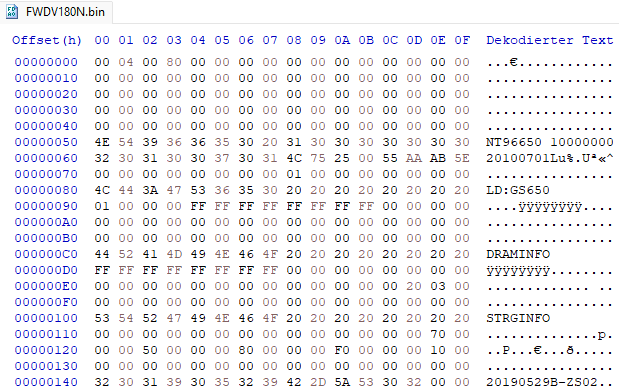

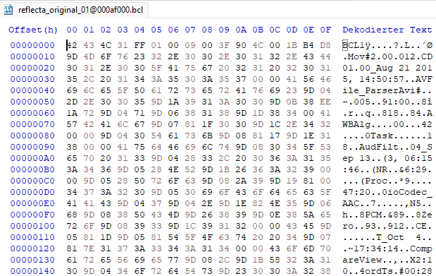

Hi all,
I've been trying for a while to increase the quality of the scanning results of my reflecta Film Scanner Super 8 – Normal 8 (Art.No.: 66040, S/N: 20201000887, https://reflecta.de/de/super-8-normal-8-/41-reflecta-film-scanner-super-8-normal-8.html). The device is based on an NT96650 IC. I read through the available information, but somehow I got stuck. What I did so far, probably in error:
I desoldered the MX25L3236F EPROM IC from my device mainboard.
I obtained a complete dump of the EPROM with the help of AsProgrammer and a CH340A programmer.
I was able to open the dump using NtkTool (BnGui) v0.4.1. It detected a FULLCOMP Firmware type with 2 BCL partitions.
I unpacked the larger one of the two (Offset: AF000, Compressed size: 1BB483, Extracted size: 3F904C) to obtain the file [email protected].
I was able to open the rbn file with NtkMPE 1.2 by Tobi@s which showed 5 different settings at addresses 1D6D78, 1D6D8C, 1D6DA0, 1D6DB4 and 1D6DC8.
I did NOT change anything!
I re-packed the unchanged file [email protected] with the option c and a Baseval [hex] of 0 to [email protected] and noticed that the new file was bigger (1.815.784 Bytes) than the original compressed size (1.815.683 KB).
This is where I got stuck. Additionally, my newly created bcl file doesn't look like anything I found on the internet. The file FWDV180N.bin, which I downloaded from https://blog.hansom.dev/posts/updated-firmware/ (in the archive Reflecta_Somikon.zip) for example looks like this:
The file FWDV280.bin from the original KODAK hack looks like this.
However, my file looks like this.
So my file is definitely for example missing the NT96650 string. Where did I go wrong? My initial idea was to create a modified dump, which I can directly flash back to the EPROM (since it's still soldered to an adapter PCB). Is this possible? Furthermore, I read somewhere that it's not only possible to modify the bitrate but also the quantization parameter QP. How can I do this?
Thank you for pointing me to the right direction!
