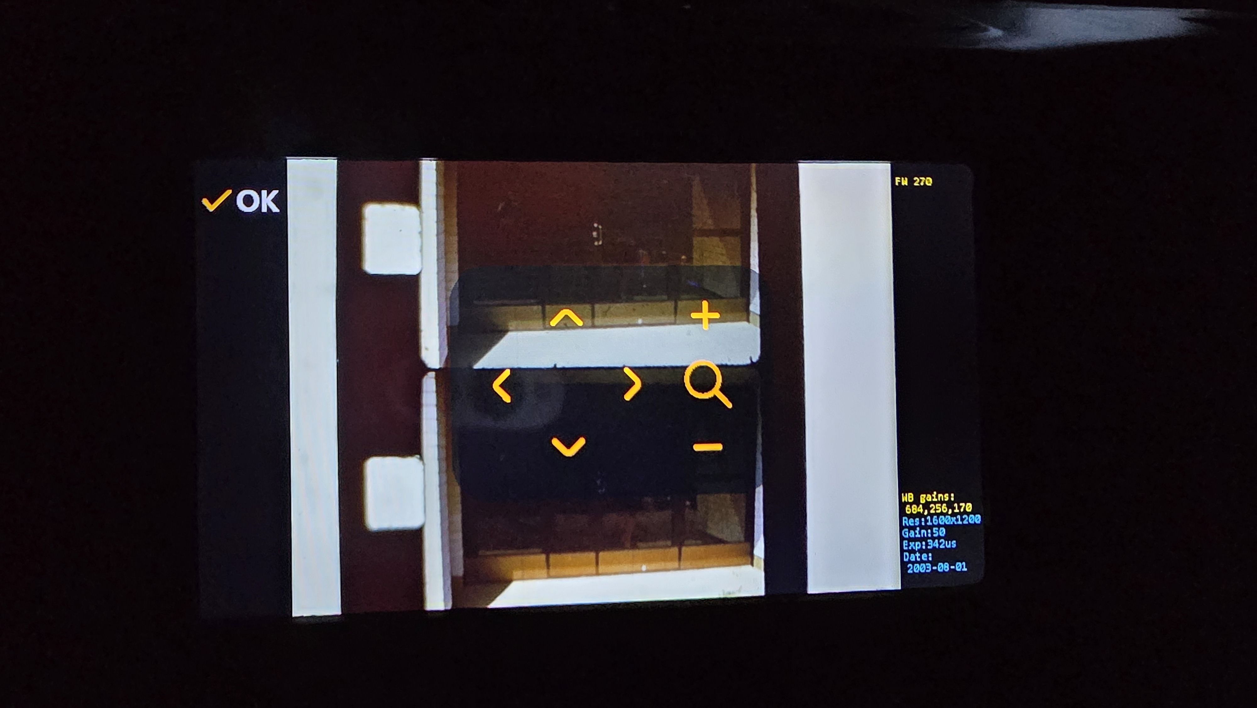

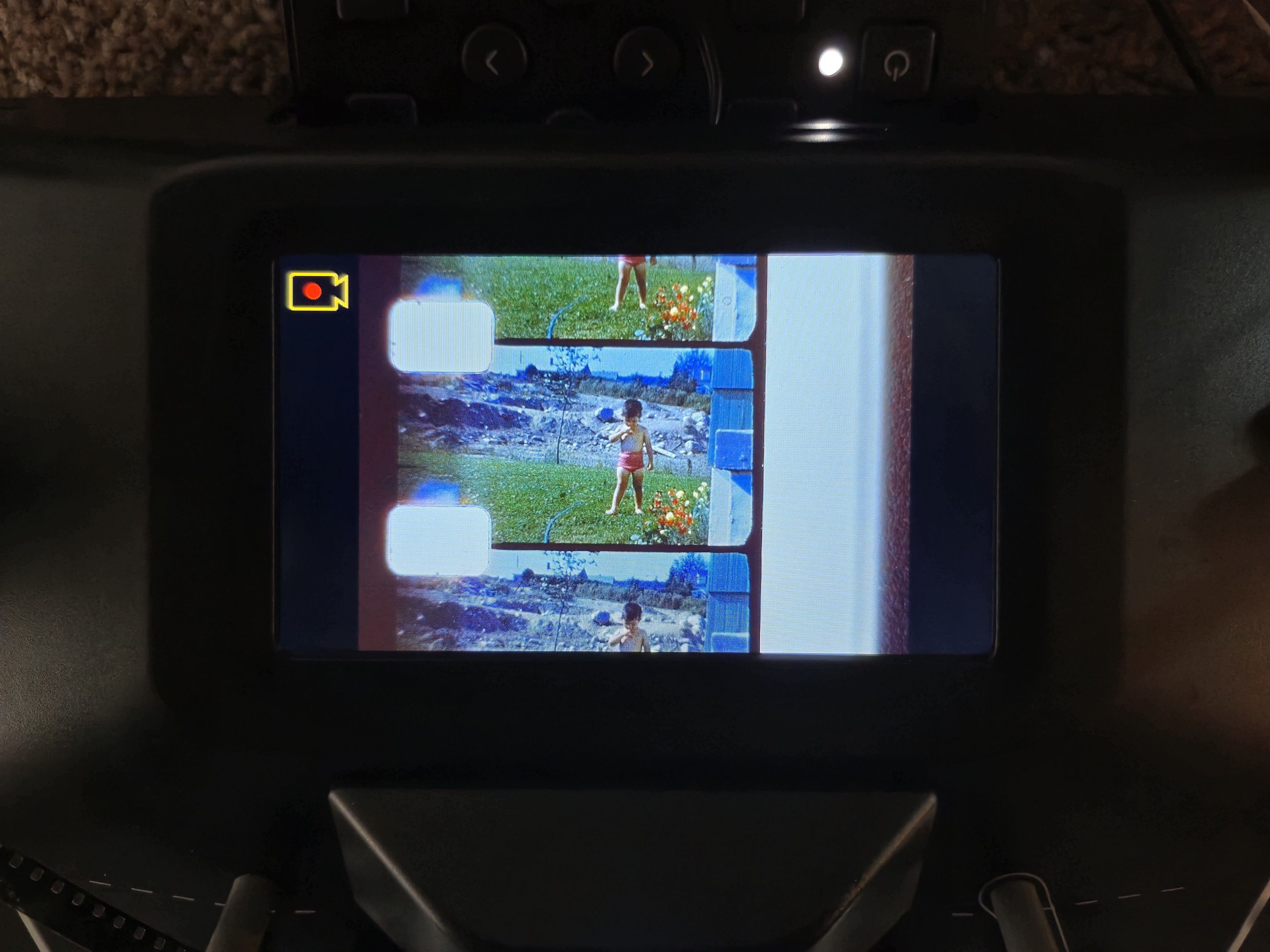

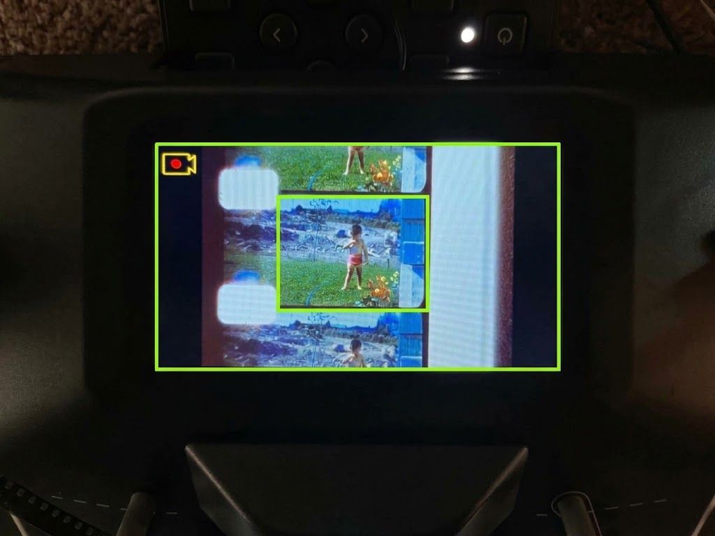

Is that in both directions zoom in and out? Or just one?
Mine zooms in both directions (in and out) and at some stage just does an awkward crop instead of changing zoom. Maybe the second to last click.. I have a Model D too.

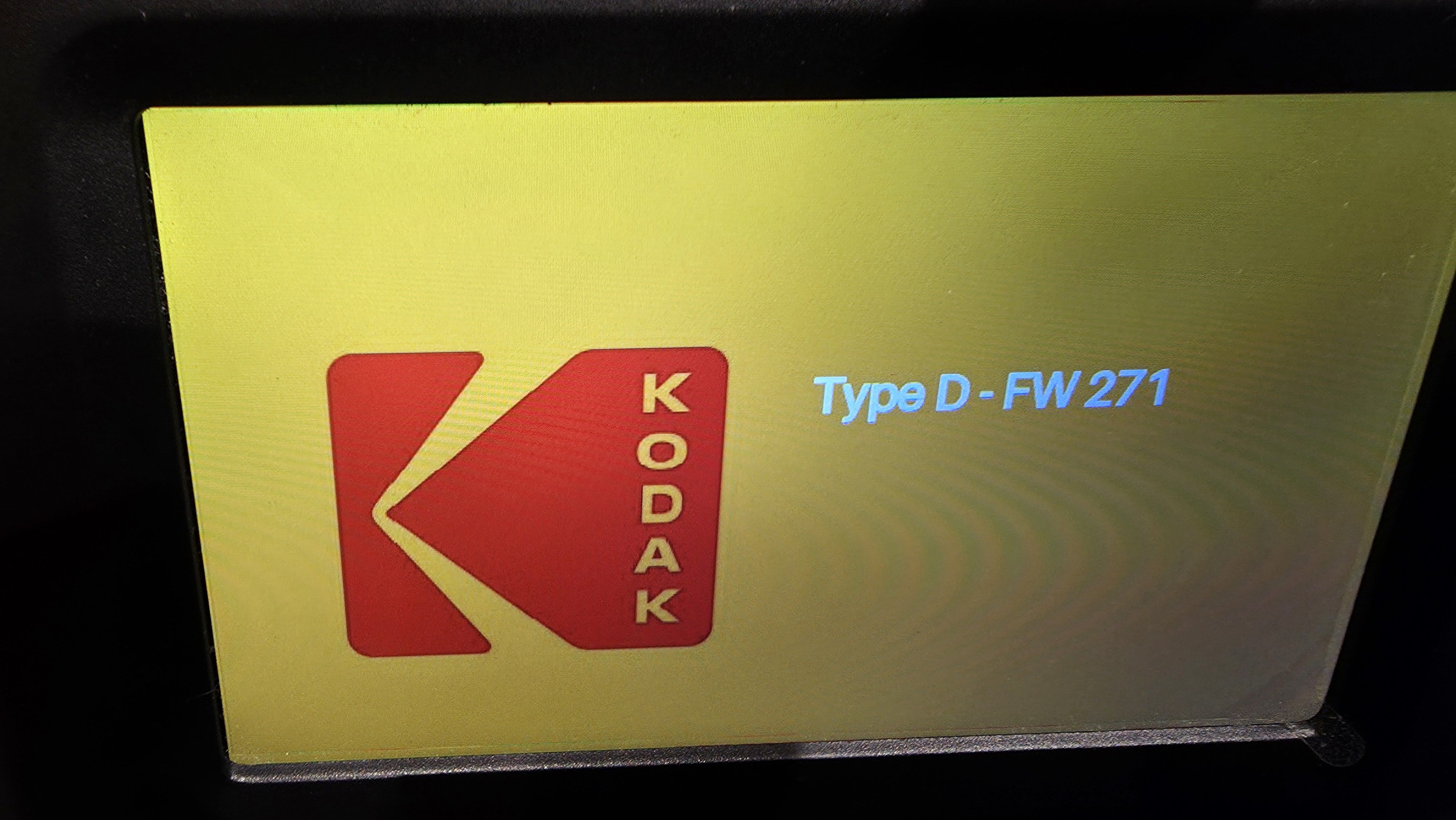

After I posted it, I tried to move the frame and zoom with the software controls. The arrows blink in response to when I hit the buttons, but nothing actually changes. I tried reflashing the firmware to stock D but nothing changes, so I have a hardware issue I'm afraid. Thanks.
