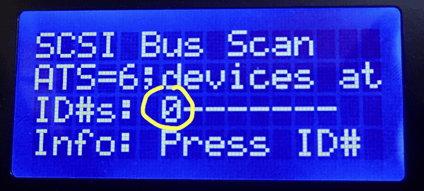

11. SCSI Functions: SCSI Bus SCAN (Let's you type any SCSI ID, but the TechStep is ID6. I tried all others but the internal HDD was not found. Interesting.)
Does yours show the 0?

11. SCSI Functions: SCSI Bus SCAN (Let's you type any SCSI ID, but the TechStep is ID6. I tried all others but the internal HDD was not found. Interesting.) Does yours show the 0?
I don't believe I saw the zero there, no. But my Internal HDD wasn't found either, so I'm not surprised. The TechStep only found itself at SCSI ID6.

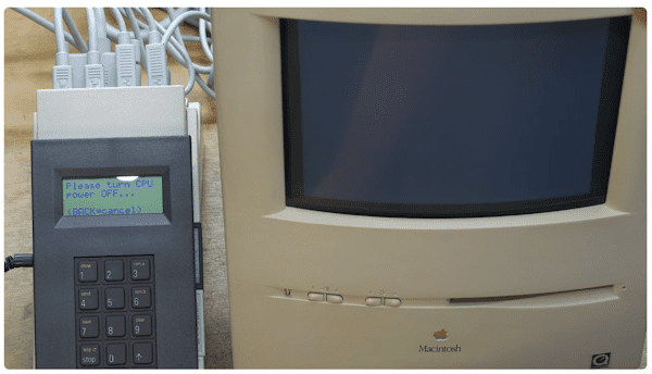

I then reconnected my TechStep again. I first powered on the TechStep, chose LC520, then switched on the main power switch of my Color Classic. When I tried to enter Test Mode it powered on the machine but complained it couldn't use ADB, just like last time. But unlike last time where I chose to use SCSI instead (which worked), this time I backed out and then pressed "3" for Test Mode again, and this time it said it was already connected. That tells me the TechStep isn't waiting long enough to do whatever it's doing on the ADB cables, I think. Now, it didn't tell me if it was using ADB or SCSI, but since I never chose SCSI, I can only assume it entered Test Mode control via ADB.
TechStep's HOME menu shows 1-PowrS, 2-PwUpV...6-FPU. When I press the Down Arrow, I see 1+Floppy Drive, 2+BuiltIn Video and 3-PDF Card ID. When I press 1, I immediately hear the floppy drive access once, and the LCD says "1+Dr.1: 1.4MB". If I then press "1" it will show me a menu of 3 commands: 1-800K GCR (Mac), 2-720K MFM (DOS), 3-1.4MB MFM. Since my TechStep is the complete Apple kit, it includes a Blank 800K and a Blank 1.44MB disk. So I proceeded to do the 800K disk test and it worked on the disk for more than a minute (I didn't time it), and it PASSED. I then did the 1.44MB disk test but it FAILED with Error #5402 saying it's either the Drive or Media. So I tried a different 1.44MB disk and this time it PASSED.
Next, I returned to MENU PAGE 2 and choose "2+BuiltIn Video", which show you the Video Patterns tests. I started with Color (4-bit). To my surprise, after hearing the static sound, the CRT came alive and displayed 5 GRN, 5 BLU, & 6 RED (left to right)! I then did the B&W Bars test and it worked too! I also did the PowerSaver and it worked this time, turning off the CRT (which let me hear the static sound), and then I was able to turn on the screen and display Gray. So both of those tests passed today.

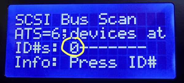

After that, I dug down into the menus and choose SCSI Bus Scan. This time I see exactly what you saw, David...
When I press the 0 key on the TechStep, it says NO SCSI TARGET DEVICE FOUND AT THAT SCSI ID#. And then when I press Back to return to the menu, I see the same as the screenshot above EXCEPT that the zero (0) is now gone. But what I can say is that my spinner drive installed inside the CC is definitely SCSI ID 0.

Finally, I did a Power OFF CPU, which turned it off (no fan spinning, no HDD spinning — all off). Then I did CPU ON, and to my surprise, the CRT came to life with a gray screen and even the arrow pointer in top left, and eventually the disk icon with flashing "?" inside!
I then tried to Power OFF but the TechStep said it was no longer in Test Mode. So I entered Test Mode again and the CRT went black. I then disconnected the Sound Output cable so I could listen for sound coming from the Speaker. I used the TechStep to Power ON again, and this time I heard to bong through the computer's speaker! The CRT lit up too.

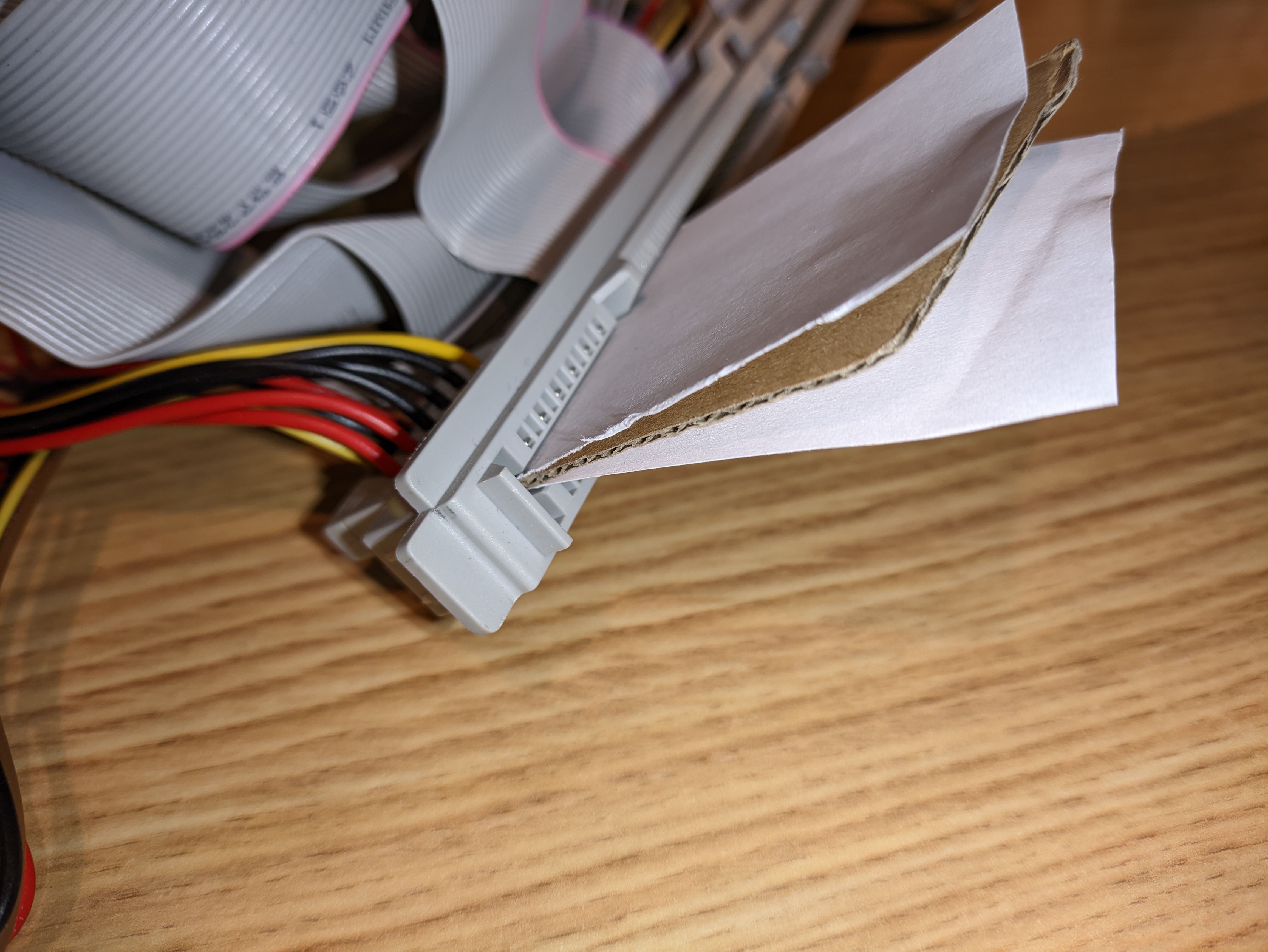

I have a theory. What if the edge connector is finicky? And for whatever reason, your LC 520 board's connector is just enough out of tolerance (thinner) from the CC and 575 chassis? Every time a board is inserted into those chassis, the little fingers on the mating end get pushed further apart.
Here is part of the reason for my theory... the pins in the middle of the connector control turning on sound and the monitor. If those are making intermittent (or no contact), then the motherboard would work but the screen and speaker would not. (Obviously if a bunch of other pins are not mating -- such as on the 575 chassis, then the motherboard wouldn't even turn on)
I guess the next step is to clean the edge connector on the LC 520 motherboard with Deoxit -- just to make sure there is no oil or capacitor gunk. That might fix it.
If you're determined enough, maybe even disassemble the chassis enough to inspect (bend down?) the pins, make sure the board is firmly mating, and even probe pins 37 and 39 with power turned on to make sure they are high.
Wait! Didn't you say you were about to discard the 575 body? Then there's no loss in disassembling it to perform this analysis on those parts.

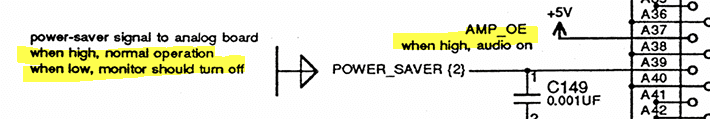

Attached is Apple's Color Classic schematic. See page 12 for the connector pinouts. We assume the LC 520 pinouts are the same, even if the part numbers are renumbered.

I know exactly your concern about DeOxit. I think you should play it safe and just use IPA on the motherboard for the first attempt. Don't be disappointed if it doesn't work -- this is just a theory I have.

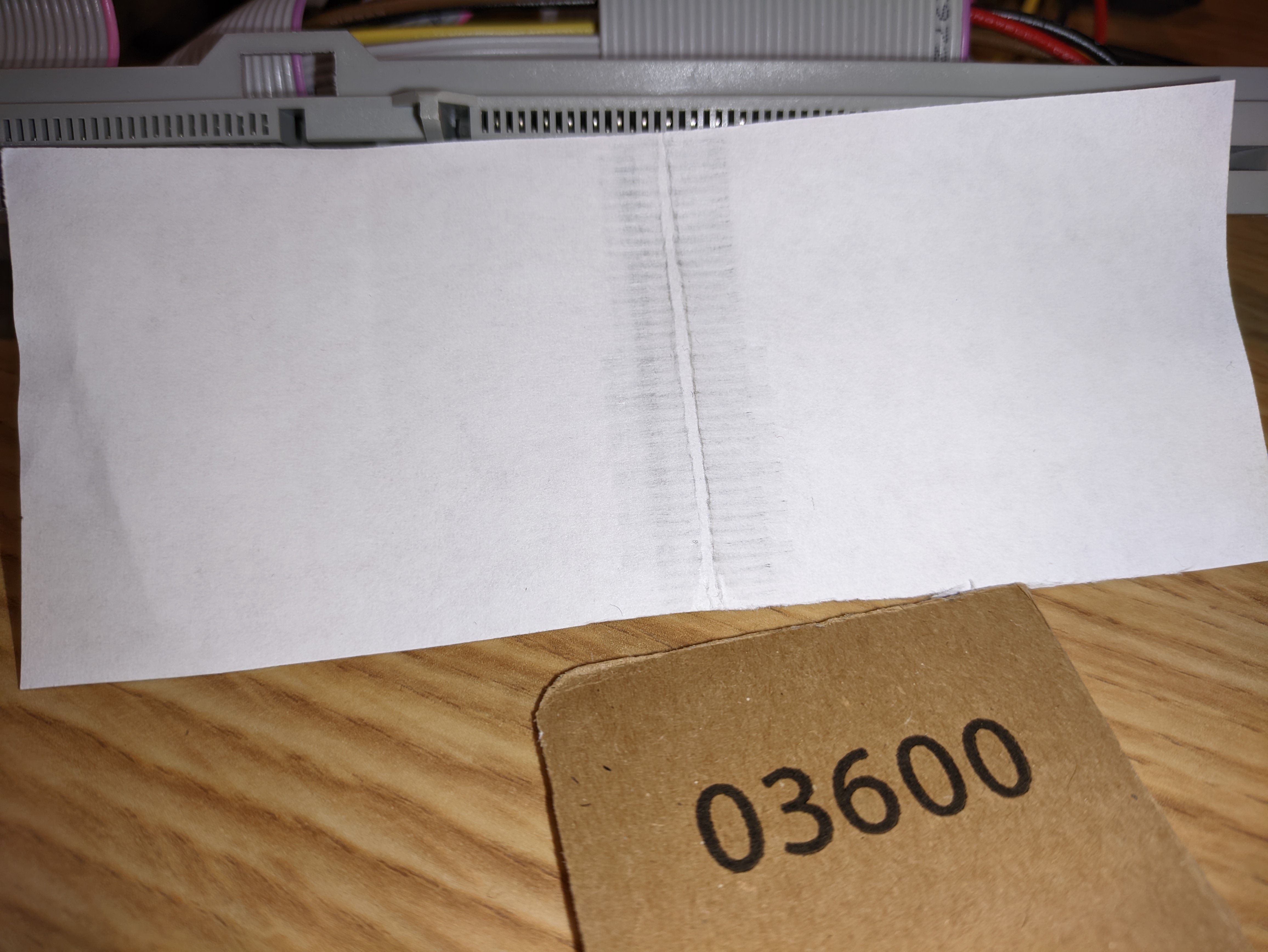

I did make time a few minutes ago to use 100% IPA and a soft used toothbrush to clean the gold fingers of the LC520 board top and bottom and side. I gave it multiple scrubbings. These gold fingers are cleaner than my teeth. That's all I had energy for though, so it will dry over night. I will then measure the thickness of the PCB access the gold fingers tomorrow and compare with my LC575 board and if it is pretty much the same, then I would say that should settle the matter. Because I know the 575 board has ZERO ISSUES with the CC body across multiple removals and insertions.

@David Cook , you're a miracle worker. At least, I think you are.
Last night, I cleaned the gold fingers with 100% IPA. Against the advice of my wife, I decided to go to work today, in part because I hate being absent, but also because my soldering equipment is at the office, and well, PRIORITIES are priorities! So I soldered the 3 resistors back in, cleaned off the flux, then came home, put the 520 board into my CC body, flipping the Power Switch on back to ON, then with great doubt in my mind, I pressed the Power Key on the IIgs Keyboard. Bong. LED lights. HDD spins up. Static sound from the CRT circuit. Then I could hear the drive boot! Then I saw the CRT come to life!
I confirmed it's running at 25MHz and am now running Norton System Info. I've restarted once with success.
So I don't know if it was the gold finger cleaning or the drop in clock speed or both, but for now, it's working. I will of course need to power off and keep testing a bit longer before I make any final conclusions, but one thing I can say for sure...

Using some contact cleaner, insert and remove a couple times a piece of thin cardboard with a layer of paper. A person could fold the paper over itself a few times and get the same result, I just happen to have the cardboard and wanted something to grab onto.
I'm sure there are dedicated slot cleaning tools, but I'm not that fancy or worried, personally. It's a one-off event and beats grinding scum against the contacts every board-insertion in my opinion. (and I use my loose harnesses.)
Here is a Performa 631CD chassis harness I got off ebay a couple years ago I just did as an example. As I type this that system is sitting beside me testing some random unmarked RAM before I pack it away again.
I certainly don't expect miracles and I'm not saying this fixes anything/everything, but it can be a fun game of "Did I really want to know..." if something turns out to be more gross than expected. :ROFLMAO:
