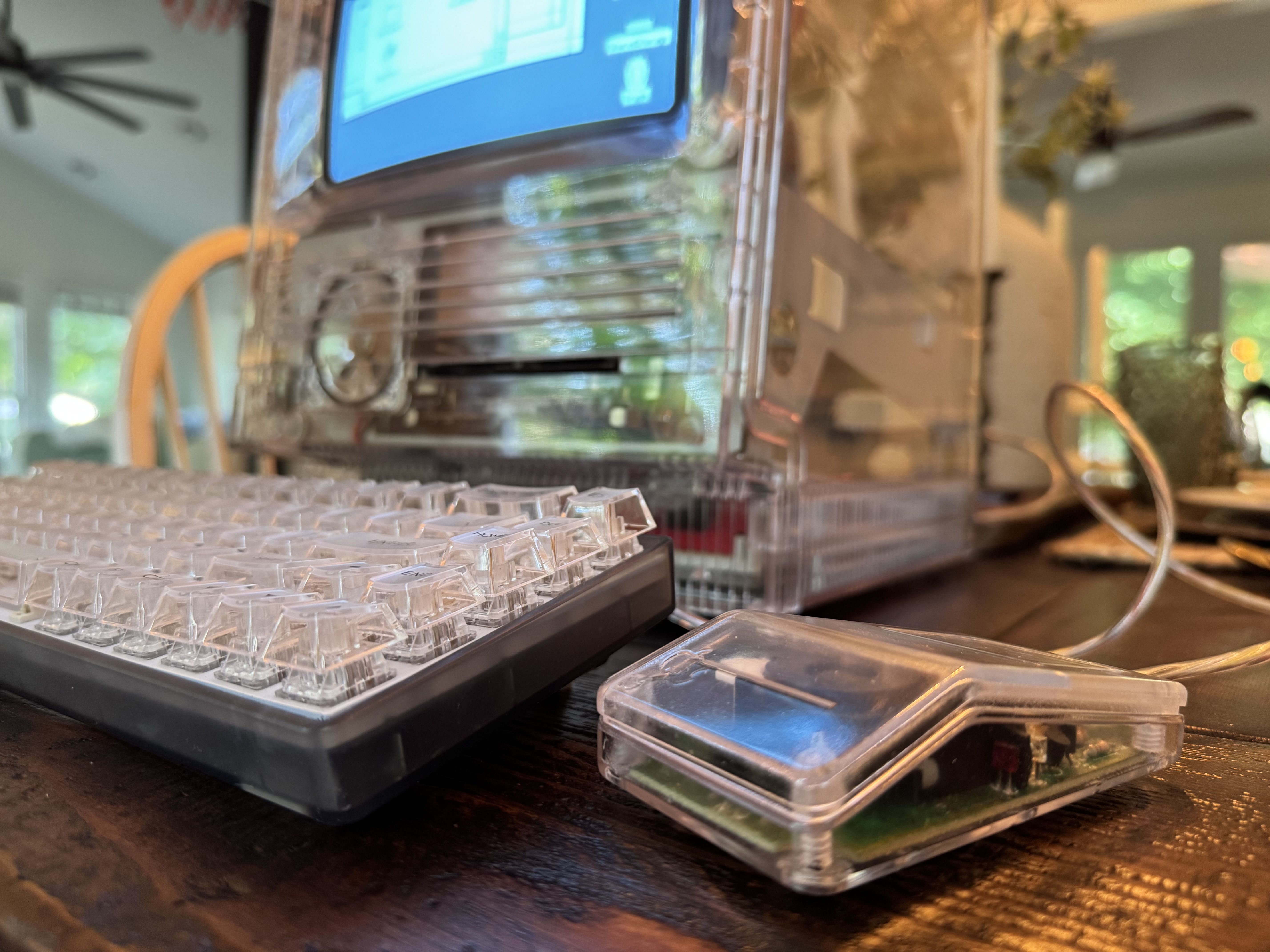

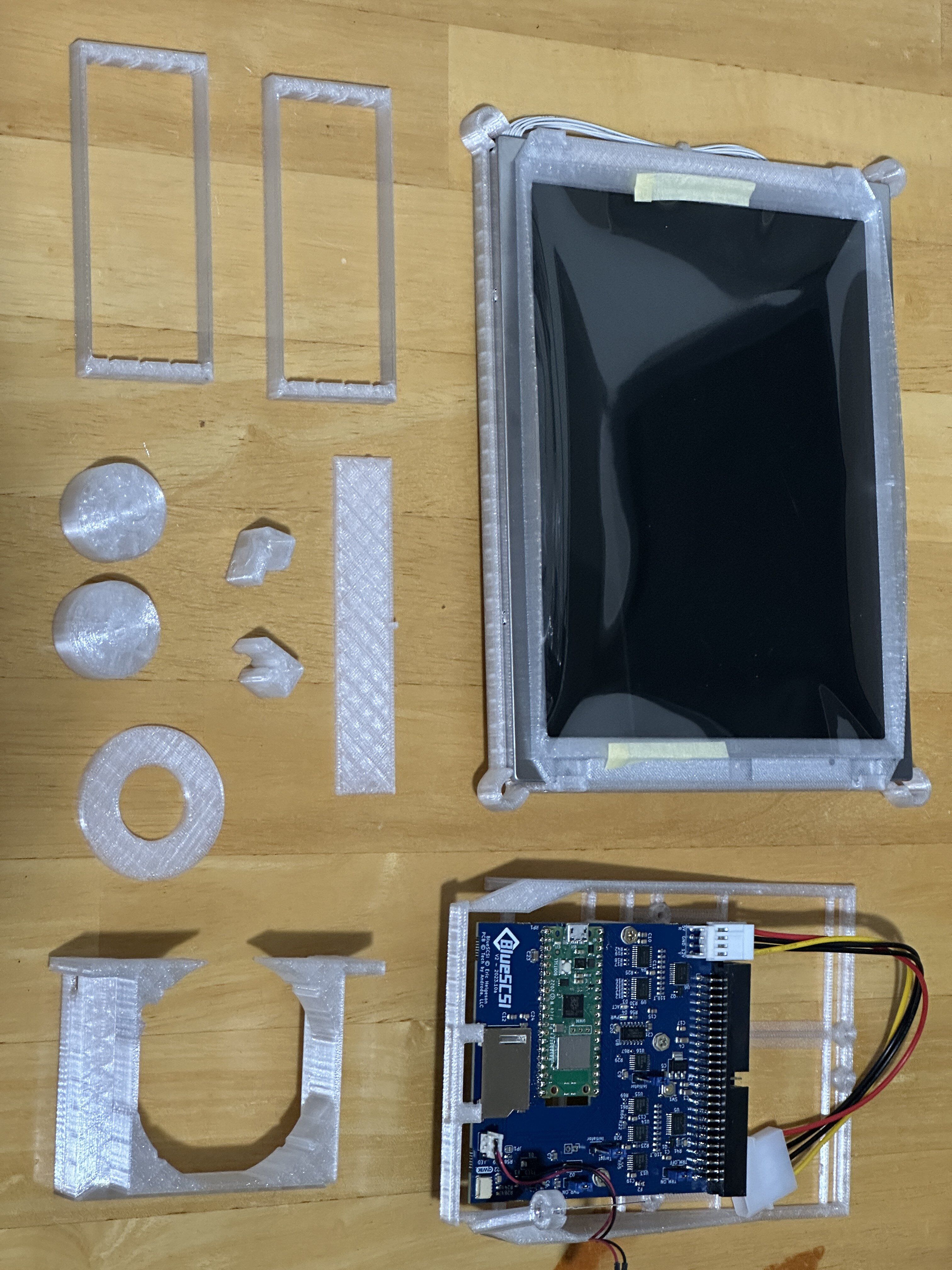

@wottle How well does the back panel fit over your crystal clear BlueSCSI2 mounting bracket? I am comparing the amount it protrudes into the expansion port area and it is almost double the version I have installed in my SE/30 today which sits flush. I have not assembled my MacEffects case yet, so maybe it is thicker, but does yours
The firm’s very nice. I’m not home right now but I feel like the extruding part is nearly flush with the back of the case.
caver01
That‘s excellent. Thanks for sharing those photos. . . Wow that clear resin version looks really nice. I know you commented on it having a little texture, but this looks way better than mine will look. You can see the PCB right against the “window”.
I am printing my bracket now using your model. Much appreciated. I did split it into three pieces instead of just two to avoid overhangs.
Yeah, my model was more optimized for the resin printing I was planning to do, so it is probably not as good for FDM printers. I also found this model, which looks like it may be better suited for FDM printing. Also, with its thinner outer wall, I wonder if it would look better with the clear resin print. I can't tell which version of the BlueSCSI v2 it was built for, so my guess is I'd need to create a version with different mount locations.
I do really like the one I made, so it's not worth it for me to re-print a new mount, but I may see if I can update that print for others that might want to do the same. The cost savings appear to be significant. The one I posted cost ~$15 to print in clear resin, the model linked above only costs ~$6 to print in clear resin. If anyone is interested, let me know and I can try to update the above linked model to have the proper screw mount locations for 2023.10a version of the BlueSCSI v2.

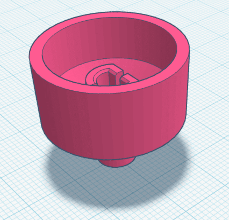

People who want to print the knob (normal inner diameter version or the slightly larger 6.2 version) should grab the download here.

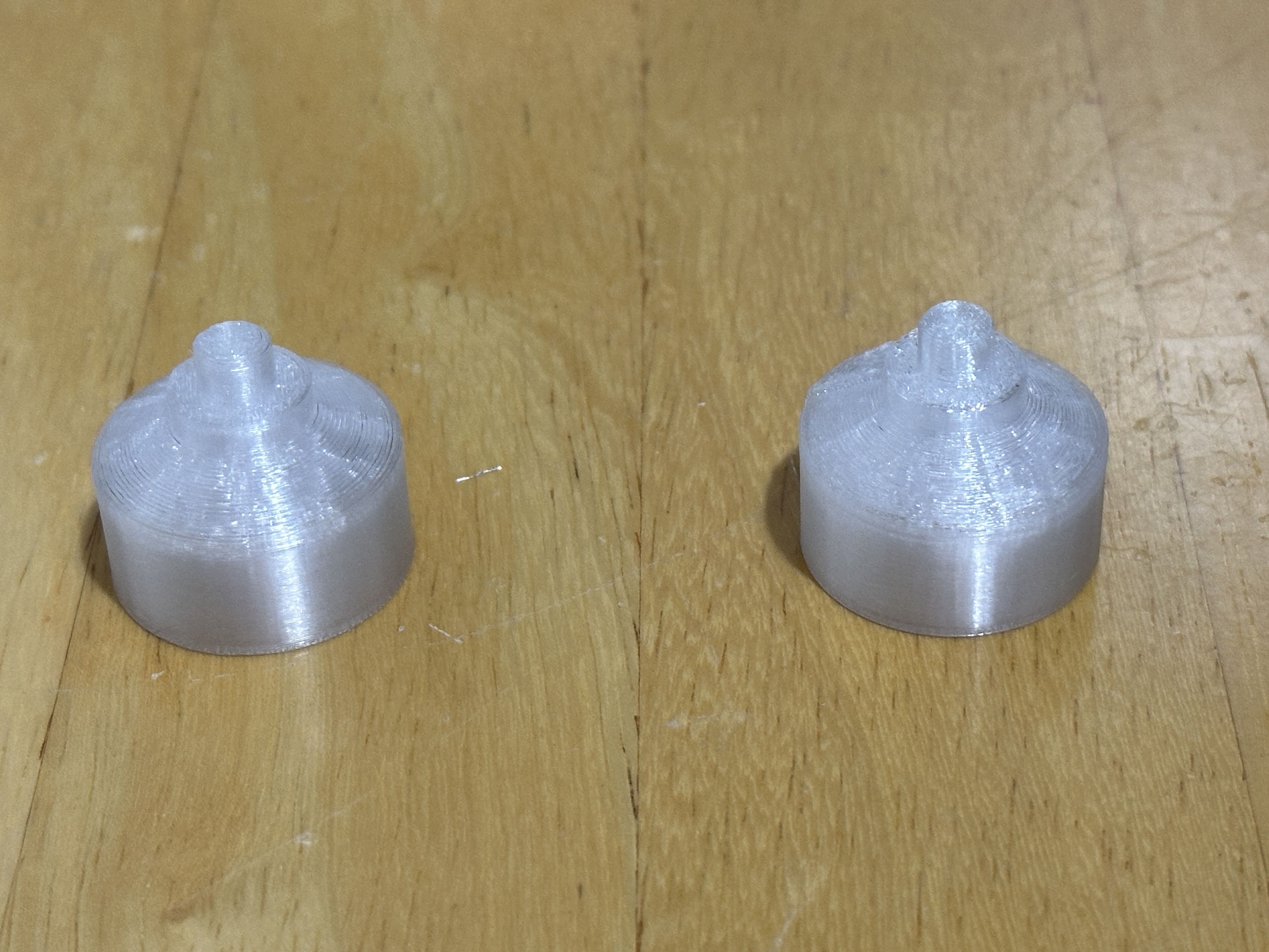

I printed the standard knob (not the 6.2 version) in TPU just for fun, but it mounts easily on the POT due to its flexibility, although it is only semi-transparent. And sadly, JLC3DP wouldn't process it without the silly brim due to their min. size restrictions, which means if you print it in TPU at JLC, you will need to spend time removing the brim. Should be easy but I've not done it yet.

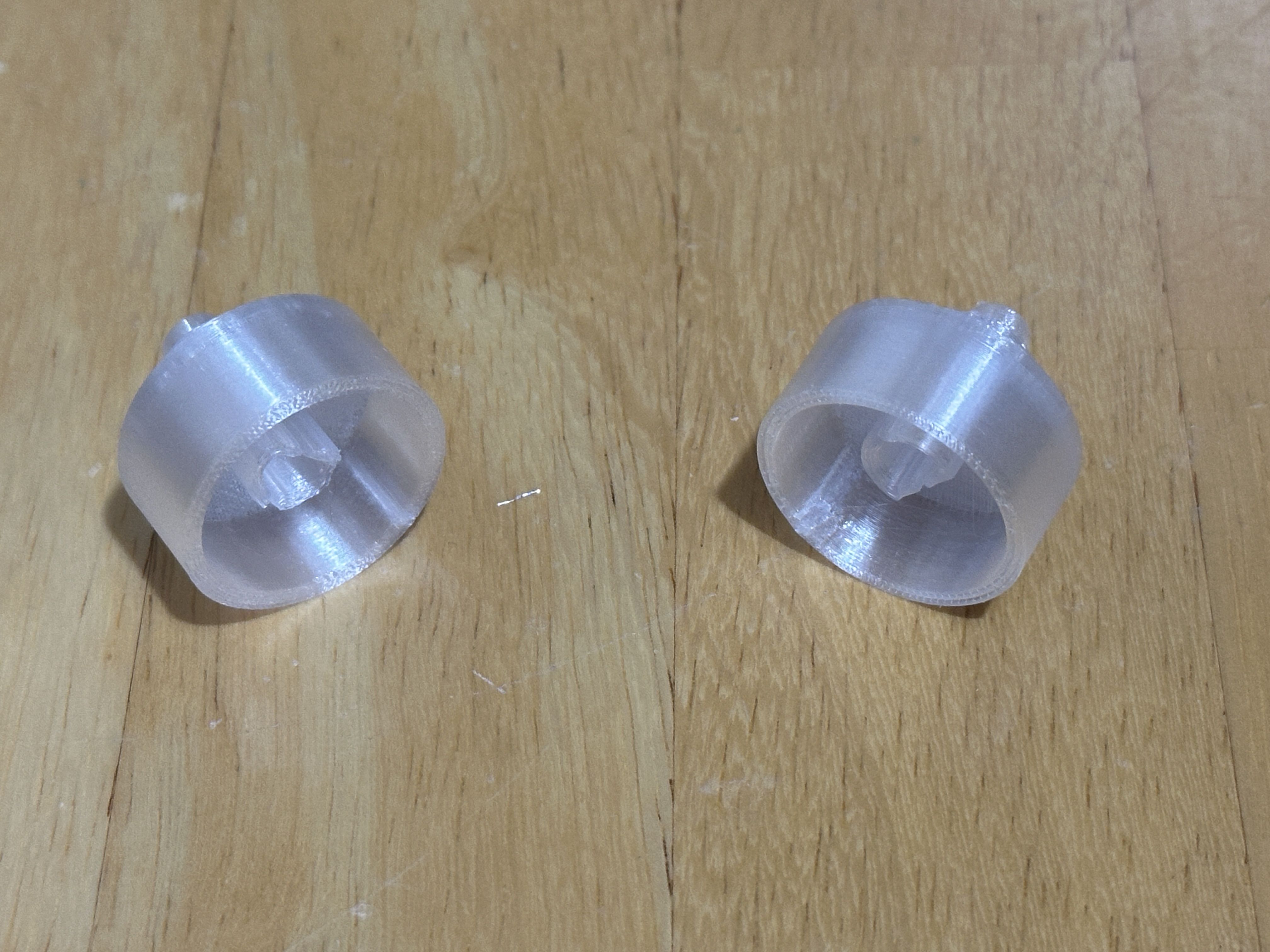

I then printed two versions in 100% transparent SLA 8001 resin, one being the standard inner diameter and the other being the 6.2 version.
Hands down, print the 6.2, not the smaller diameter version STL! Because even the 6.2 didn't slide on as easy as the factory knob does, neither on the factory Analog Board POT, nor on the replacement POT for the @zigzagjoe Dummy Analog Board. Note that in the two photos below, I didn't slide the transparent one on all the way because it's tighter than the factory knob and I knew that sliding it on all the way would mean I would need to fight and riddle to get it off, and I didn't want to do that. I wanted to get my photos edited and uploaded for you folks faster. :)
