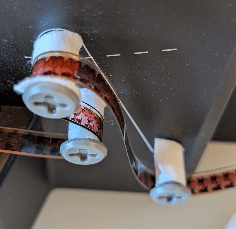

I'm not sure what scratches the film, I haven't done anything more than put PEC PAD on the rollers (which seems to help.)

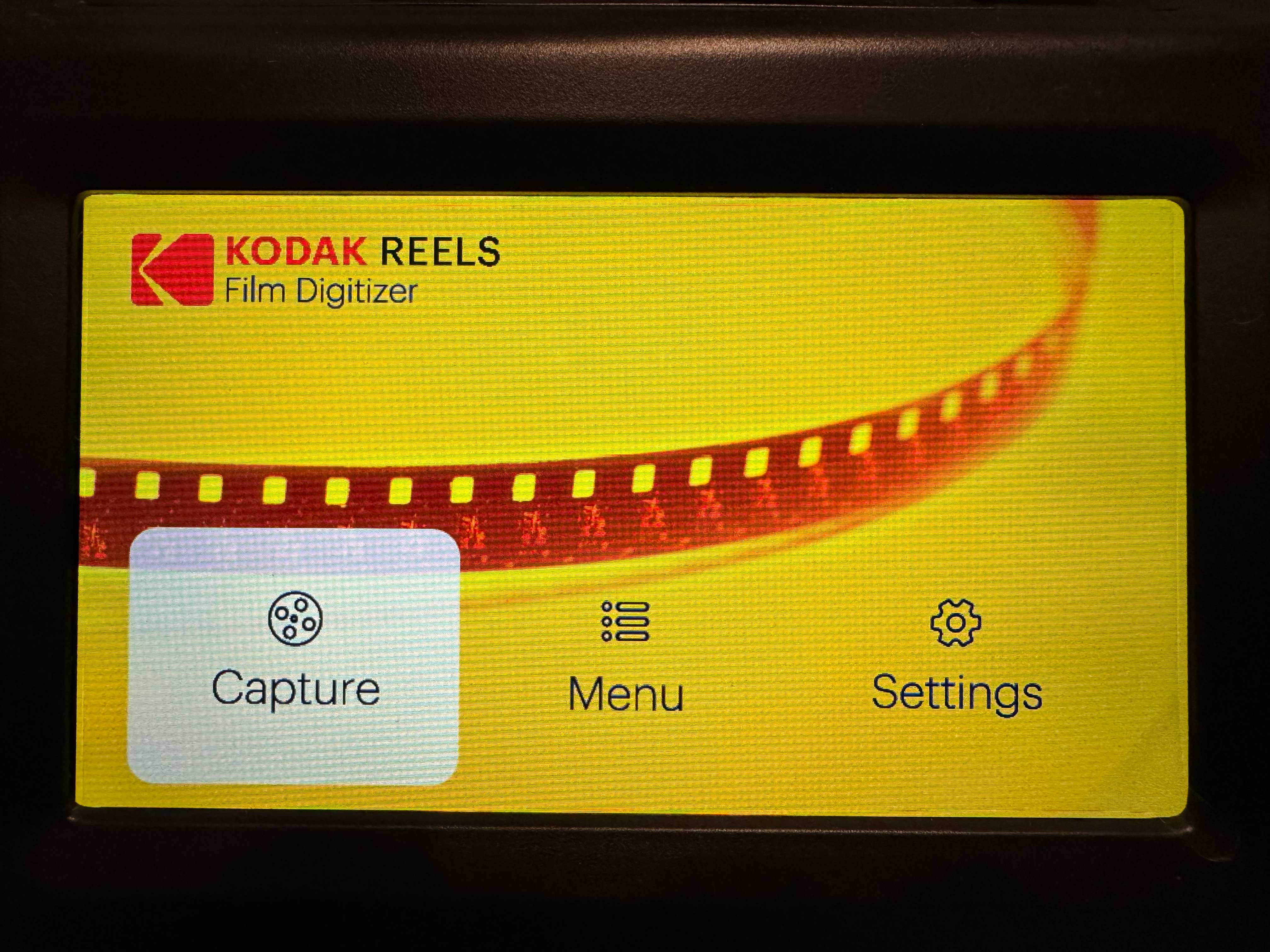

Hello everyone,
I wanted to scan some of my grandfather's 8mm films and was not satisfied with the scan results from the Kodak Reels. It is a newer device, model number RODREELSEU, with serial number H282... and version 2.0 on the "About Us" screen.
I started with Steve's Kodak 8mm Digitizer Firmware Lookup Tool. Results:
"Your serial number was NOT found on the list.
Use Firmware B labeled files for your device."
In the second step, I installed Firmware B FWDV280.bin v7.1.1. Reboot and start logo are normal, but all the buttons no longer work. I can't adjust any settings or start scanning. I then tried v7.1 and v7.0, but the buttons still didn't work.
Please help! Kodak no longer offers original firmware either. So I'm currently stuck :-(
Many thanks in advance!

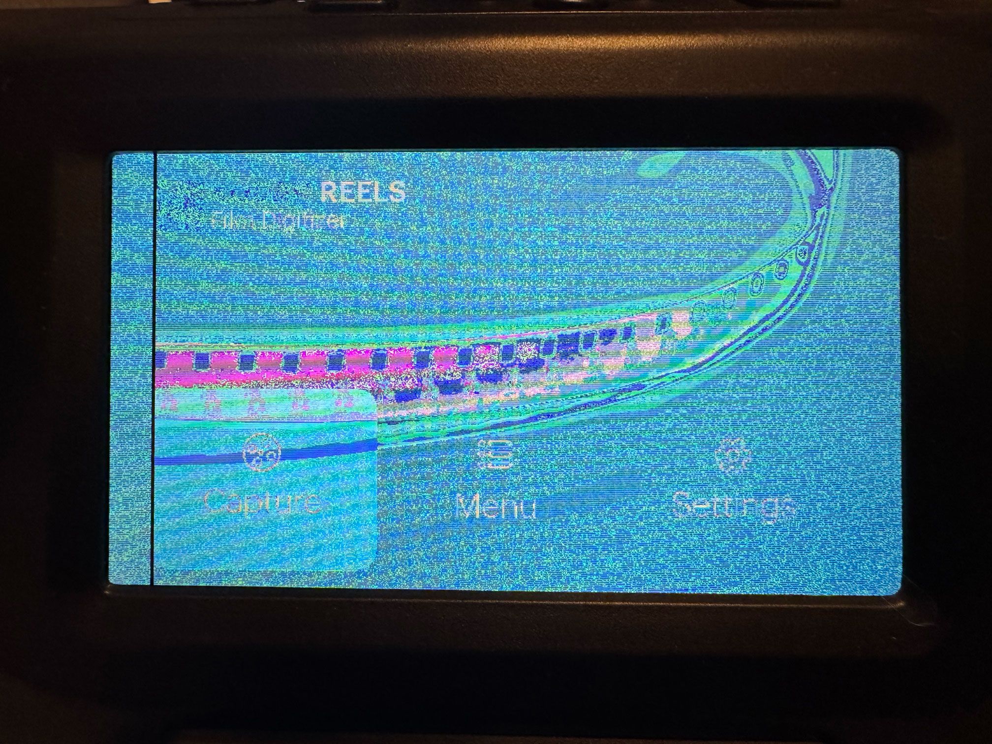

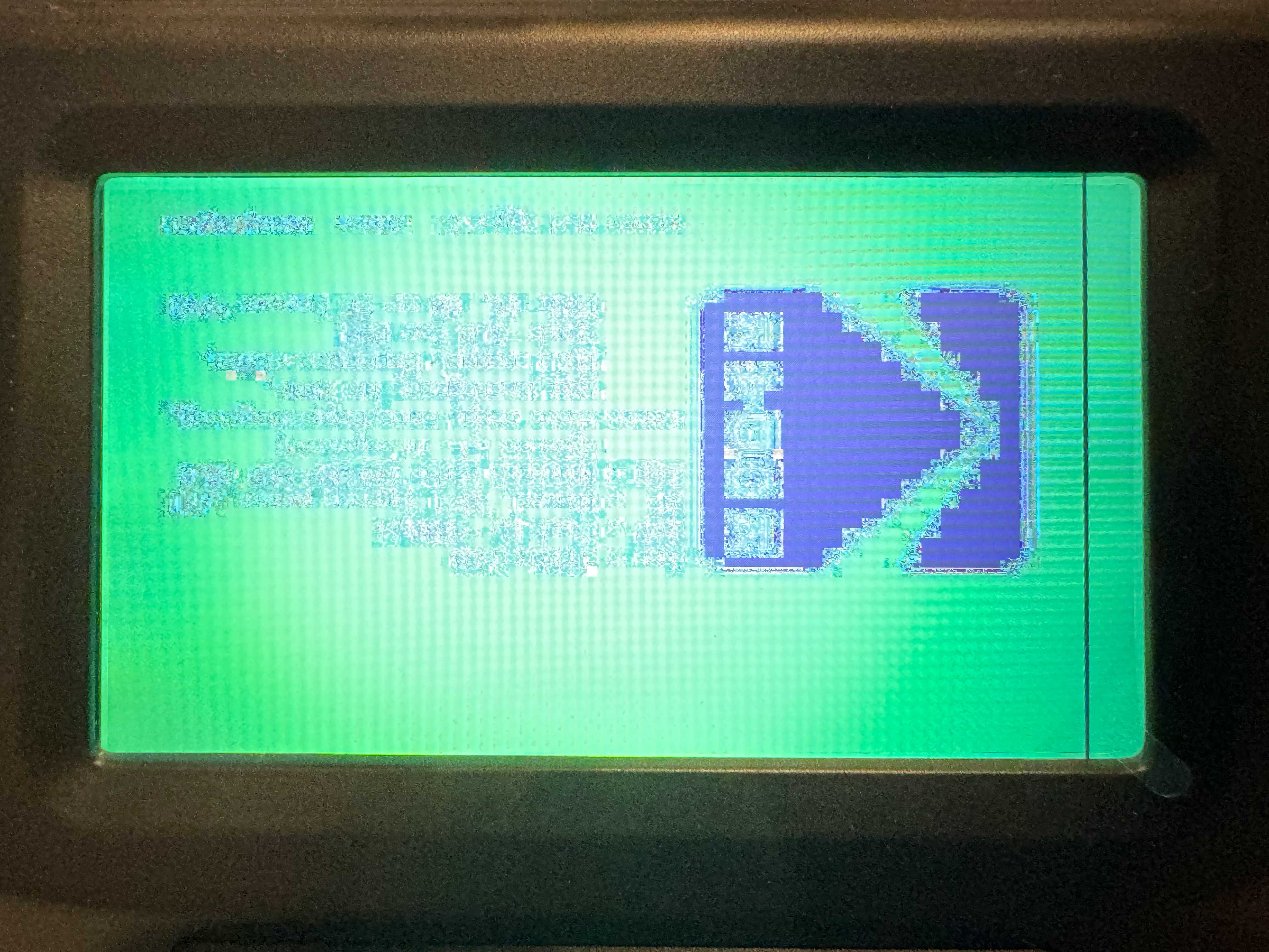

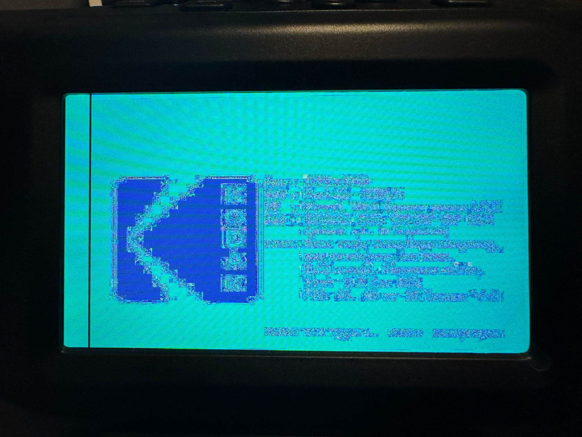

Thank you very much for your replies ThePhage and fishgee!

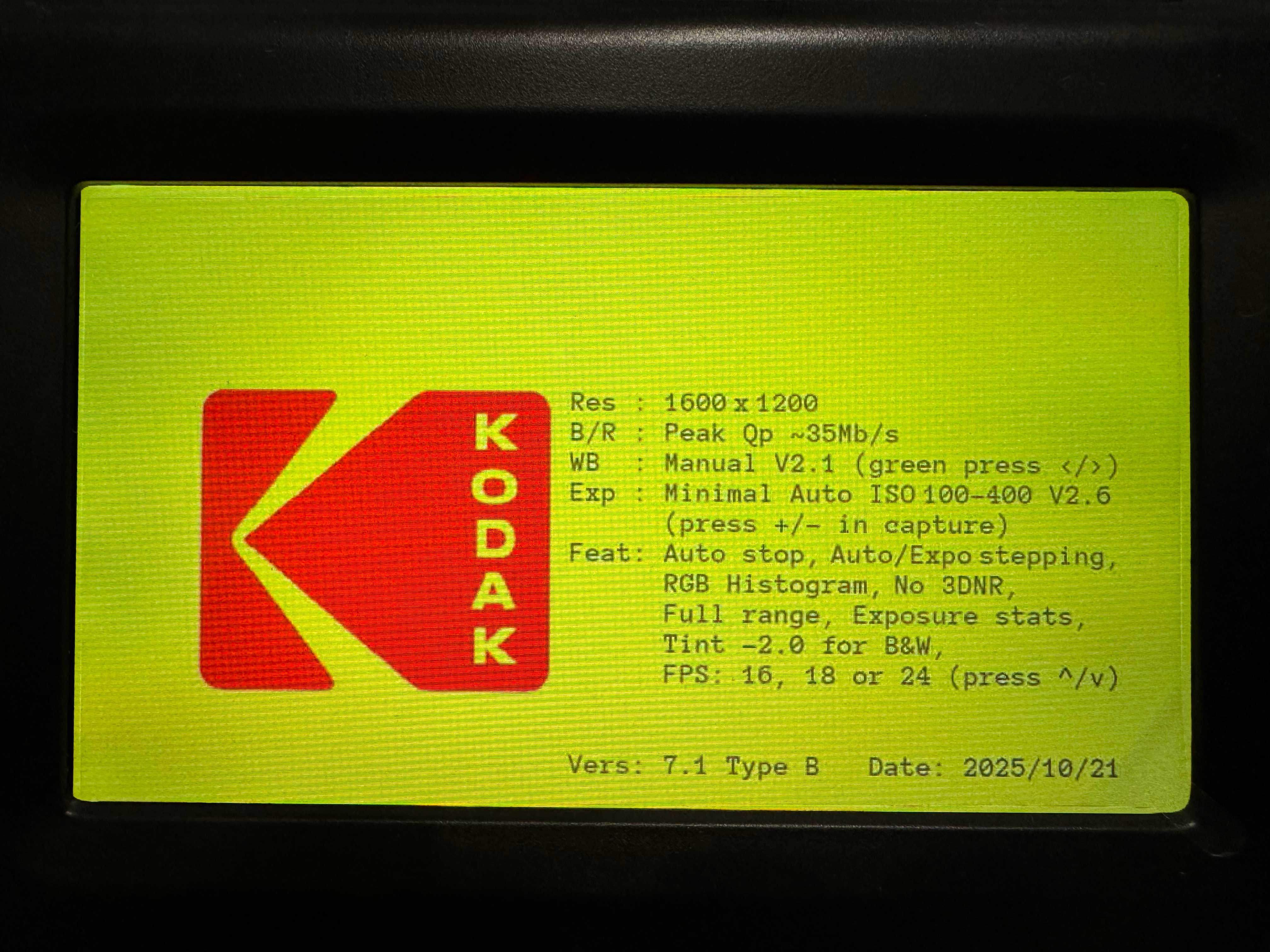

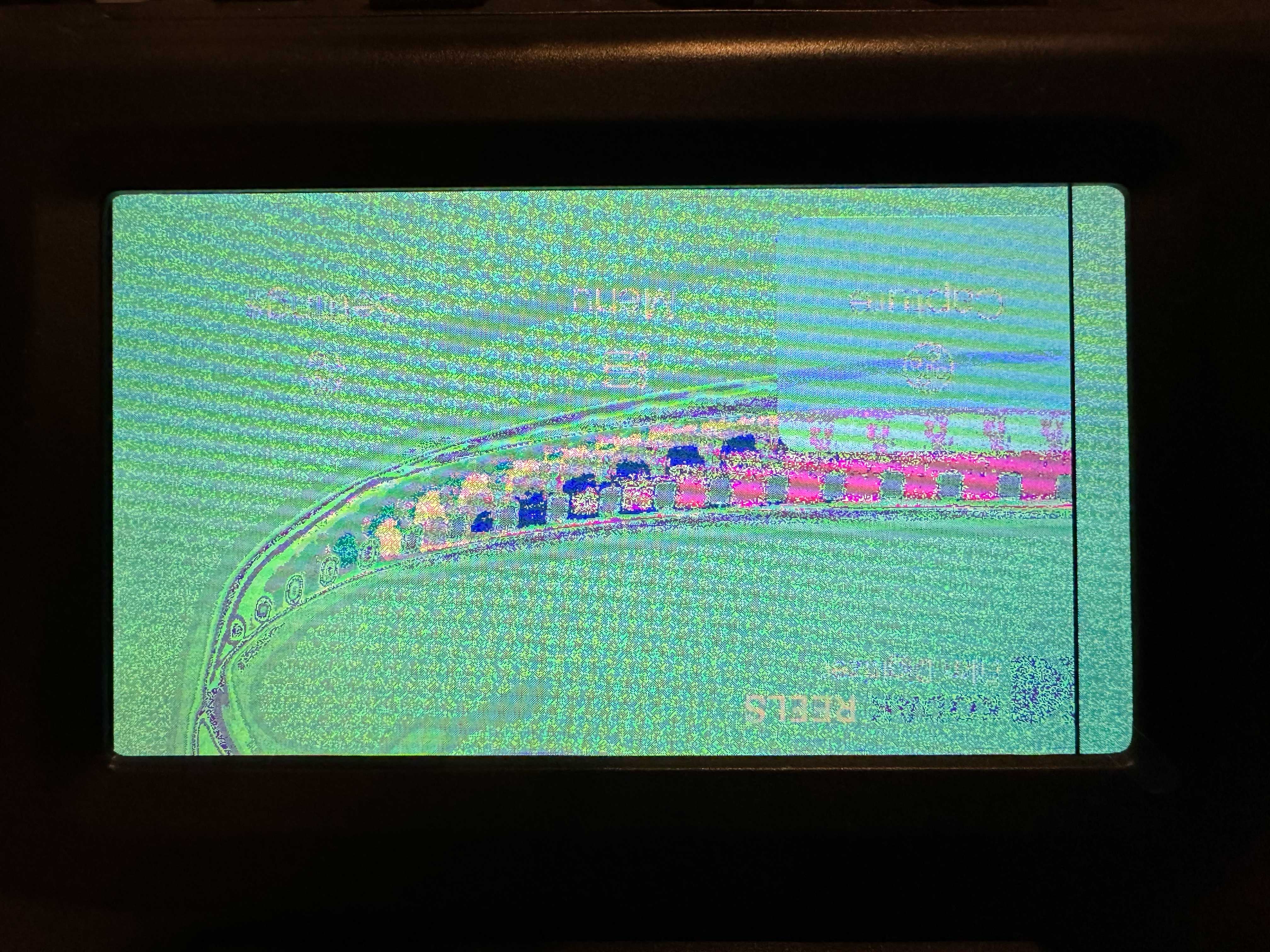

I tested the firmware from 0dan0 (post Oct 22, 2025) v7.1 for both TypeB and TypeC. Unfortunately, without success.
With TypeB, as before, all buttons are dead.
With TypeC, nothing works either, and the screens also have color shifts.
4 attachments are included for reference.
What can I try next?
Best regards,
The grandson

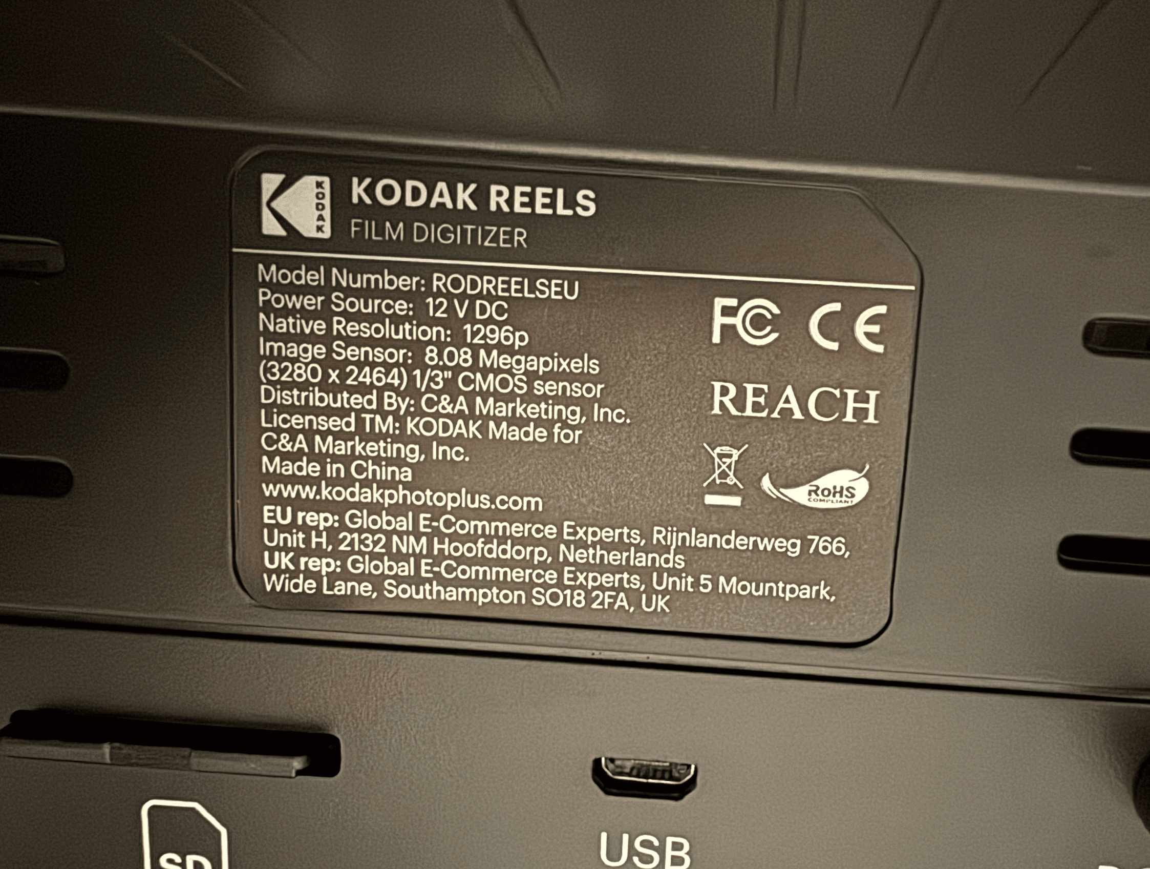

I noticed your model number is RODREELSEU. Mine (in US) is just RODREELS without the EU. Is your unit a European one? If so, maybe that is the reason the firmware isn't working 100%. If you go way back to the first posts of this thread, I think the original Kodak versions of firmware were posted. Sort of a fall back position in case things went sideways. Look for an original B version, since the C you tried screwed up the display. Best of luck.
Grandson
Nov 21, 2025
Yes, that's right, fishgee, it's a model purchased in the EU.
I've now tried various firmware versions, including the ones without the hack—Kodak firmware.
Unfortunately, without success so far.
It boots up, the screen appears, but all the buttons are dead—they don't work.

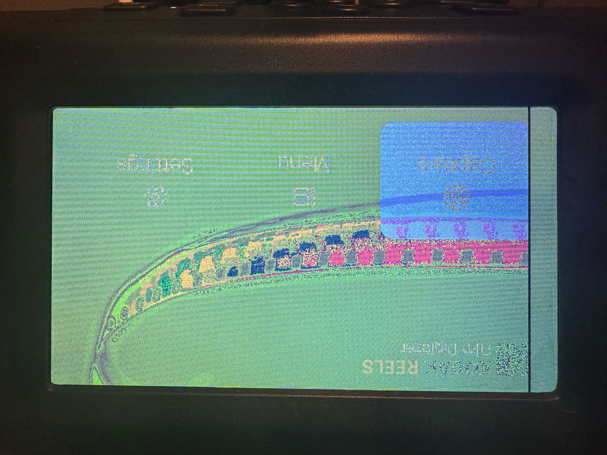

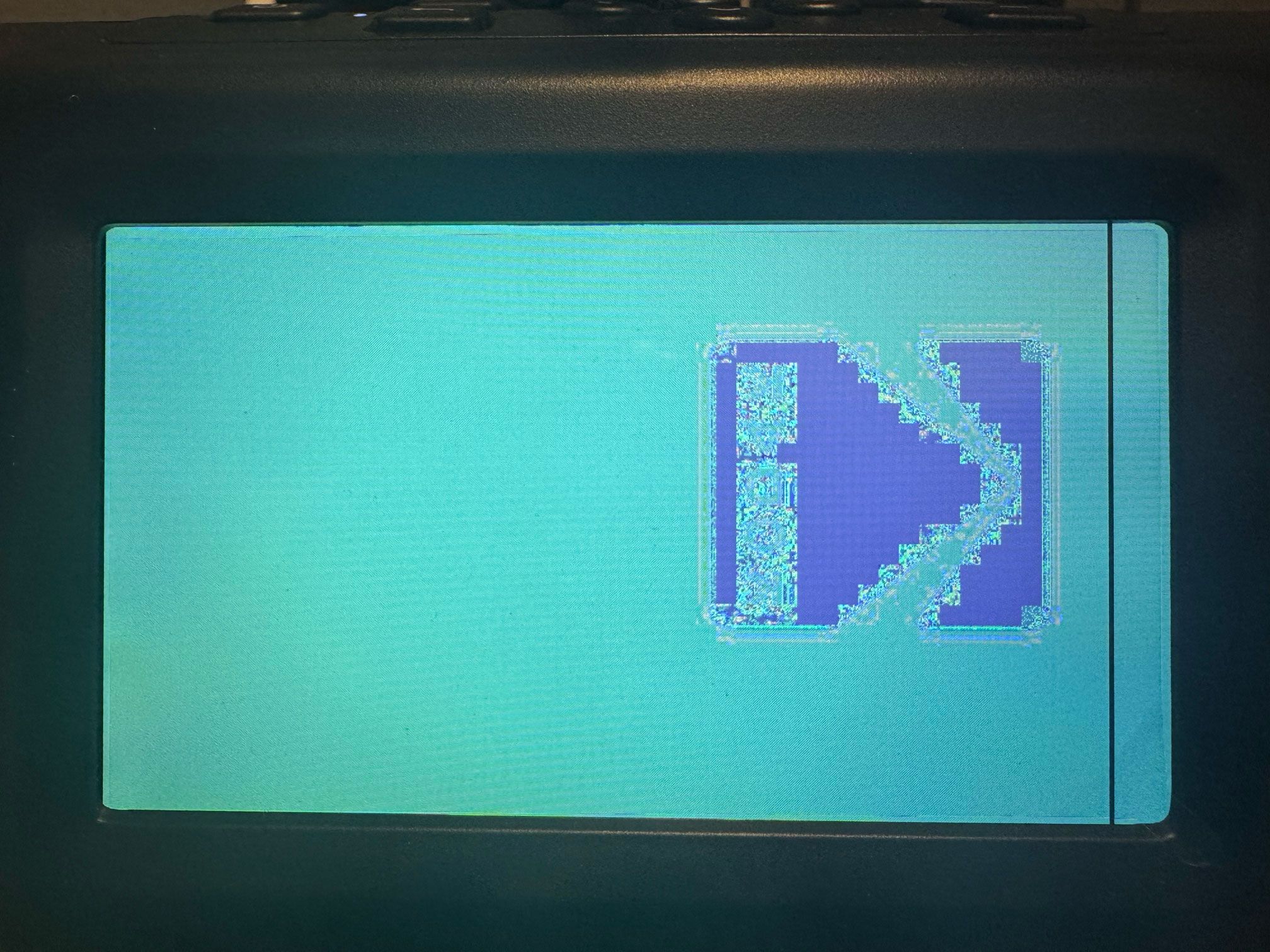

Firmware A also tested, without success.
See attached screenshots.

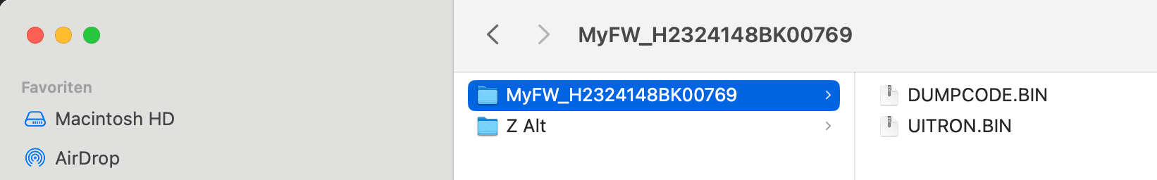

I unzipped the MyFW_H2324148BK00769 folder. It contains two files: DUMPCODE.BIN and UITRON.BIN.
Are these supposed to go on the SD card for a firmware update?
I tried it, but nothing changed. See screenshots above (my last post).

I'm really sorry. I forgot to write that the file UITRON.BIN needs to be renamed to FWDV280.
