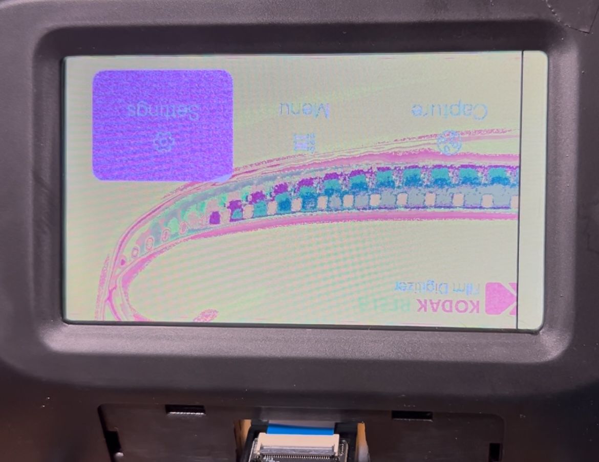

Great news!!
Thanks to the great efforts of @wnt2fly - we now have a fix for users who were experiencing weird screen issues! This firmware file should solve those problems, 🥳
It seems any model with a serial number that begins with H2324148BK.....has some different hardware inside which caused problems when using different firmware. So if your model had issues before, it doesn't hurt to try this firmware to see if fixes it. Please report back if it does.
I've also updated my 8mm Lookup Tool to understand there is a 3rd variant of this firmware. So if you enter a serial number on that website, and if it starts with H2324148BK... it will tell you to download "firmware C"
And again, huge thanks to @wnt2fly for helping out! 👏
The above photo is my unit (which does not support this variant firmware) with a messed up screen, showing you what users have been experiencing if the wrong firmware is flashed to the wrong hardware.
  • Kodak FW for H2324148BK Series.zip
Reactions: Federico

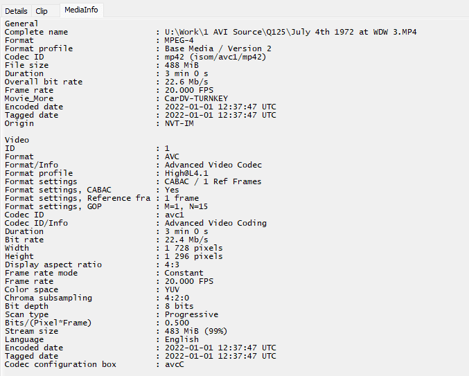

Hello, that sounds fantastic. Is the modification of the firmware in terms of bit rate and resolution also applicable? Or has this not been tested? In any case, great work, thank you very much.
wnt2fly
Dec 23, 2024
16
21
I modified firmware for my own and I'm recording at 1728x1296 at 22413kbps; see attached MediaInfo from a file the modded unit created.
Regarding updated files, i'll let @Mac84 create those.
I'm also thinking if we can find someone to decompile the firmware and see if we can turn off auto whitebalance and brightness, TBD right now.. have a few other things to do and then I may reach out to a dev community and see if i can pay someone to look into this firmware further.
