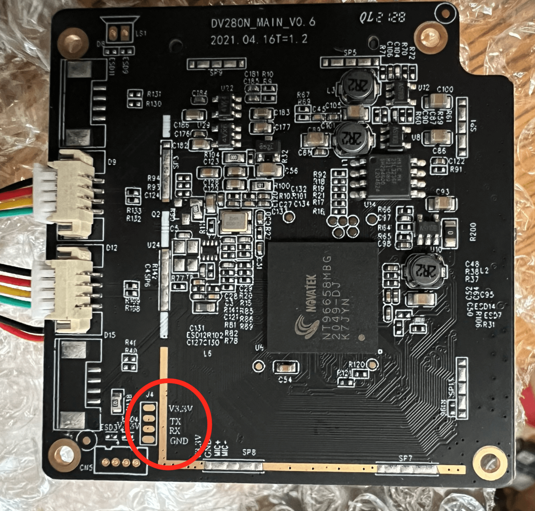

I've successfully connected an Arduino Nano (acting as a UART TTY serial to USB adapter) to the Kodak digitizer, which had nicely labeled and exposed serial connections.
Setting the baud rate to 115200 allows me to connect and access, with plenty of things to look at! 🎉
It let me dump the firmware, run SD card checks... and loads more. More importantly, it's showing me errors and is giving me clues to what is happening (and potentially why) when I give it a firmware with too aspirational resolution / bit rate settings.
The serial pinout is circled below, I only needed to connect Ground, RX and TX. Cool stuff! I'll provide another update if this gets me further.
