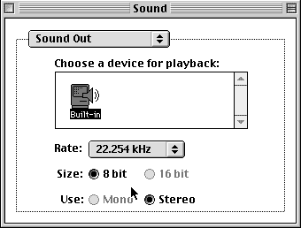

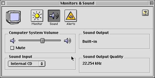

Hmm... Not sure what's going on...
Sounds Control Panel indicates Stereo
But Monitors & Sound doesn't look like it is...
AppleCD Audio Player plays through all speakers even when selecting left or right. Am I missing something?

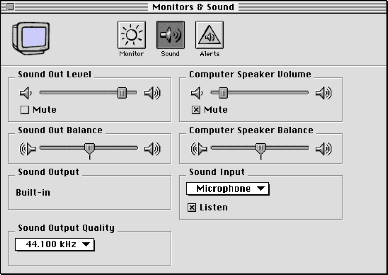

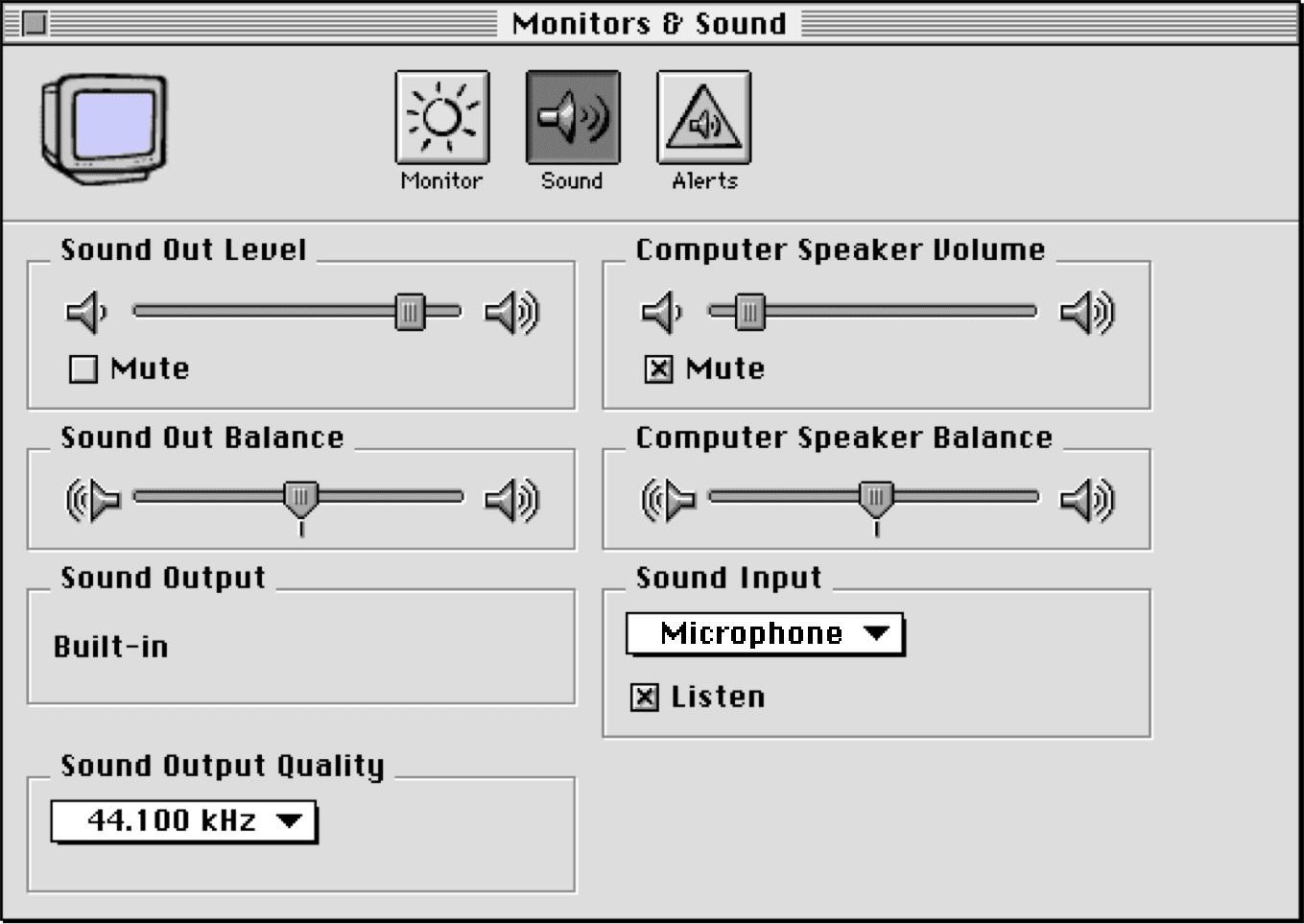

I can confirm today that after doing the STEREO MOD on my own Color Classic and when booted into OS 8.1, the Monitors and Sound control panel looks exactly the same as yours, without the additional controls like Balance. :-(
What defines "stereo"? Is this dual Mono?
I must assume it is Stereo insofar as when I load Duke Nukem 3D and walk near the fire (with Flip Stereo enabled), I can hear the fire out of the left speaker as I put Duke's left ear to the fire side, and I hear the fire out of the right speaker when I move his right ear toward the crackling fire. So that tells me it is stereo of some sort. And yet, OS 8.1 does not recognize it, which is interesting because the LC575 motherboard has the PCB pads for that second Amplifier IC, as if it was designed to originally have that second chip for something. Even so, it's clear that OS support is lacking.
I also though the new speaker I added would not sound as loud as the stock speaker because I didn't drill any extra holes, but in fact, it sounds a tad louder. Could be the speaker. Could be the fact I added thicker wires than the stock speaker wires, or it could be that there's a huge gaping hole beneath my second speaker which isn't found under the stock speaker, thereby allowing more of the sound of the new speaker to get out.
