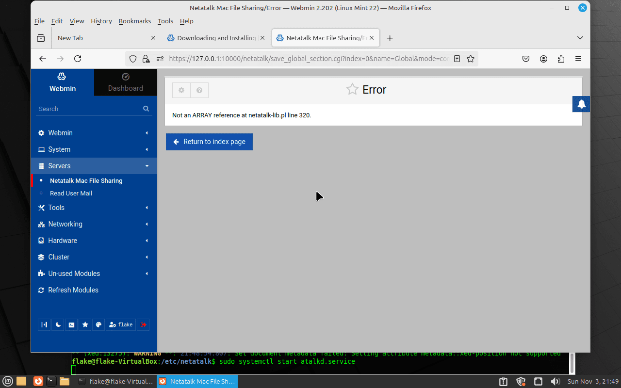

More updates. Newly compiled 4.0.4 under Mint 22 once again.
No issues with the netatalk file server feature. I compiled for Webmin and got it all set up first, then built & compiled Netatalk. Seems like the Webmin module is still in beta status though:

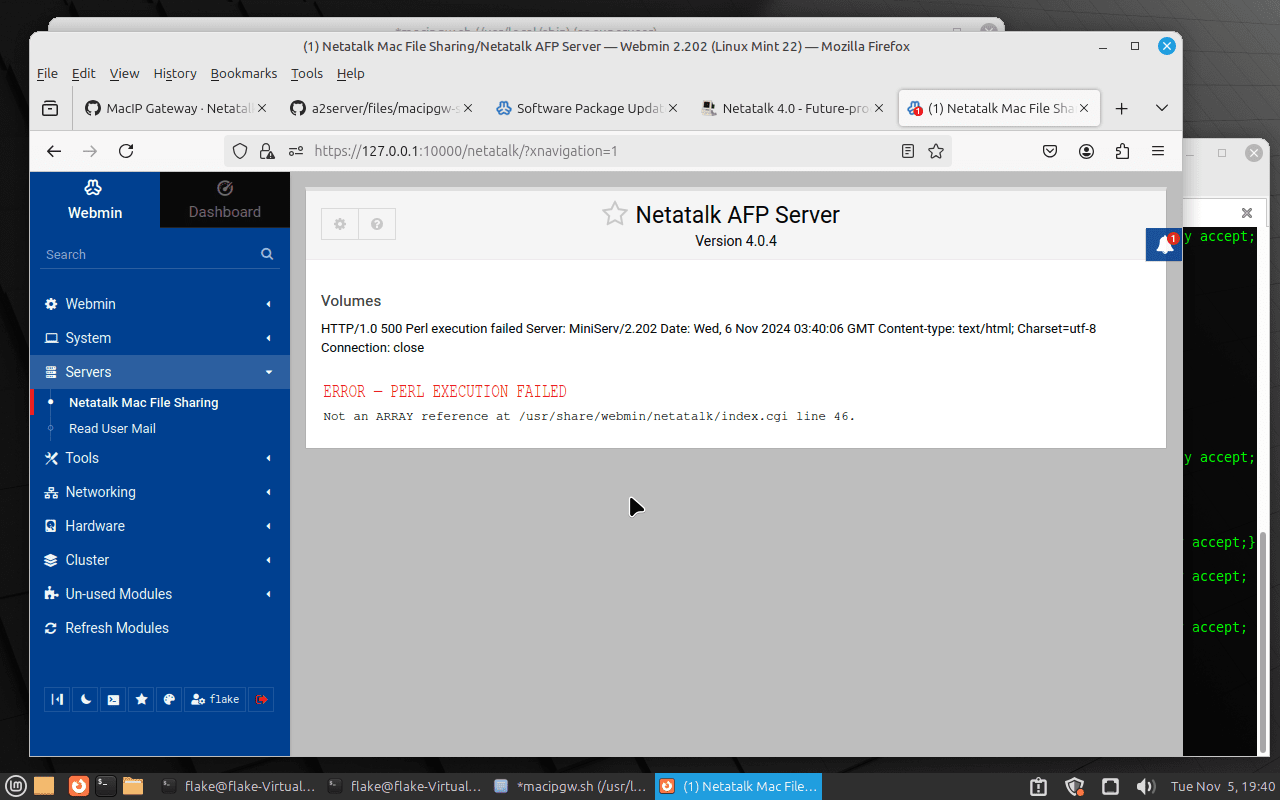

View attachment 18549View attachment 18550
First image is after doing something simple, like changing the log file location. Simply errors out after saving.
Second image is today. Can't log in to it.
My immediate thought here is that Mint may not include the Perl libraries required by Webmin by default. Or shipping a Perl version that doesn't understand the double dollar sign notation... both seem unlikely though.
Anyhow, both errors are at lines in the codebase with double dollar sign notation, so the dereferencing of the pointer variable to the array data structure representing afp.conf is failing.
What does your afp.conf look like when this error is happening? Perhaps there's something in your afp.conf that when parsed by Perl turns into an invalid data structure. If we can find out what's triggering this, we can improve the error handling.

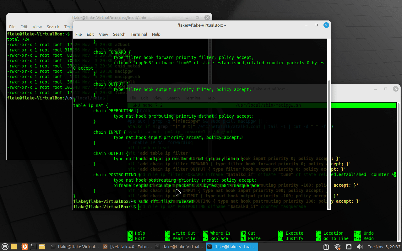

Can you please run macipgw with debug output enabled and share the logs? The debug info was very helpful to me when I was having issues on Debian Testing. It will tell you exactly what is happening in the tunnel, data sent and received, etc.

macipgw log. 7.1 with OT 1.3 copying 1 file from a 10.4 Tiger system, tried to FTP to the 10.4 machine, said illegal PORT command rejected, then tried to ftp to ftp.belnet.be. That timed out.
edit: ugh this weird, macipgw-VM from MacIP.net doesn't work either...

@Mk.558 I have found a fix for the webmin module bug. This is something I broke in the latest version because I tried to do "clever" path substitution in the build system to present the user with the actual default paths to the UAM libs as well as the afppasswd shadow file. However, this clearly broke the Perl code in insidious ways. Probably because Perl contains healthy amounts of @ symbols, which we also use for substitution in the build system. Not a good combination.
Fix here: https://github.com/Netatalk/netatalk/pull/1736
