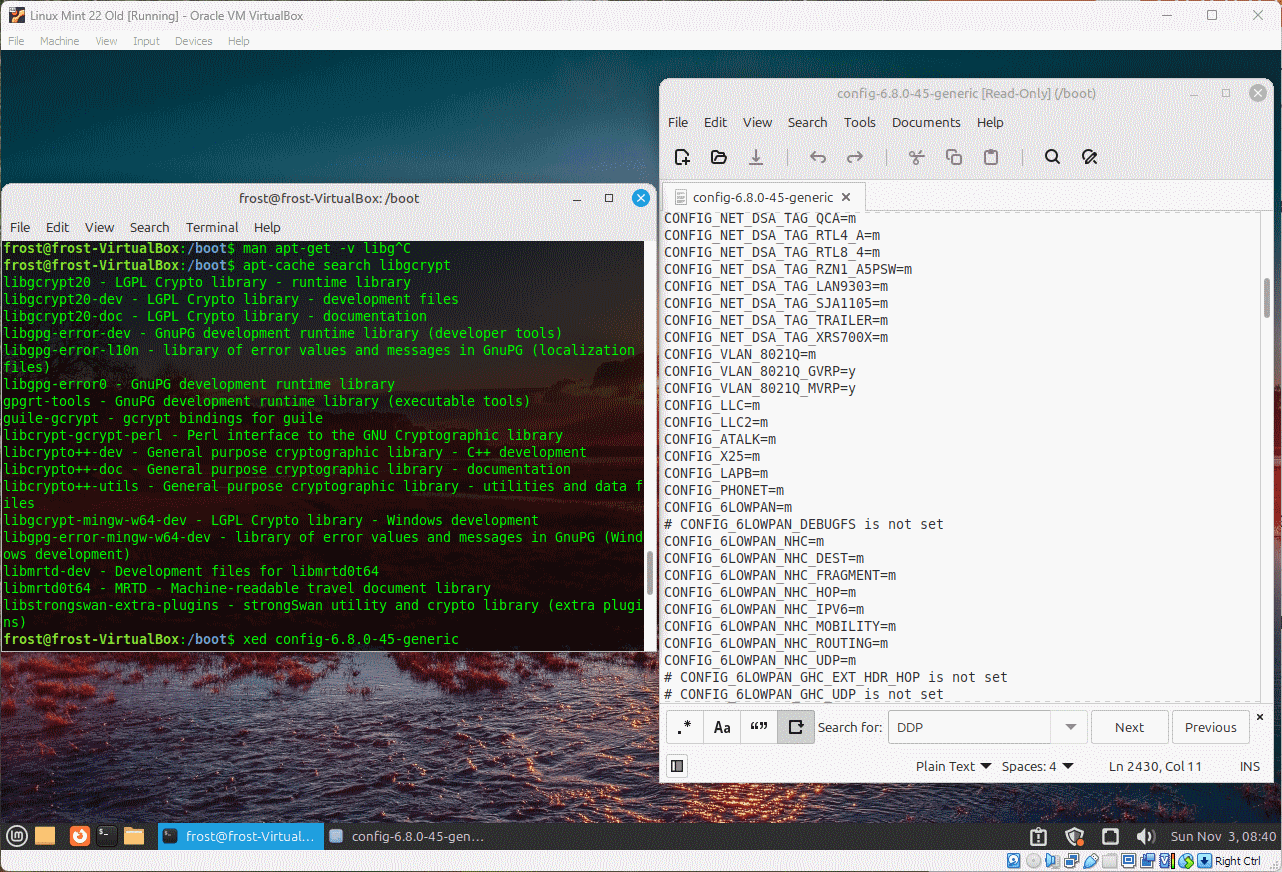

I get excited waiting for your responses every time rdmark and can't wait to hammer things out.
Linux Mint is Debian yes. It uses Ubuntu repositories for software updates, if you type $ sudo apt-get update it sources from Ubuntu updates, right now Noble. Kernel version reported by uname -a is ...
Code:
Linux frost-VirtualBox 6.8.0-45-generic #45-Ubuntu SMP PREEMPT_DYNAMIC Fri Aug 30 12:02:04 UTC 2024 x86_64 x86_64 x86_64 GNU/Linux
Anyways. libgcrypt doesn't even show up in the cache, and if you type $ sudo apt-get install libgcrypt and then spam the TAB key to try to list what it shows, it only shows libgcrypt20, libgcrypt20-dev, libgcrypt-doc, and libgcrypt-mingw-w64-dev. I don't know. This is one repository, there's of course others.

And now for macipgw. It is too new to have IPDDP, the first image above shows that it's not included. Is there anywhere I can get a NAT configuration script kind of like what @NJRoadfan has? I think his script is fine, but it doesn't work properly. I'm going to re-do a Netatalk installation onto a fresh VM instance after this. Also can we have macipgw create its own debug log that just prints to /var/log/macipgw ? It's buggy and troublesome enough that if you use a script like NJRoadfan's then it doesn't print to the terminal and show what's going on anyways.
Code:
Alrightie then, let's change to the canonical libgcrypt20 for Debian/Ubuntu across the board. A fix will be in the next release.
I included the config file for the build system. That's a big config file. I'm assuming that when it says CONFIG_ATALK=m that means that AppleTalk is a module (obviously loaded with Netatalk) and if it said =n that you'd have to recompile the kernel? There's a number of places that say if it's not compiled with AppleTalk support, you need to recompile it, but not how to check.
The AppleTalk README has some suggestions how to check for appletalk support.

More updates. Newly compiled 4.0.4 under Mint 22 once again.
No issues with the netatalk file server feature. I compiled for Webmin and got it all set up first, then built & compiled Netatalk. Seems like the Webmin module is still in beta status though:
First image is after doing something simple, like changing the log file location. Simply errors out after saving.
Second image is today. Can't log in to it.
Build string:
Code:
meson setup build -Dbuildtype=release -Dwith-appletalk=true -Dwith-dbus-sysconf-path=/usr/share/dbus-1/system.d -Dwith-init-hooks=false -Dwith-init-style=debian-sysv,systemd -Dwith-pkgconfdir-path=/etc/netatalk -Dwith-tests=true -Dwith-testsuite=true -Dwith-unicode-data-path="/home/flake/Downloads/netatalk-4.0.4/ -Dwith-webmin=true
Dependencies:
Code:
sudo apt-get install libavahi-client-dev libdb-dev libevent-dev libgcrypt20-dev meson xsltproc docbook-xsl
I'm getting nowhere with macipgw. Using a script file, it tells me invalid IP address. It works from the command line though. nftables is ranking high up on my list of software not to like very quickly. Using the command line, I get an error on almost every single entry, usually a bash syntax error for something. Even this example right off the man page doesn't work:
Code:
flake@flake-VirtualBox:~$ sudo add chain inet mytable myin { type filter hook input priority filter; }
bash: syntax error near unexpected token `}'
/CODE]
I will keep trying, but this isn't really very interesting. The computer is using me more than I'm using it. Suppose I need to make a text file for the whole ruleset and diagnose it line by line according to the errors i get.
