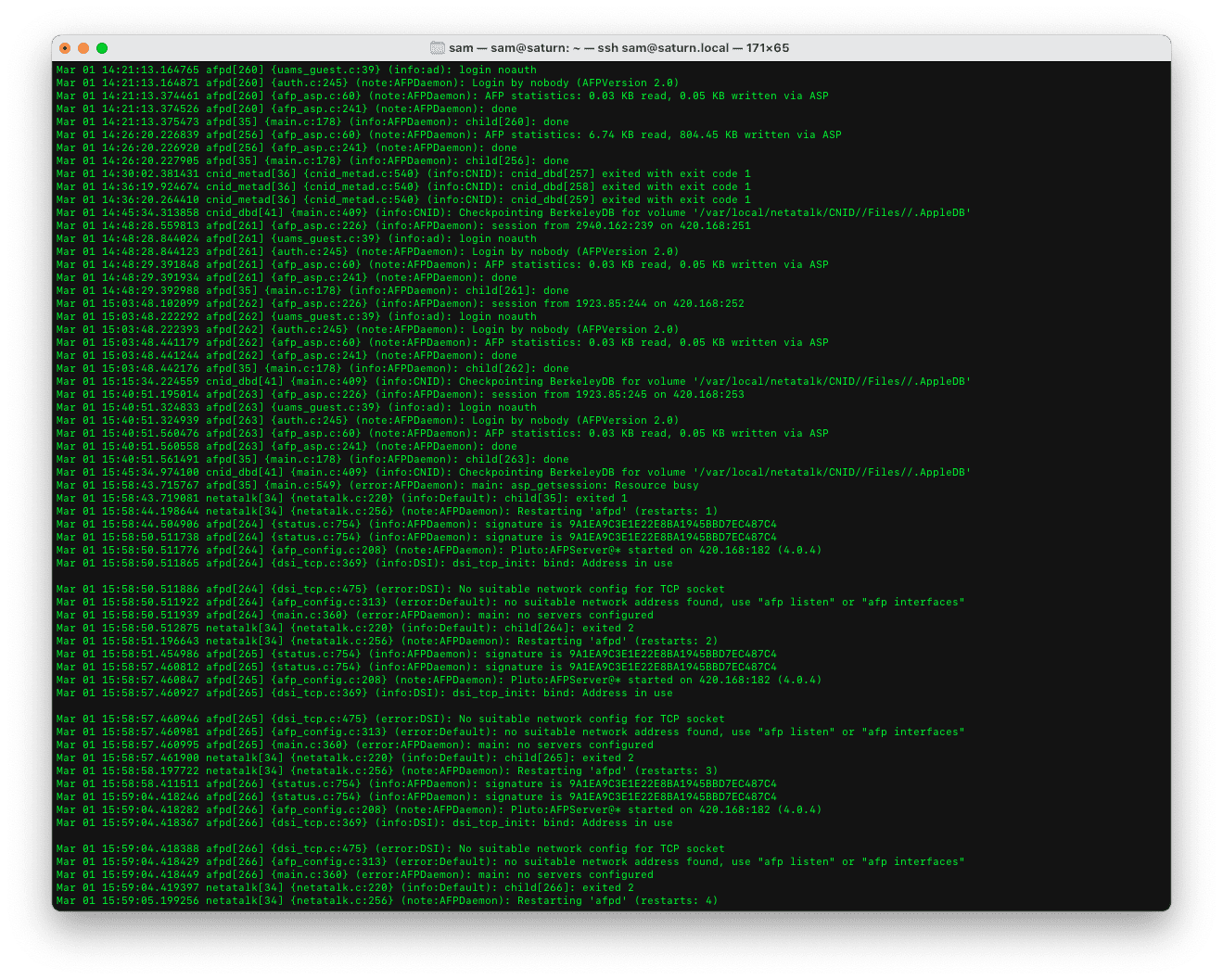

I've been using Netatalk 4.0.x Docker container successfully for quite a while and ran into my first real issue with it today. For some reason, afpd got into a crash loop:
Interestingly, an existing AFP connection I had up to it from another machine never disconnected. Did Netatalk accidentally spawn multiple instances? I've since updated to 4.1.2 and the container came up again just fine. I didn't notice any item in the change logs that relates to whatever I ran into, but hopefully this log is helpful.
Interesting. The error here is that netatalk wasn't able to detect a usable network interface for DSI (AFP over TCP). Was networking functioning at all in the container in that state? For instance, exec into a shell in the container and try pinging other server etc. This might be something worth trying the next time you experience this.
