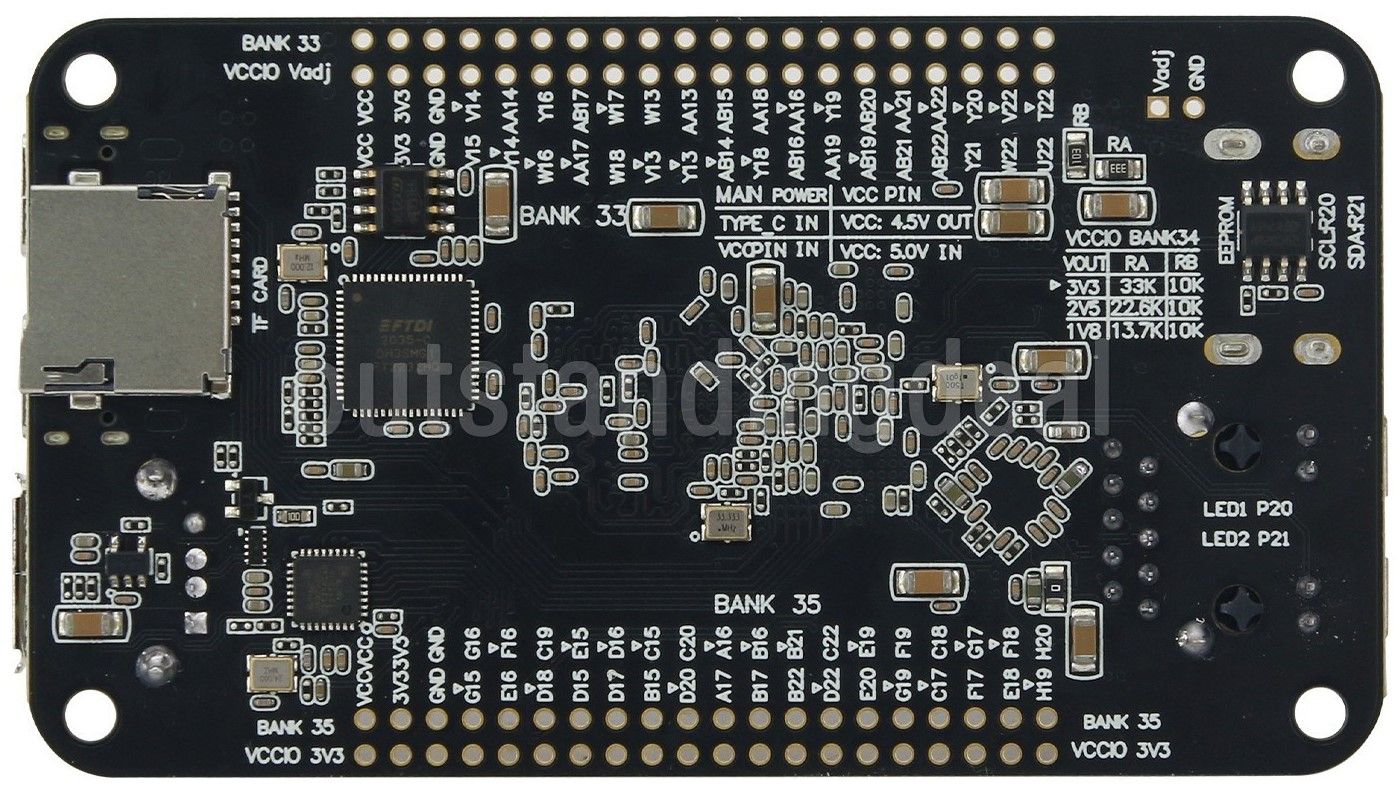

We know from the video that RGB2HDMI can handle the pixel clock. Only the rotation transform is missing and not sure even Pi5 can pull that off. Some inexpensive FPGA Dev Boards cost less than Pi5 anyway and they too have HDMI out.

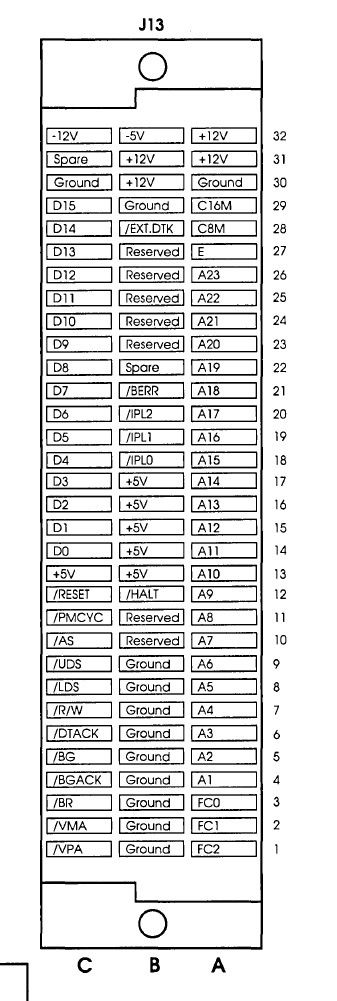

  • FPD-Schematic-007.PDF
  • SE-PDS-to-MagicBus.PDF
  • FPD-Schematic-007B.PDF
  • SE-PDS-2-MagicBus-Worksheet.PDF

1,518
489
Just gave up on buzzing connections on my much corroded MagicBus card. Can't locate the good one. So will be setting up the copy stand, taking pics of MagicBus and working from there in Illustrator just as I'm doing with FPD. I can then verify the layout by buzzing my Radius16 Accelerator. Do not want to be handling that one very much at all.
