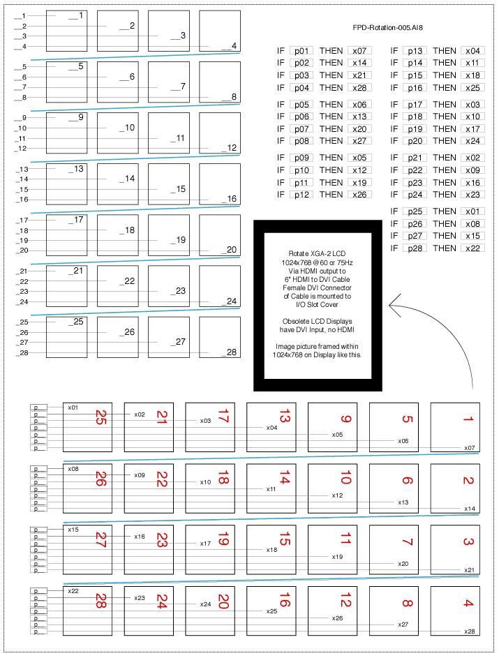

The image scans as I've illustrated it.
from start, scans across 640 pixels, doubles back, drops one row . . . repeats 800+ times.

No, I've been saying all along that the card performs no rotation at all. It builds a standard horizontal scan 640x864 image that needs to be rotated to be useful on the target displays.
At present, there are no solutions for rotating the image outside of very high end systems. cloning with built-in rotation is the only option.

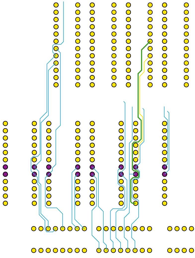

Currently buzzing the board for schematic capture as I'm wire wrapping a prototype. That'll need to be done eventually for cloning the card. At this point I'm hoping output from the four GALs would be the place to do screen capture. I'm concentrating on VRAM to GAL connections. If all I need is output from four GALs aligned with VRAM, so much the better. I could move the carrier board topside and plug it into the GAL sockets, moving them onto the carrier.
So far so good. View is solder side, need to square up ground pins.Note the curious ground line connection (Green) between VRAM and GAL. Best WAG for that would be grounding the sense line on the video connector, testing monitor connected case? Dunno . . . it's a mystery.
edit: No mystery there hadn't mirrored the pinout. The green trace is from pin 1, not ground. OOPSIE. :oops:
