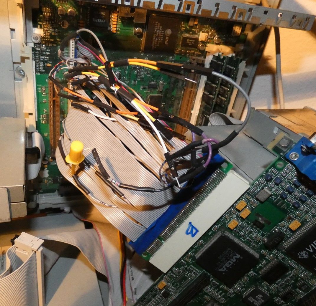

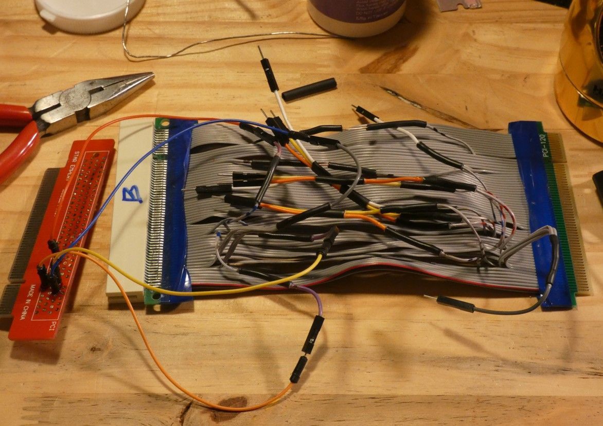

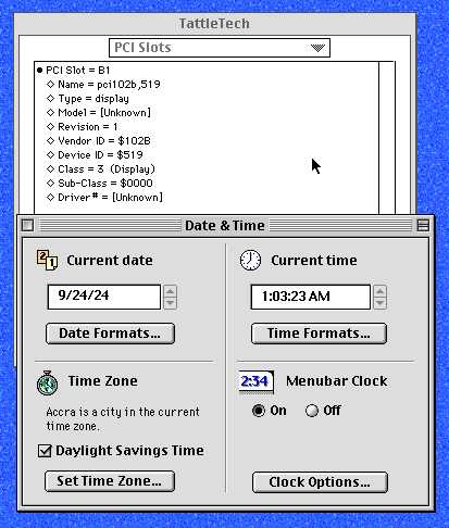

Yep, no capicitors involved, just the resistor. Using jumper wires attached to all the requisite points I got:
Slot A = A1
Slot B = B1

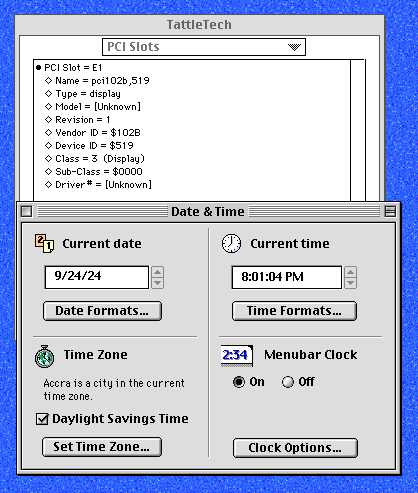

Slot C = D1
Slot E = E1 - with signals jumpered from CSII Slot. This one's tangential, but I'll do a dedicated post here with the info/pic.
TattleTech PCI Slot report screenshots in link:

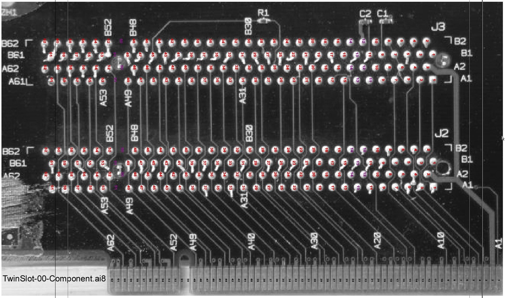

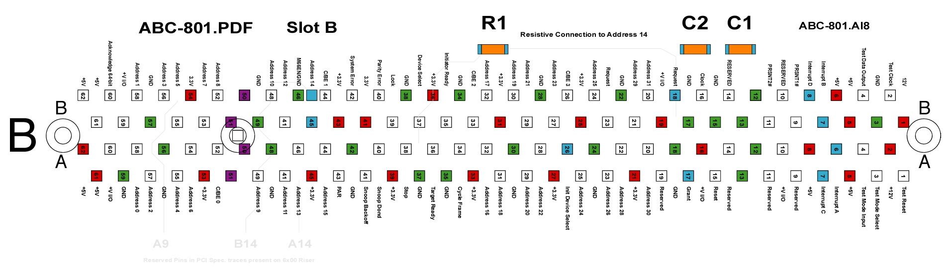

None of the pins on the earlier diagrams are correct. I'm in the process of
- mirroring the connector so it looks like the component side.
- rotating the pin numbers
- rotating the signals so they match the proper pins - recreating baseline PCI pinout
- color coding the thruholes
Purple indicates the pins missing due to the break in the connector, they're all wrong . . . they belong at the high numbered end of things.
- Green = GND
- Red = Power of various values
IOW, hold off on schematic development until I get everything looking like the component side, numbers and signals tagged and color coded correctly.
So it goes . . .

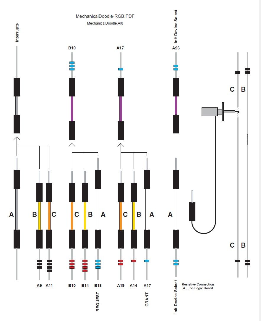

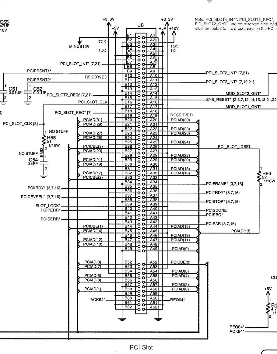

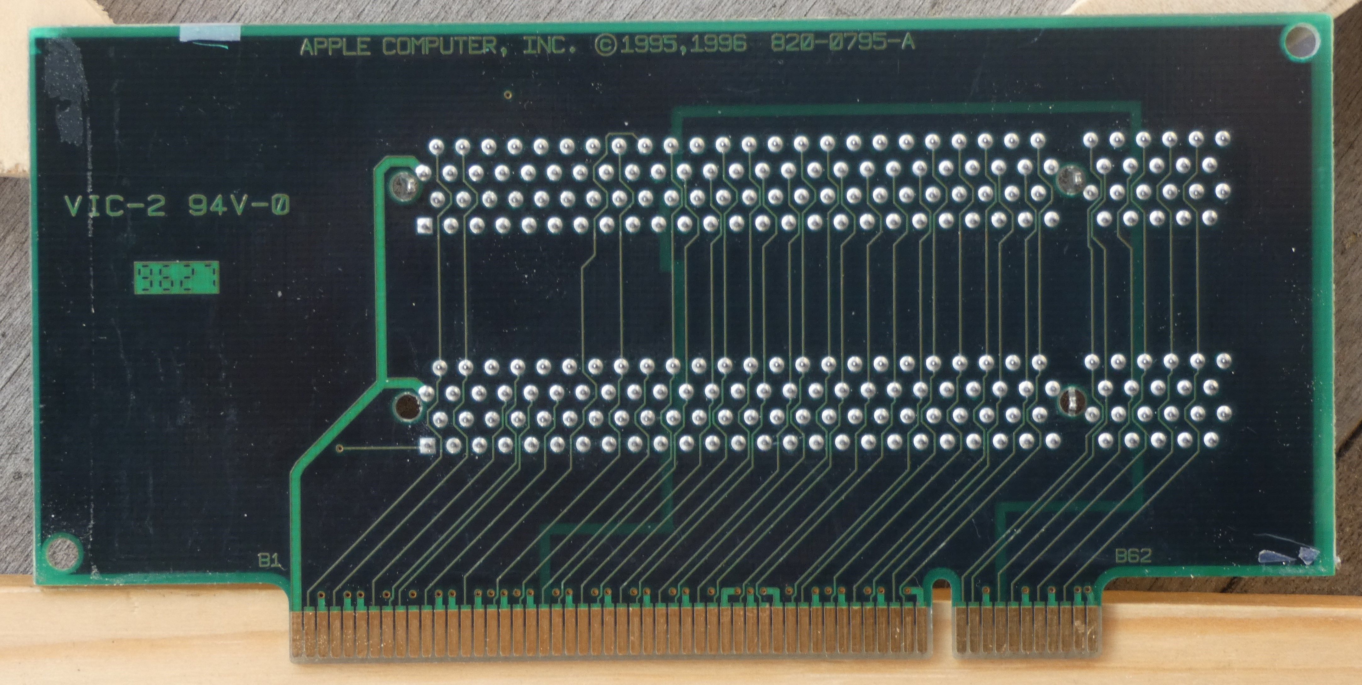

Woke up with my head as straight as it gets. Walk didn't do the reset trick. Did the illustration above without realizing that you'd probably have had all the info in thread already that you need for schematic development?
Mechanical doodle has pinouts for most everything that isn't 1:1 from SLOT_A to SLOT_B, but for capacitor setup.

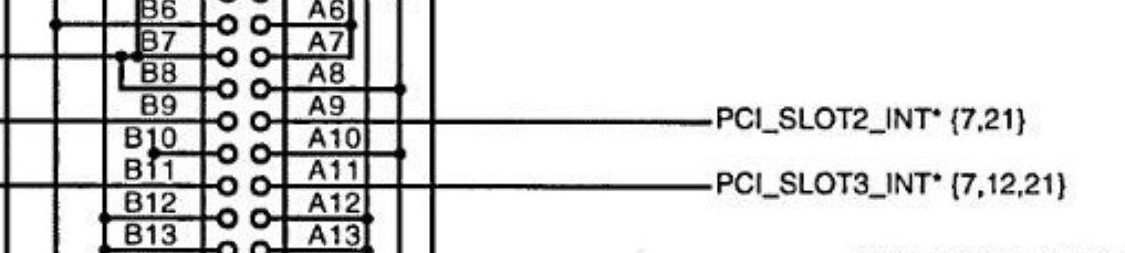

Assumption that all four interrupt lines are tied together appears to be in error.*****

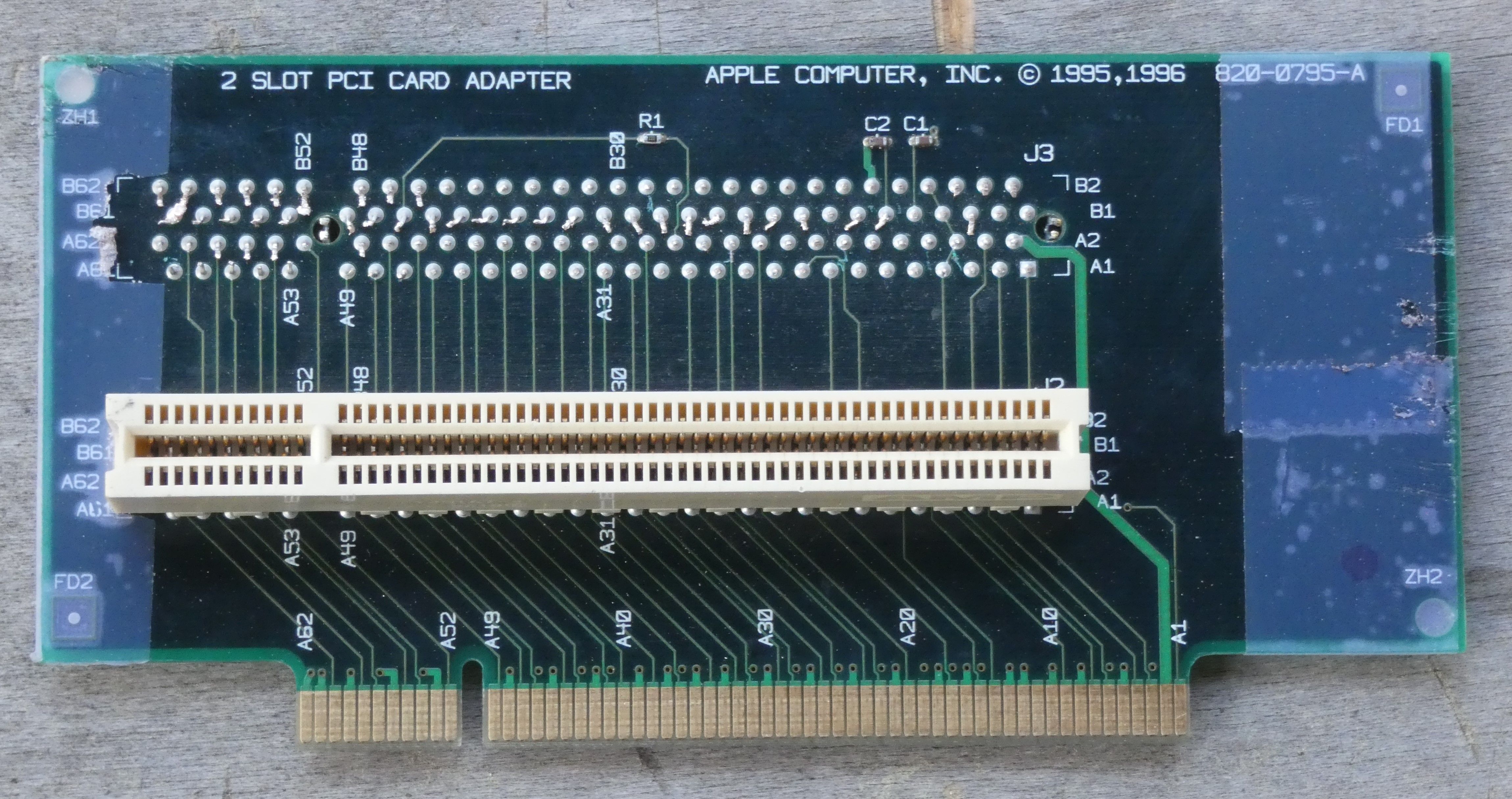

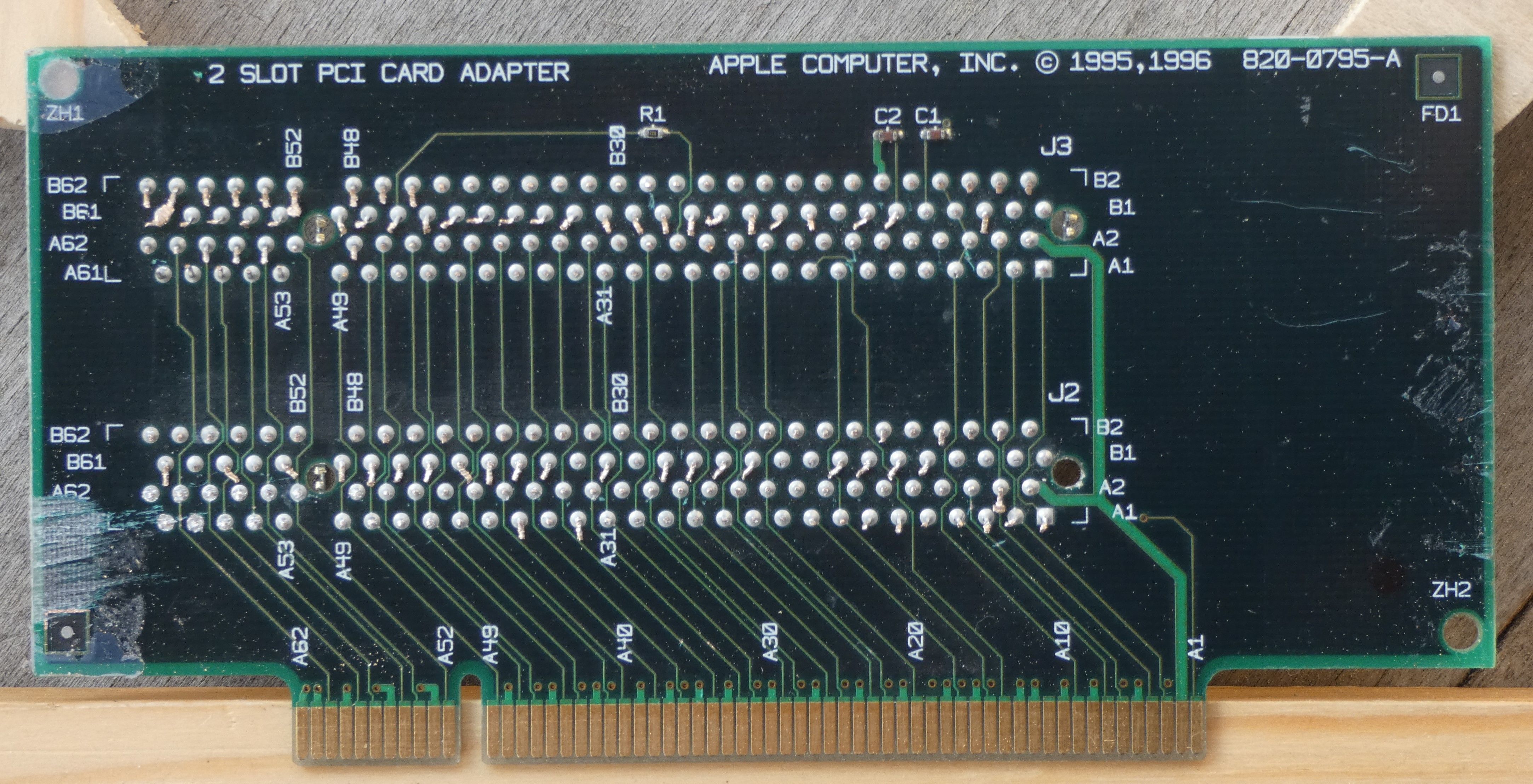

Hacksaw desoldering method revealed connections for capacitor setup you identified above:
Capacitor values you've identified in the schematic:
". . . the two caps C1 and C2 are connected to these pins PRSNT1# and PRSNT2#. So not decoupling."
***** Note that PCI_SLOT_2_INT and PCI_Slot3_2_INT pinouts differ in schematic. My questionable assumption that all four are tied together was in error.
However having all four tied together appeared to work fine in my jumper cable test lashup.
Looks to me like a binary interrupt decoding setup indicated in schematic?
I got confirmation of SLOT_ID in TattleTech PCI Slots report, but function testing wasn't done at that point.
Wondering if same holds true up in Slots B? IIRC all four interrupt lines buzzed out as connected on riser. Gotta check that out again.
Is pretty much everything you need for schematic development in this post?

Picture of hacksawed riser shows trace on slot B connecting all interrupt lines together. So I'm not sure why you'd think you've erred?
I would like to start with schematics of a known-good riser. Even if your cable kludge worked, I'd rather do things by the book.
If you need me to you may send me a known-good riser to reverse schematics from. Preferably with no PCI slots attached. Am based from Washington, D.C.

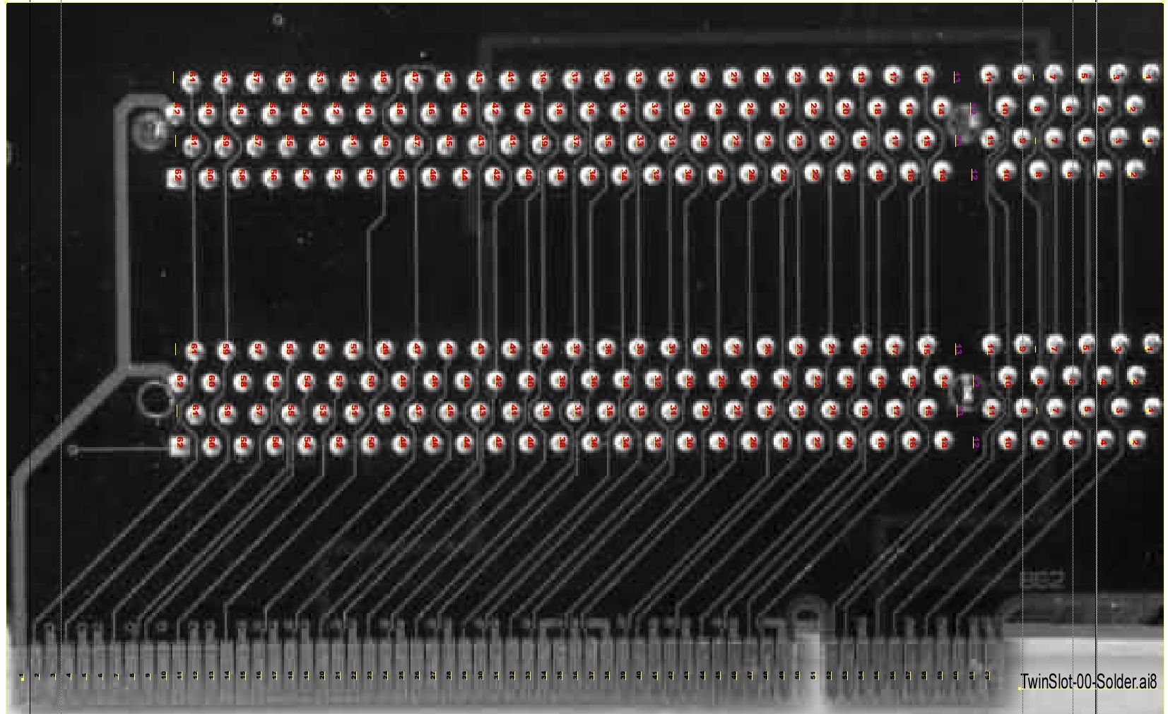

Pretty sure you don't need these .PDFs do your schematic, but rough as they are, following the traces across the page works for me!
They're vertical here, but the .PDF files are in portrait mode with traces going left to right from edgecard contacts
Now with the connectors off, it's all put together betwixt my ears. :D
Apparently it was too late to get the files together correctly, I'll edit in the correct pics and .PDFs in the AM.
