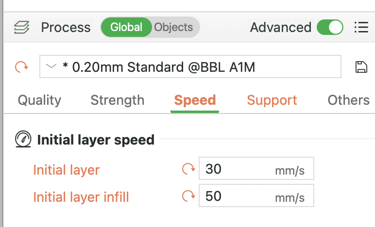

Does anyone have good settings for the Retro Platinum PLA on a BambuLab P1S? Mine does not adhere to the bed (or even well to itself) when I use the Bambu PLA settings.

I had some similar trouble with the Polar Retro Platinum PLA on my BambuLab A1 mini. I've been successful in my last few prints using the "Generic PLA" profile and slowing down the initial layer print speeds by ~half.

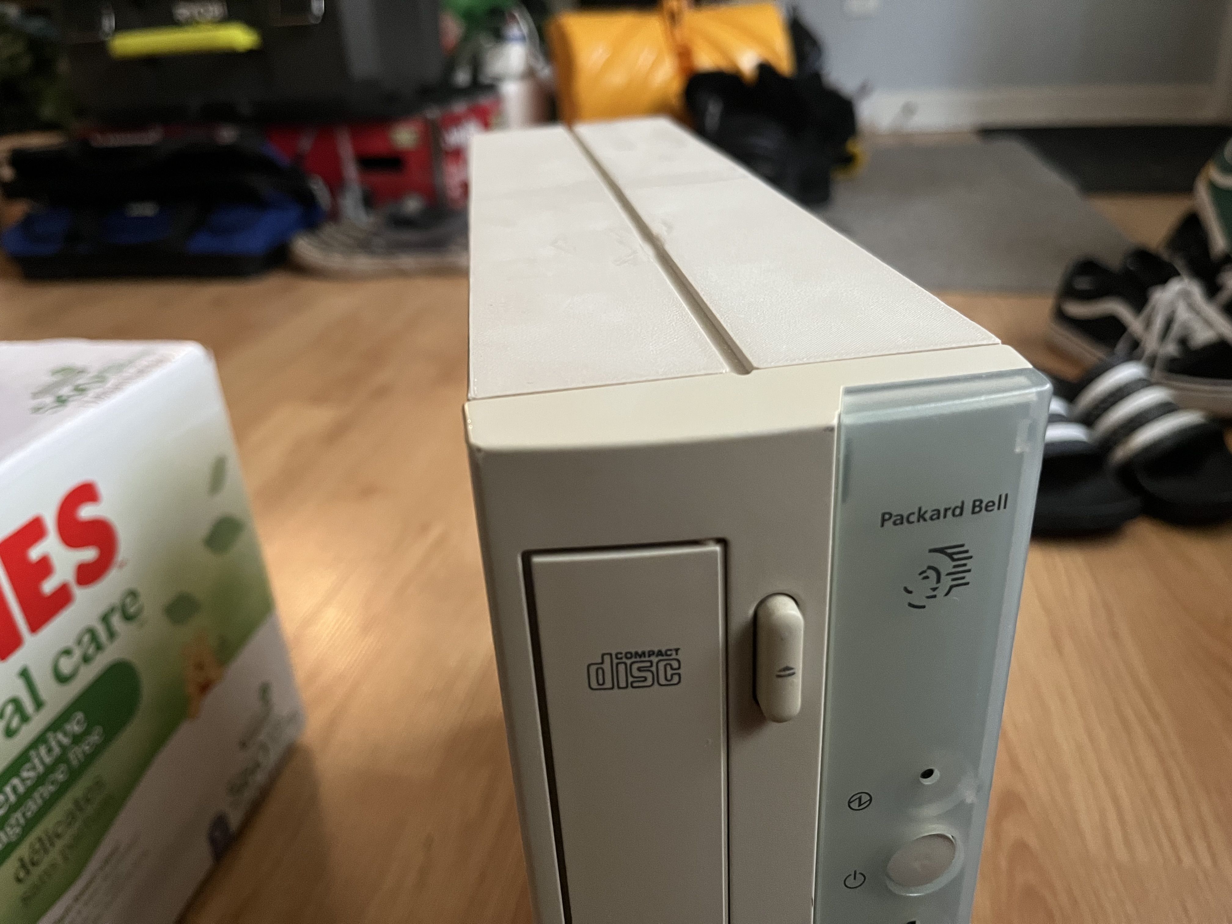

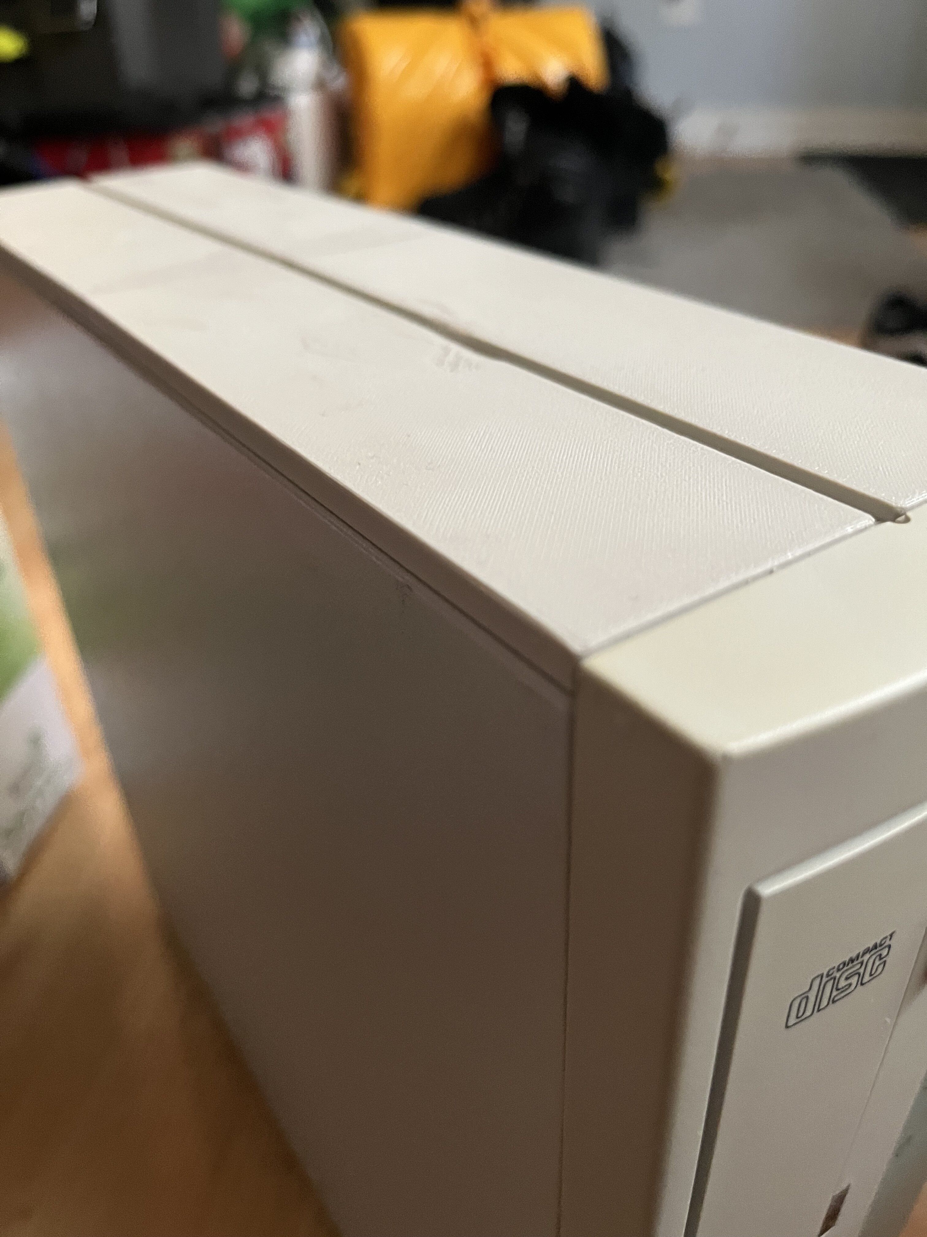

Just got some Retro Platinum PLA, and it was an excellent match to the Packard Bell Aloh@ (Aloha) as well!
I was missing the top/side panel ever since I got the machine, and as far as I can tell I've got the only one of these on the internet, so no way I was going to find a replacement... unless I go to Japan and find an NEC version of the case.

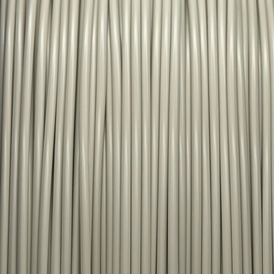

@jcm-1 On the Polar website looking to buy another Retro Platinum spool and noticed a new one to me:
Power Gray "Special thanks to Joe's Computer Museum for designing and funding this color, and choosing to release it to the public." ​
Is this really new or did I miss this being out there! Is this a match for PowerBook 100 series plastic? Kinda looks like it might be 5300 series? In any case super excited to hear more about this! Thanks!

This is the grey for Power Book 500 series machines. They have a sample to do the more popular 100 series and should be getting to that soon.

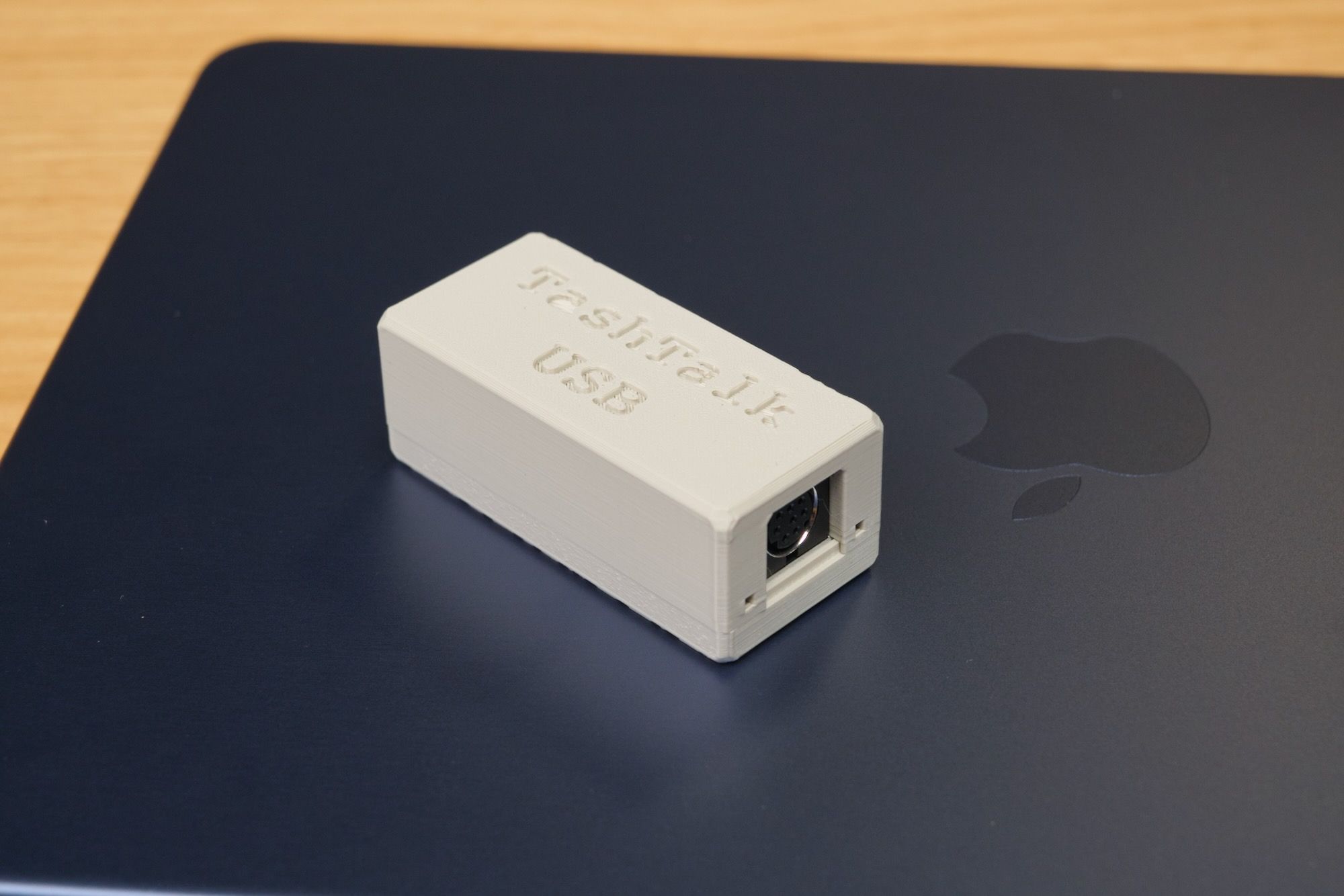

Just printed my first object with this filament — it seems to be a tad bit more oozy than others (at same humidity level), and it also popped off my textured build sheet on my first attempt (yay spaghetti!).
But it's all good now, and looks like a pretty close match to the Mac IIcx case I have sitting on my table.
Neat stuff!

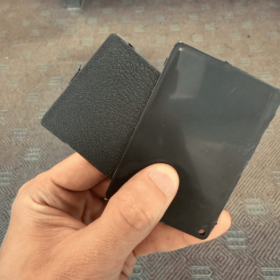

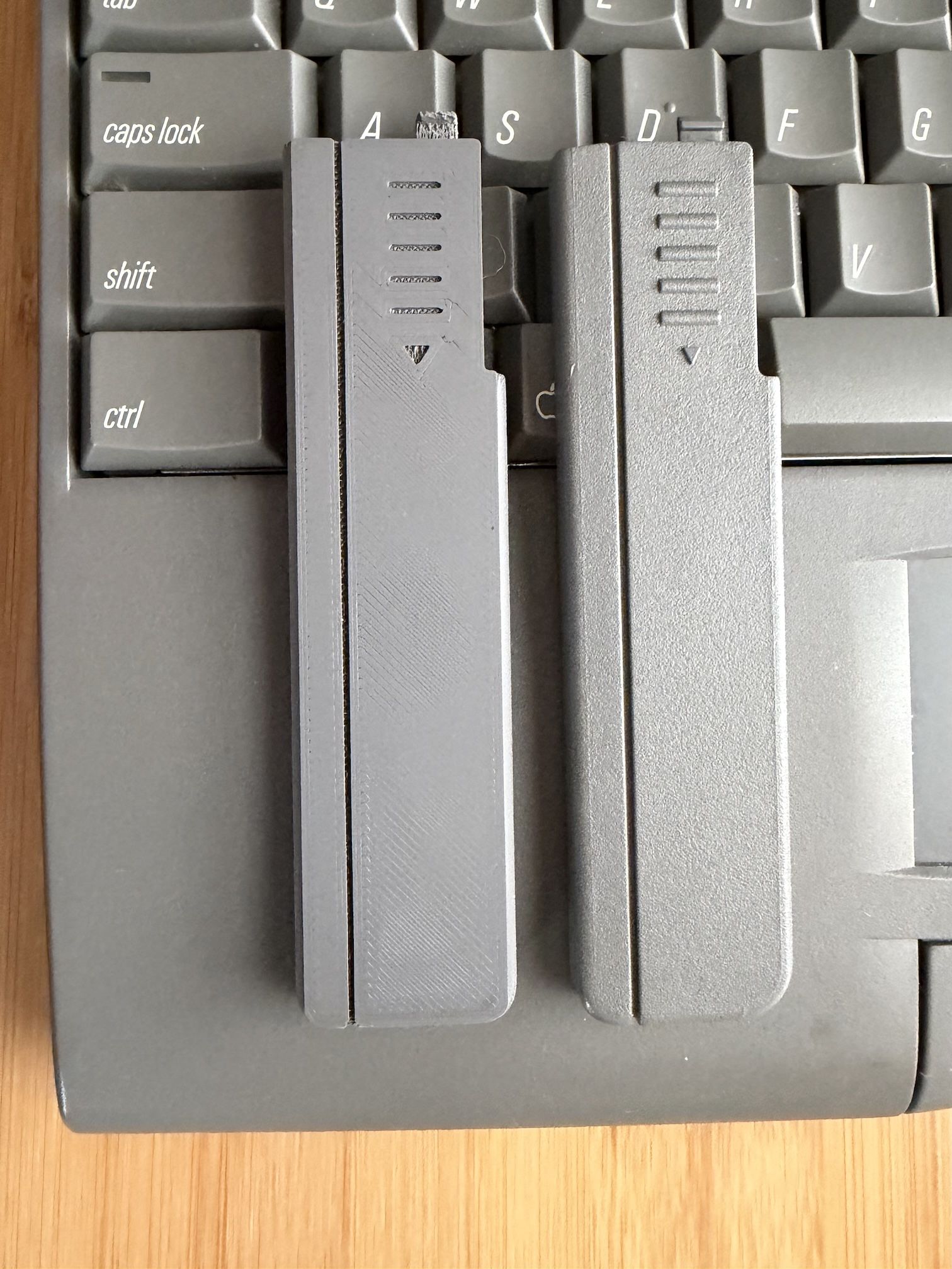

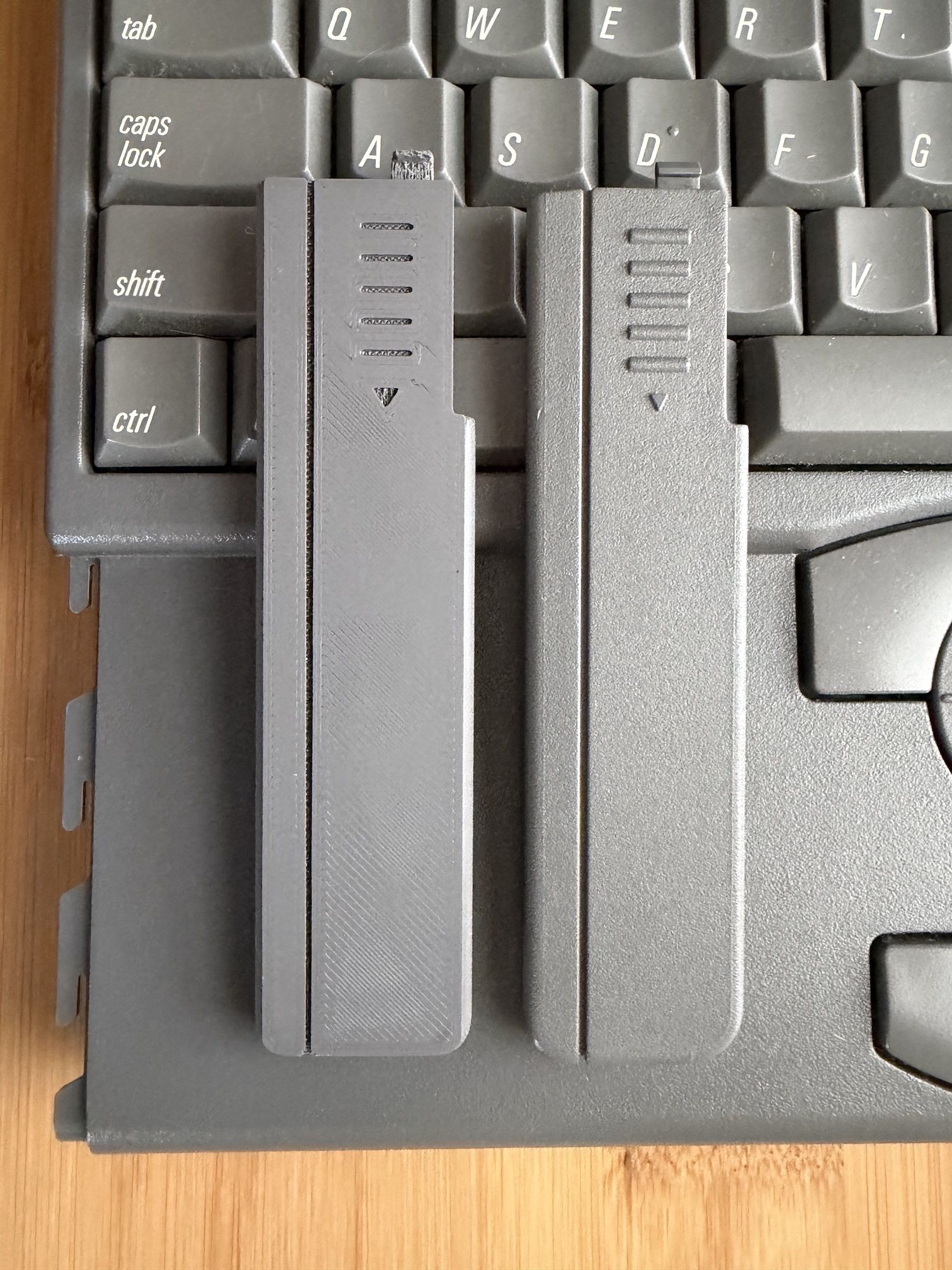

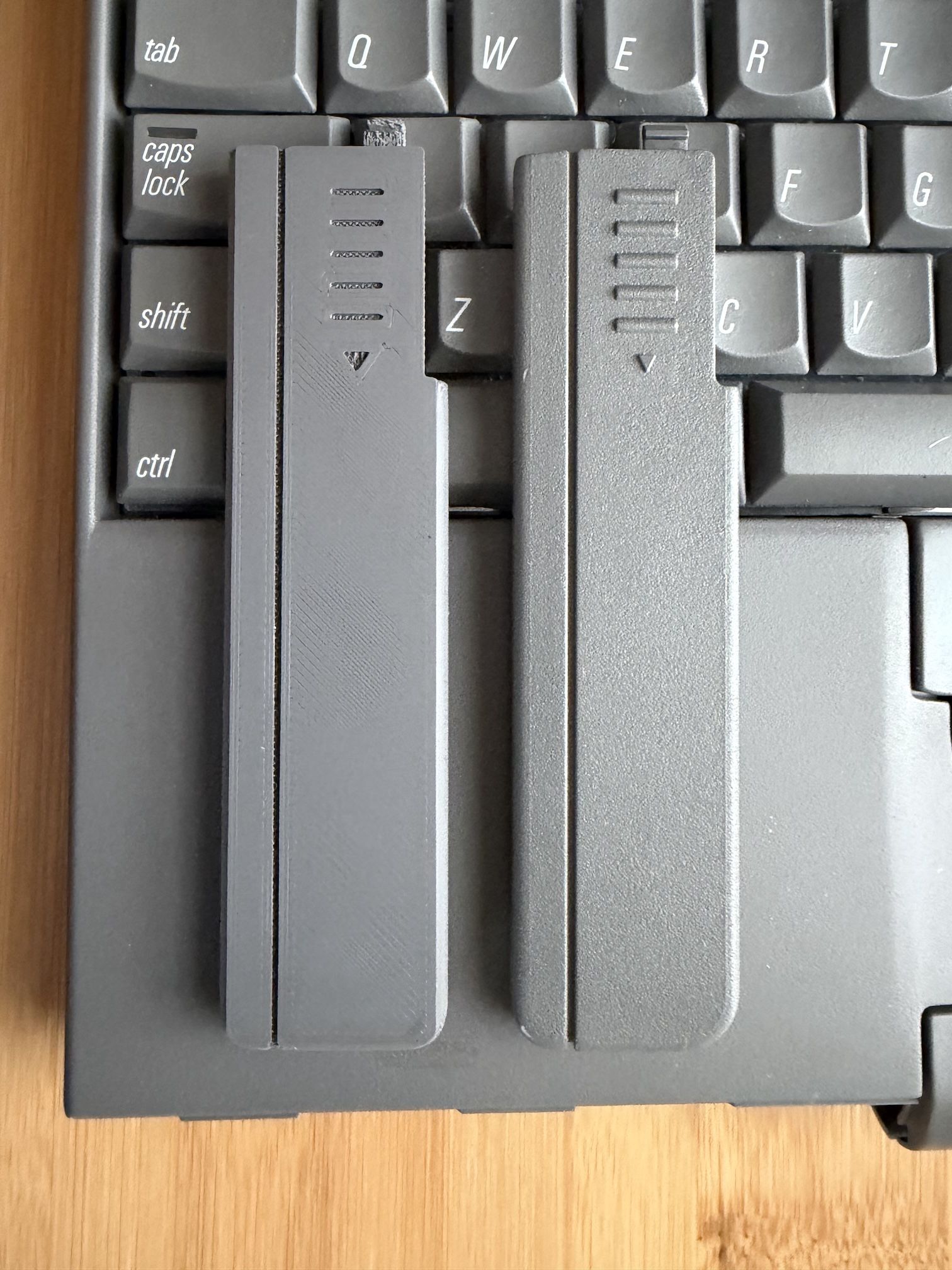

Got some Polar Power Gray 100 PLA filament (All hail @jcm-1 !), printed a PB 1xx battery door, here's how it looks next to an original door on top of a PowerBook 165c, PowerBook Duo 230, and PowerBook 540c keyboard:
While pretty good, my PowerBooks and original PB 1xx battery door are likely not without some "yellowing", all in all I think it's a great match for all three!
I also got some Polar Power Gray 500 PLA filament which I thought would be the darker gray components on the PowerBook 500 series machines but upon looking at the spool I think it actually might be the PowerBook 5300/1400/2400/3400 series color? Printing now...

NICE!
Let me know how the PowerGrey 500 turns out!
