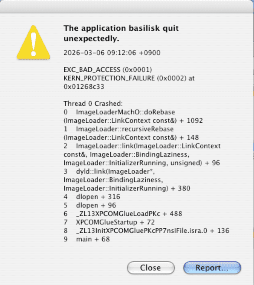

I just downloaded the new v3.1 under OS 10.4.11 on my G4 Cube (with 1.7GHz Sonnet CPU). Disk image mounted fine. But the MacFox v3.1 app launched and crashed right away...
Again, I don't know how to convey this info to the developer, but if anyone here does, please pass the word along. Thanks.

How much video memory do you have in the system? ISTR that Action Retro tried the 10.5 build on a G4 and had to upgrade his graphics card or he'd get a similar startup crash. (I'm not sure how he determined that was the problem, but it worked after he did.)

Just FYI, I fixed this several weeks ago - it seems like he was using my initial build.
The problem was related to these GPUs not supporting FBOs which caused the basic compositor to freak out.

The G4 Cube I am testing on has the stock ATI Radeon Rage 128 Pro installed. So I guess 16MB of VRAM? The machine is at the office and I’m home for the weekend so I can’t check right now.

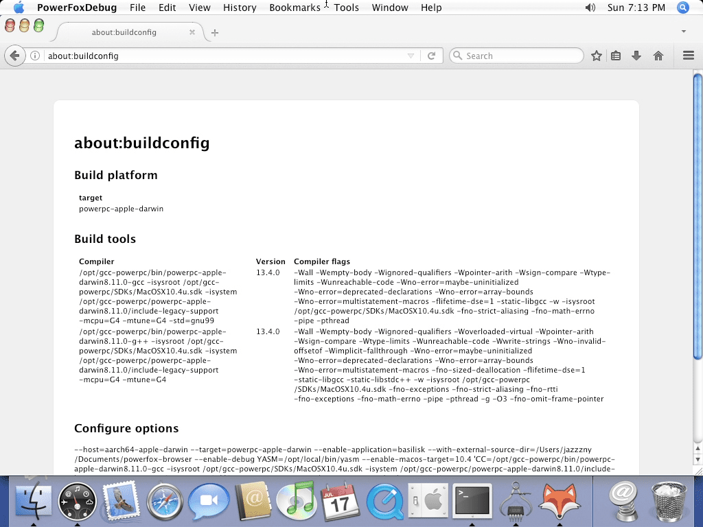

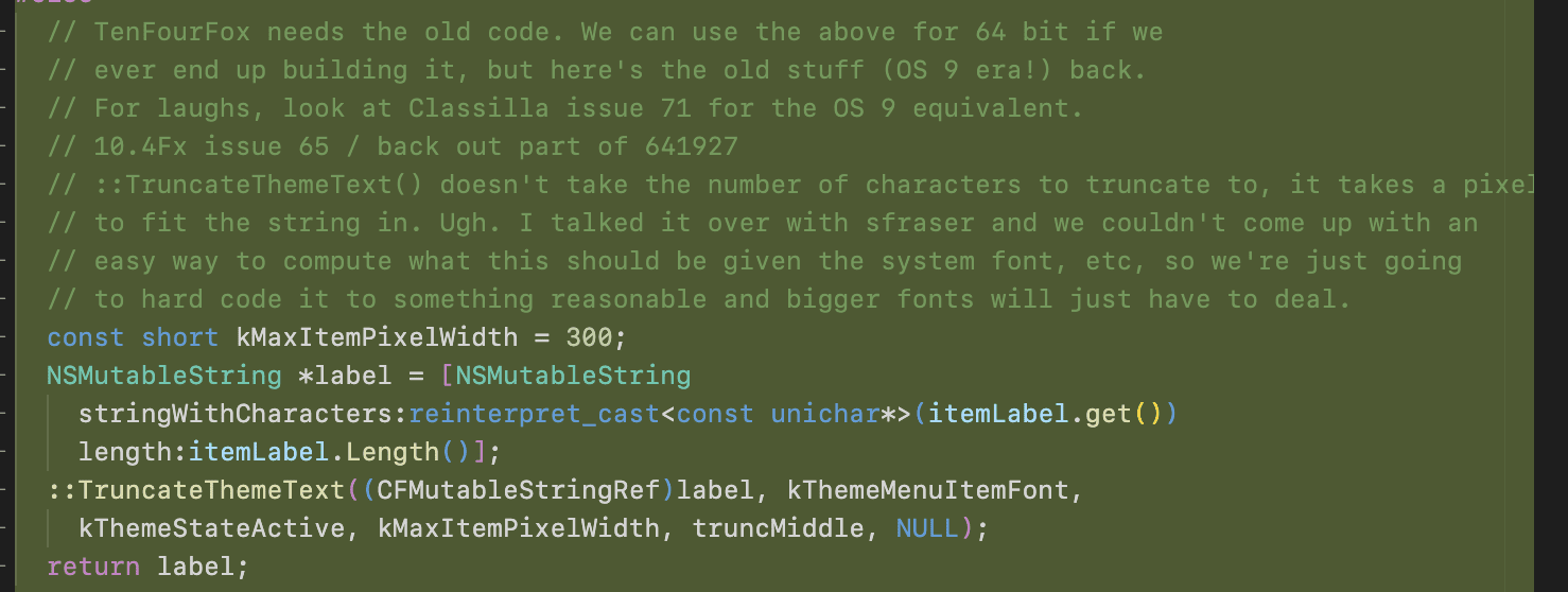

@ClassicHasClass I've ported down to 10.4 using your patches, all code written by hand.
Thanks again for TenFourFox and (especially keeping the if(0) defines)! Most of the patches I was able to copy-paste.

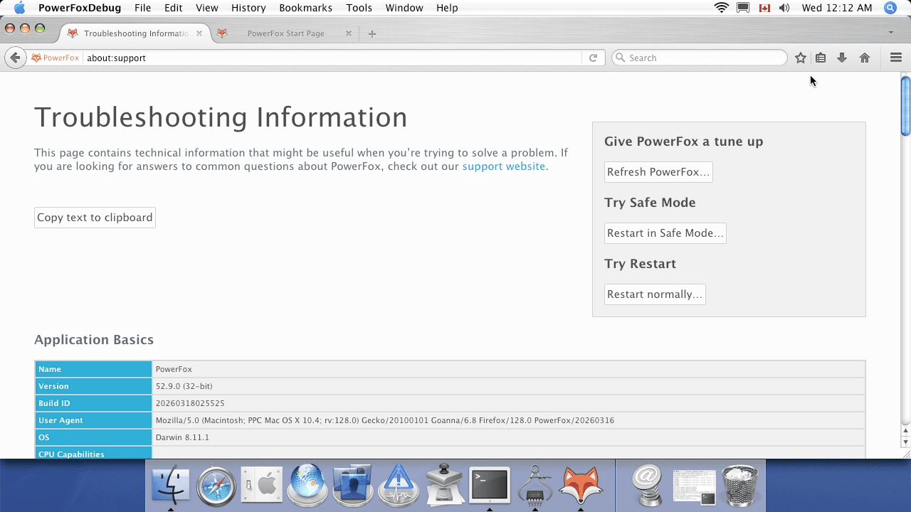

Yes, I'll try to get something out soon.
Still a few blockers that I need to deal with though, mainly DrawTargetCG doesn't seem to like like certain draw requests for whatever reason, even pages like about:support cause it to fault in SVG code.

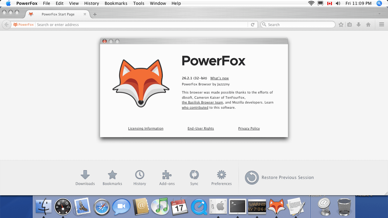

I confirmed just now that the 7450/7447 build of 26.2.2 works on a G4 Cube with Sonnet 1.7GHz 7447A running OS X Tiger 10.4.11. Great!
But the main problem I have is that if you use the Start Page and type Wikipedia into the Search field and hit return, you are given an "unusual traffic" error page with reCAPTCHA, and after clicking the "I'm not a robot" checkbox, the spinning wheel spins forever. Tried searching for Macintosh Garden and the result was the same.
I am able to access websites ONLY if I know their URL. These worked when I typed them into the address bar directly and hit return:
But search is blocked for me due to that reCAPCHA problem. And search is pretty important.
Performance is slower than other browsers like Safari that came with Tiger, but not unusually so, as it often is when trying to get a vintage browser to run on 68K Macs, for example.
