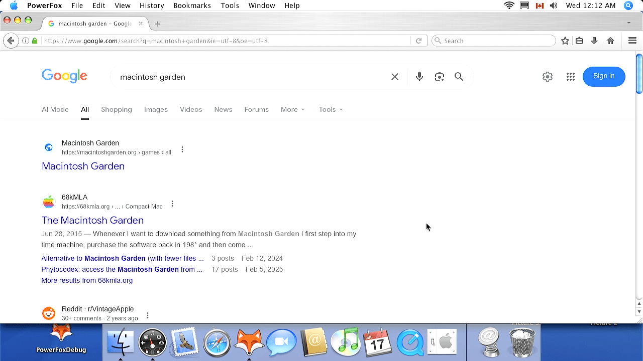

Great to hear that. And so... What is the technical reason I am not having the same great experience, being hit with reCAPCHA? Because I am located in Japan? As mention in my earlier post here, on the search results page, rather than see any search results, it tells me that there is "unusual traffic" from my computer and therefore it throws a reCAPCHA at me. Fine and well, but why doesn't the reCAPCHA work?
If you cannot answer these questions, maybe you could find a site that requires you to do a reCAPCHA and see you can successfully get past it? In other words, is there a bug in getting reCAPCHA to work?
Jazzzny
Feb 2, 2026
35
68
Unfortunately it looks like Google thinks the JavaScript engine is too slow to be legitimate, opening the browser console shows reCAPTCHA timing out. I have also been able to reproduce this in MachFox, so it seems like we will require a significantly optimized JavaScript JIT to have a chance at passing reCAPTCHA.

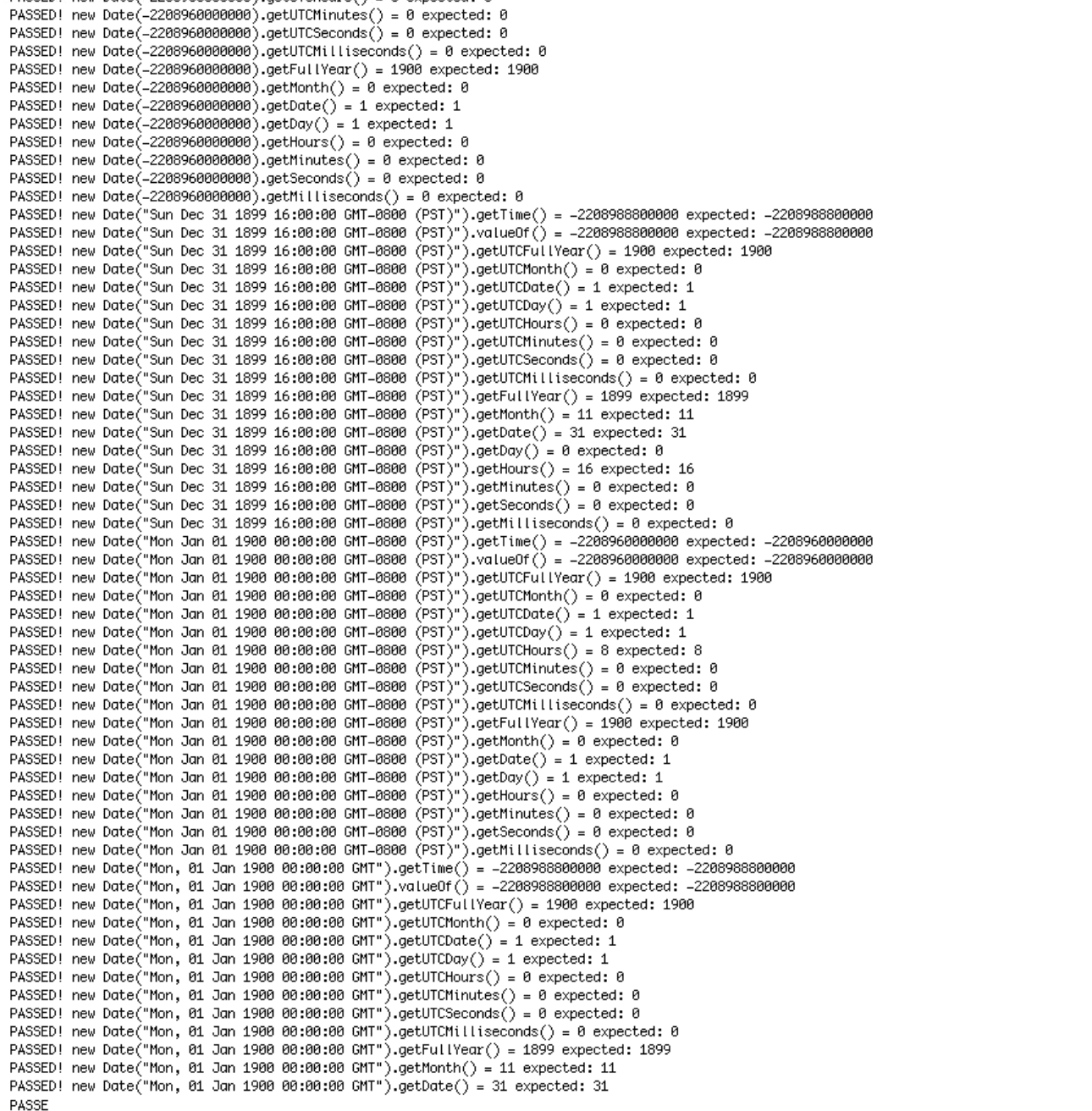

I have worked through all of the assertions, crashes, and conformance issues I could find, and I can now confirm that the browser is working correctly:

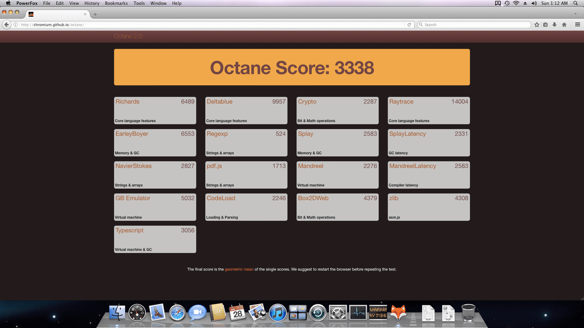

Still some room for optimization, but I really don't know how I would approach that. This is already around 21 times faster than JITless.
On another note, in a way, this is "TenFourFox 52" in spirit. Only 10 years in the making... :)
