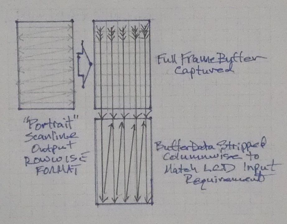

Seems like his initial approach to going from portrait to landscape mode for his LCD should work. He went with a different approach which worked out very nicely, reducing the size of his Pico-Mac-Nano. I'll have to take pics of my sketches illustrating the first iteration to post.
Capturing the full frame buffer and stripping the "Portrait Mode" pixels out of the buffer at right angles would yield a nicely rotated "Landscape Mode" input of the frame buffer to the LCD I'd think. Then Rotate LCD.
I'd like to build rotation hardware into the FPD card clones.

As you'll see below (hopefully) the scanline output orientation of Radius' FPD boards is unsuitable for using a standard LCD. I've found only exceedingly expensive solutions for the rotation of Hi Definition Video and the like. I figure rotating only 640x864 single bit pixels ought to be "easily" done. LOL!
Couldn't find the original, so cobbled this diagram together at work in downtime tonight. I think the presentation is a bit better, maybe?

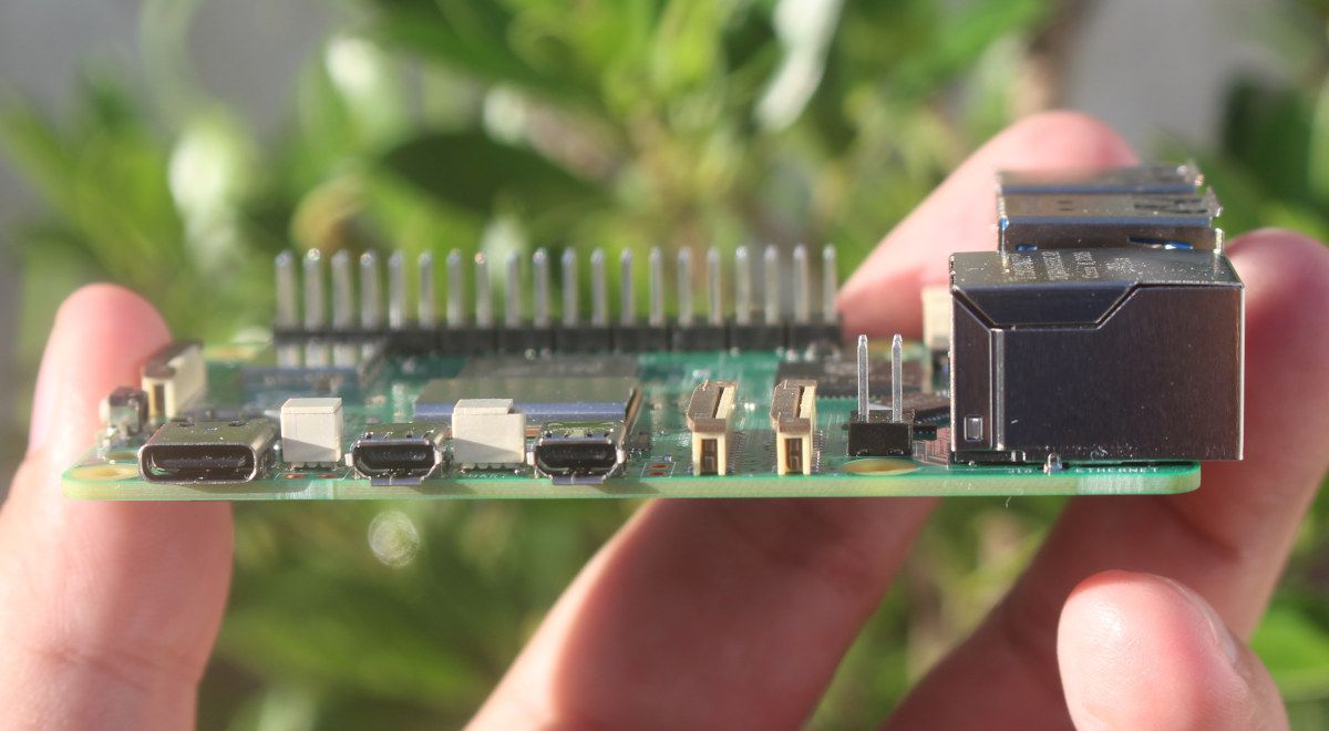

Thinking DVI-D input for "middle aged" displays sans HDMI, but the output of the card should best be Micro HDMI from SBC of some sort.
Micro HDMI end of HDMI Cable ought to be able to be fished through the security port of a Plus?

mini HDMI.

Need to get the captured Frame Buffer stripped off column-wise for rotation on board the FPD clone with an inexpensive SBC.

edit: I think it should be a lot easier to implement the frame capture/column stripping technique in my illustration above. RGBtoHDMI seems overly complex for a simple datasnatch rotation of a single bit image?

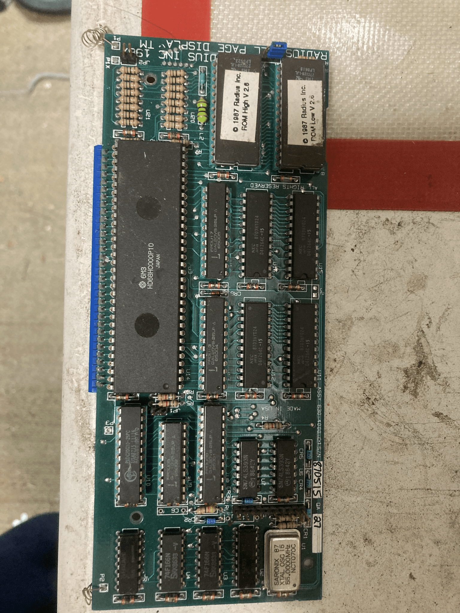

I have one of the Plus/512k cards with the 68000 CPU on it sitting around. I can try to take some photos of it if that would be useful.

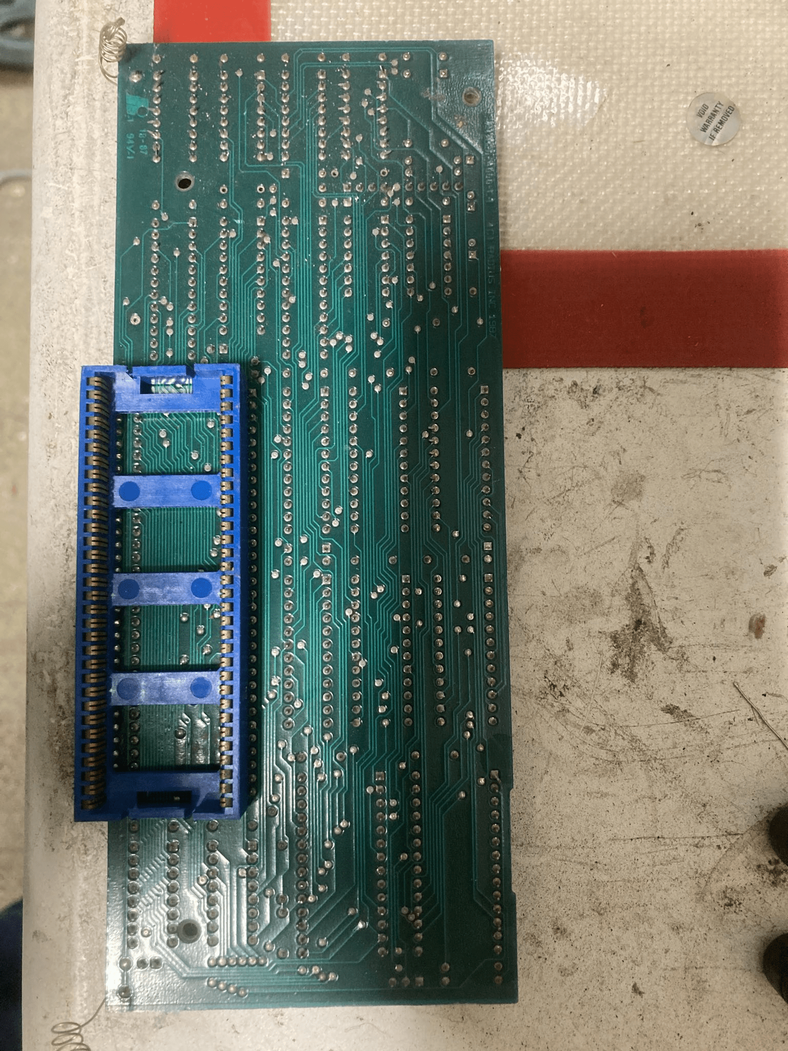

Not the best images, but what I could snag tonight quickly. I don't have the cable to connect to it, but I do have the display and it works with the nubus version of the card. I have been meaning to see if this card works and fix up a spare plus to try it out inside. I hear you have to do some logic board modifications and I don't want to mess with my prize Plus Platinum. Let me know if I can get any more details for you.

Very strange, that looks like the Killy Klip setup. If so it would clip onto the 68000 on the mobo? There were ceramic and plastic packaged CPUs, one of which was problematic for using a Killy Klip. I needed to solder header pins to the legs of the 68000 when I installed a NewLife board. Looks like this one might go either way as well, which makes me wonder why there's a 68000 on the card itself?
Thanks much for the pics! Pics of that connector from several angles to give me the chance to "see it in 3D" would be much appreciated.
edit: have you seen the installation directions or a list of the board modifications required? YouBoobTube video?
Very curious. Wondering if the 68000 on the board works in conjunction with the Plus' processor? I have a SCSI2 card with a 68000 controller on board on board. Plus was pre-DeclROM/Slot Manager setup. The presence of High/Low ROMs on the the FPD cards (only one on the SE/30 FPD) makes me curious.
