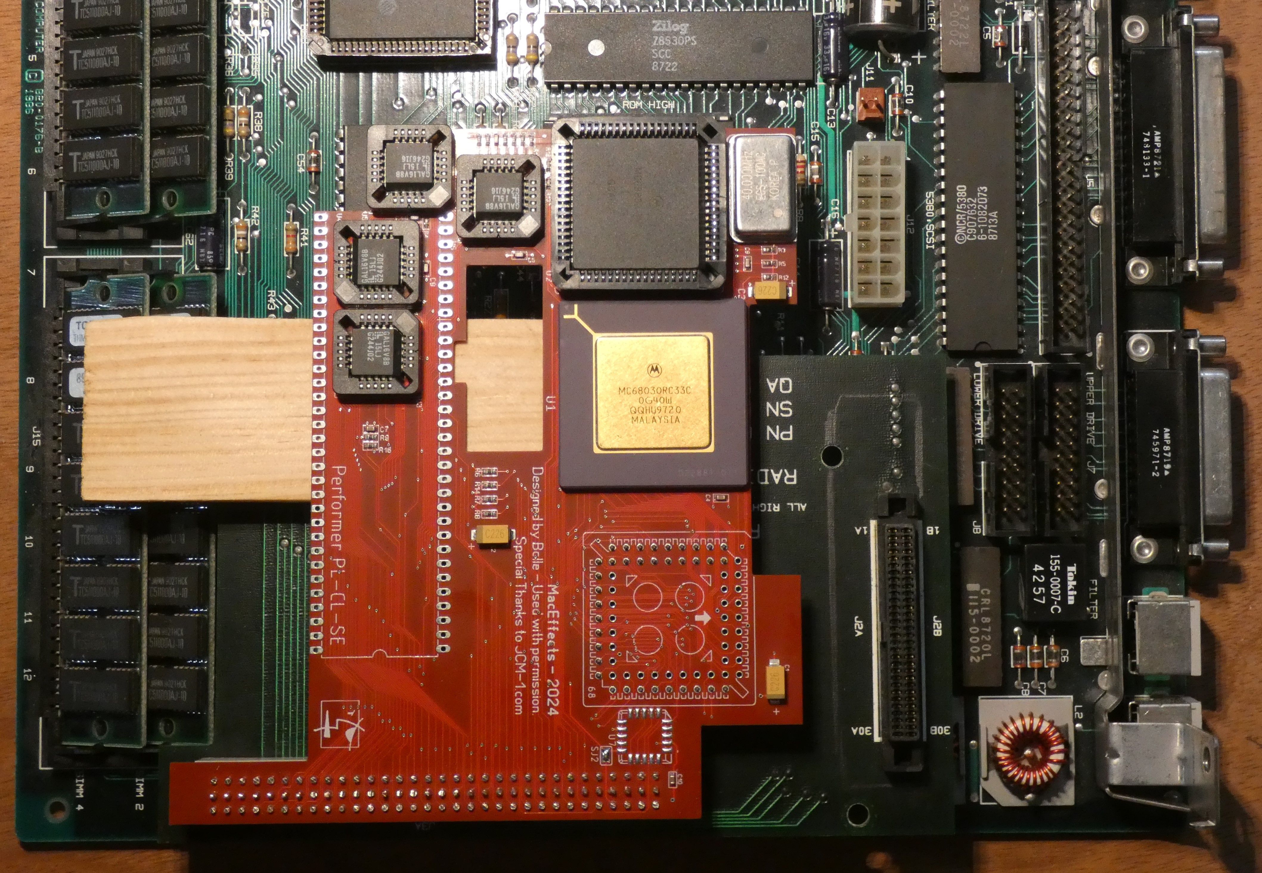

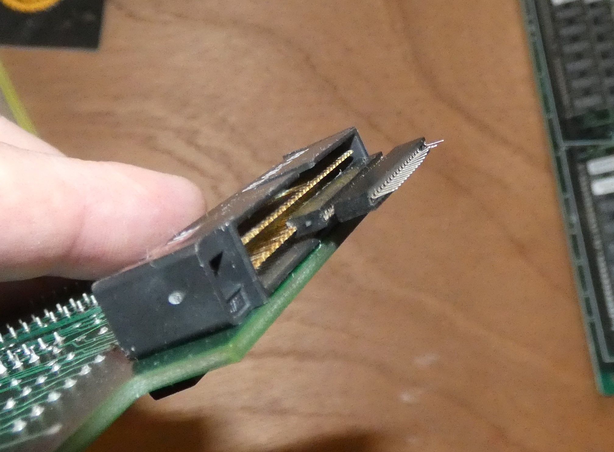

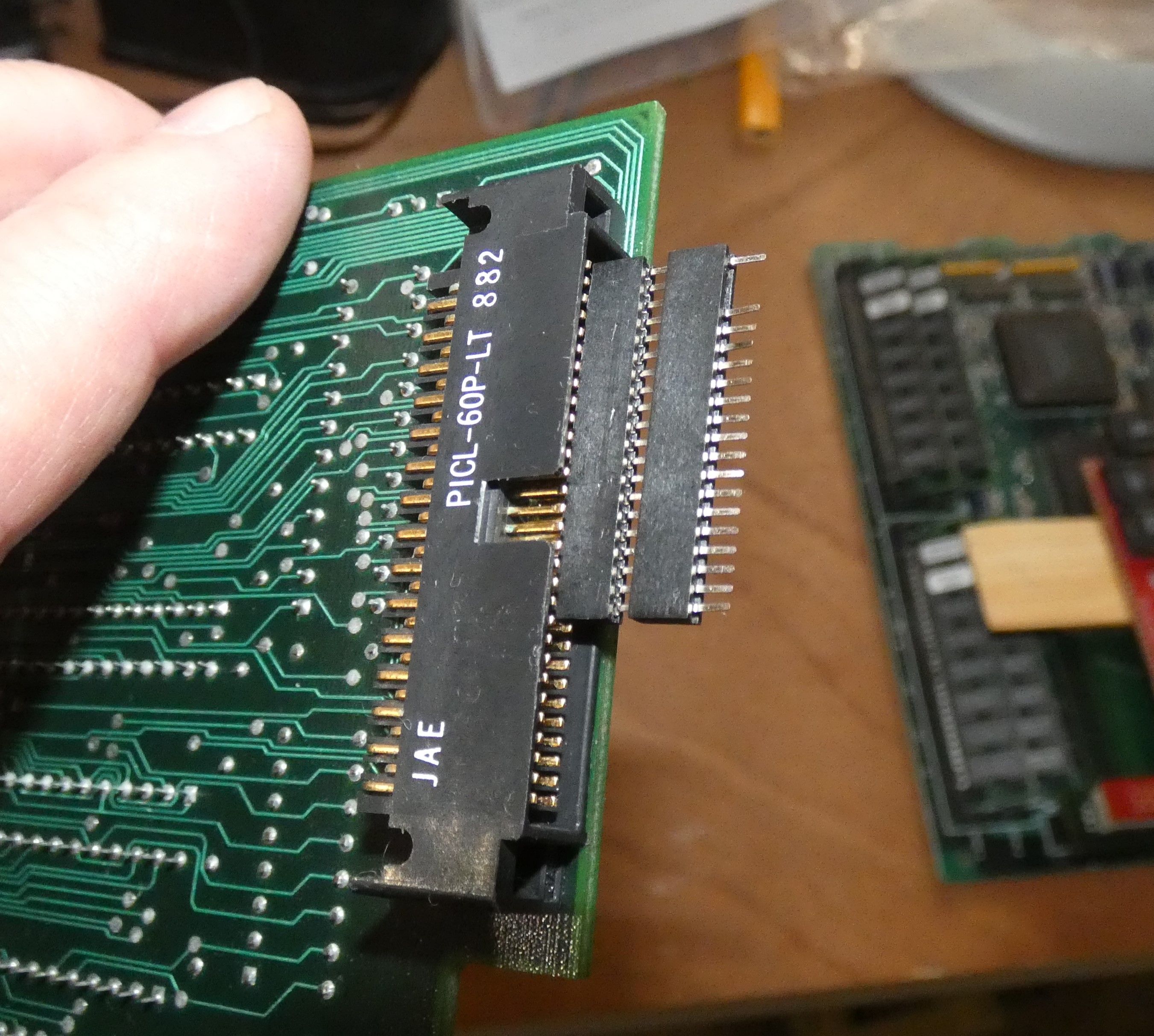

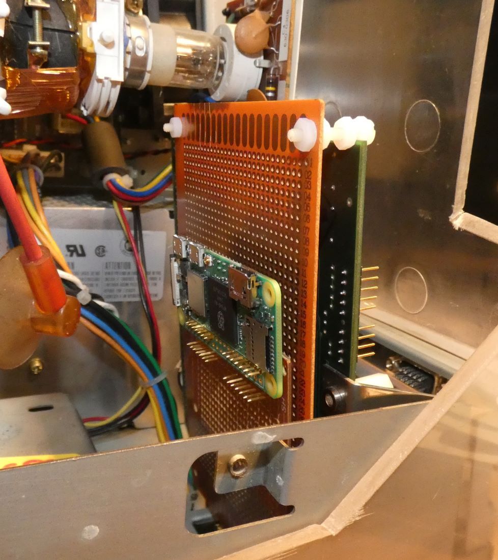

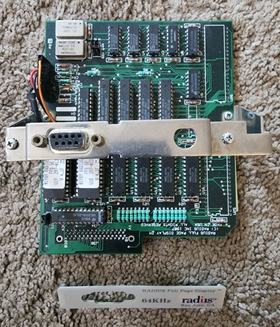

FPD/SE bits are beginning to come together. Ordered up male and female header interconnect parts today for more experimentation. Here's what I've played around with so far:

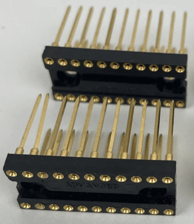

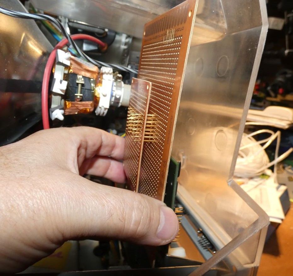

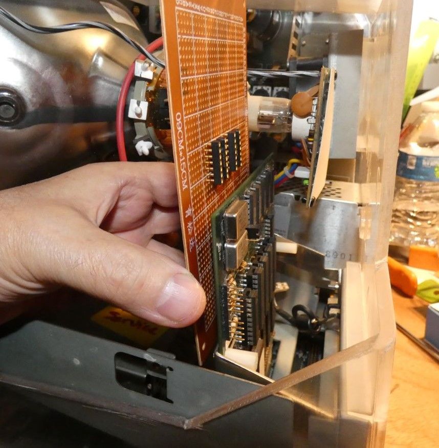

First set of single inline sockets arrived from China. They don't mesh onto the Radius FPD connector's headers, which appear to be about the same thickness as .1" pitch headers, but .05" pitch so pins don't insert. I was able to sand the socket housing's face down. That removes the plastic surround so I can get a really snug, electrically solid fit. Second connector is on it to protect the soldertails.
Hopefully the parts on the way will be what I need, but at least I've a proven modification. With a bit of sanding of the interstitial connector added, the kluge and some hot glue the FPD and TPD cards for the SE, with a new printed bracket for adjusting the height differential, will be compatible with the setup proposed below:
BlackMagicalBus is what I call the crazy contraption illustrated by the board sandwich above. It's a mating of an elongated board for the MicroMac Performer Clone project I started @Bolle pulled off so masterfully when I sent him my board. with as close to as I can come up with as a replacement for Radius' MagicBusconnector for their SE Cards using available parts.
I haven't got a Plus board handy, but the hope is that the FPD/Plus board can be cloned and placed vertically on a slightly offset variant of the elongated Performer/BlackMagicalBus Accelerator. The chassis opening of the Plus looks like it will make such a bodge possible.
A direct 1:1 clone of the FPD/Plus is one thing, but getting it to play nicely with the Performer is another thing entirely. That's the dream I have for the Drexel Plus in which I found the Performer.

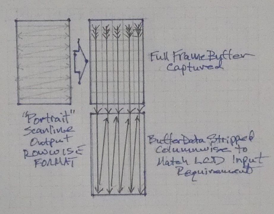

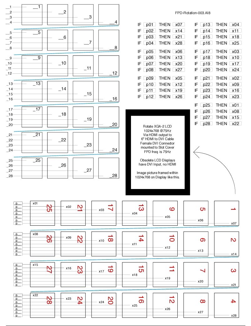

As proposed upthread: rotation of the image appears to be the most serious obstacle, but my concept for column stripping of the frame buffer appears to be as simple ad is gets.
The first approach Nick Gillard looked at for his Pico-Mac-Nano would appear to be the same as the diagram above? He abandoned it and went with a compromised approach to using a portion of his native 480x640 "Portrait" format LCD which did an end run around the rotation problem and made for a much smaller Mac replica.
Using the same Pi Nano on the clone would take care of rotation. but killing two birds with one stone seems the thing to do:

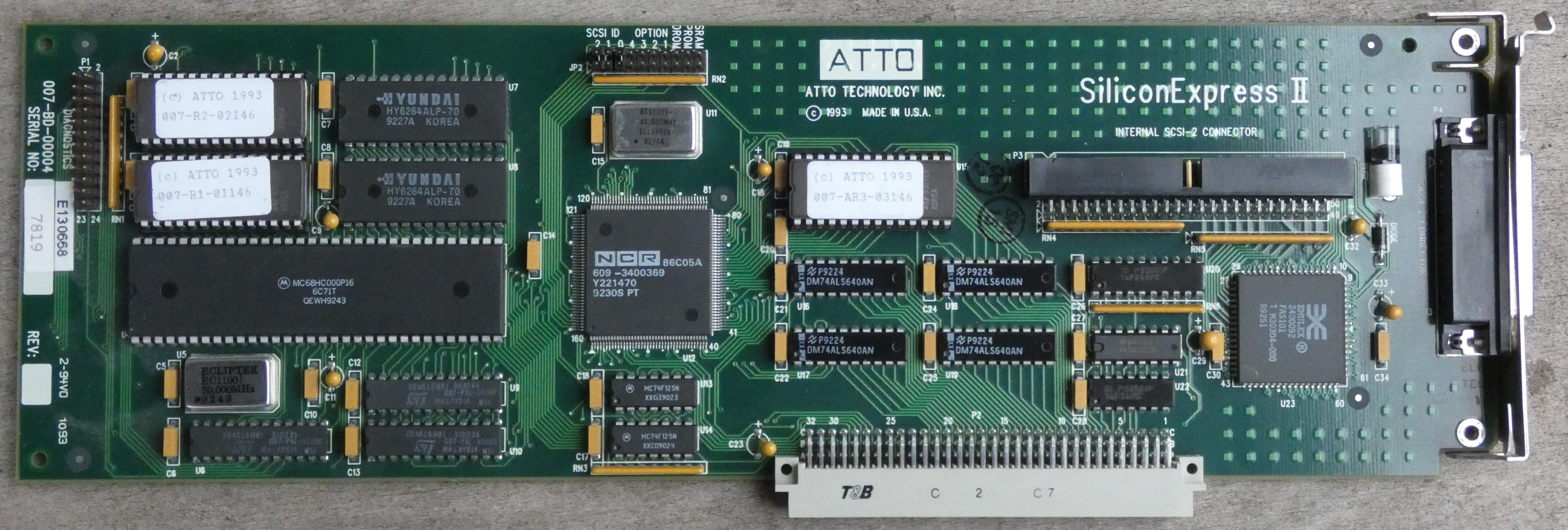

- so why on Earth is there a second 68000 in the mix?
- Plenty of ROM on there to use it as a CPU?
- No dedicated RAM as on the Atto Silicon Express II?
- Is there enough VRAM on the card to be shared with the 68000 along with Frame Buffer tasking?
- might VRAM be addressed by 68000 on the card between buffer cycles?
68000/ROM/RAM setup on ATTO SiliconExpress II
Way too many questions ATM.

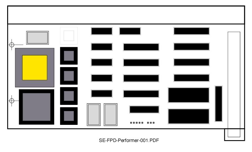

Wasted a little bit of money on inter-board connector experimentation and switched gears:
Instead of adding MagicBus to the Performer, there's room to put Performer AND the Radius FPD/SE on the same full size SE Expansion Card!
Since VGAtoHDMI works just fine for FPD resolution, the only thing left is the rotation problem.
  • SE-FPD-Performer-001.PDF
